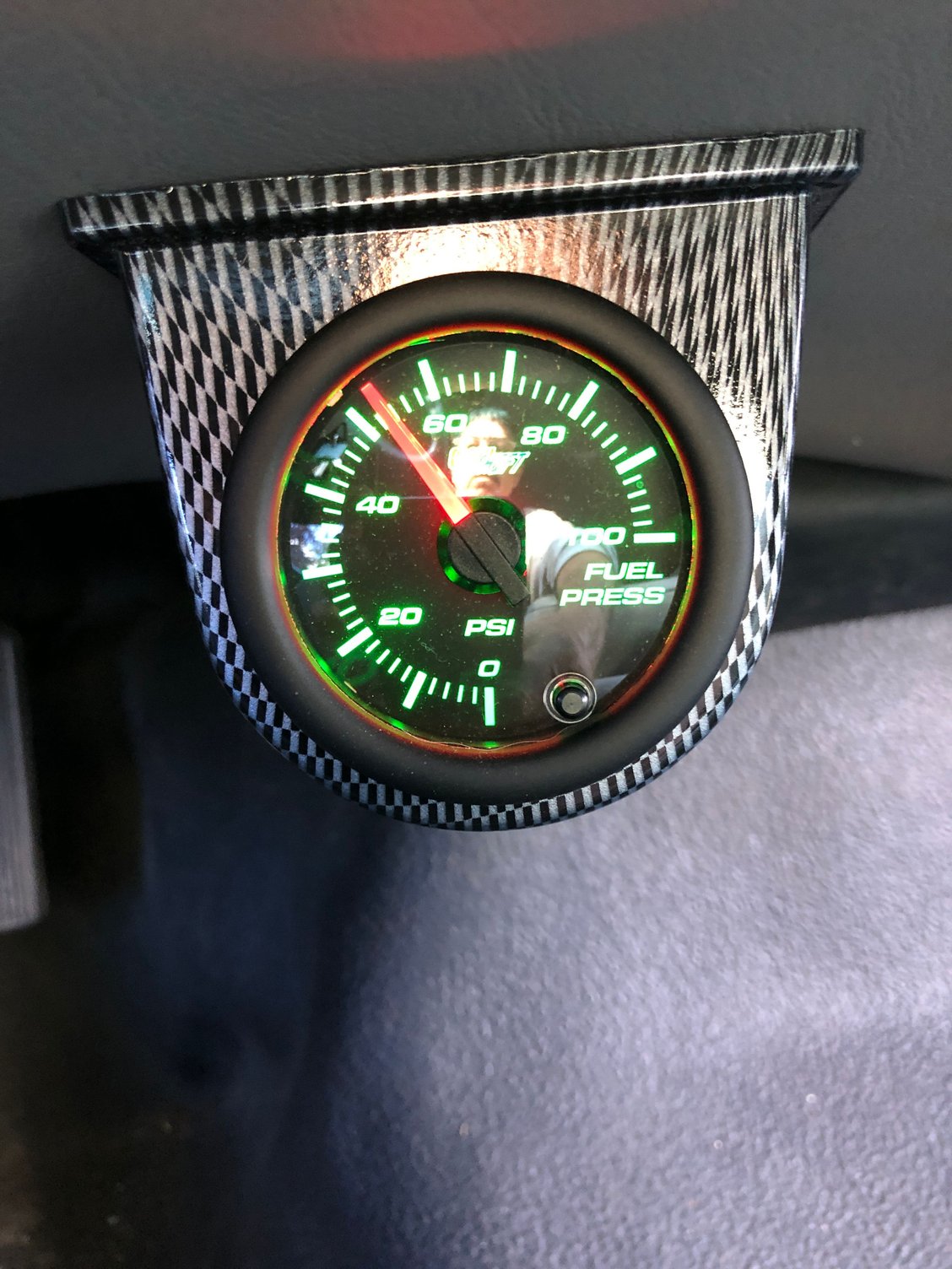

Gold spring at idle.
Less than 1/2 throttle, 2200rpm in 2nd.

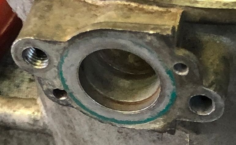

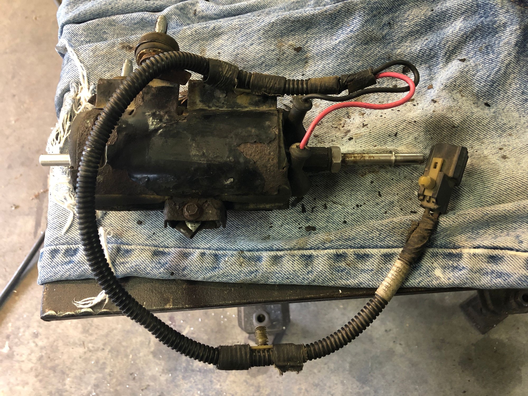

Alright, I had enough time to cool off and take a breath since my test drive.
It was an eventful day. I won’t go so far as to say nothing was achieved, but the primary symptom persists. Fuel pressure dropping under load.
Filter arrived yesterday evening and was the first thing done this morning. That was an easy job.

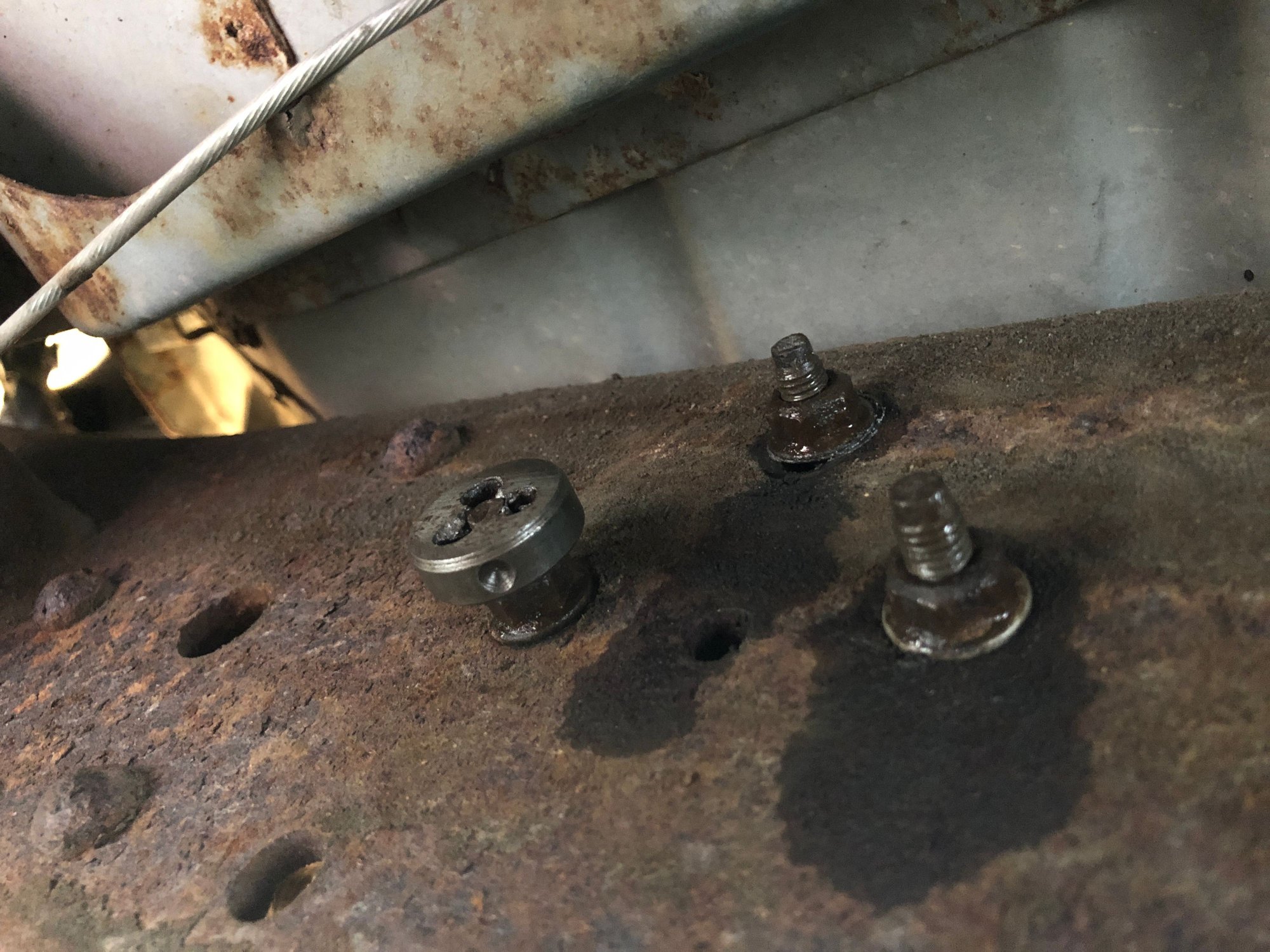

Yesterday I put penetrating oil on the 3 fuel pump mount studs. Then I chased the threads with a die 8mx1.25 before trying to remove the nuts.
Fuel pump stud on the blind side.

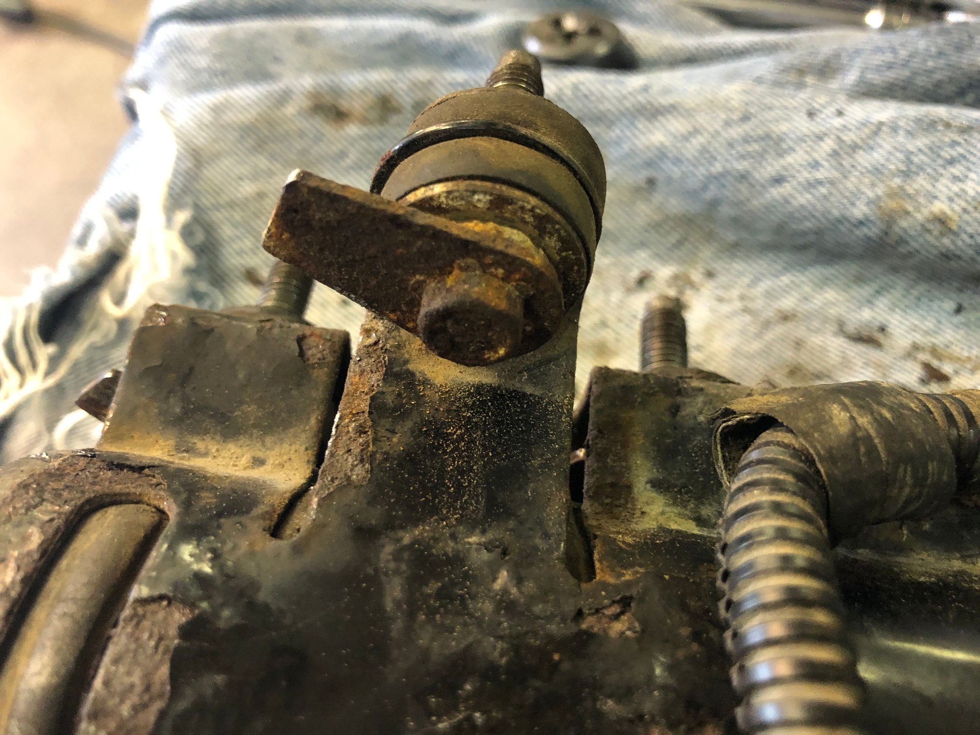

Do yourself a favour and pull it as a unit.
I was looking at it and tried to disconnect the harness from the pump (8mm for the ground, 9mm for the power) and thought if it’s this hard to pull apart how will I ever get it back together while on the truck. She much easier on the bench.
This bucket of diesel was clean before running the immersed pump.
Once I got the pump out of the mounting bracket it went into a clean pail of Diesel. There must be a check valve in the pump since it wouldn’t pump steady with reverse polarity. So switched back and forth between forward and reverse. It did pump a lot of crap into the pail. That was encouraging.
Everything reassembled on the bottom side time to move up top and do the FPR.
Just to keep it interesting one of the bolts on the FPR stripped out.
Turns out I had to pull the fuel bowl after all. Made a couple calls to some friends, solicited my FB Superduty parts group and in the end bought a helicoil kit 5m x0.8 is that bolt size.

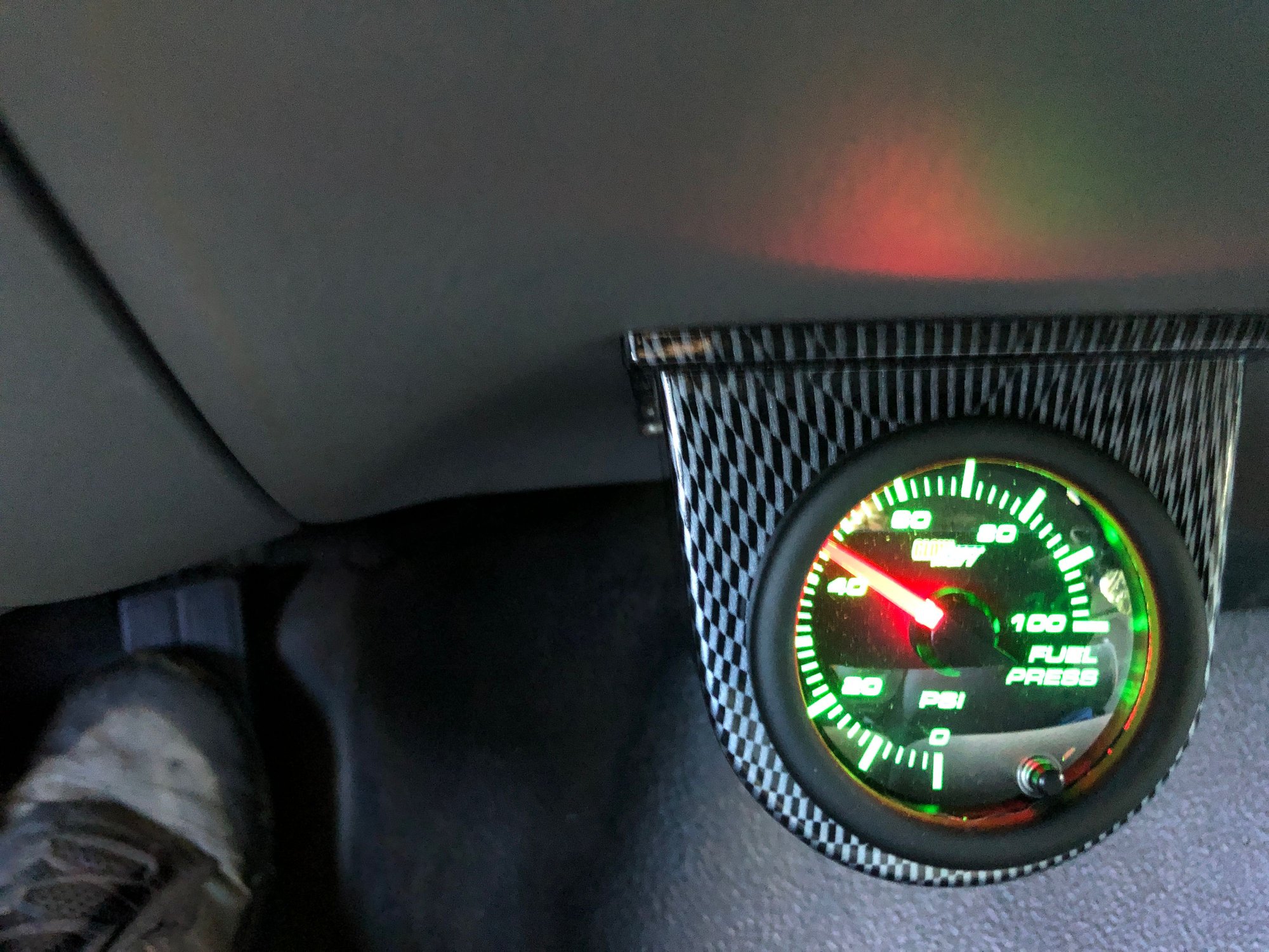

I had put the black spring in last time I had it apart which is rated for 70psi so I took that out and used the gold spring rated at 62. 55 psi is what it maxed out at and a quick drop to 40 under heavy right foot exertion.
Less than 2 blocks test drive and I was back home. Disappointed and frustrated and feel like I’m just throwing parts at it.
I thought hey, only thing left now is the fuel pump, or the Riff Raff FRx.
Then along comes noob and mentions the flex line.
Thanks Mang.

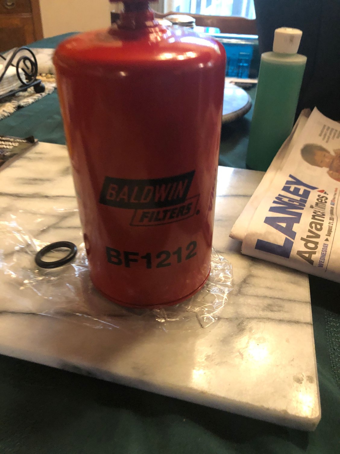

I have removed and cleaned out the tank, removed a brand new 33972 wix filter, Installed the Baldwin BF1212 pre-pump filter with 30r9 fuel line from tank to pump, Threw out the brand new Napa gold fuel filter and replaced with ford fuel bowl filter, brand new ford FPR assembly.
Pump arrives today and tonight it will be installed. If that doesn't fix my issue then the Riff Raff FRx will be removed. If not fixed after that then remaining fuel line will be replaced.
