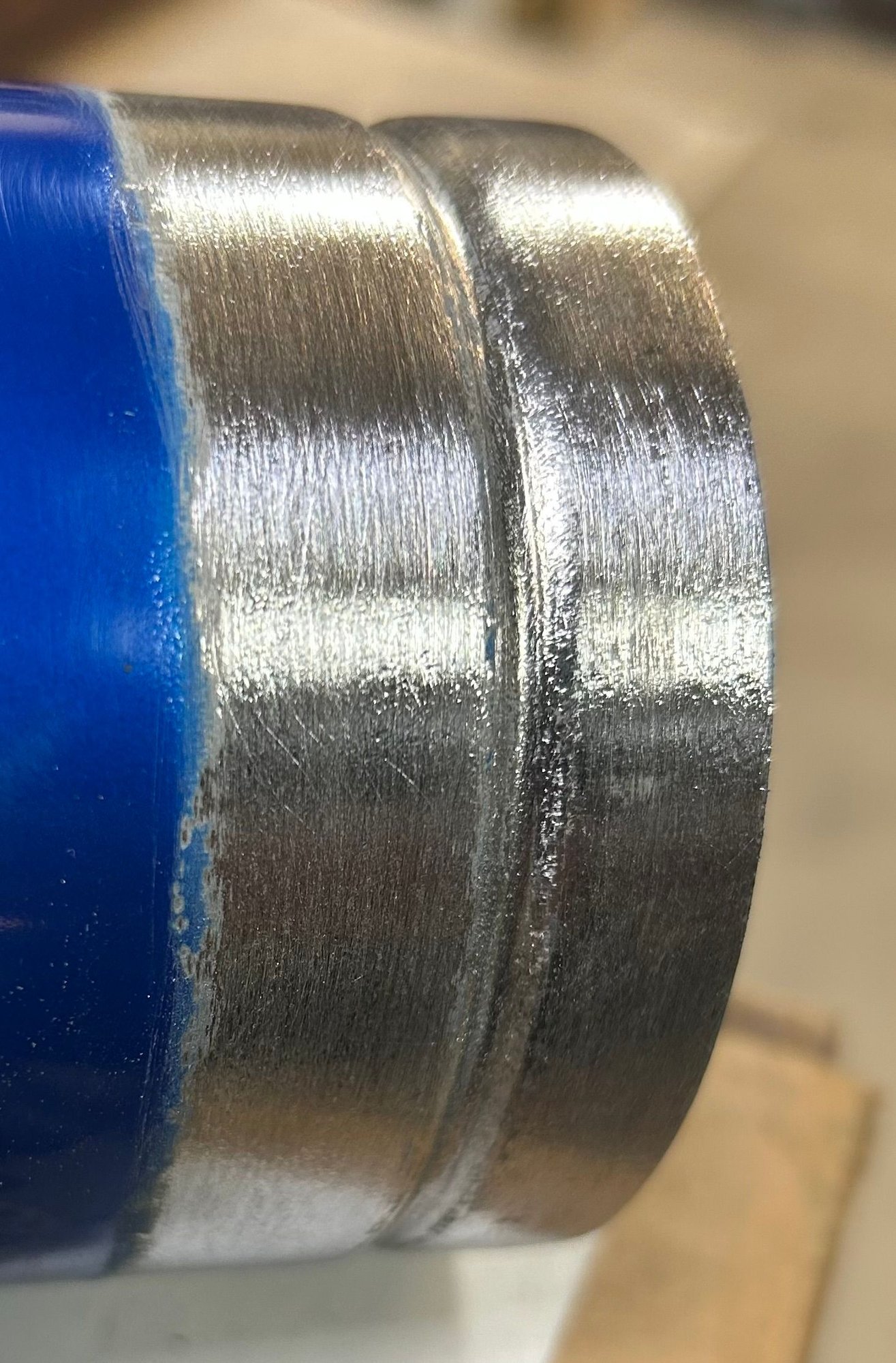

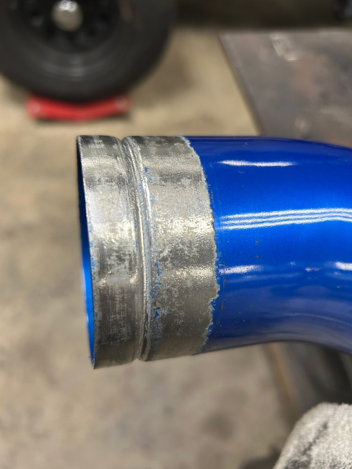

Pulled the CAC pipe this afternoon.
Interesting to see that the powder coating had slipped on the pipe. A bunch had filled up the bead roll indent and I could actually see where the coating was extended past the end of the pipe.
Spider side
Spider side
Intercooler side.
Intercooler side.
Cleaned it all off from the clamp location and then finished it off with an 80grit to scarify the surface hoping for a better bite with the boots. Going to reassemble with hairspray as well.
Before the final
Before the final 80grit “BUFF”
Ready to go back together.
Going to hold off on the welding. He seemed quite reluctant because of possibly burning the powder coating.

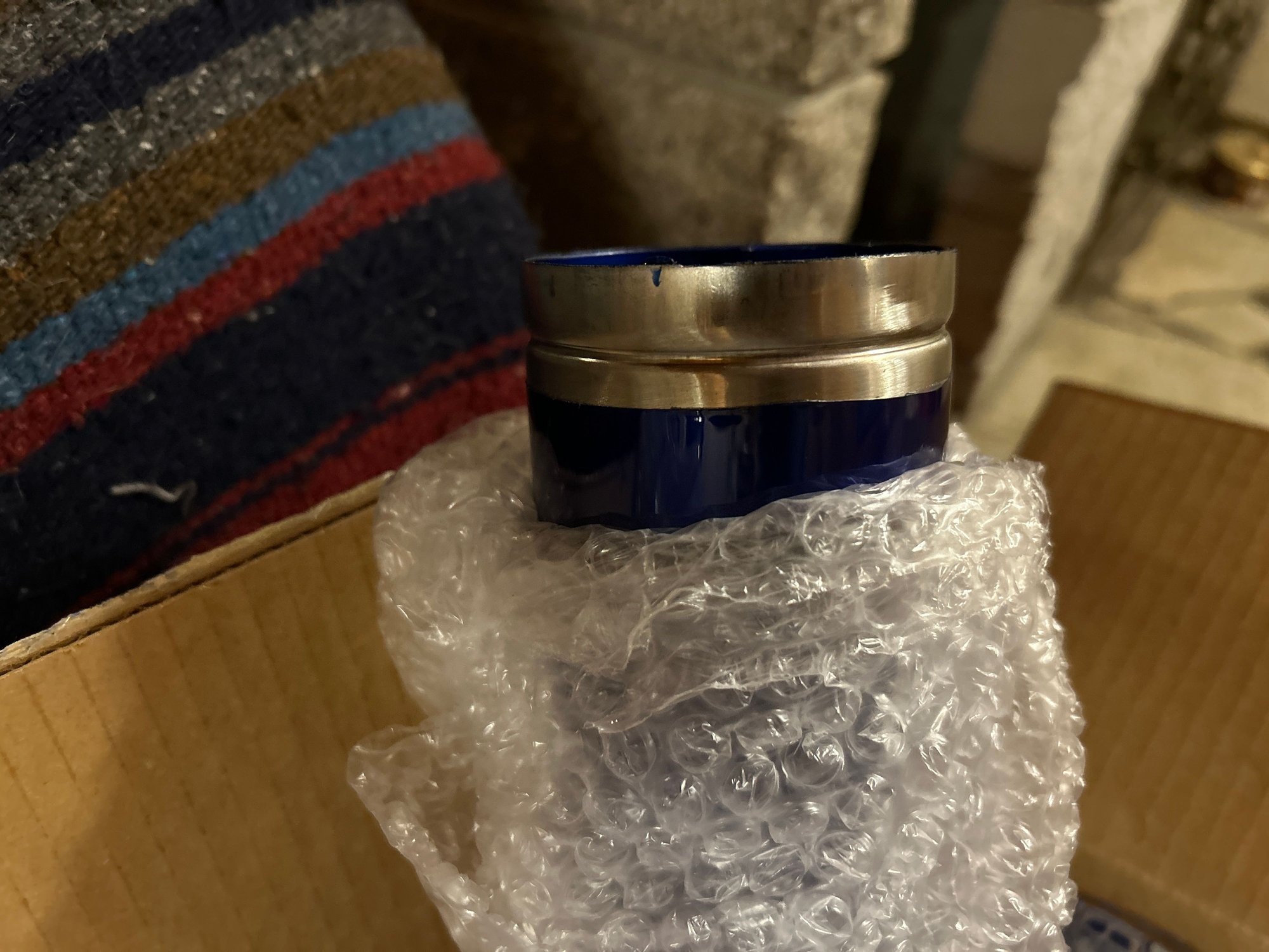

Just got back home from a 2 night out of town trip.
Sitting on my porch was a package from Sinister.
Even though they are based in Cali they are not CARB compliant.
As promised they have taped off the clamp location for the new pipe delivered. This one is going on the shelf for now. Gonna run the one I prepped and if all is well then this one goes onto marketplace to recoup some of my cost.
Too bad my camping season is over. Won’t find out until spring.
