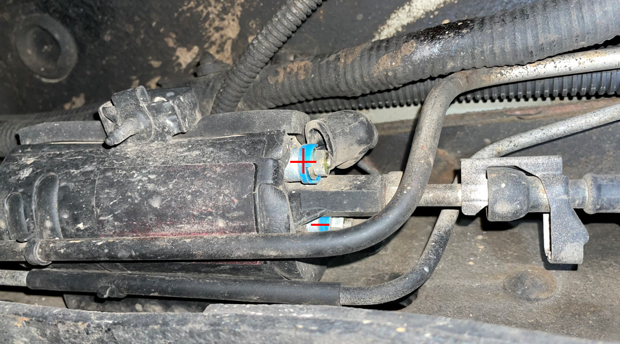

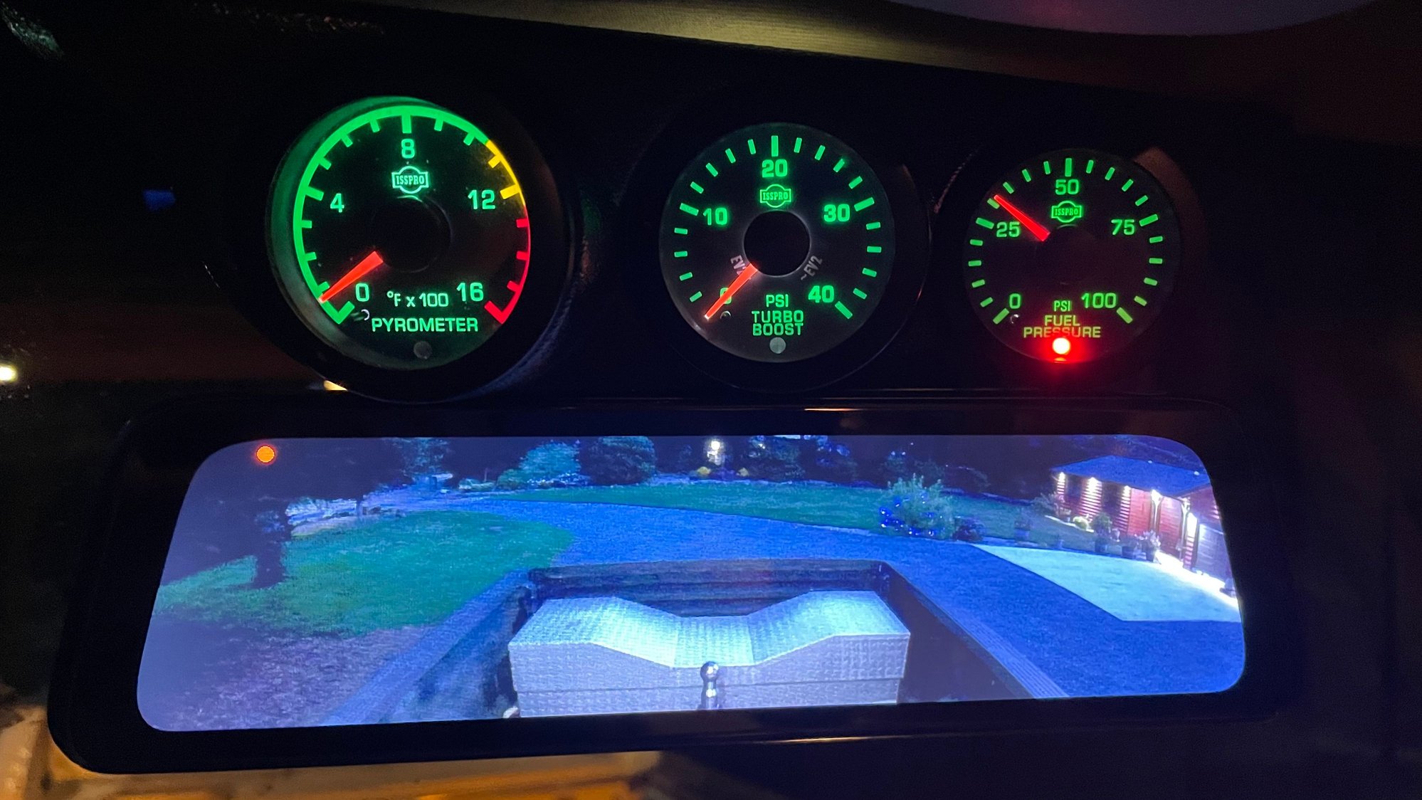

Latest update.
FRx is reinstalled.
Tank is full now.
Fuel pressure with the Riff Raff black spring is 62lbs.
Drops to around 54lbs under foot to floor in 3rd TC locked in hot tune.
Fuel pressure still doesn’t bleed down after 20second timeout. Problem with return line. FPR poppet does have the bleed down hole, and FRx being post poppet that shouldn’t matter.
Gonna run it for now. 2nd day into my vacay and supposed to be 400 miles north of where I currently am.
Most people have to drive by the EGT, I’m gonna drive by the fuel pressure if it becomes an issue.

I checked again the pressure drop after pump times out. Mine goes to zero very quickly. It’s an electronic gauge so can’t check that since going key off kills the gauge.
Took a video with hopes it would be small enough to upload. Nope, not even after trimming. The video is 2 seconds long so that’s about how long it takes to drop to zero. Pretty smooth all the way down.
Looks like unloaded after all!

Ah yes, I didn’t think about the return side. How long does it take to lose 5 gallon to the tank during this process with return going there? If it’s a few minutes that could still work for a quick confirmation. Carry an extra 5 gallon with you just in case. I understand the topper makes this much more difficult though too.
Something tells me that 5 gallons would last a very long time based on the bleed down time of my fuel pressure once the 20second relay shuts off.
Thinking about the return restriction and shouldn’t that be similar to a deadhead but not fully plugged off.
Going off that thought, shouldn’t that cause higher pressure? Yet here I am with a 70lb FP spring sitting at 62lbs at idle.
Once I get back from this trip the tank will come down for the 3rd time. I will flush the return line and snake out the in tank pickup and return.
Im rambling my thoughts as I type this.

Truck performed well for the drive. Fuel pressure has dropped at idle to about 59, but never dropped below 50lbs even when I was flogging it.
Took a while for me to have confidence in it, and more than once ( read 100 times ) wife asked me if everything was ok.
Whatever was blocking the return line has flushed out because it’s dropping like a rock now.

Since the tank of rusty fuel was introduced the delta between idle and heavy demand has been constant at 15lbs.
KOEO and fuel pressure climbs quickly to 80% value then slowly climbs to reach peak value. KOER is about the same.
Is this this happening - slowly reaching your nominal fuel pressure? That seems odd to me - I wonder if this is a clue. What would cause that - poppet starting to open maybe? Pump pressure/volume should be more than the flow past the fuel return poppet by quite a bit I would think.
Just checked mine. Pressure goes up to 65-66PSI quickly. While I rebuilt the fuel bowl, it still has the OEM FPR.
When the fuel pump relay kicks off, the pressure slowly drops. It's still over 25PSI after 3 minutes on my truck. Looks like I have a restriction too, but it does not appear to affect FP under load. It does not drop more than 5-6PSI with these 160/30's, though have not checked that with this latest tune.
Is the fuel pump getting full voltage in all running modes? Wondering if there's a voltage drop in the circuit that is reducing voltage to the pump. Just spitballing another idea.
