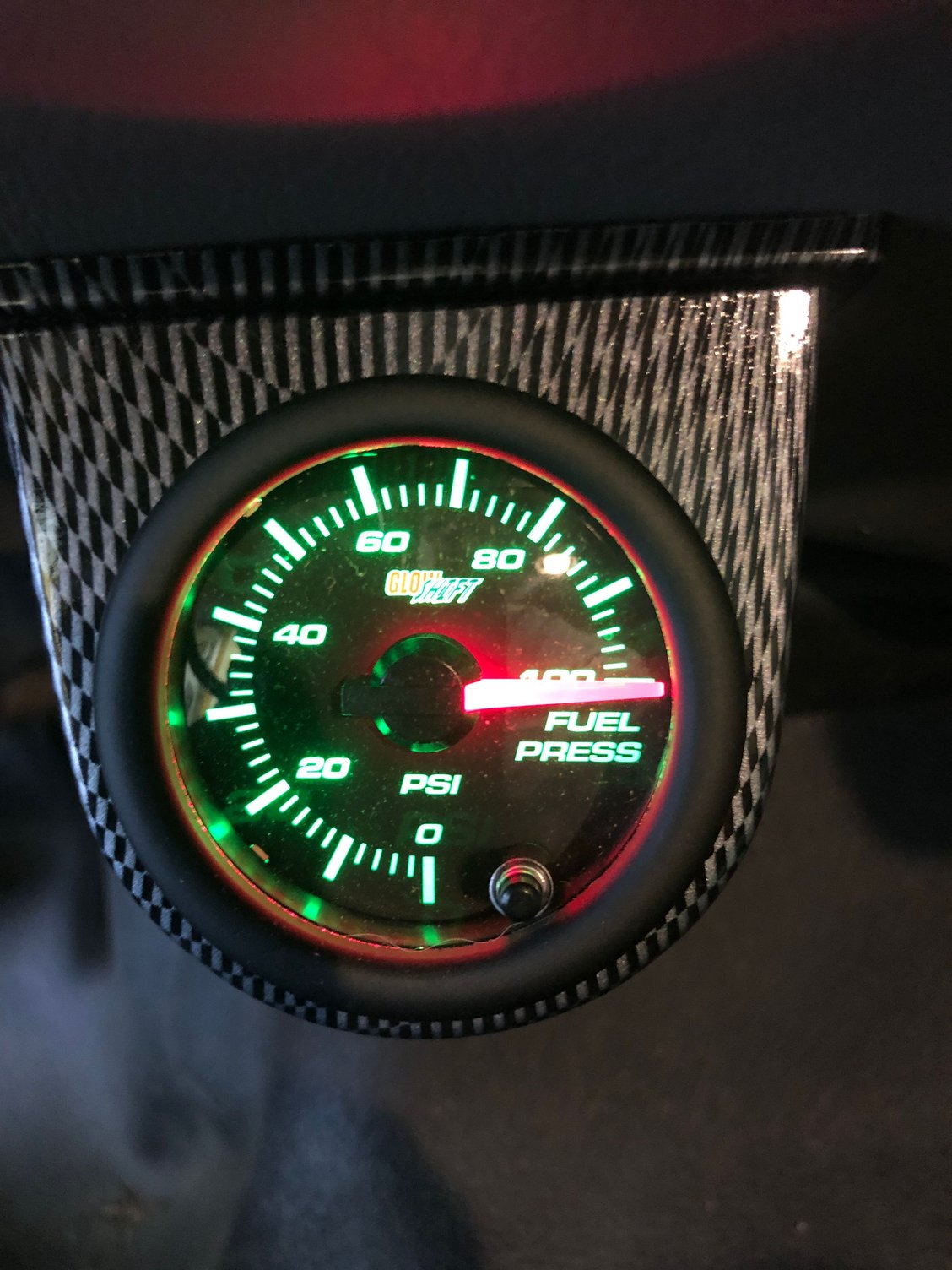

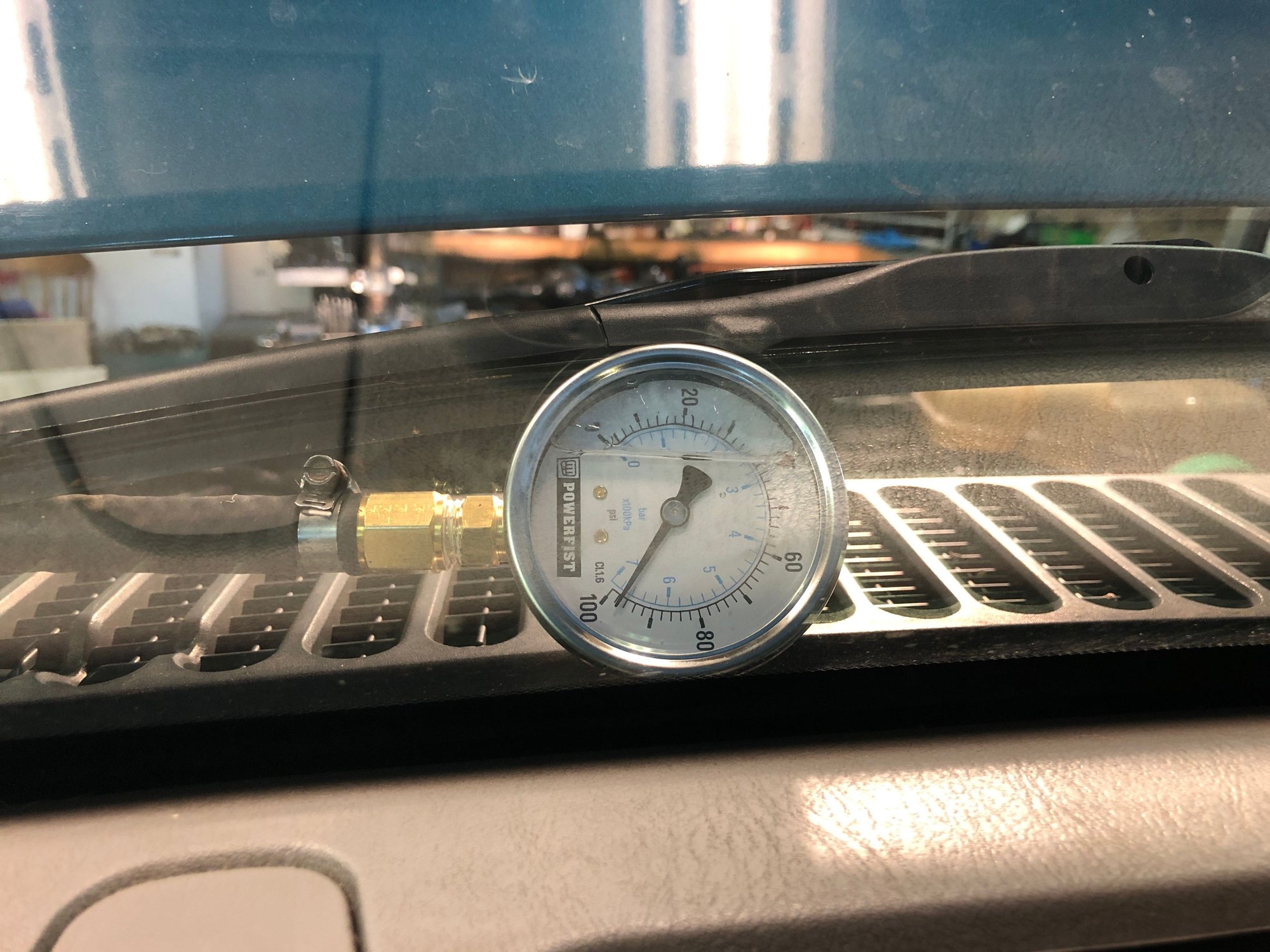

In preparation for tomorrow’s opening up the fuel system, once again, I did a couple of preliminary tests.
Voltage at battery is 14.02, fuel pump is 13.64. Lines up with what Jeff saw on his truck.
Did a “full stop” deadhead on the return line and fuel pressure maxed out at 65psi.

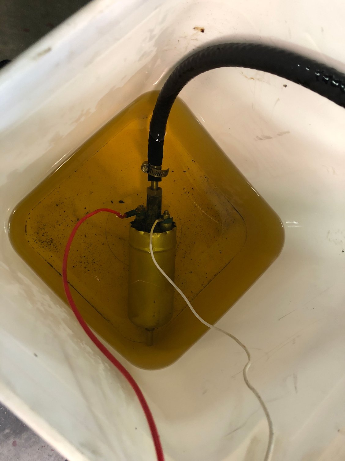

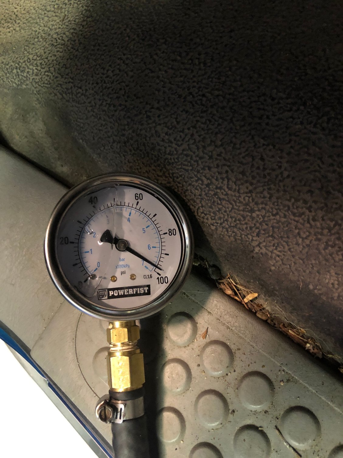

Deadhead on removed and replaced fuel pump is at + 100psi
Cool, so now I know it wasn’t the pump, which I already know because I installed the replacement.
Climb underneath and deadhead the new pump expecting to see low pressure from an in tank restriction.
Damn.
Where the heck is this pressure bleeding off.
I did a deadhead on the return line and maxed out at 65.

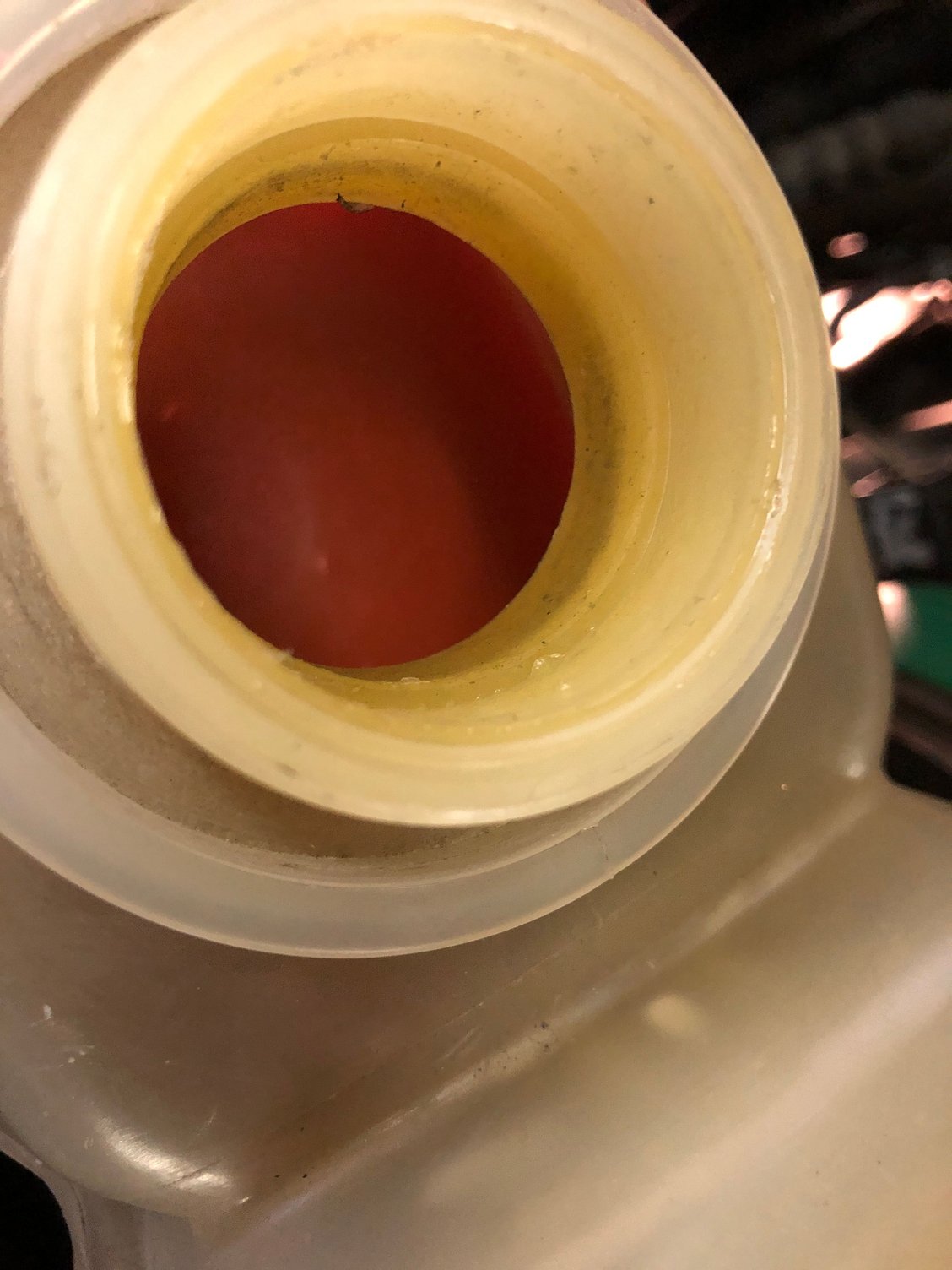

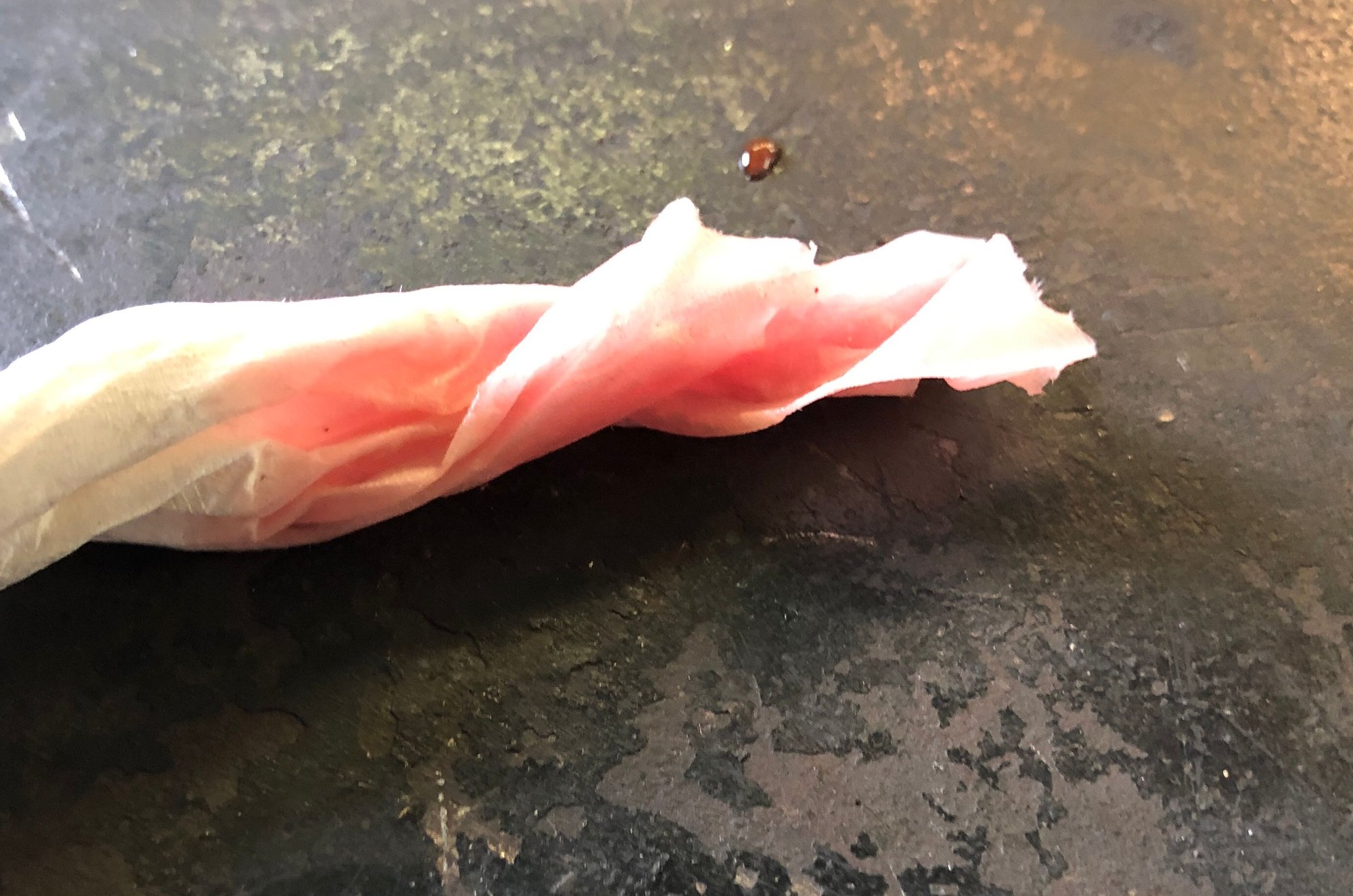

Originally Posted by Tpayne621
Wonder if it's a internal issue with one of the injectors bleeding off pressure somehow? No diesel smell on coolant or oil?
Coolant smells like coolant. Looks clean with no floating scum on top.
Looks good. Passed the sniff test.
Dipped a paper towel. Came back clean antifreeze with no smell of diesel.
Oil smells like oil.

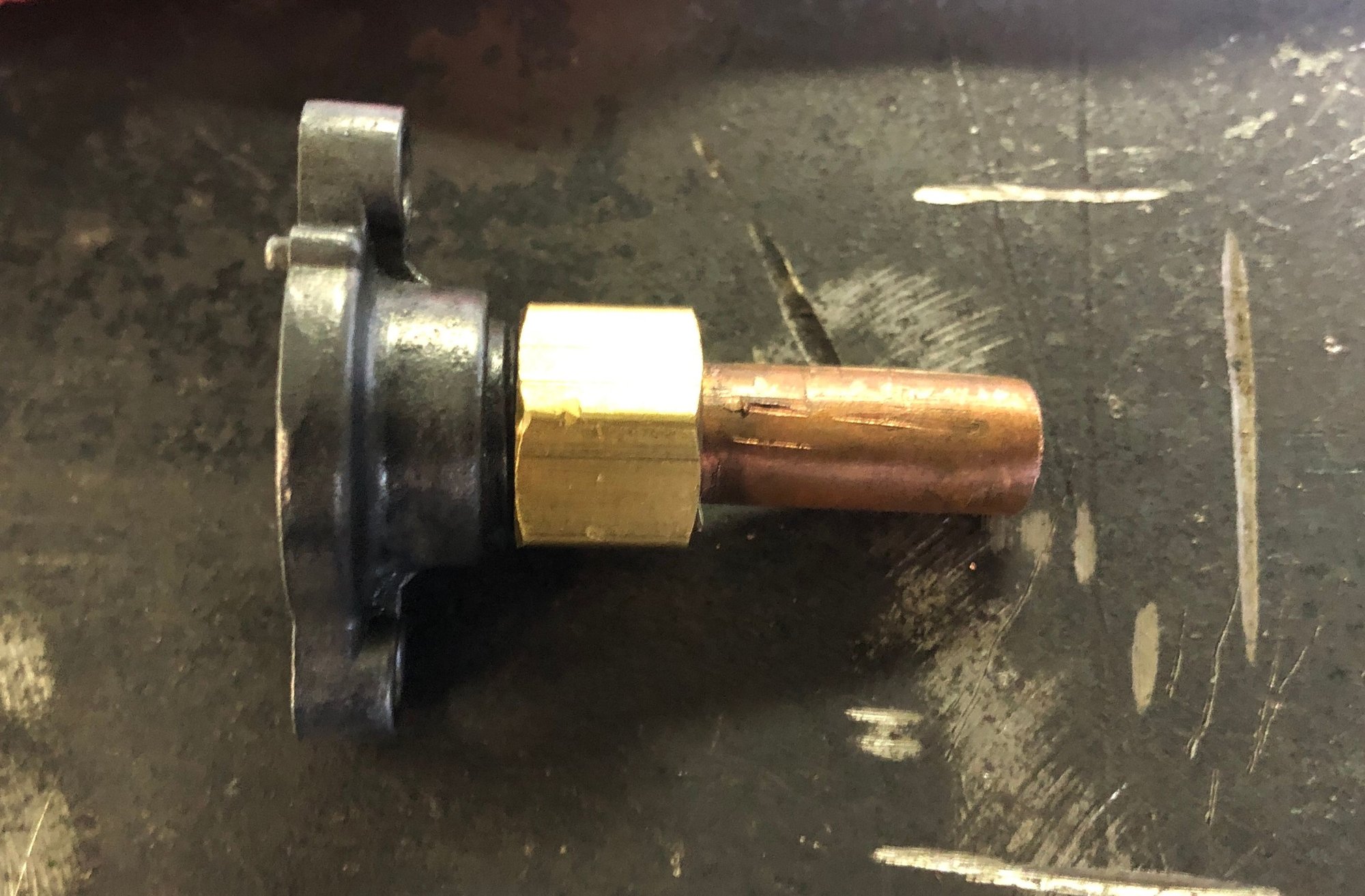

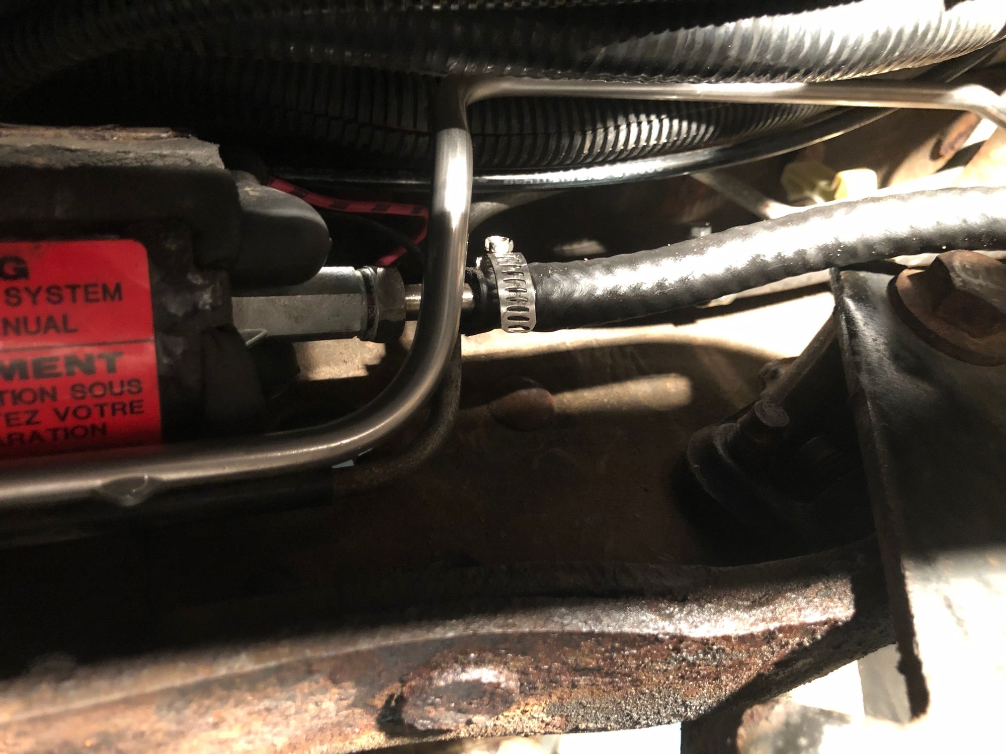

Deadhead on the return line yesterday was just clamping vise grips on the flex line between bowl to frame hard lines.
Just about to install this fitting and check pressure after FPR.

just got fuel feed line hooked back up under the truck.
Moving to engine now for Return deadhead hook up to gauge.
Back in 1/2 hr with results.

Less than 1/2hr. Getting to be a pro at this.
FPR is the culprit.

Today with the deadhead on return line both the post filter and remote pre filter pegged at +100psi.
Reattached the return line and back to 58psi on the black spring.
