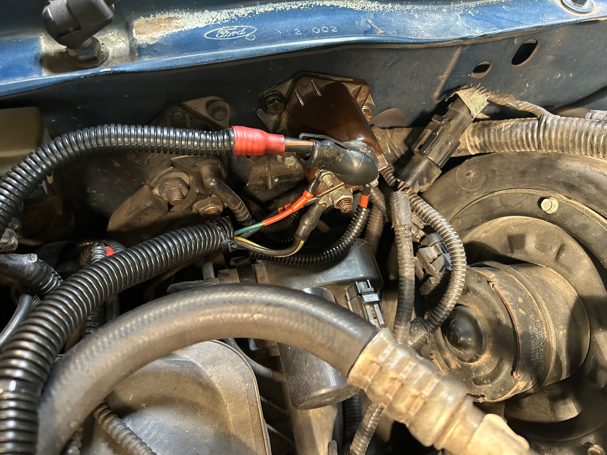

This is the AIH relay for now.
Originally Posted by BWST
I thought it was necessary at the time - might have just been convenient. I wonder if you could use the space to the right of the starter relay - where I put a Noco charger.
Thats where I currently have my relay mounted.
