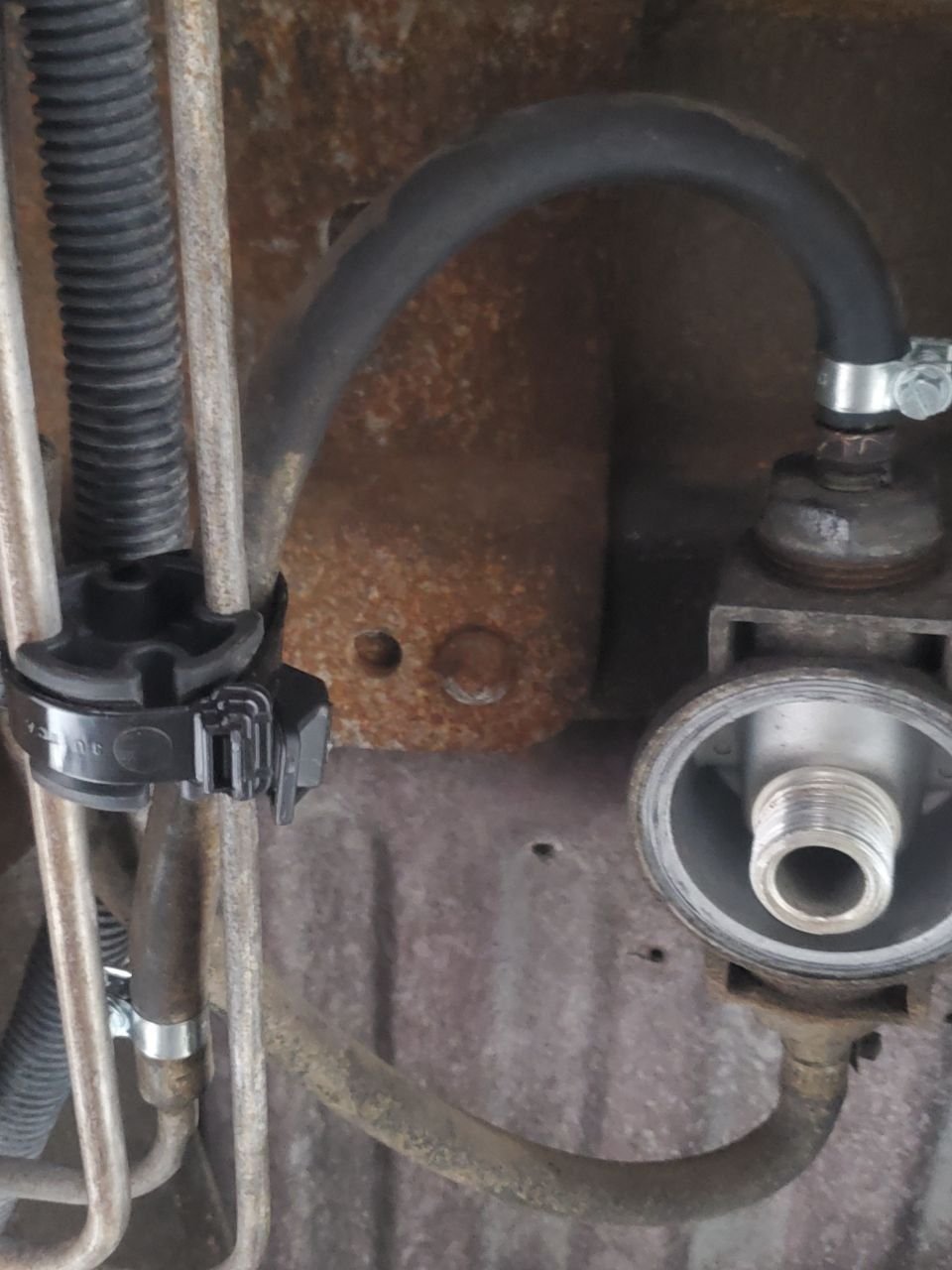

my previous pix showed the sump we installed.
this is the Wix Pre-pump 10 micron filter that has been on the truck for 20+ years.
the Fire Department installed it, 10 microns is not too small to restrict fuel flow, as the canister volume is huge...
most likely, it got changed out a few times, we did, only a few thousand miles on the new filter.

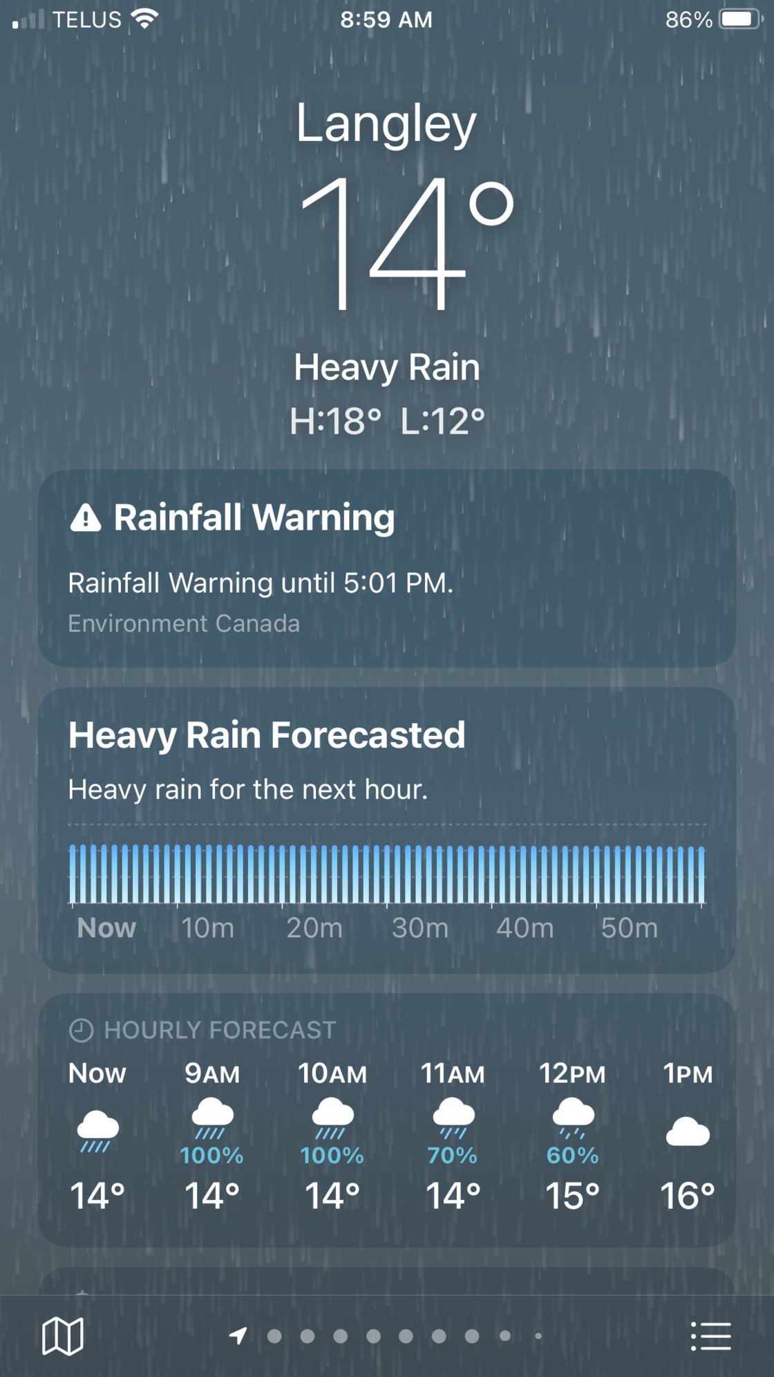

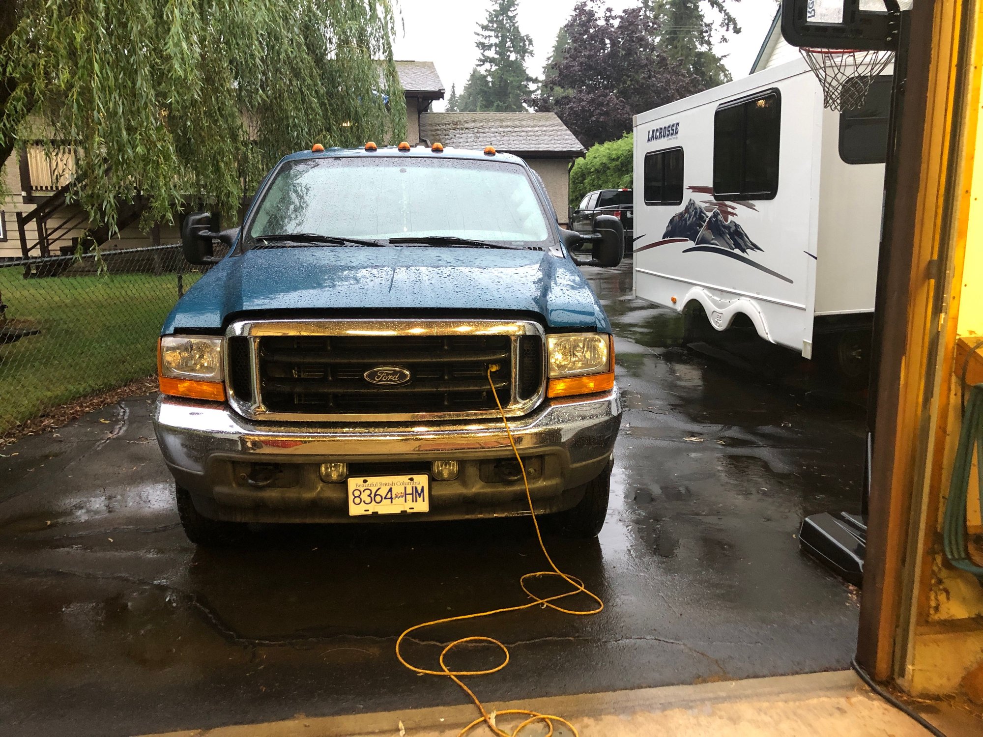

Boy did I pick the wrong day to put this off to.
It’s been raining steady since last night. Of course I opted to do the tank work outside of the shop so that I had room to work.
Rolling around on the creeper in the pouring rain ain’t no fun. Better than crawling around on gravel though.

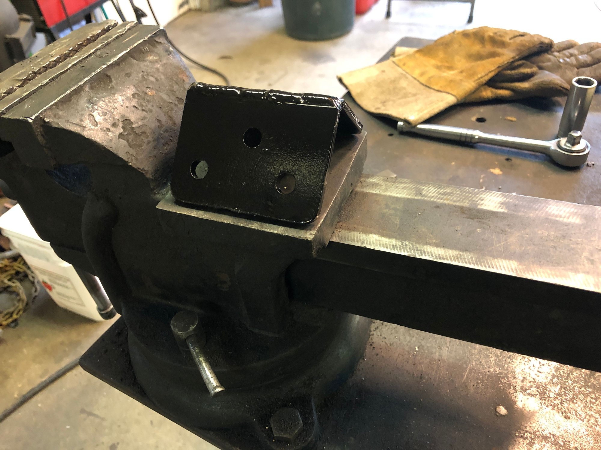

So far I have the bracket made for mounting the filter.
Had a good look at the fuel pump and trying to decide the best method for flushing in reverse. Leave in place and swap the wires, or remove and flush on the bench. Neither looks to be a fun job.

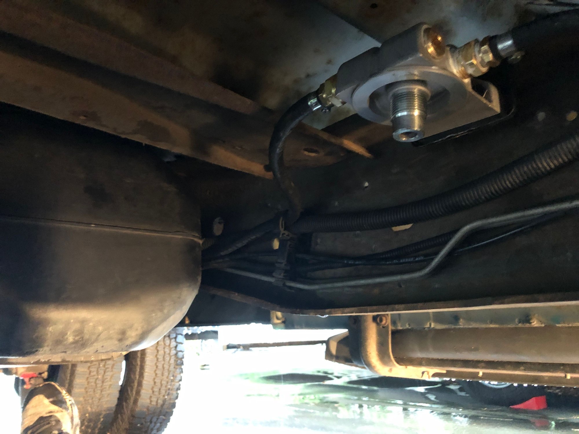

Threw in the towel/ came in to towel off.
This is how far I got.
