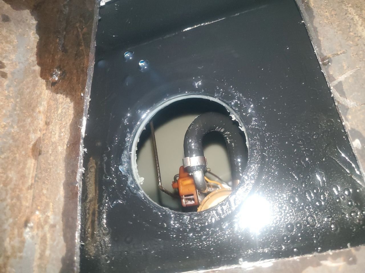

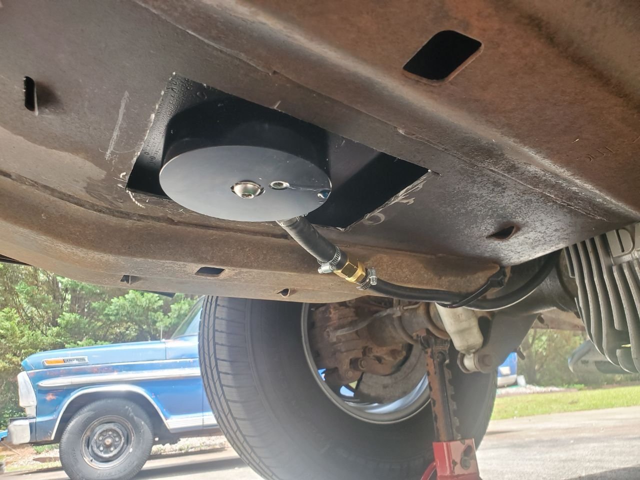

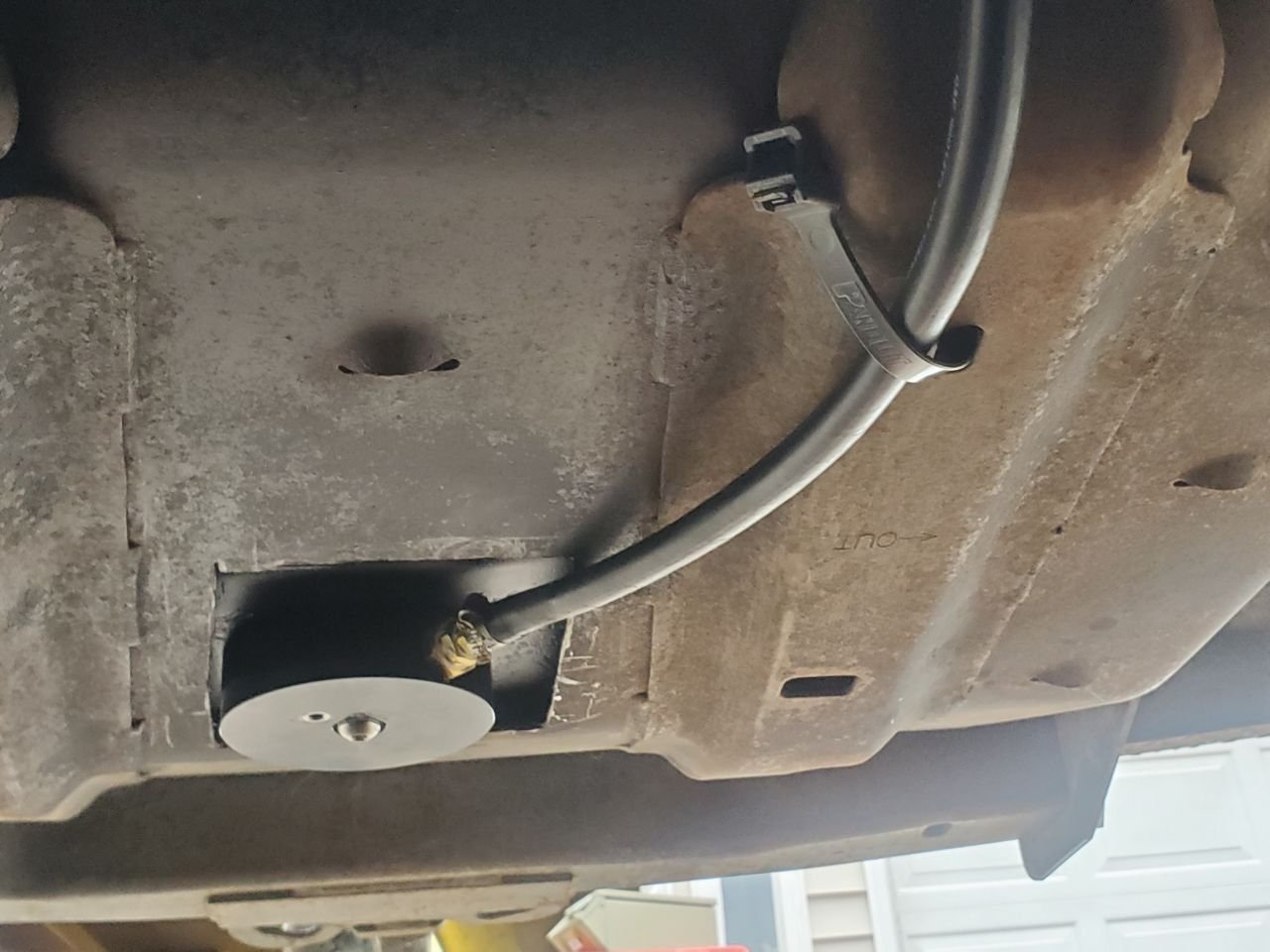

PJ cut the OEM fuel line just aft of the Fuel Pump, and ran the new all rubber fuel hose direct to the pump suction line, I bought special fuel line hose clamps, Worm Gear clamps are not good enough, they leak, and we can prove it.
This is the OEM Return Line, it worked for 20+ years, we left it as it, why reinvent the wheel?
Return line worked for 20+ years, why change it? : :
this is where the hole was cut in the skid plate : :
the hole saw drill bit, cut the hole in the tank,
it drained diesel for over 20 minutes
Sump position is directly inside that circle. : :
this is a better view of the Sump and the line we used, the Sump uses a 1/2" fitting, we reduced that to 5/16" for the fuel line to the pump.

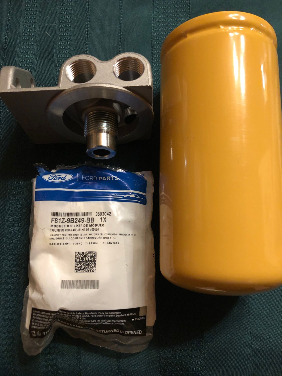

Parts arrived today.
Have the FPR and the screw on style filter and base.
Couldn’t find a Racor PS 120-02 that was reasonably priced, and readily available. Figure I will go to a Baldwin or a Donaldson for the next filter. This one is rated as a 2 micron, and I’m going to leave the brand new Wix 33972 in line as well.

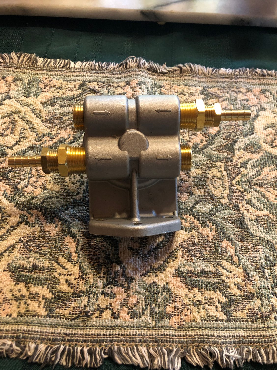

Got my fittings today.
