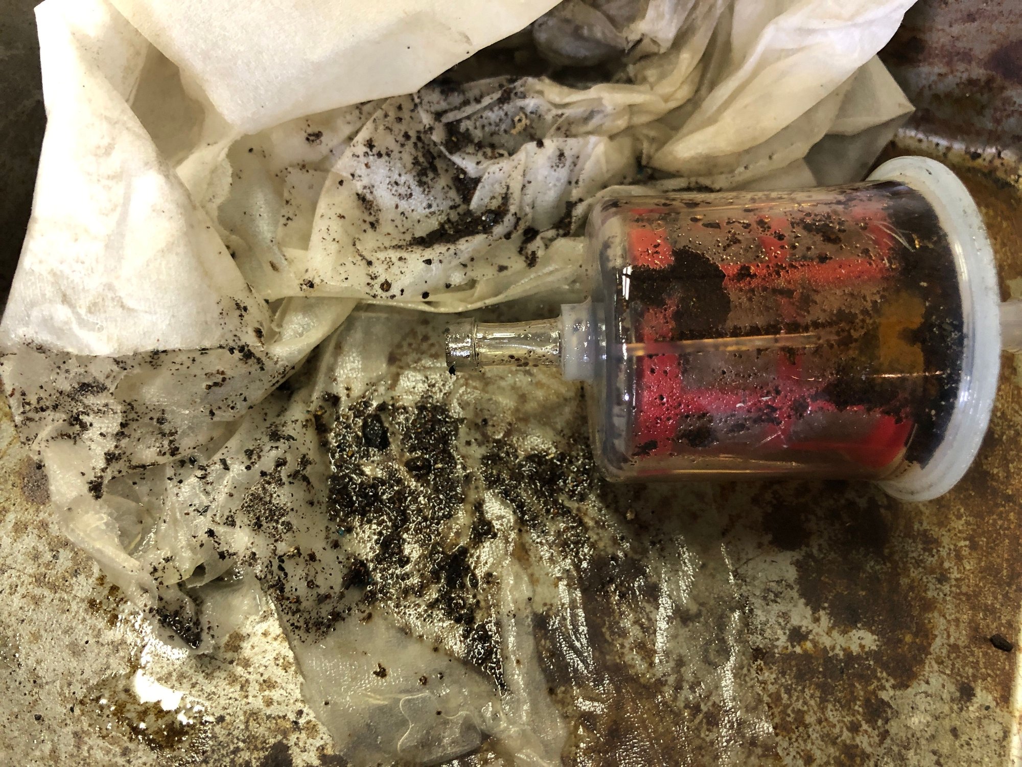

Heres the pre pump picture.
I dunno where I picked up the bad fuel from. I can only imagine what the tank looks like.

My pre-pump WIX has a little bit of the same looking type of material in it too. Wonder what it is? Looks rusty to me. But a plastic tank 🤷‍♂️. Maybe from the fuel station tanks.
Yup. I’m thinking the same thing. Fuel station tank debris.
I won’t fuel up at a station that is getting filled from a tanker for that exact reason. Had a problem years ago in a Datsun and had to eventually drop the tank to clean it out.
I’ll know within the hour if I have to drop the tank. Headed out to the shop to change the filter and blow air through the line and then see what fuel pressure looks like after.

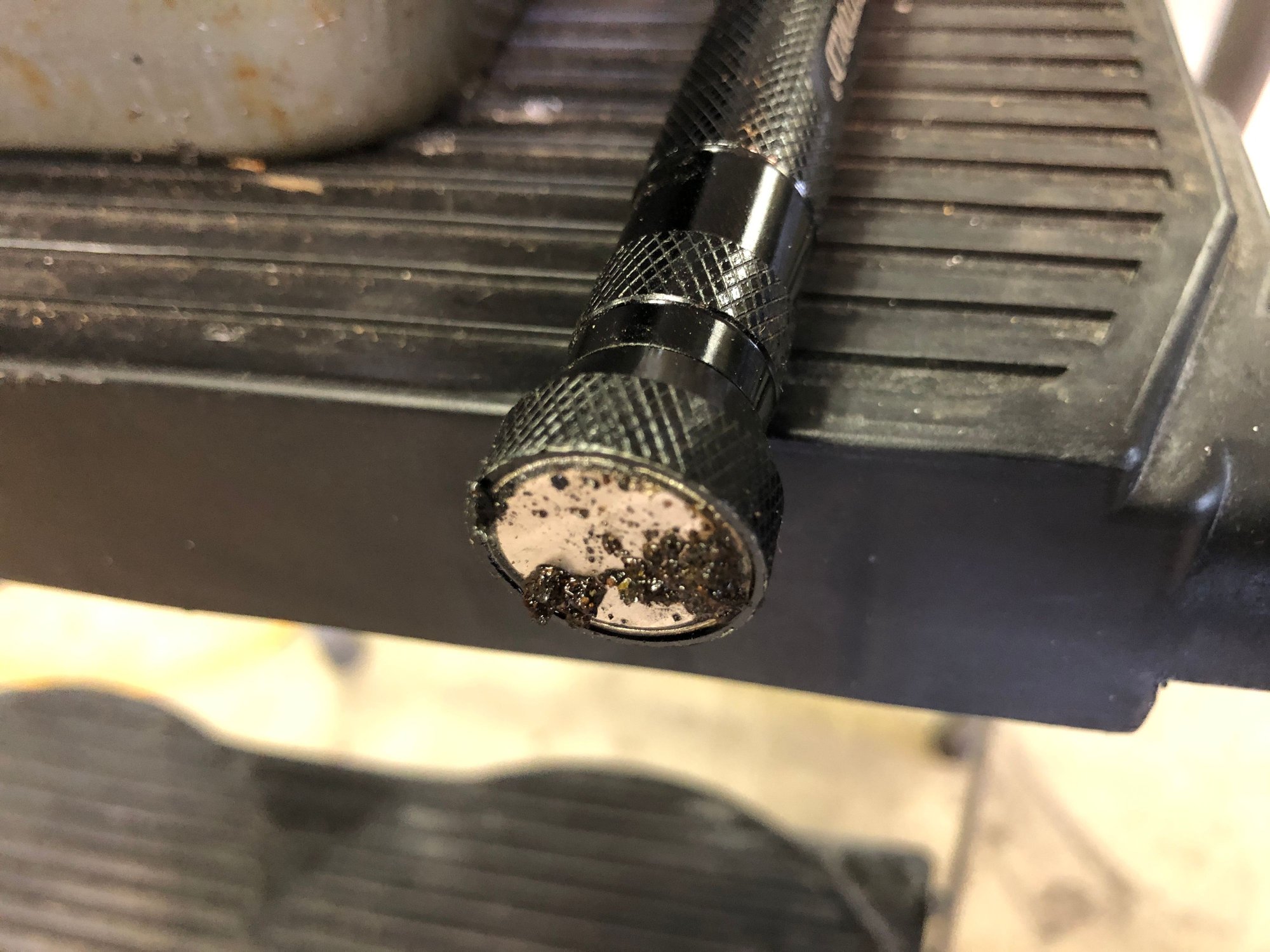

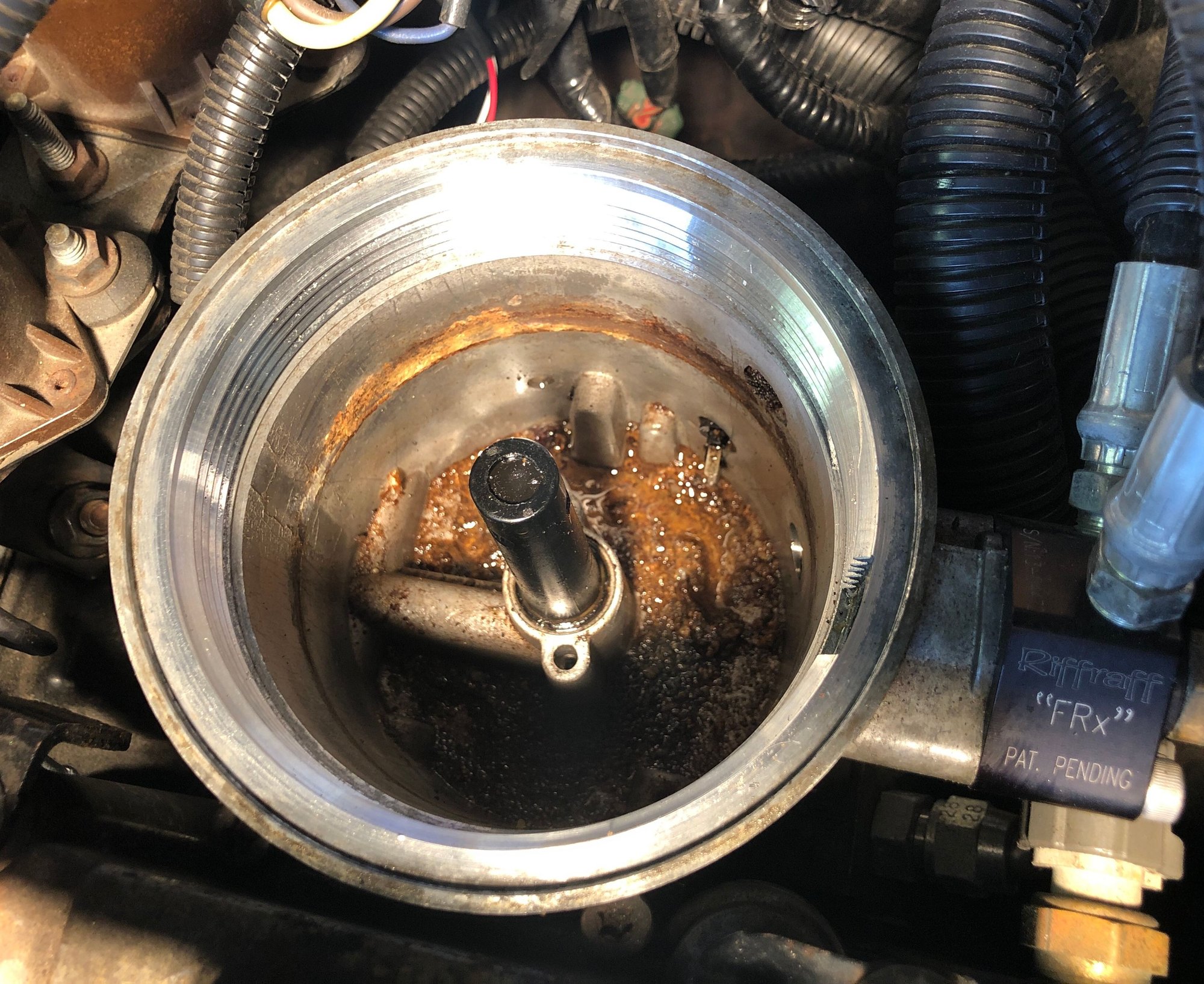

Found the problem.
after replacing the filter and blowing out the line FP was still at 52-55 and would drop significantly with a stab at the pedal.
Went after the FPR next. Cleaned it all up and replaced the O-ring and Parker sleeve. Installed the RDP black spring. 65psi at an idle.
Next is the test drive to confirm.
Filter was full of rust.
That’s a lot of crap in there.
Probed with a magnet. Yup its ferrous.

How did the poppet seat look when you had the FPR apart? (Taking about that little beveled gasket that sits on the plunger). I experienced similar symptoms, installed a new fuel pump, and that wasn’t the problem. These parts fixed my issue: https://dieselorings.com/products/7-...ef-rebuild-kit
It looked good with no nicks or debris on it. The spring didn’t look pretty though. That’s why I went with the black spring over the what was once gold spring.

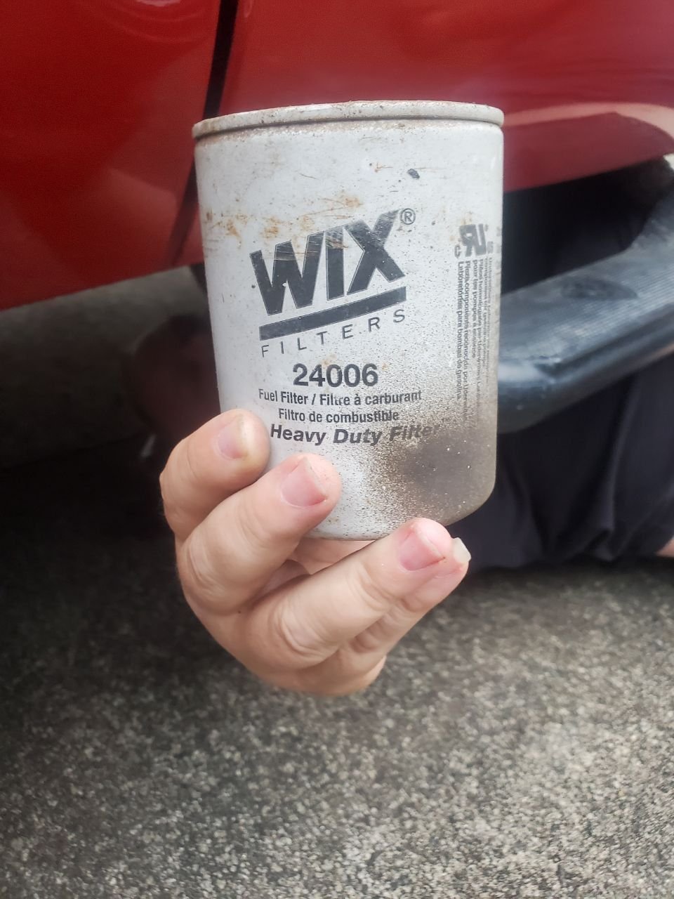

I think your PrePump filter is way too small,
put a BIG filter on it,
my truck has the Wix 24006 on it, it is as big as the 7.3's oil filter.
( that Wix 24006 was installed by the Fire Department 20 years ago )

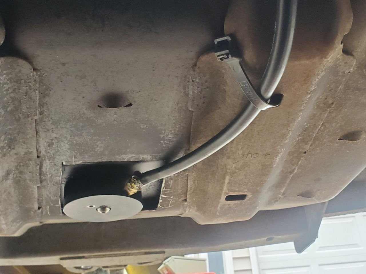

a year ago, I was having running problems also, I bought a new fuel pump from O'Reilly's, the best one they have, $200 it cost me, but it and a new PrePump fuel filter fixed my truck.
my fuel tank has a Sump on it now, no more worries about the in-tank filters stopping up
Starting to see the merits of a fuel tank sump with a bigger pre-pump filter.
I’m leery about the single centre fastener for clamping pressure to seal the O-ring to the tank, but see that is what you have installed. Also has to have a drain plug for periodic let’s get the crap out of the bottom of the tank.
If I go this route, would also like to install a glass ( read clear )water separator as a pre filter so that I can visually check to see what is going into the filter.
I don’t know if I’m thinking overkill, but I don’t want to chase this down again the next time I choose the wrong fuel station.
