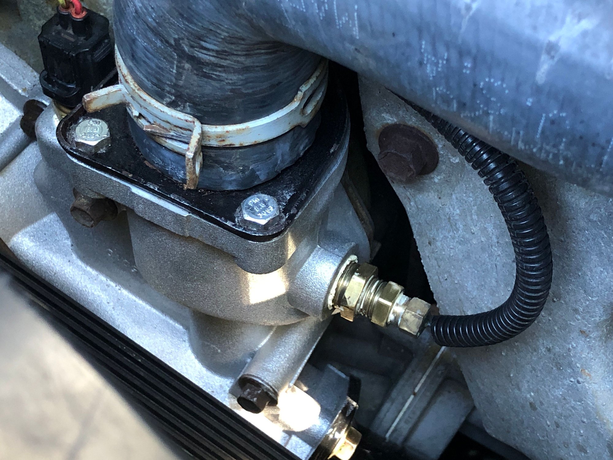

With my aftermarket ECT gauge on average I’m seeing 170-180°.
It will climb above and have seen it upwards of 215° when the clutch fan engages and pulls it back down.
I haven’t hooked up to FORScan to see what value is given there.
Not sure if the motor is running on the colder side or if the gauge is. By the fan engagement I’m leaning towards the gauge being correct.
Recently did the Waterpump, Thermostat, and ELC with no change to temps. I had thought I’d see a climb in operating temperature with the new thermostat. Will have to go back into the receipt folder and find the part # to reference the opening value of new thermostat.
I had always suspected that the old thermostat wasn’t closing properly.
For reference here is the sending unit location.
Is there a better location for the sending unit placement for ECT?

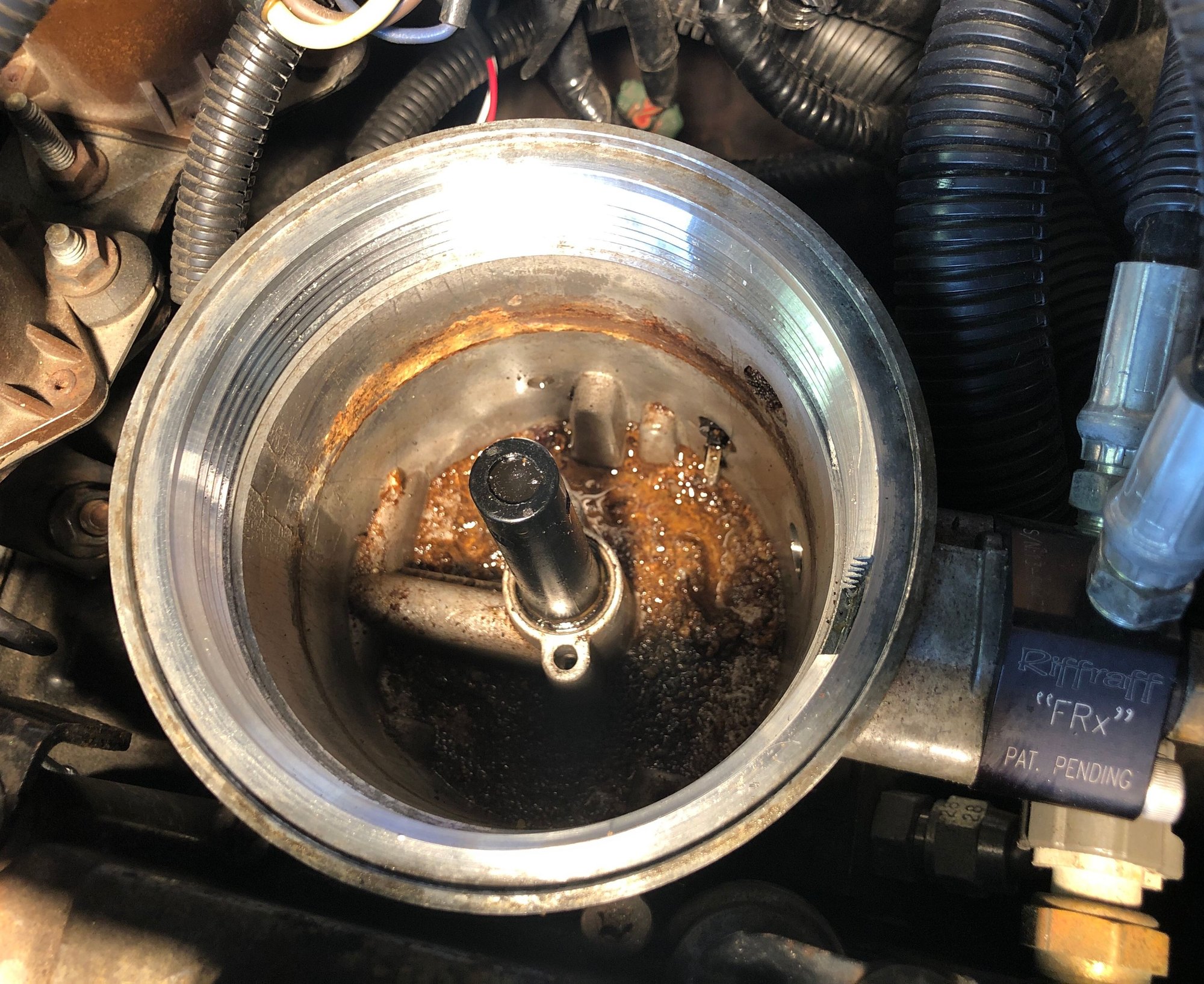

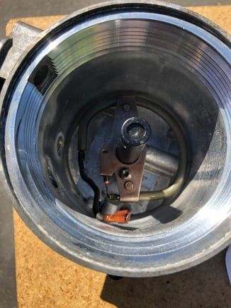

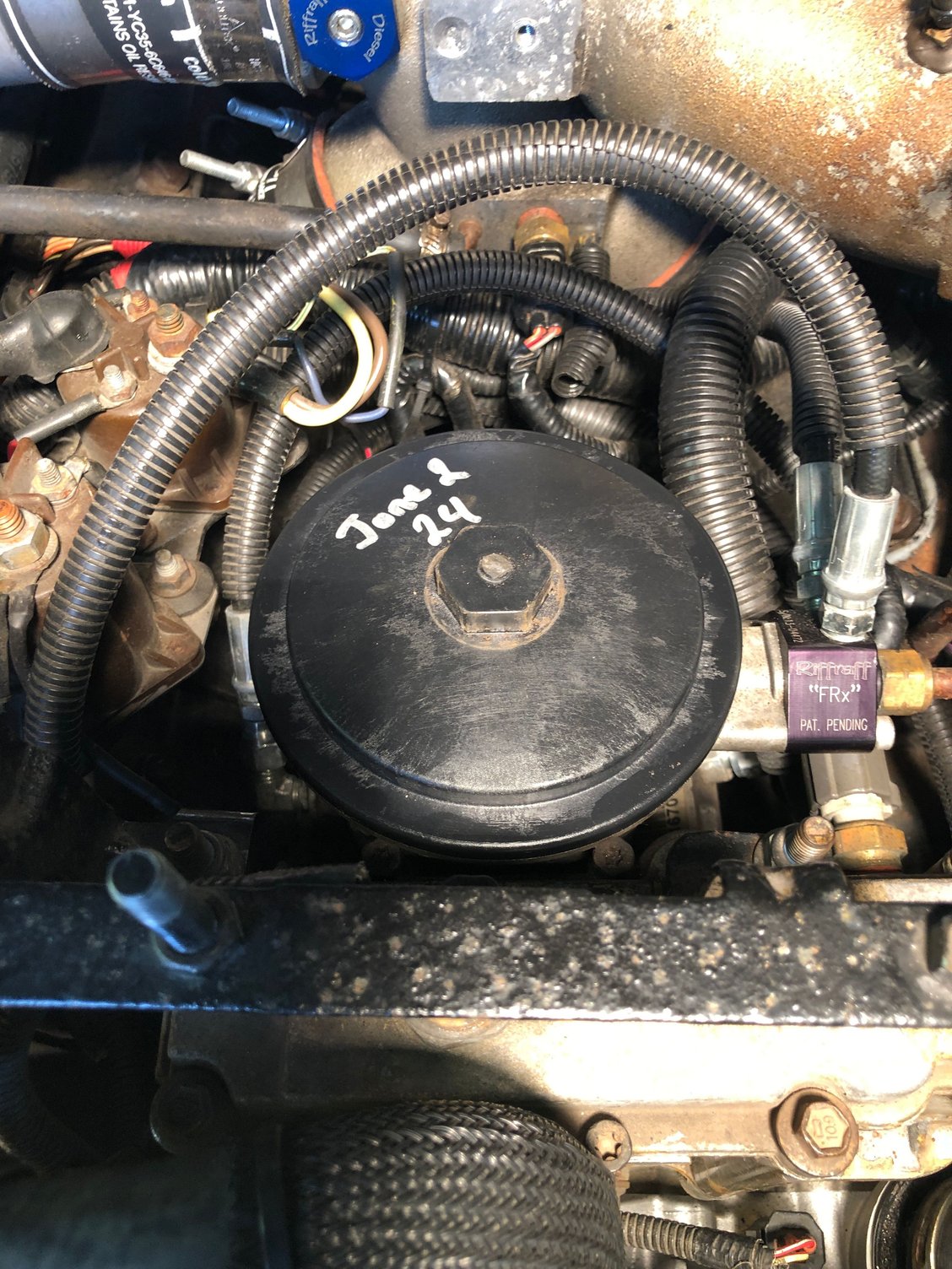

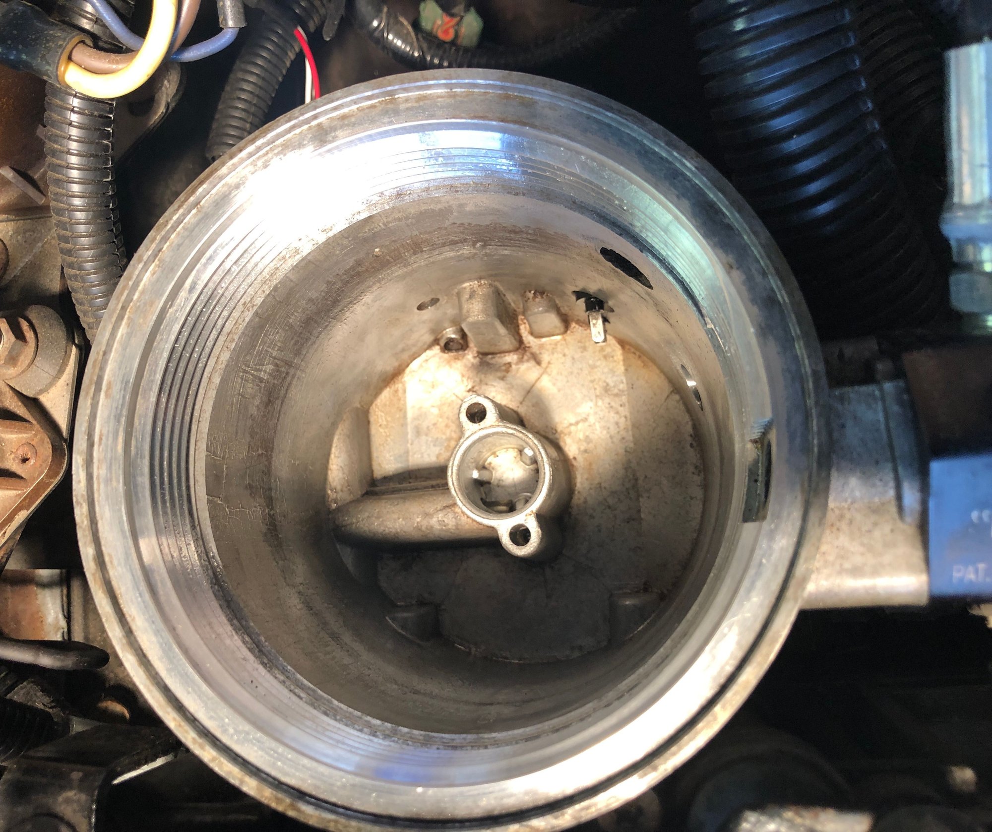

Yesterday was oil change day. Today was fuel filter day.
July 2021 I did a complete rebuild on the fuel bowl.
2021 clean as a whistle after the rebuild.
3 years 6000miles and what the heck is all that sludge from?
Cleaned her out again rags, shopvac, small screwdriver for the tight bits.
It’s alive. Idles at 62psi now up from 58. Haven’t driven yet to see where it drops to but was seeing high 40’s on the last trip.

Well that's not a fun thing to find. Glad you did!
Do you have a pre-pump fuel filter?

Yes, the WIX 33972 filter as recommended by SSJ.
Climbed underneath to take a look and for the most part it’s pretty clean. It was sucking air though and was quickly fixed by snugging up the clamps.

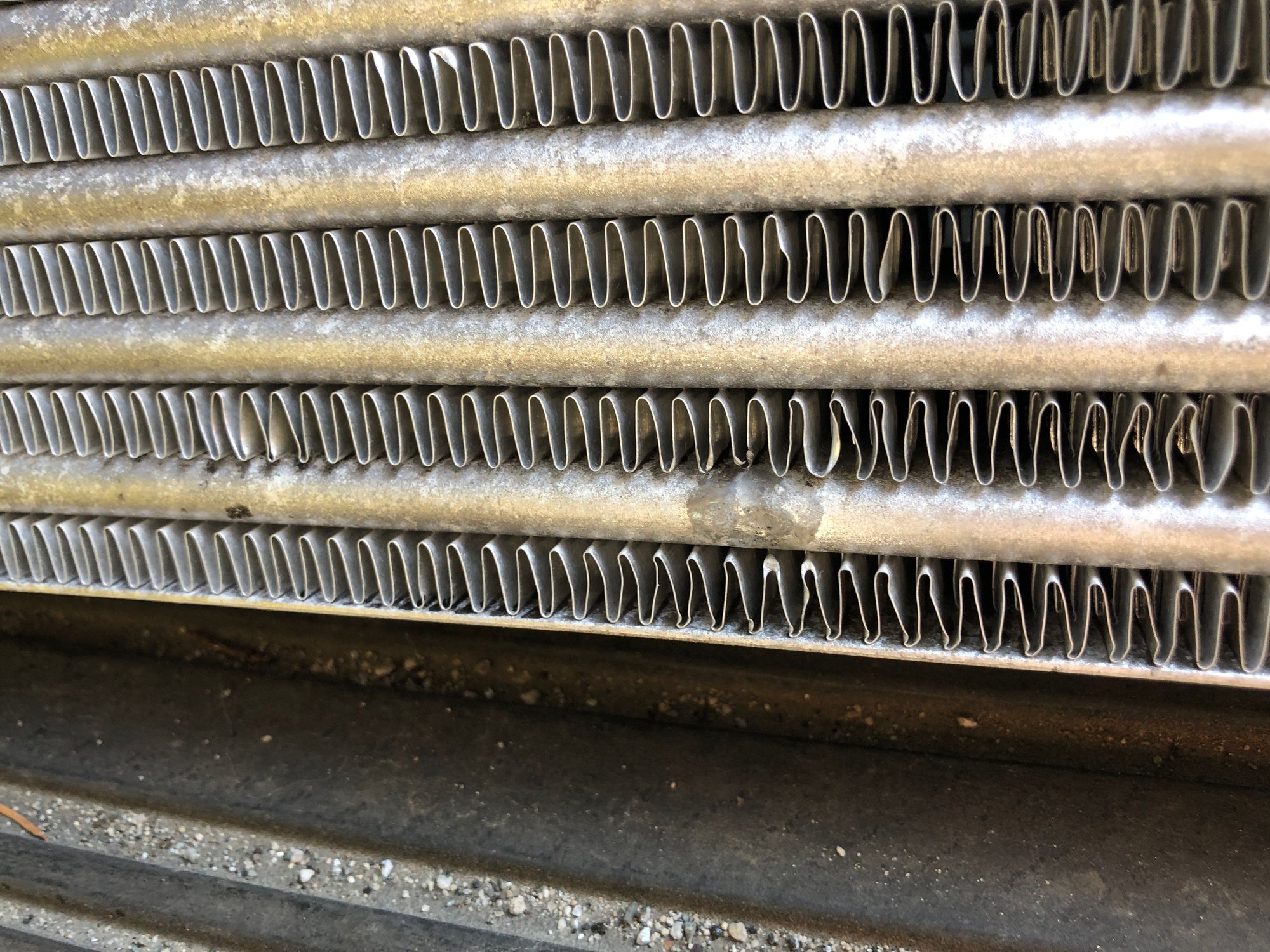

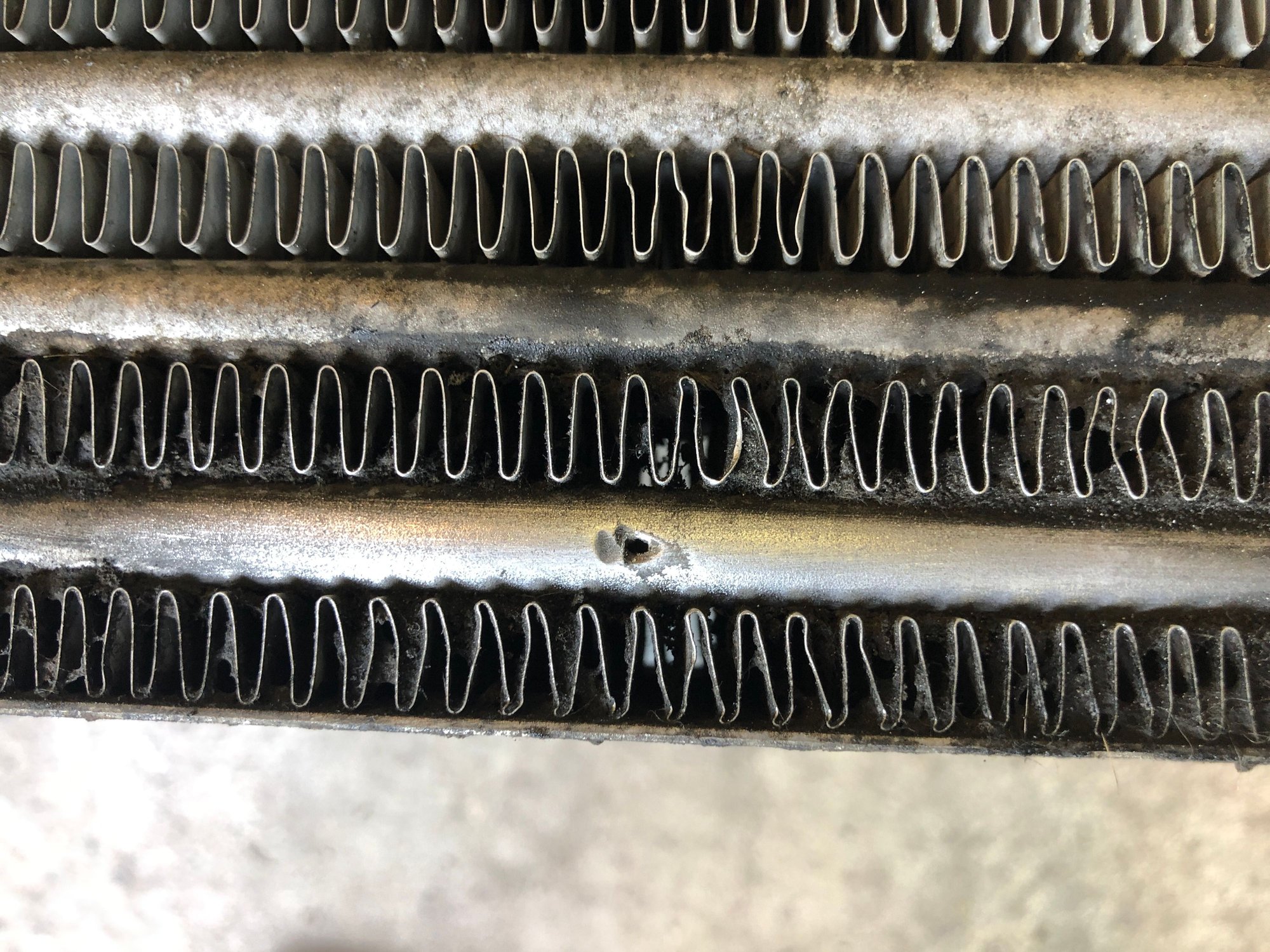

Last trip towing the trailer boost was off slightly so I did some investigating.
Leak in the intercooler on the bottom tube. The previous owner had an aftermarket Transmission cooler installed and the hose clamp rubbed a hole.
Took me 2 hrs to have the intercooler on the floor.
That might bleed off some boost.
Dropped it off at a radiator shop for a spa treatment and repair. $117.00 they washed, flushed, fixed and pressure tested.
Second leak is in my boost gauge line up in the pillar, so that will be replaced next.
