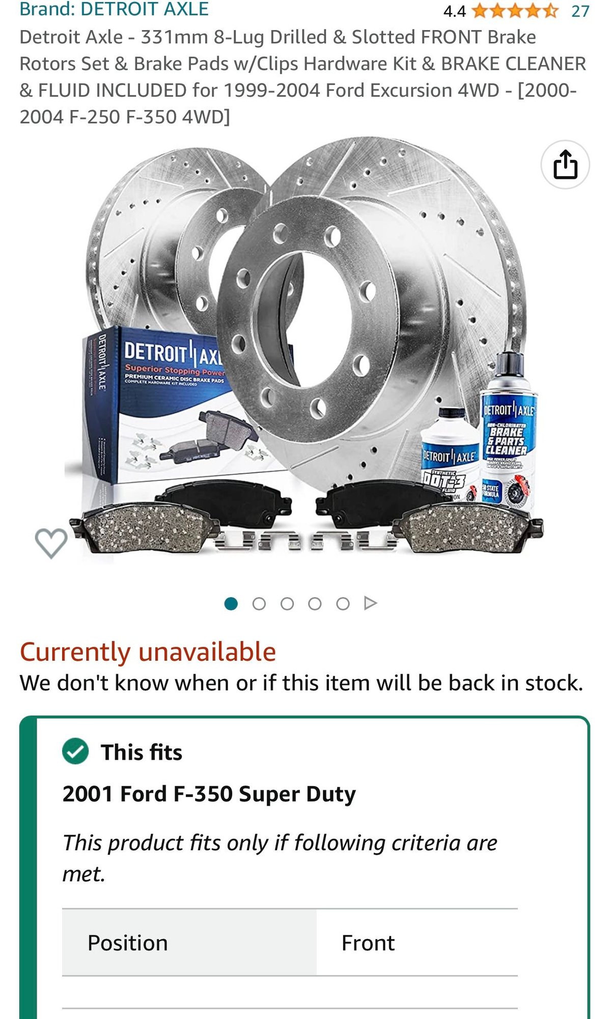

I didn't need the calipers,
and selected these, cheaper than what you got.
Amazon Amazon
https://www.amazon.com/gp/product/B07G7CN5ST/
I put Detroit axle front end parts under my 03 Ford ranger and they are junk. Less then a year later ever rubber boot was already dry rotted and tore. Ball joint tie rod ends. Sway bar bushings all of them. Hopefully there brakes are better.

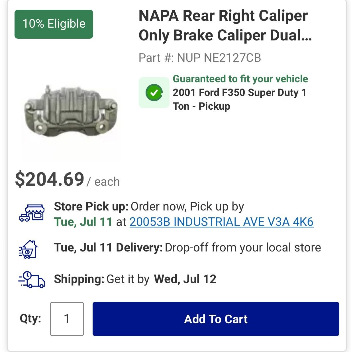

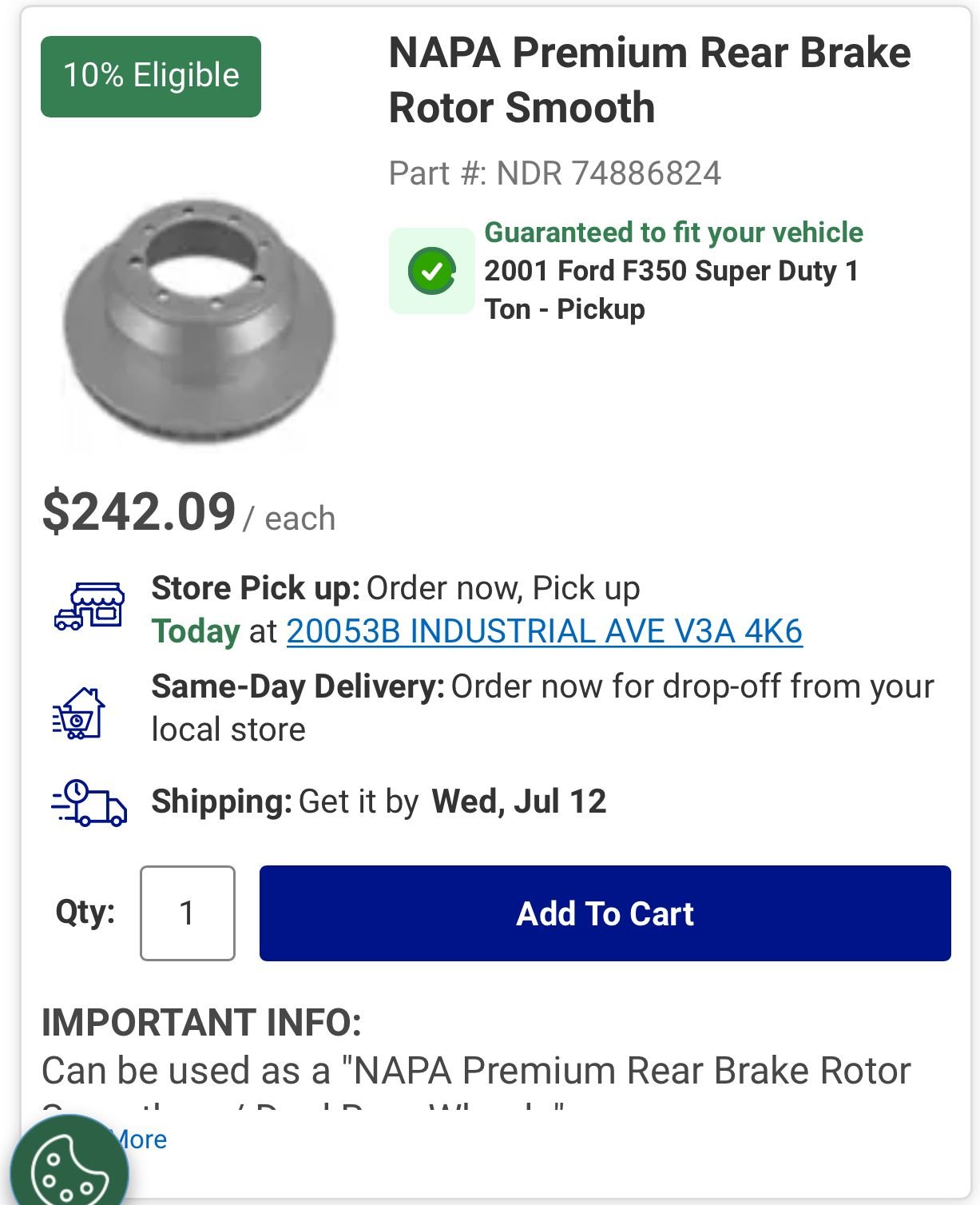

Napa rotors are $242 each plus the 12% for our government .
Calipers are $204 + 12%.
Powerstop on Amazon was $349.00 cheaper. I just did the math. That is significant enough to justify in my head, and leaves enough in my wallet to replace either and still break even.
I know you care, and thank you for your input. I have been forewarned.
I’m not sure what happens when I post a link for Amazon for you guys to view.
When I click a link that you guys down in the lower 48 post up it automatically redirects me to .CA not .COM If you don’t get the redirect from .CA to .COM then you are comparing Cdn pricing to US = 30%ish difference.
Plus you are comparing SRW front to DRW rear, not apples to apples.
Lots of stuff you guys have access to is not available to me. Don’t ask me why. Thanks for the link though.

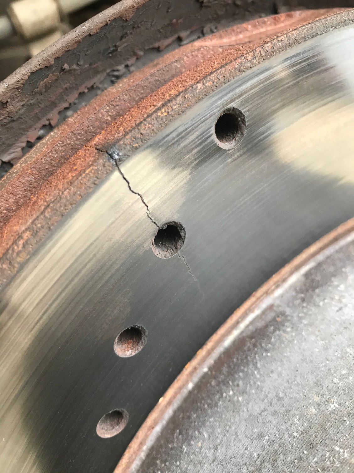

I have been running slotted or drilled/slotted rotors on all of my vehicles for the past 25+ years with good results. Well, until recently...
I installed slotted rotors on the truck with HAWK SD pads. At the same time, I installed slotted rotors on the Subaru with EBC Yellow Stuff pads that I bought on sale for cheap. Turned out the EBC YS pads did not like the slotted rotors.
Pad material started to build up in the slots and cause a vibration between 35 and 45 MPH while braking.
This is the first time I have seen this in all of the combinations of pads and rotors I have installed and run. I went with Bosch Quiet Cast (non-slotted) rotors and pads which were dramatically reduced in price and am happy with the results.
I don't know if the issue was the EBC pads, the size of the rotors or the combination of the EBC pads and rotors, but they did not play well together. Out of all of the no name pads and slotted rotors I have used, this has never happened. The same model of slotted rotors on rhe truck works great with HAWK SD and the previous slotted rotors did very well with HAWK LTS. Clearly there is a size difference between the truck and Subaru parts though, so maybe that is it.
I did like the EBC YS stopping power while installed on the Subaru, but out of all the cross country travels towing our 5th wheel I have found the HAWK pads to be more than adequate. Even out in MT, ID, CO, etc.

Seems that even the big guy upstairs didn’t want me to use the drilled and slotted rotors.
Just cancelled the Amazon order for the Powerstop rotors. I got a message that they are on back order with no anticipated delivery date.
Napa lifetime no molestation rotors are going on with the yellowstuff pads.
@SkySkiJason thanks for the crack kills image.
@Sous you pushed me over the edge with the Subaru fiasco.
