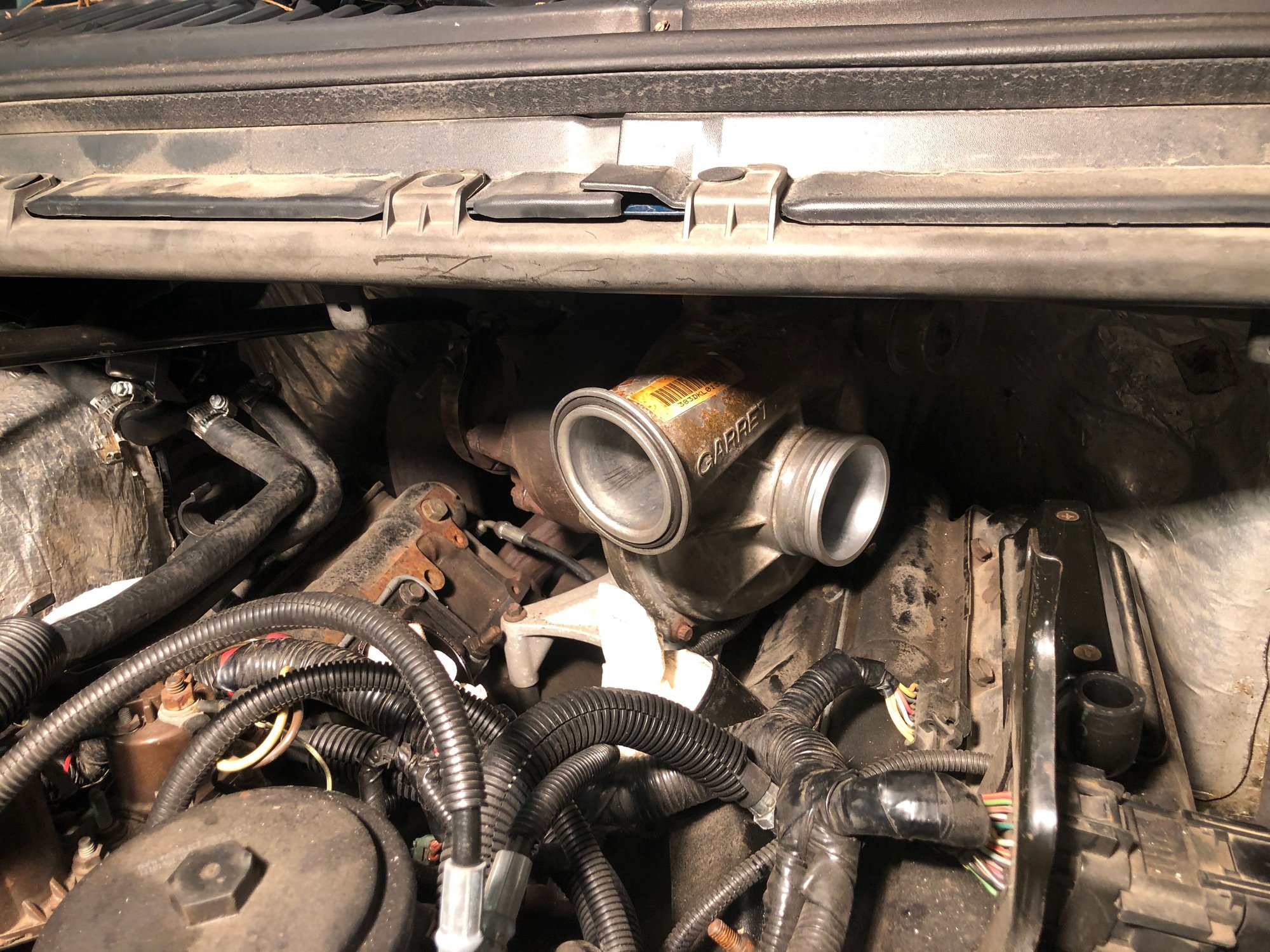

Coming up on time to climb under the hood to get started on fuel pressure gauge install and turbine wheel upgrade with 360° rebuild.
Looking at the crazy crowded valley can I eliminate the AIH relay and move the GPR relay into its place to clear up some space for the fuel pressure sending unit? Already have deleted the AIH and have Clay’s code eliminator.
Seems easy enough but am I missing something.
Went to the tech folder and the only one for GPR relocates to the inner fender.
It has been a while since I’ve had a close look in there but may be able to cut down the mounting bracket to make even more room.

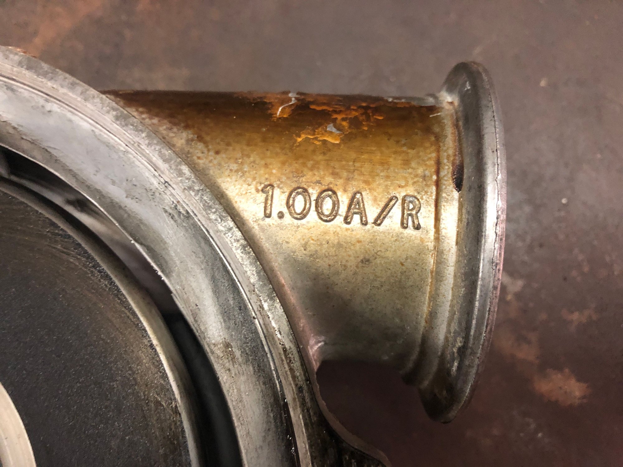

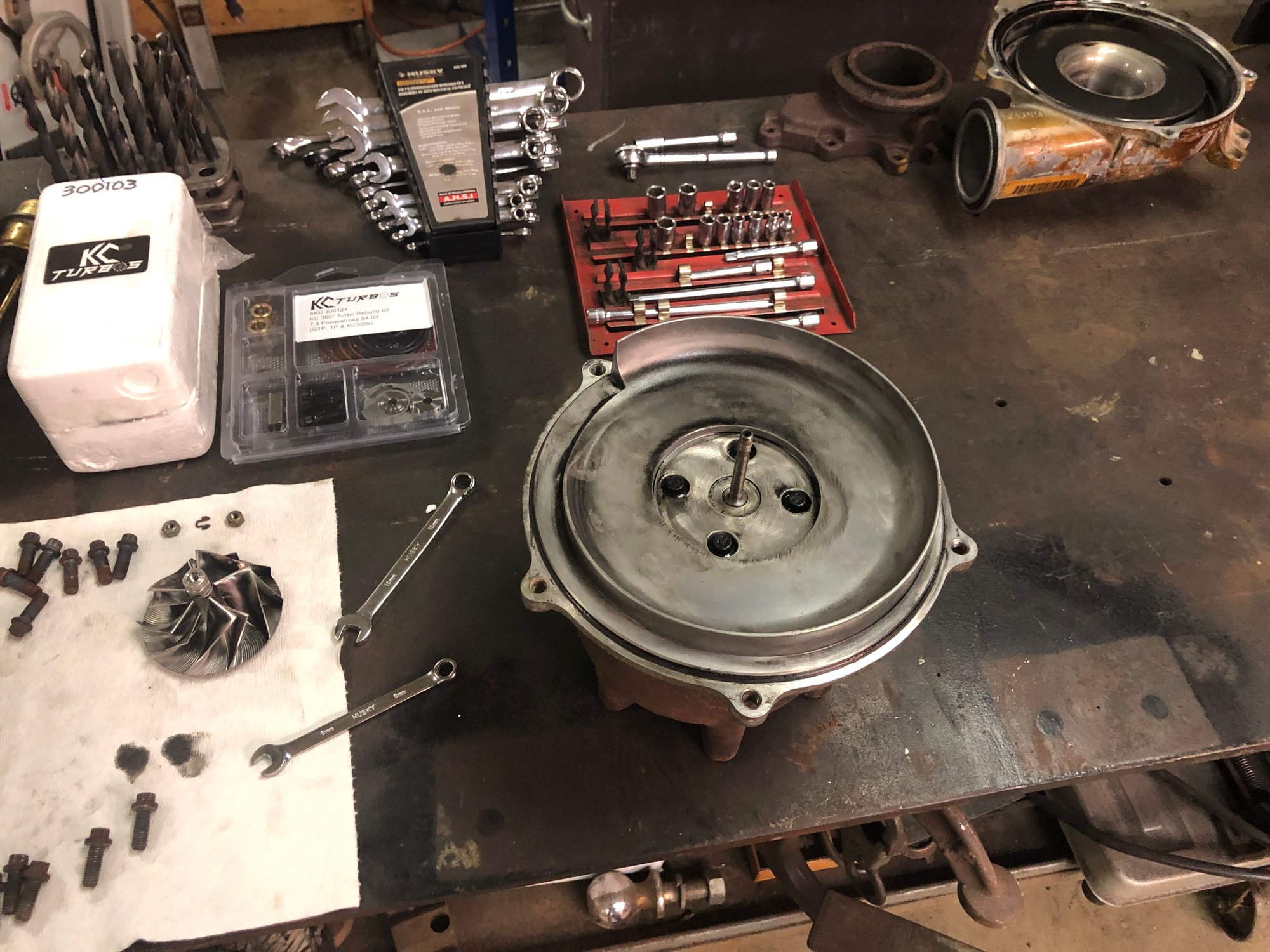

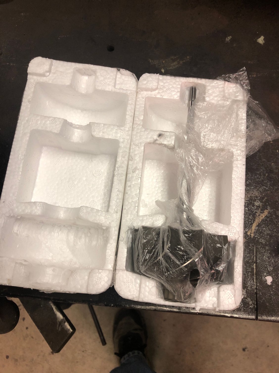

The fun has begun.
Turbo is out and on the bench.
I have an 8mm 12 point wrench so have the turbine and compressor housings off. Wheel is on the bench. Need a 8mm 12point socket for the next step. Wrench won’t do the trick here.

I thought that styrofoam packaging around the KC part was a fluid reservoir at first.
Old Feb 10, 2024 | 10:15 AM
  #776
F350towing's Avatar
F350towing
Joined: May 2020
Posts: 2,936
Likes: 2,198
From: Langley B.C. Canada
Turbine wheel.

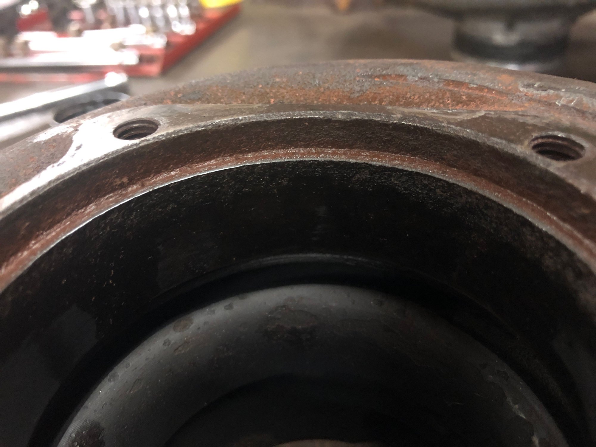

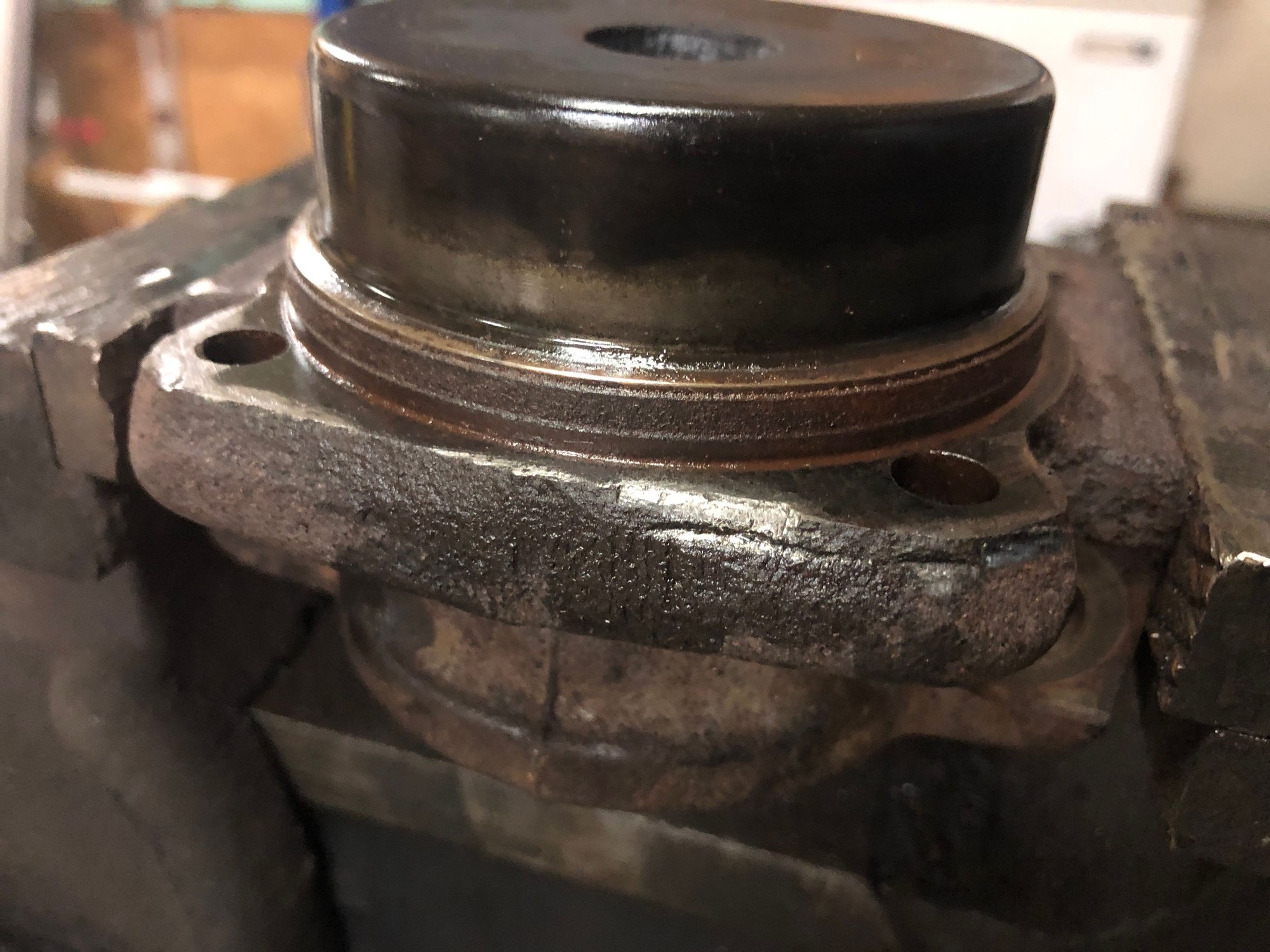

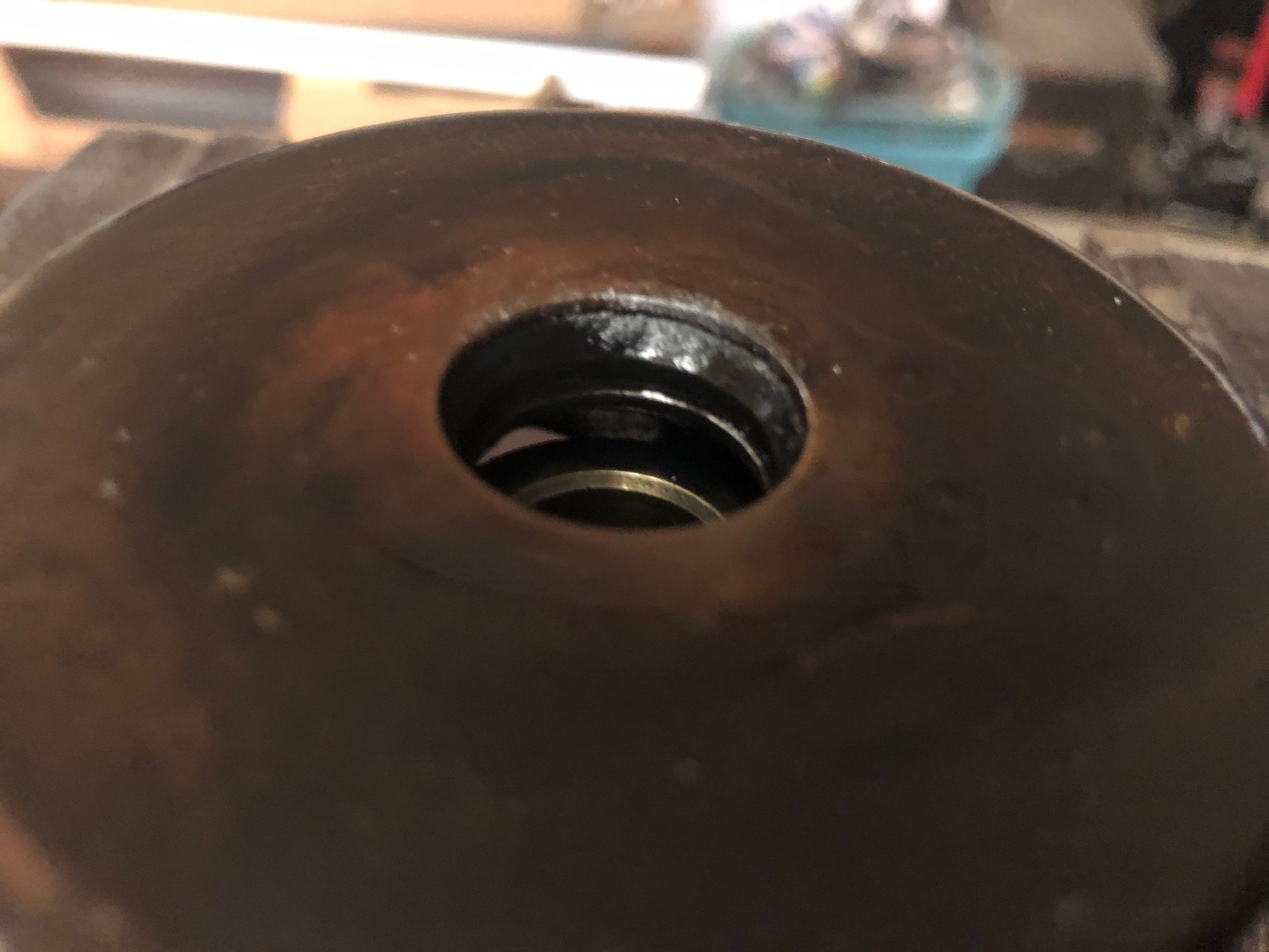

All bolts are removed now. Had to buy a 1/4” drive so it would fit inside the centre section to get the lower bolts on the turbine housing.
How difficult should it be to separate the centre section from the housing. 1/2 hour now and no movement. Prying, wedging, dead blow hammer, heat. Hasn’t moved at all.
Old Feb 10, 2024 | 08:01 PM
  #778
F350towing's Avatar
F350towing
Joined: May 2020
Posts: 2,936
Likes: 2,198
I Beat the crap out of it, mindful not to damage the housing, then ended up using a chisel to get them apart. There is maybe 3/16” lip on the centre section pressure fit/ rusted into the turbine housing.
They almost don’t even have to come apart if it wasn’t for the oil seal groove that needs to be cleaned.

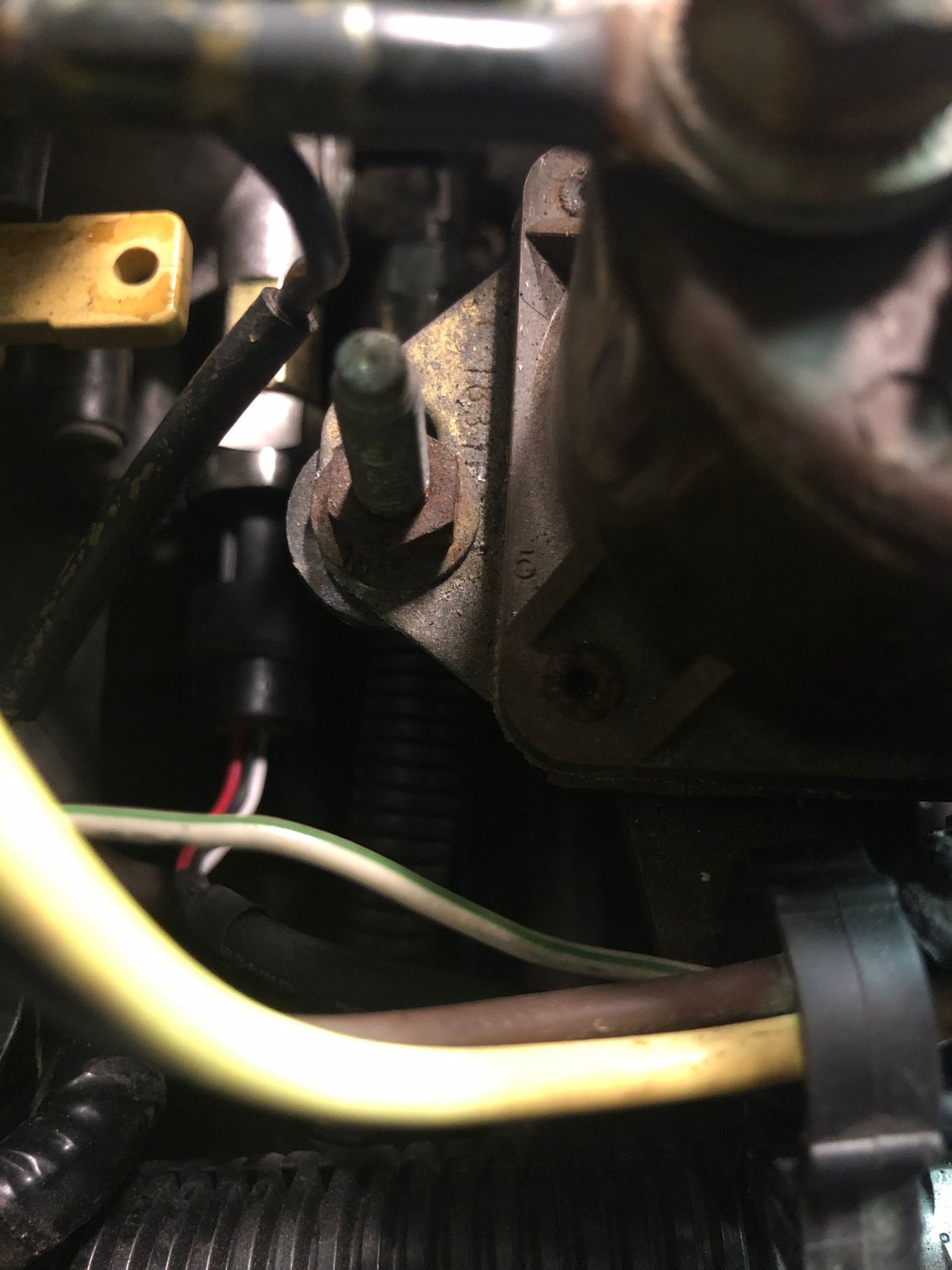

Turbo is back together and in the truck.
Fuel pressure sending unit is installed.
I was worried about the AIH relay in the way. Not a problem. Fuel line to back of head was more the headache. Can barely see the shiny bit down there.
Wiring is run into the cab.
Pushed that through the same grommet as the 2wd low wires and the ranger valve.
Lunch break is over. Time to go finish up the gauge install.
