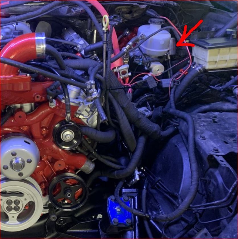

Can you please give me the part no. / manufactor no. of the hydraulic oil inline filter? I only find fuel filters for 9.5mm hoses

Hartwig it is a Magnefine power steering fluid filter 3/8” hose which is close enough to 9.5mm to fit.
The engine is purring like a kitten, no more leaks of any kind except the air conditioner condensation drip. I have been working the last 7 days so not driving it much. I’m at 145 miles!

I'm glad to hear that the girl is marching. But there was a leak in the pressure regulator?
Thanks, I'll have to find something similar from Germany. The shipping to D is more expensive than the filter itself
or this one?
https://www.rockauto.com/en/moreinfo...71118&jsn=2109
