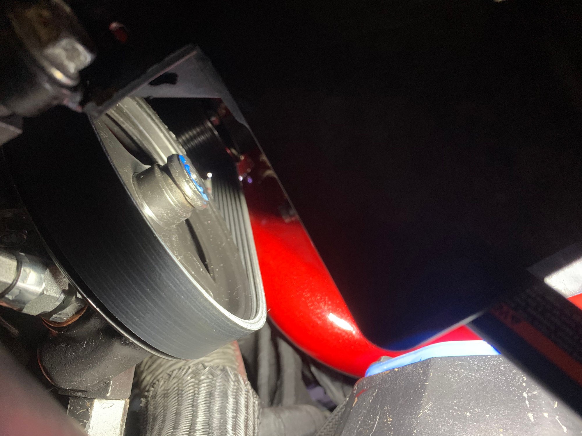

Come on guys, you’re killing me. I don’t need to know how to change the pump, I did that already this morning...and I don’t have the stock lines or fitting in the pump, I have the braided hoses and straight fitting in the pump. I know how to change the pump. I am asking if anyone has had a Ford pulley that is narrower than the belt by 1/8” and also about 1/8” closer to the engine side than the rest of the pulleys causing a misalignment of about 1/4-5/16”. The pulley install tools bottom out when they are fully seated, you can’t press the pump on the shaft further than it should be. I should have taken pictures, I didn’t think it was worth the trouble but I will take some in the morning, it might help some other poor soul searching for “Ford pulley narrower than belt”.
I’m going to take this POS to NAPA tomorrow after I remove the whole unit and take my other good pump and the OE pulley.

When I changed mine I got a Ford reman from Ed and swapped my pulley over.
The odd size pulley on your NAPA reman could be one of two things.
The supplier screwed up and put the wrong one on.
The person that turned it in has done something odd that needed the smaller pulley.
Then NAPA supplier did not check to make sure it was the correct one.

As I said, it’s a rebuilder issue. Other Ford platforms use different width pulleys and pulleys, that can have different setbacks. The rebuilder installed the wrong pulley.

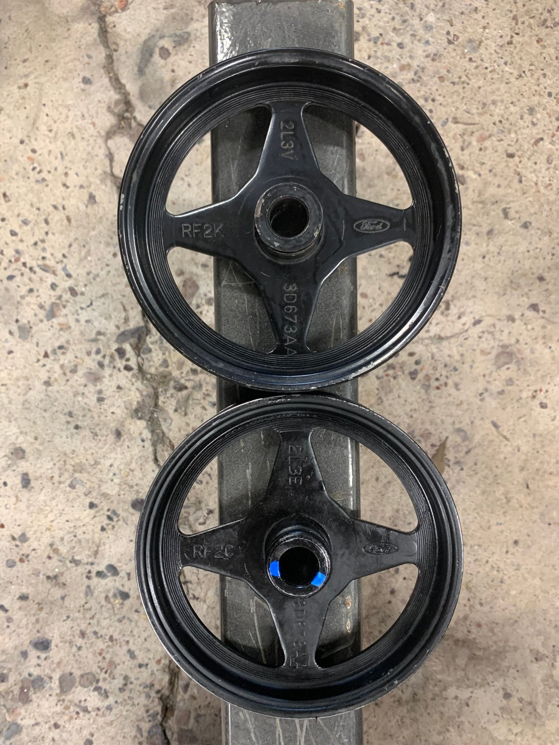

Already swapped the pulleys. I know how, that was not the question. Anyway, they had the same Ford part number but different last letter on the 4 digit code.
The one with the blue tamper mark is the wrong one from Napa. Just FYI later, note the number code differences.

"they had the same Ford part number but different last letter on the 4 digit code. "
Yeah, that's not the same part number then. The same year, and it's a pulley, it ends there. That 4th digit represents the platform level, ie F-150, Superduty, Escape, etc.
What was installed was a 6 groove pulley, the Powerstrokes take an 8 groove pulley.
