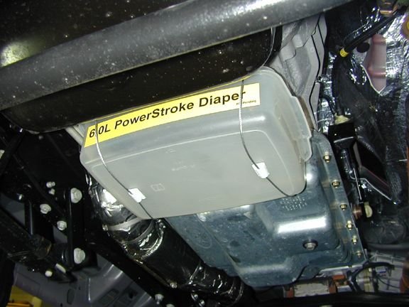

Jack that is too funny! I knew I wasn’t the first to think of a drip pan! No, I didn’t flatten the pan before putting it back on, I didn’t know that was something I was supposed to do. Please elaborate.

“The Ultimate 6.0 Accessory!” 😂
Jack, you are a funny dude!

Sometimes I was asked about the Harley exclusion, and like Hatwig’s Land Rover, I would say if it’s a Harley Davidson Edition, it should be designed to leak.
I’ve have a video posted about salvaging my oil pan, with its condition you would have replaced it. The flange lip distorts from the gasket bolt-up so it never achieves as tight of a seal, and probably less on a second bolt-up. I hammer flattened the pan’s flange, used the RTV, and welded up a reinforcement to prevent the distortion. I can't say if an after the fact reinforcement would seal the pan better, I don't know year if it worked.
International should have designed the sealing of the oil pan like what is done for the valve covers and transmission pan, flat gasket using standoffs at the bolts to ensure designed compression of the gasket; it would have sealed without distortion. They knew the concept for the valve covers, they are both a laminated design, probably both from MSC. At the time I was also thinking about doing away with the o-ring seal altogether and just using the RTV as we do with the differential covers.
