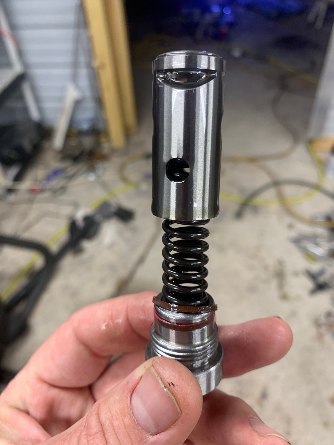

I removed the new oil pressure regulator and found the o-ring was cut even with me using assembly lube during installation. I checked the cylinder for scoring and it was perfect. I compared the springs and the old spring was about 1/8” longer than the new one which was odd. I would believe it being longer would hold back more pressure so I installed the old spring with new cylinder and new o-ring from another oil seal kit. I drove it 10 miles on the highway getting oil temperature up to 200 degrees (new 200 degree Mishimoto thermostat) and came home to find only one drop of oil on the regulator head. I degreased the engine with Dawn and hot water in a spray bottle, let it sit and then pressure washed it and went for another 15 mile drive and immediately pulled in the shop to inspect and not a drop of oil anywhere.
I have a hard time believing the o-ring was leaking by and causing oil to get behind the harmonic balancer pulley on the seal. I honestly thing Sean was dead on when he text me last night after our discussion and asked if I had checked my low pressure oil pressure. I still want to install a gauge to monitor base oil pressure soon. I’m about to go drive it some more and run errands then come back for further inspection. I ordered a new LPO pump front cover, crank seal, crank pulley bolts and regulator o-rings to have just in case...
Thanks for the idea Sean, I think you might have figured it out. The regulator spring was allowing the pressure to get high enough to push oil past the front crank seal. That’s all I can think.

O-ring as it came out
New regulator spring on the left, old one on the right...the old one is longer.

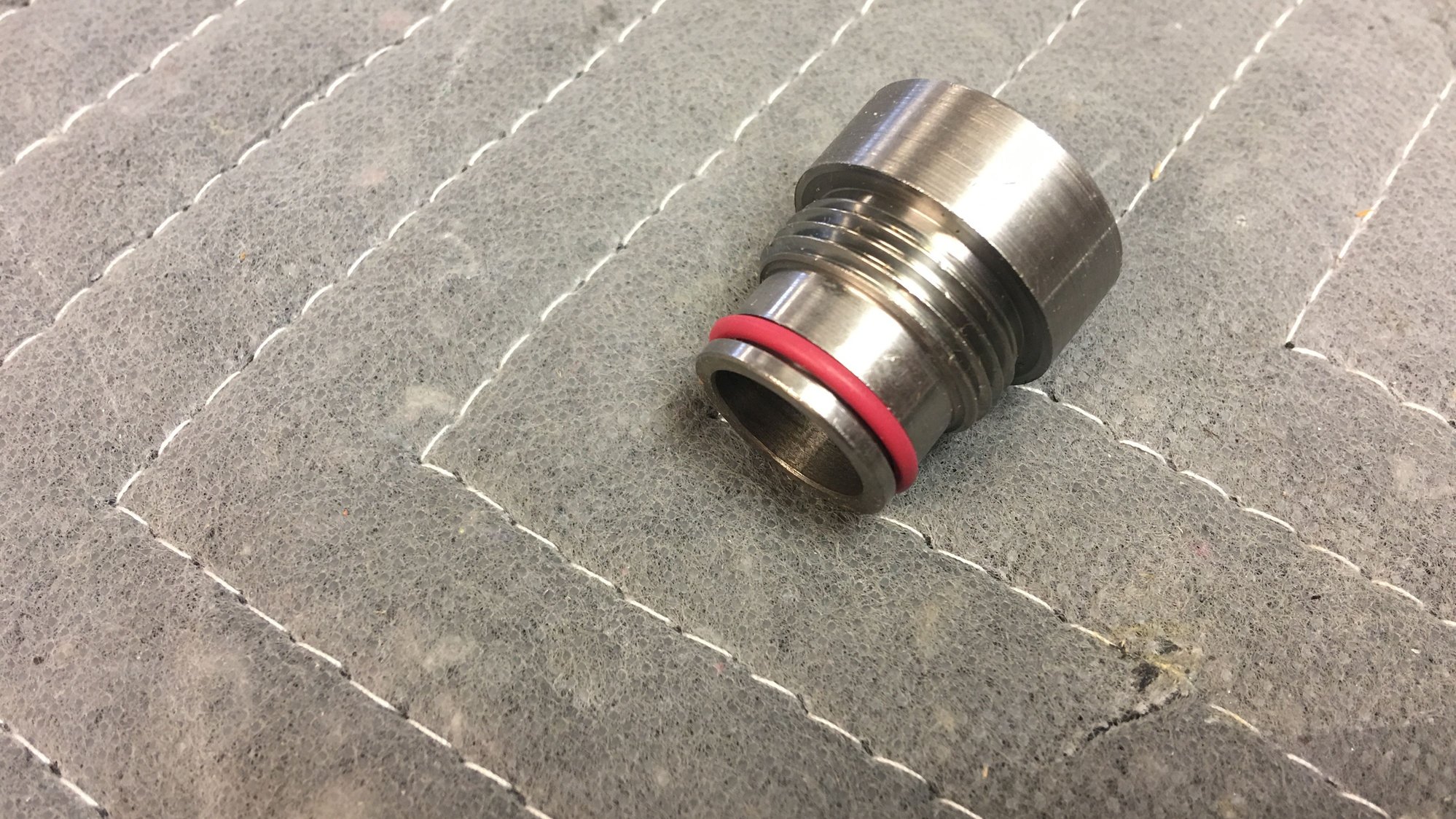

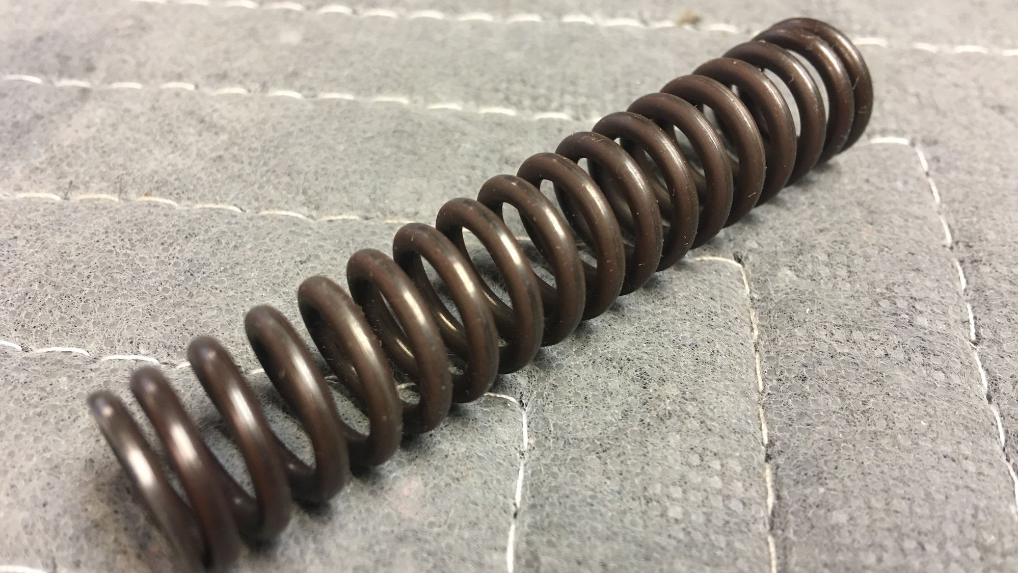

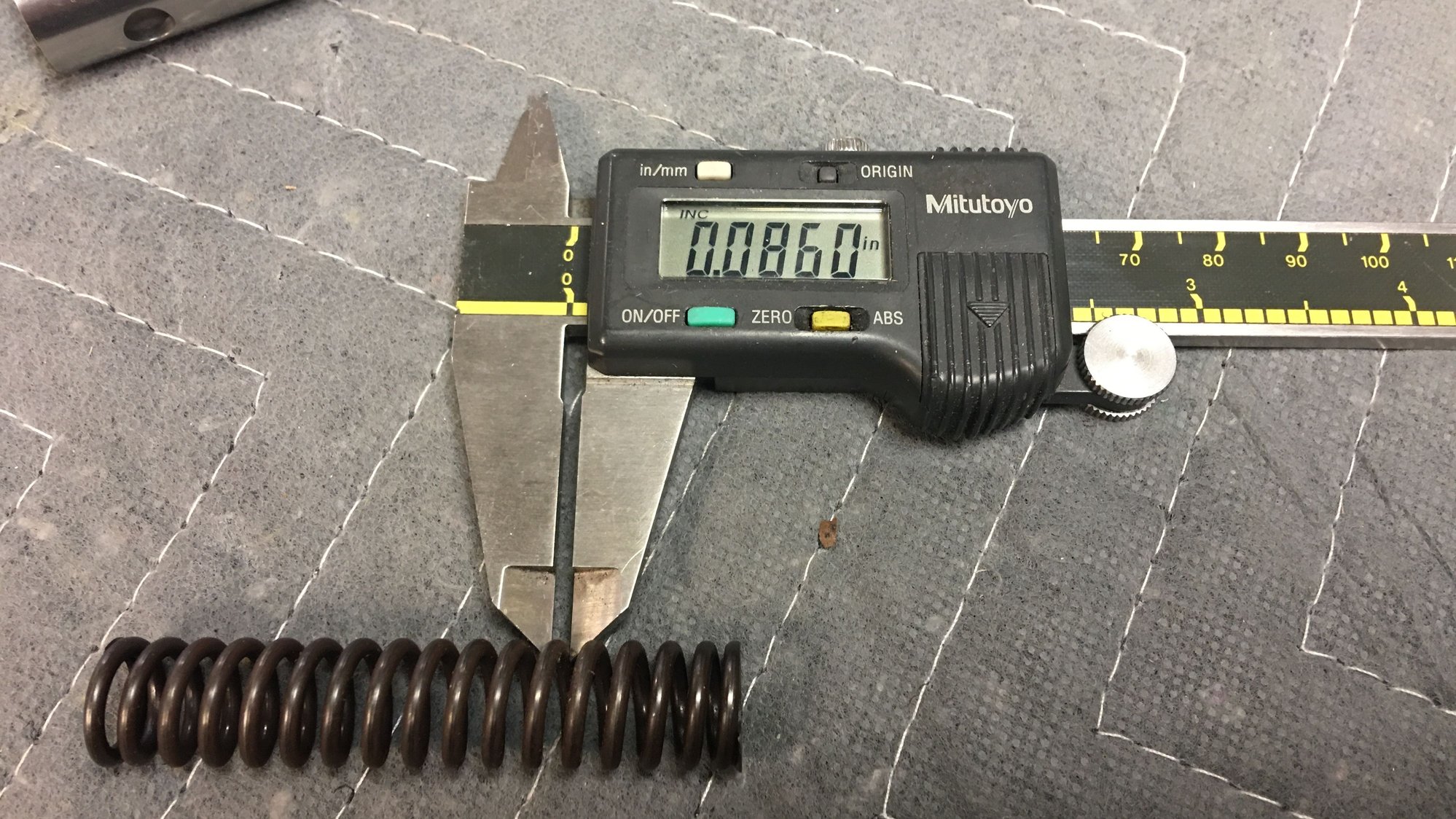

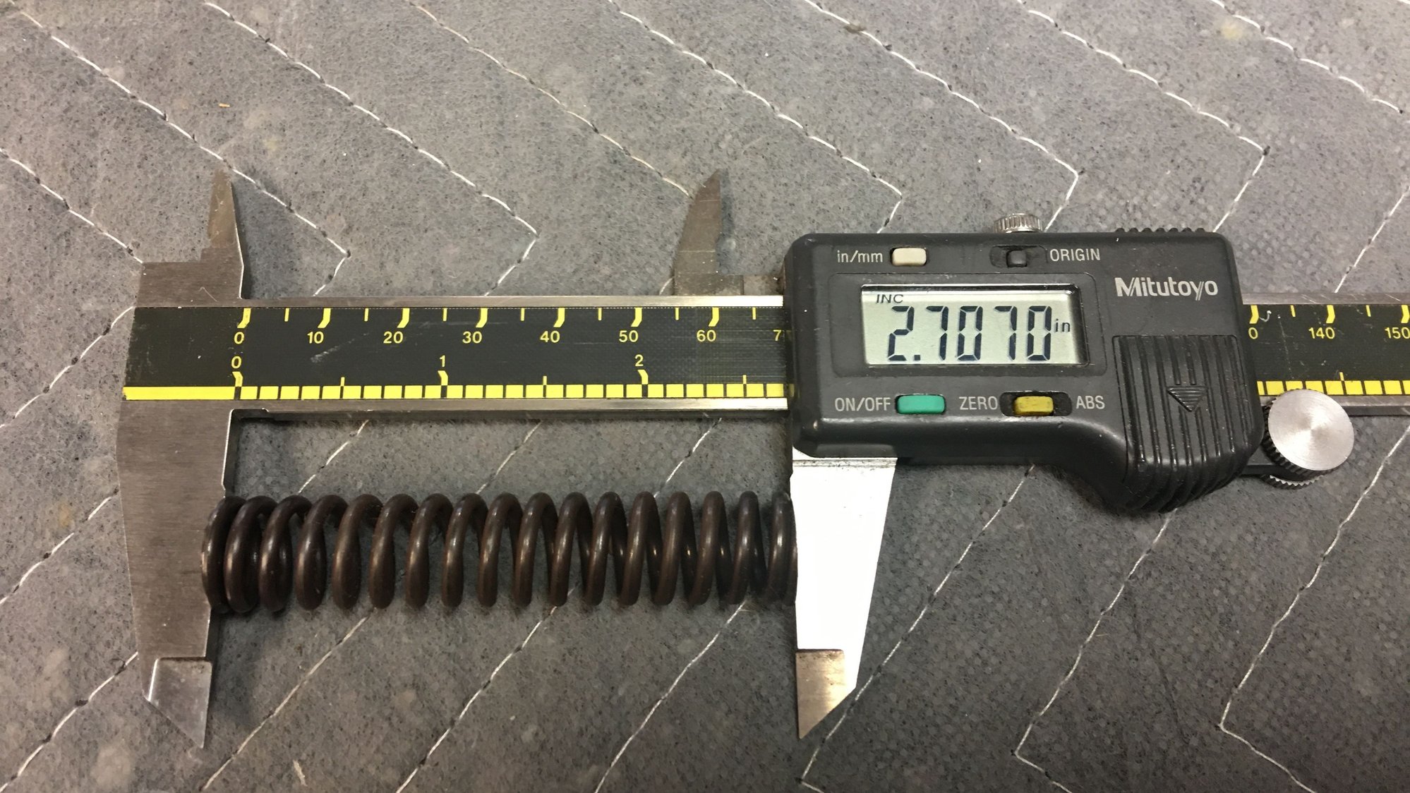

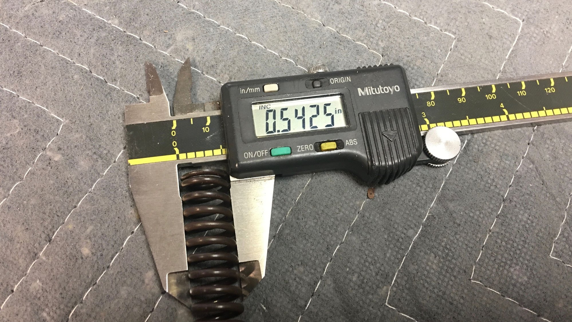

Old Mar 16, 2020 | 05:19 PM
  #450
SmackDaddy's Avatar
SmackDaddy
Joined: Sep 2016
Posts: 3,941
Likes: 240
From: Texas
Very interesting, thanks Jack! I will get my cheesy micrometer out later and inspect the new spring. Either way, swapping the o-ring and using my old spring seems to have mitigated the leak. I could see someone else seeing what I saw and just replacing the crank seal and having the same result after. That could get very discouraging. I’m going to keep an eye on it over the next few runs. I have four of those red o-rings on the way and I will swap it when they come in.
