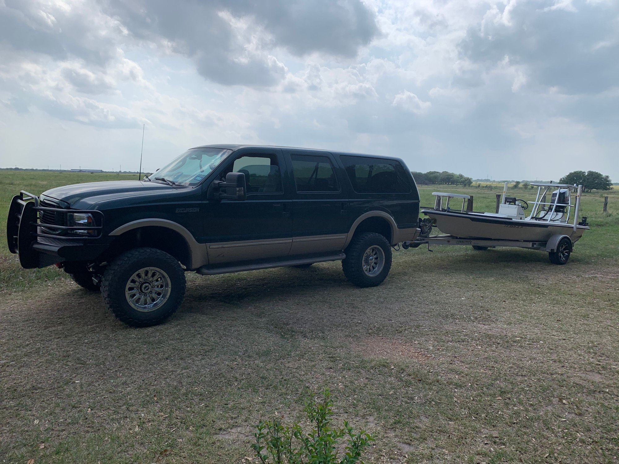

Last Monday I hit a thousand break in miles on DBR oil so I changed oil and filter and got to tow my boat and open her up a little. She ran like a champ but the new cam wants something. I don’t feel like the turbo lights off as it should so I gave Gearhead a call and had them rewrite my tunes for the upgrades. I’m having some taptop compatibility issues so I have not been able to load and run them yet.
I think I need a bigger boat...

My friend, your trailer needs bigger wheels. If you want, I can build you a trailer that's appropriate for your class.

15” wheels are perfect...there is a reason my trailer is low profile, so the boat comes off and floats without having to back the truck into the water. C’mon man!
