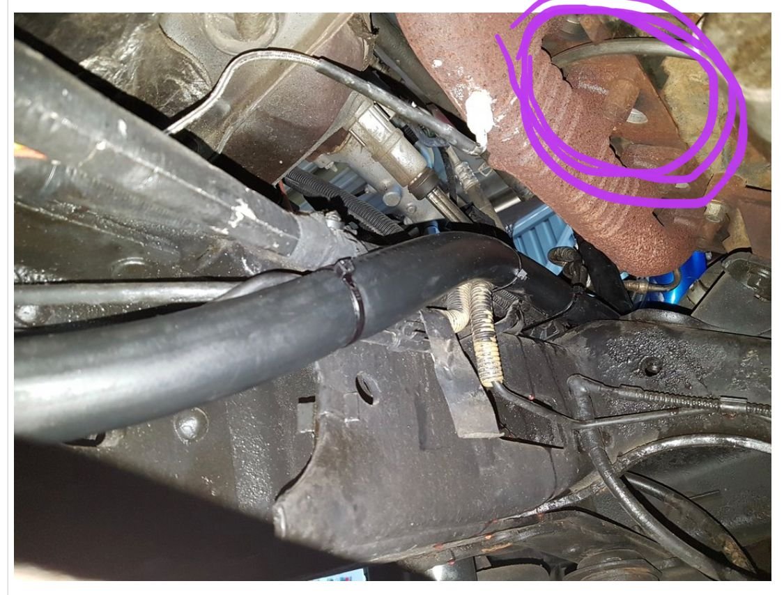

What do you mean, brother? How should pressure be created in the hose? Or have you narrowed the diameter at one position? In my truck it steams out of a hose behind the transfer case

The drips have always been there though, long before the CCV reroute upgrade....whether the engine needs a vacuum to be "tight" I can't say.
