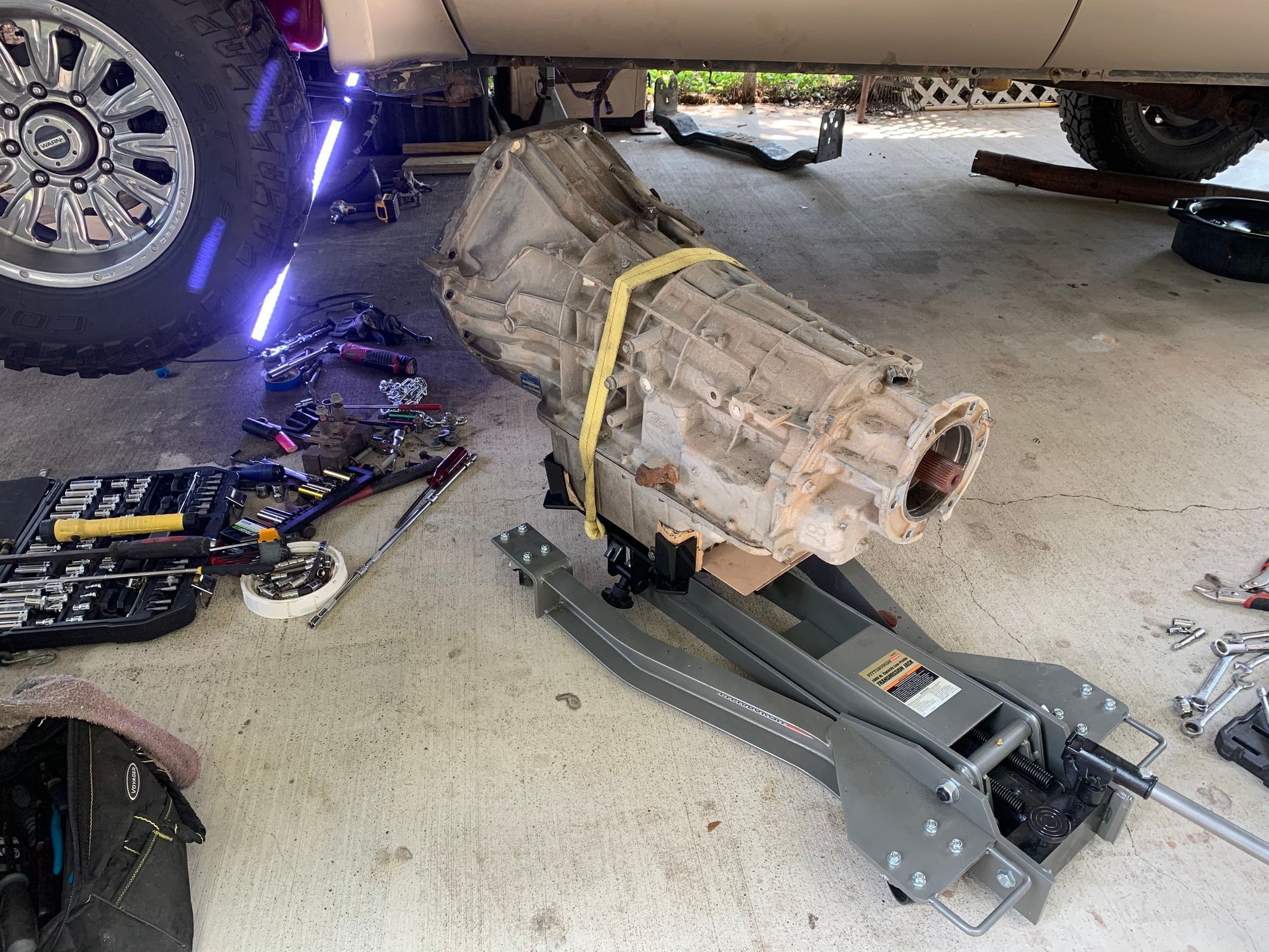

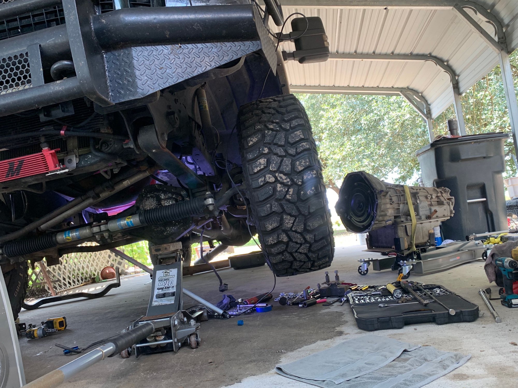

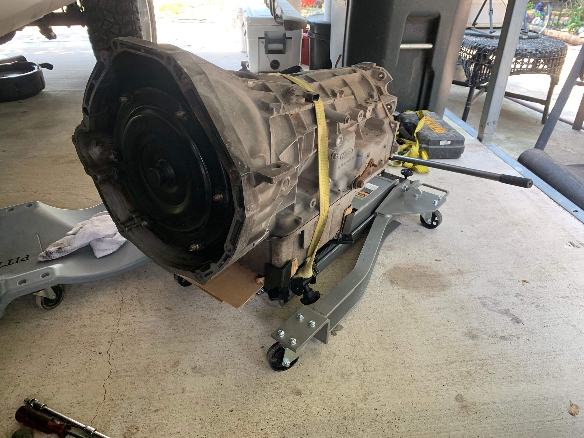

Sorry I never got around to taking photos and posting the transmission install but I will get some more. I’ve been busy with family, working two jobs and all that. I have about 1200 miles on the transmission and had to get Warren to write my tunes because Gearhead could not get them right. It seems this is an issue between them and Warren transmissions.

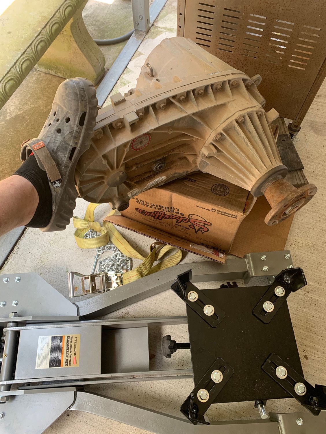

Transfer case drained and out. The fluid was beautiful clear amber like fresh honey still!
Had to jack her up high to get the transmission to clear
I hate Chineeze junk but HF transmission jack for the win...

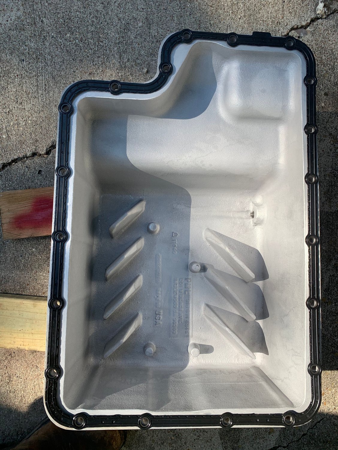

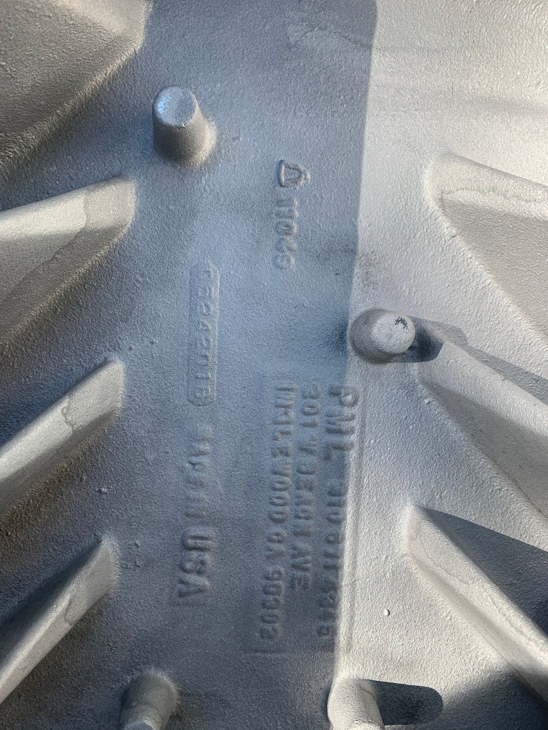

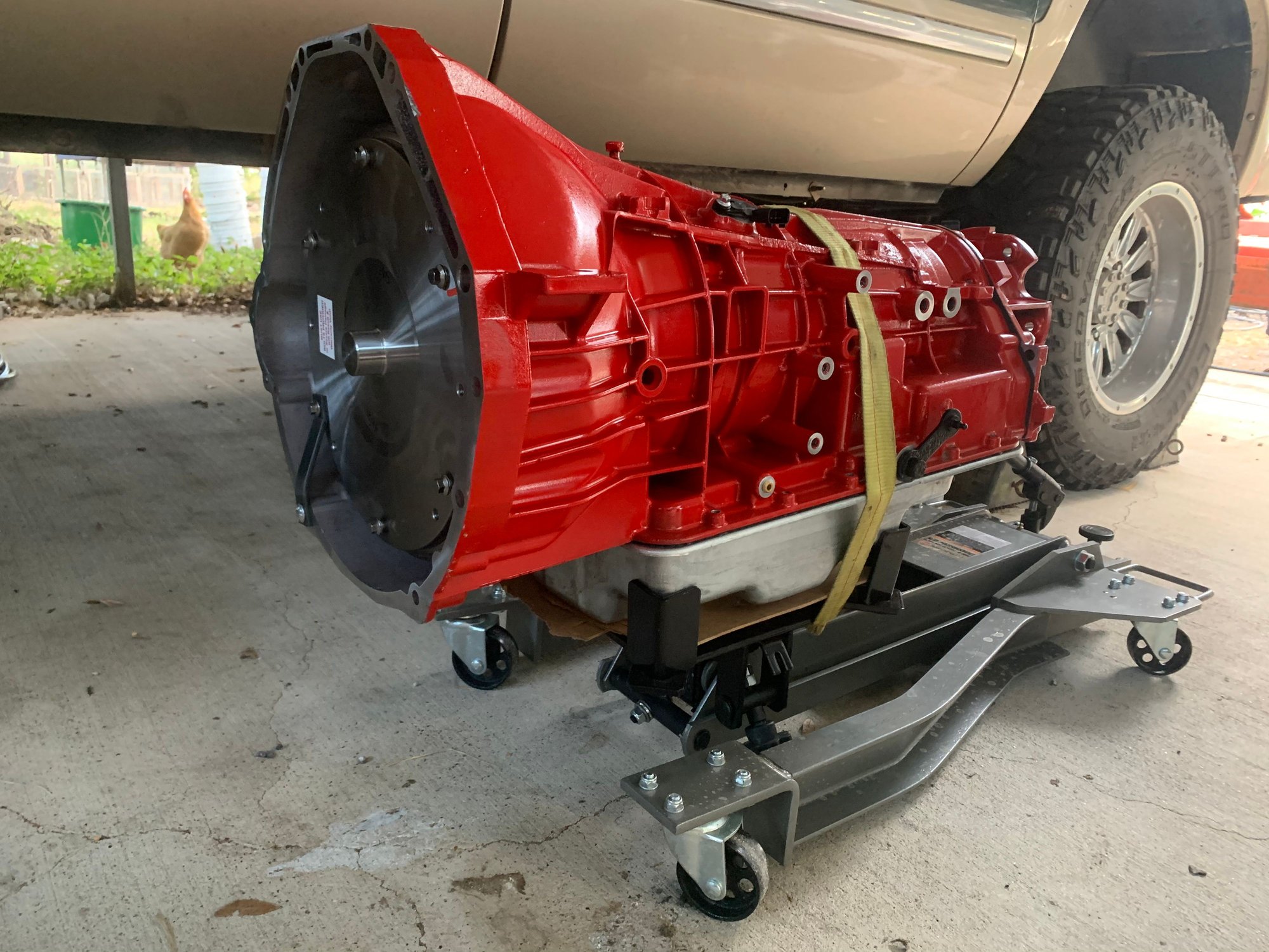

Heavy sucka with the PML pan

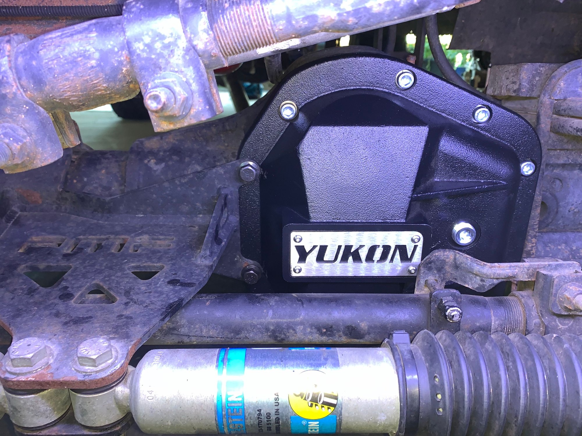

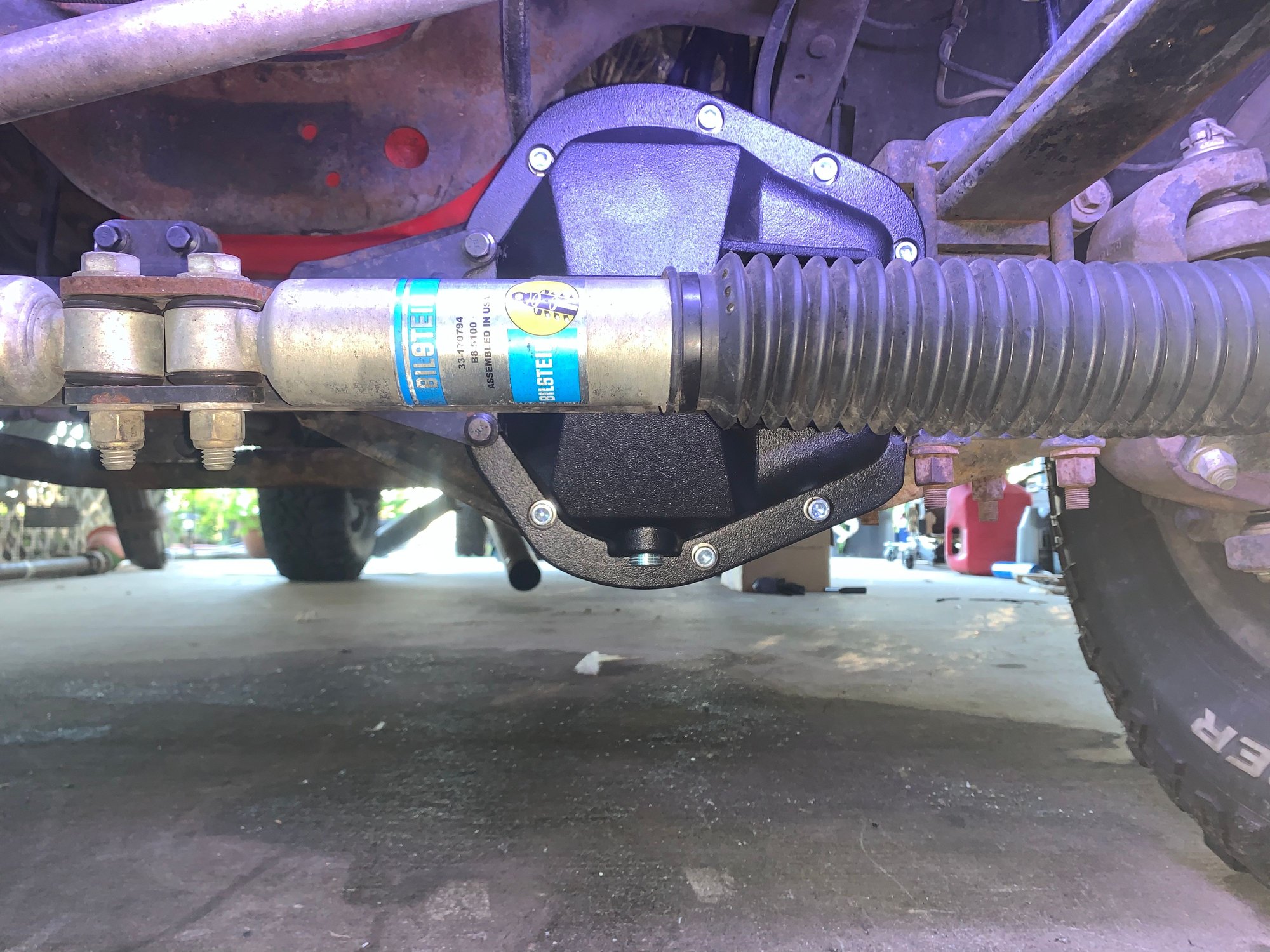

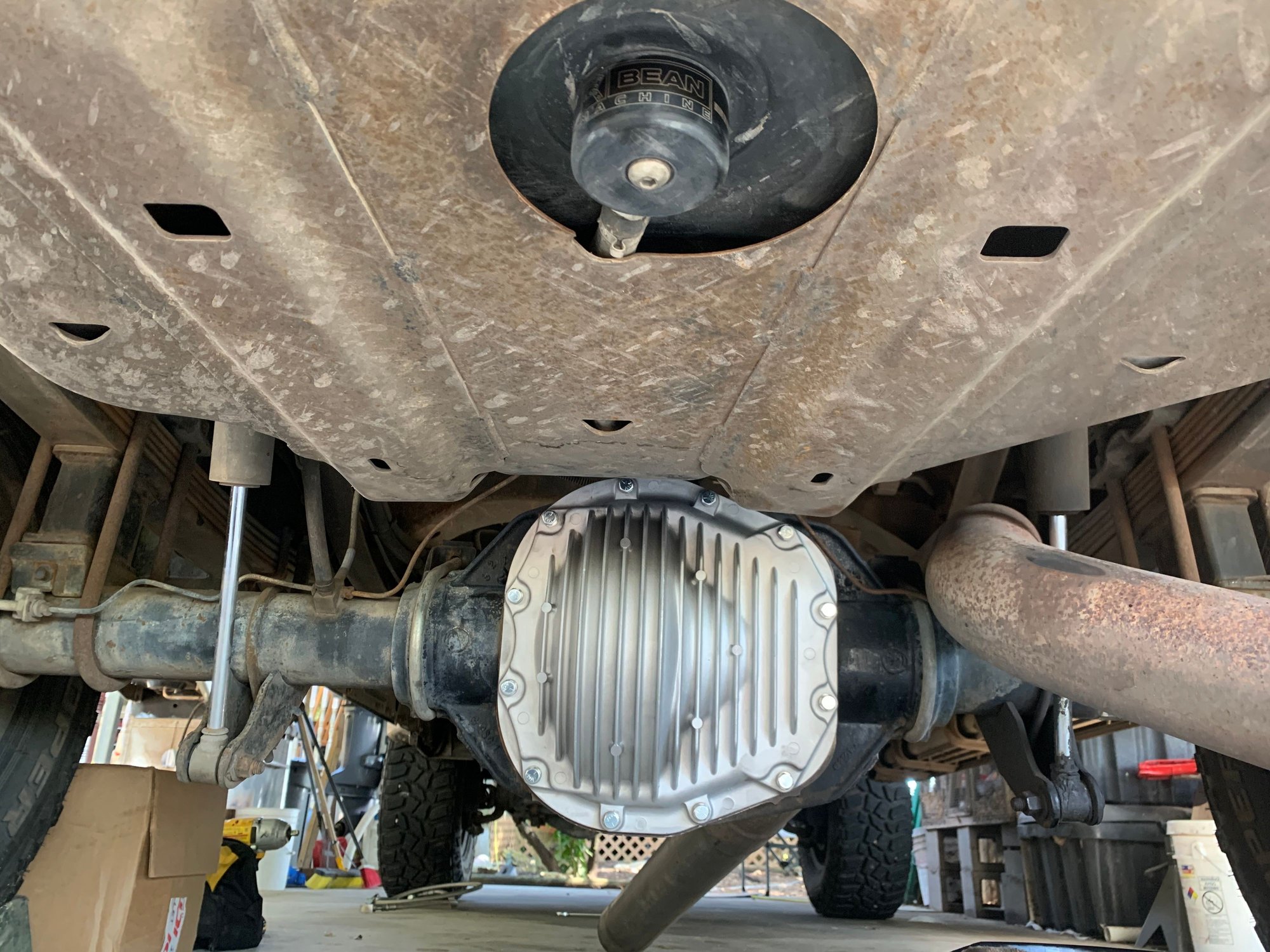

Cleaning/servicing rear end. Upgraded Yukon aluminum diff cover and Mobil1
Oooooo shiny!
Beefy front diff cover with drain and fill plugs! This thing is 3/4” thick!
Drain

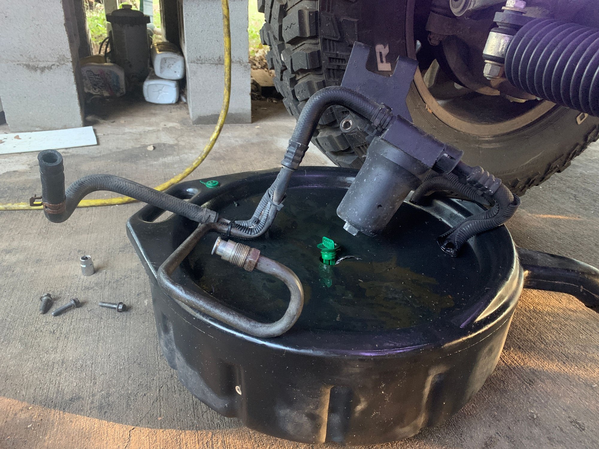

Toilet paper bypass filter delete

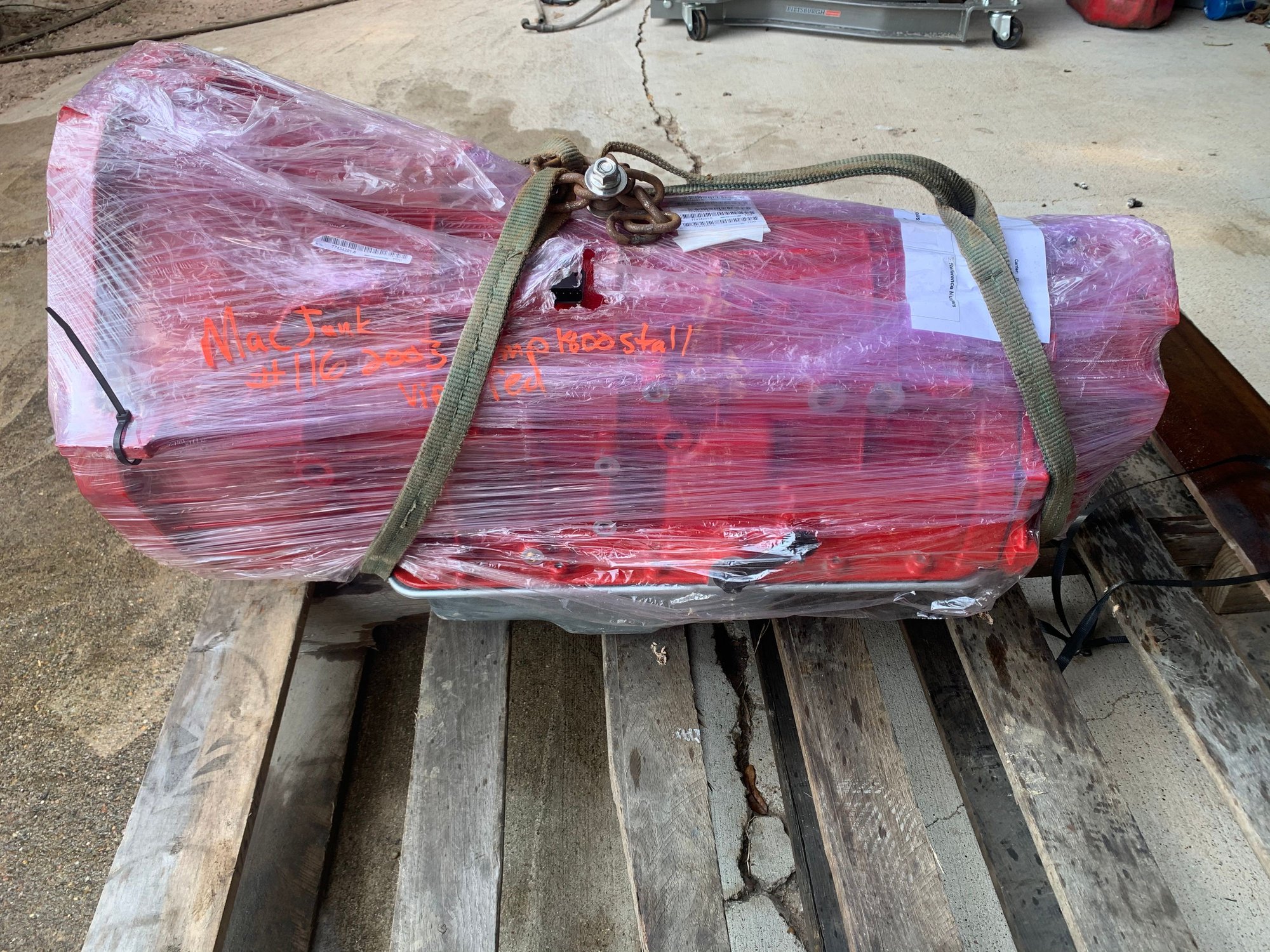

Redneck rigging ready for lifting
Viper Red Warren Competition 5R110W

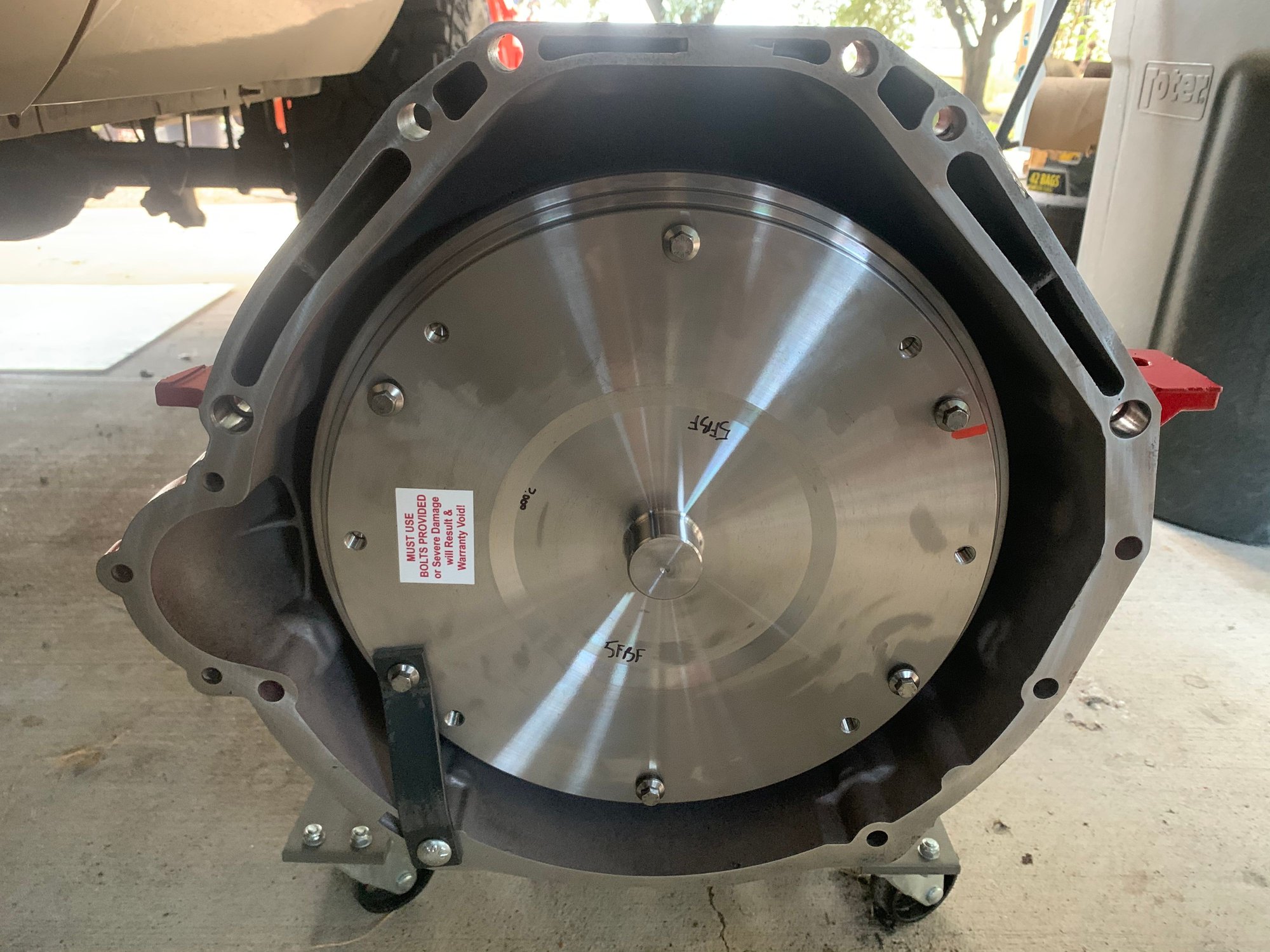

Billet Goerend torque converter with ARP bolts instead of studs and nuts
Clean PML pan

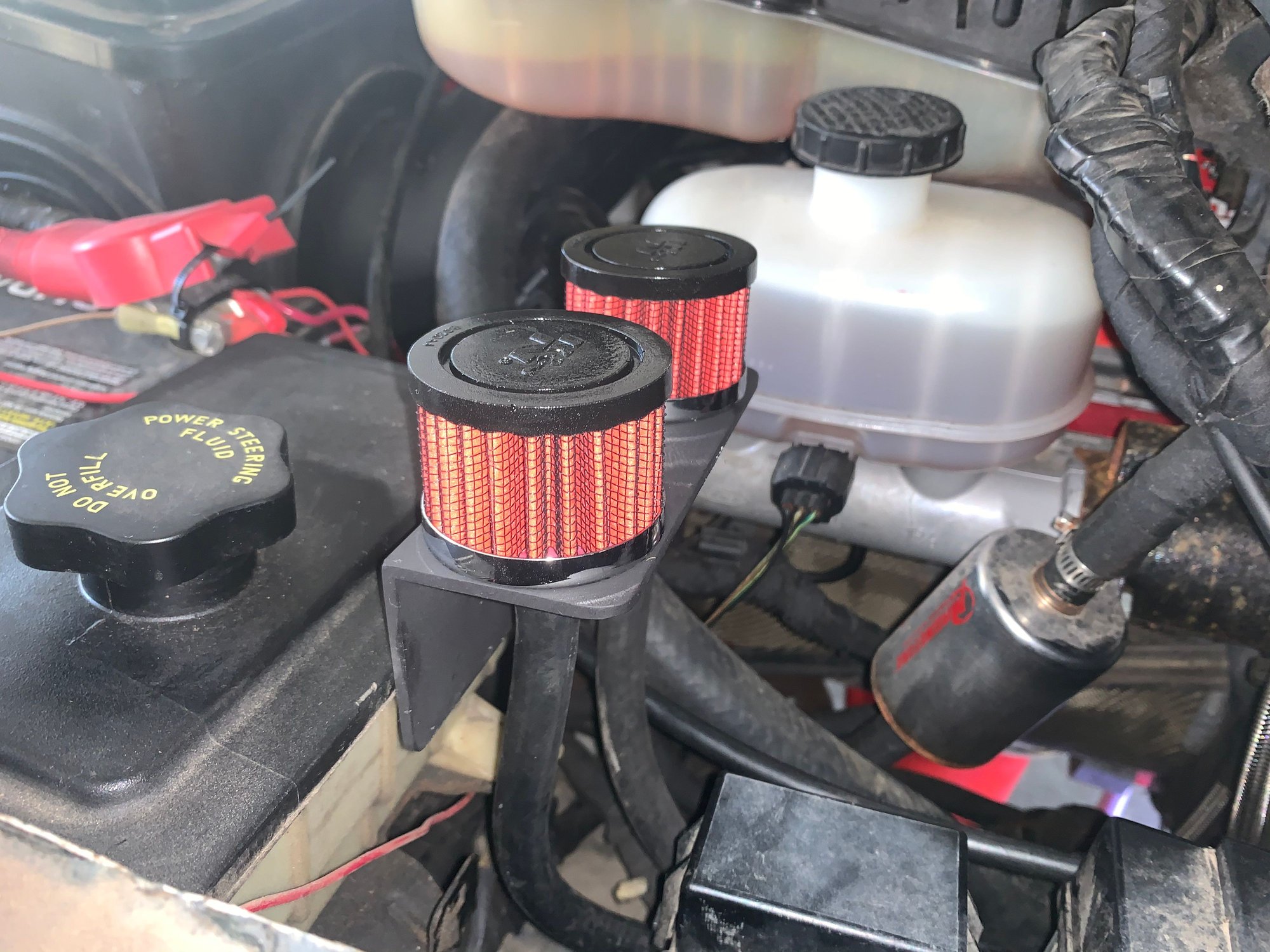

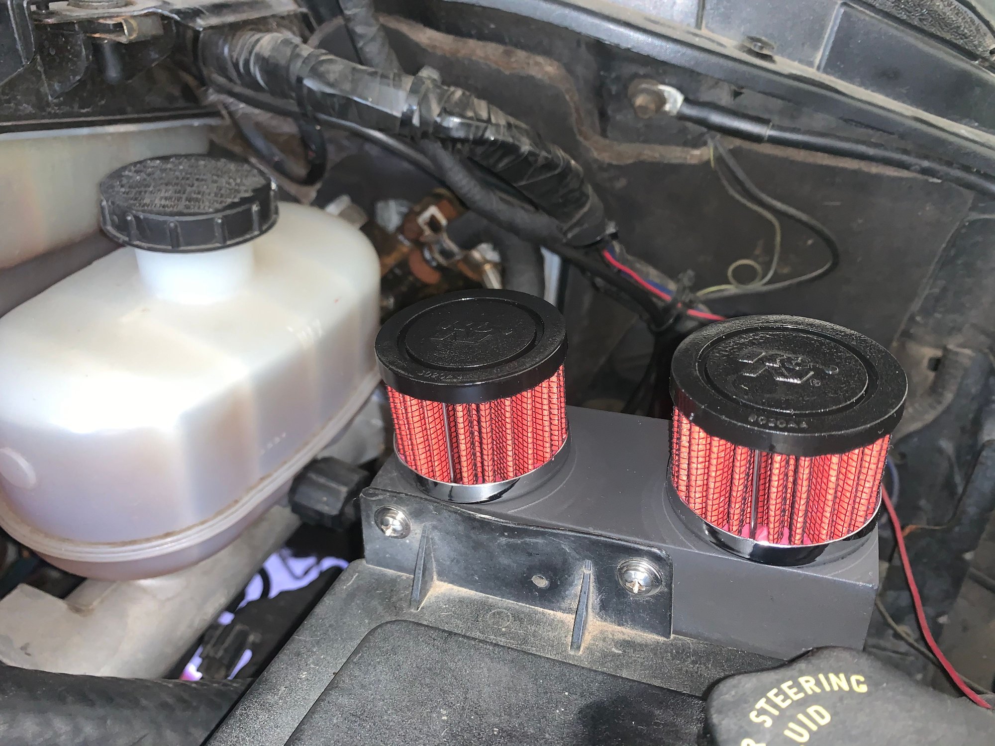

K&N diff and transfer case breather filters with 5/16” Gates fuel hose
Aluminum angle mount

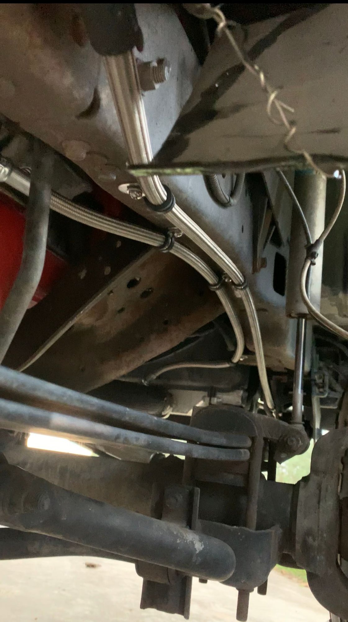

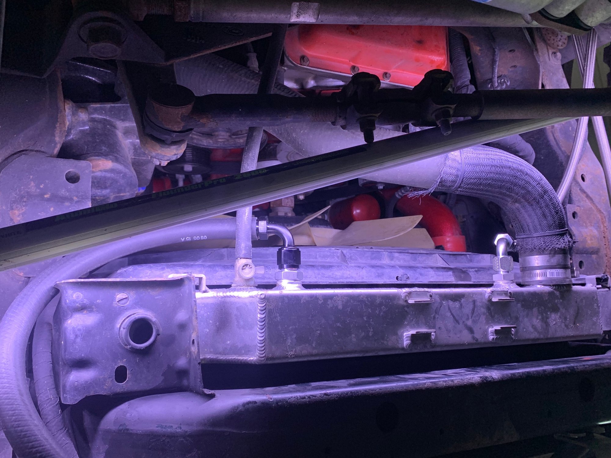

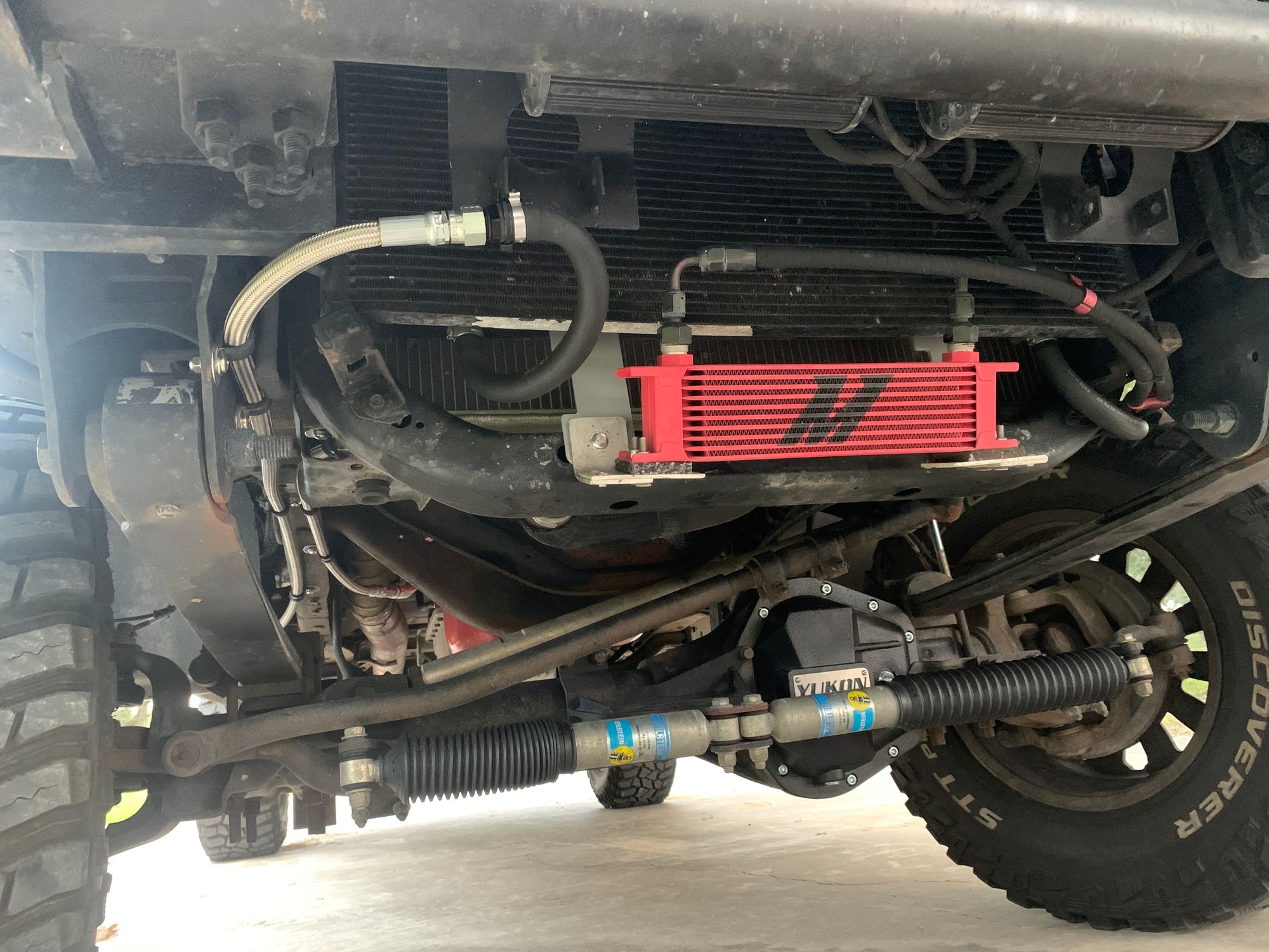

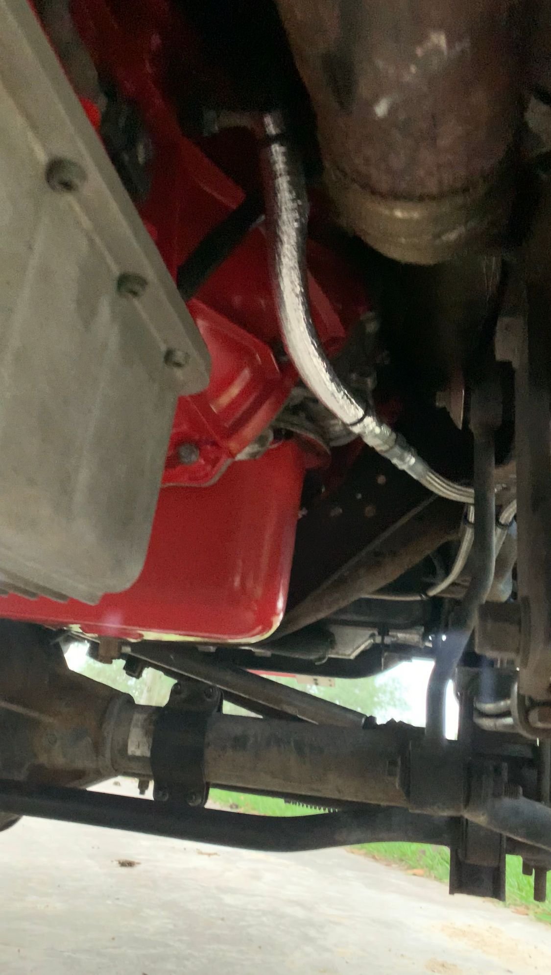

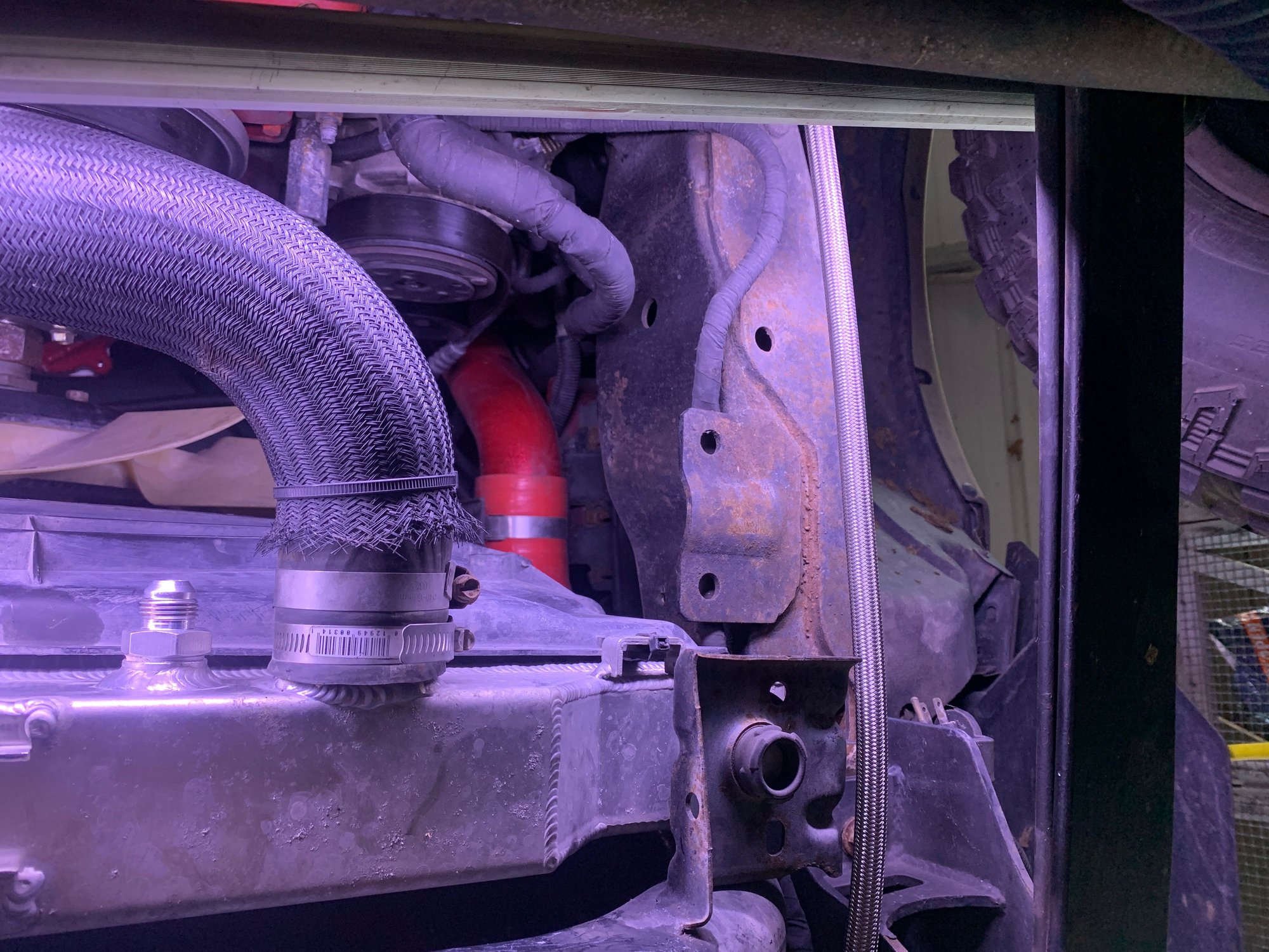

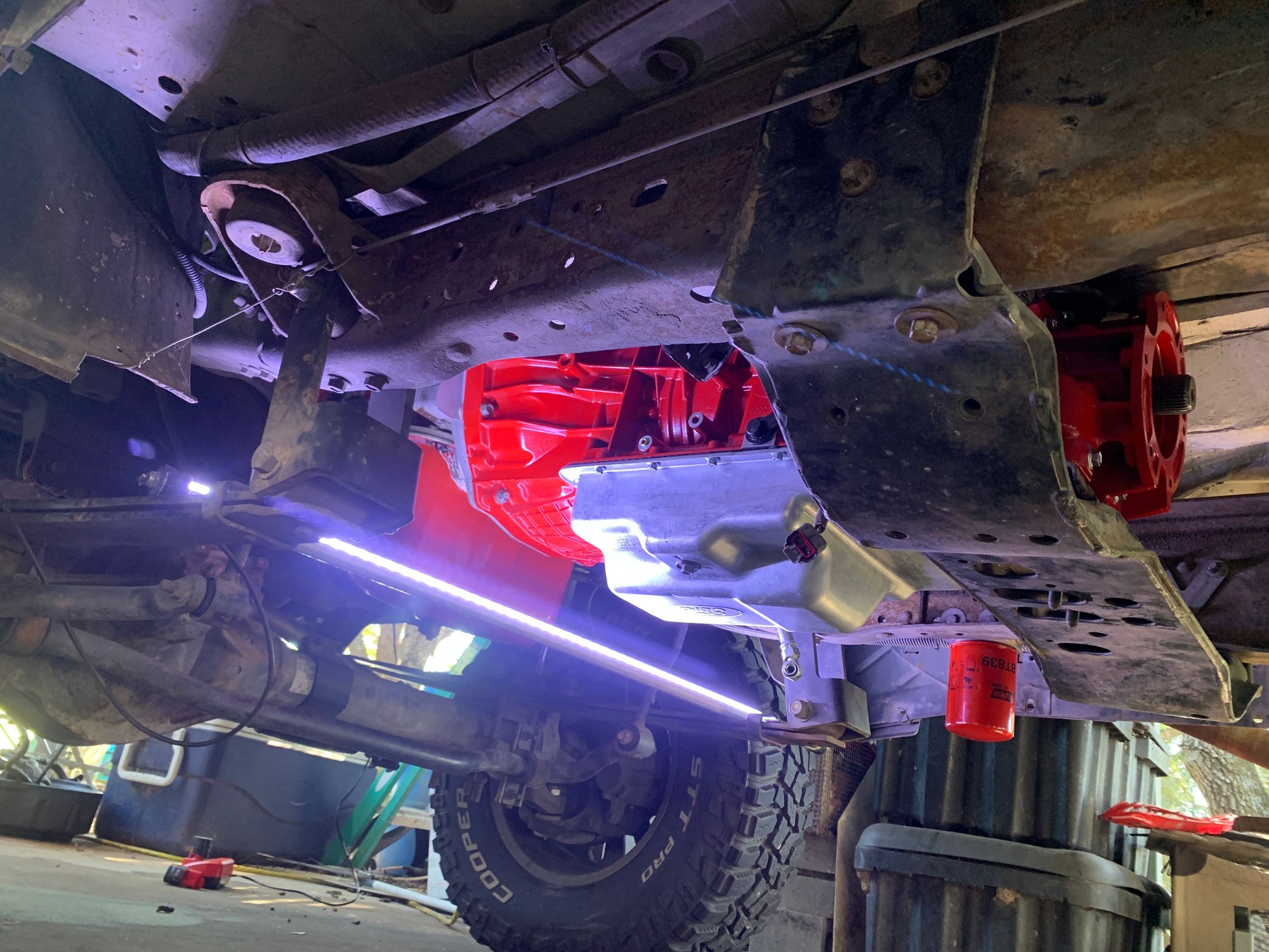

Lots going on under here...you can see the new 8AN teflon/braided stainless hoses on the left running under the frame rail. I used Gates transmission cooler hose to transition to the Mishimoto cooler barbs. The red Mishimoto cooler is my power steering cooler from the rebuild.
Stainless hardware and cushion clamps mounted through existing frame holes. No bump stop to get in the way.
Triple layered Thermatec heat shielding sleeve to protect the hose from the exhaust

Your rear cover looks just like my Ford cover. Sure would have been nice if they had put drains in them.

Thanks! They are identical except the Yukon is quite a bit cheaper. A drain would be very nice, I would have drilled and tapped for one but there was no good place for it. The transmission runs much cooler now. Before I was running 165-168 on average, now I’m at 125-130 and at an extended idle around 160-165. Time for the drain and fill after break in. Mercon LV is expensive but not bad considering the cost of the transmission, cooler and goodies to get her upgraded.
