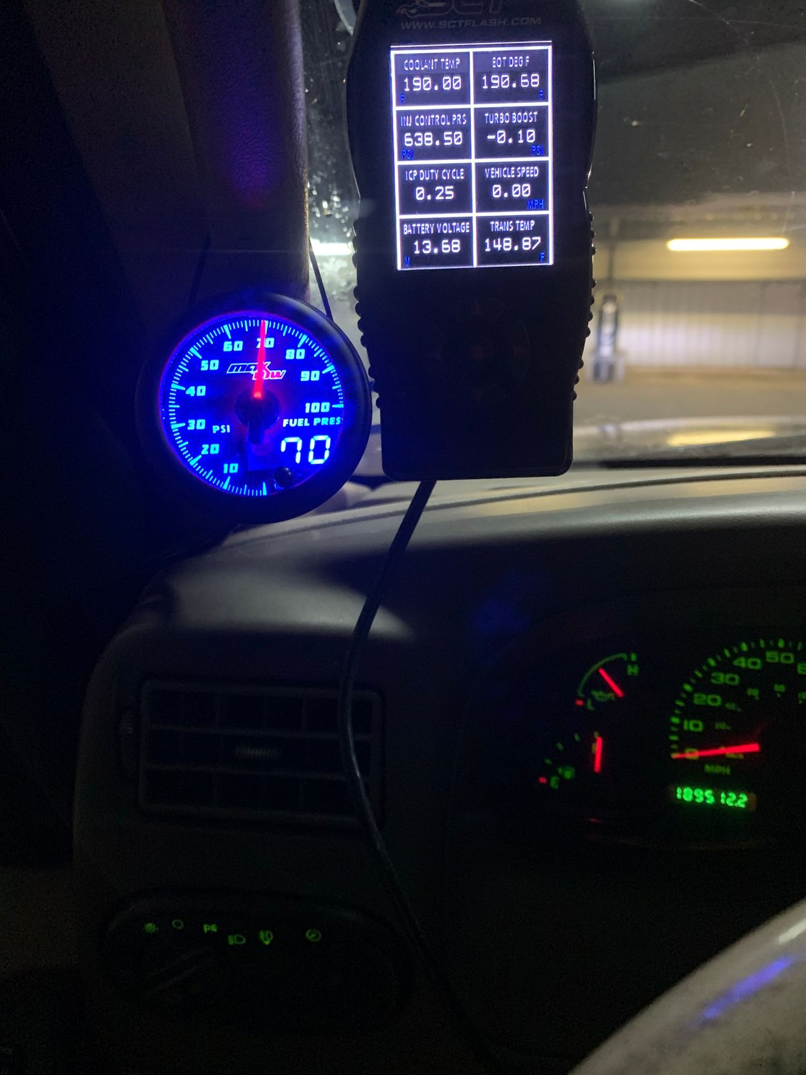

I topped her off earlier and holding rock solid at 70. Went for a drive to my favorite coastal towns and am now at 508 miles on the rebuild. I’m ready to get this oil changed and pull my skiff!

Old Apr 14, 2020 | 08:10 AM
  #507
Fuzzpuss's Avatar
Fuzzpuss
Posts: 3,428
Likes: 944
From: Fort Worth, TX
Originally Posted by WolfCreek540
I found this rebuild thread fascinating to read daily, almost like a reality TV show (except it was better than most!). Gives me hope that if/when mine gets beat beyond repair I can be like SmackDaddy when I grow up and tear into it with no fear. I dread the eventual need for buying a new/later truck and won't consider another vehicle payment for the rest of my life. Very reluctant to let anyone else touch the truck, especially under the hood.
Watching deltas while driving is addictive, along with other parameters. When traveling I use an iPad to display my DashBoss app. My ears, eyes and everything else is tuned to how the truck is running. Wife is completely over all of it.
I look forward to reading more about the long term performance of this rebuild. While it is only a single example, I like seeing and hearing about things that may crop up in my truck. Thank goodness I found this forum and have this resource. Posts like this are a major reason why I feel confident about continuing to own my 6.0!
+1000, especially the part about the wife.
Old Apr 14, 2020 | 08:35 AM
  #508
SmackDaddy's Avatar
SmackDaddy
Joined: Sep 2016
Posts: 3,941
Likes: 240
From: Texas
Man I have been watching it and I think it is. This morning coolant temperature won’t get over 192-194. That is enough to **** a man off. I’ll be looking for an IH thermostat and sending this one back for a refund.
