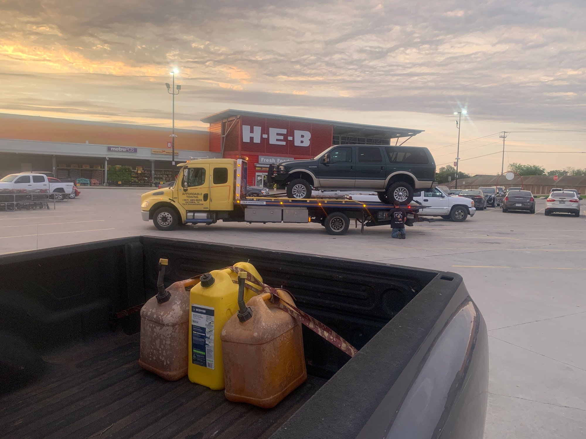

FYI this isn’t a troubleshooting request. I have the 6.7L pump and regulated return I built so I’ll handle it. I didn’t like the sending unit and wanted the sump to go in ASAP. I was planning on running the full tank to 1/4 or so, dropping it and installing the sump BUT only got 255 miles out of it.
Just needed to make a grocery run. Noticed fuel pressure hanging around 66psi (normally 68-69) on the highway...lost fuel pressure as I pulled in the parking lot 30 miles from home. Shut off before it got too low to save injectors. Had my GF’s mother pick me up and got my tools loaded up in my Dodge and went at the fuel filters. Swapped filters, hot wired pump and no pressure rise at all. Pump is running but not priming. I think my pickup fitting on the sending unit I made loosened. No fuel leaks though. Had it towed home and will siphon tank out next days off and drop it to delete the sending unit and install my Beans Micro Sump.

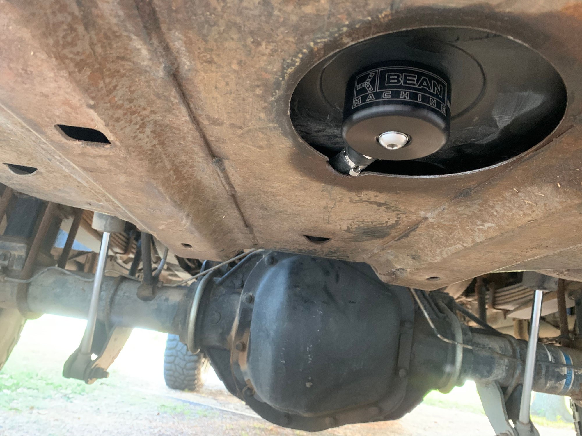

I dropped the tank to delete the feed line and installed a Beans Micro Sump after work yesterday. I added 1/2” feed and return to the stock sending unit last year and even with the draw straw 1/2” from the bottom I still had issues losing prime before my low fuel light illuminated. Last days off I had to have it towed home because fuel pressure dropped like a rock and after doing some troubleshooting in the parking lot I determined I had a loose fitting on the feed somewhere. I was right, when I removed the sending unit my draw straw had loosened and fallen into the tank. I was going to retrofit a 6.7 sending unit since I have the 6.7 fuel pump regulated return system but decided to just go with the sump and not have to mess with tinkering with the fuel level sensor. I ordered a 6.7 sending unit and it came in yesterday and I checked it for fitment and it would have fit but the level sensor reads a different ohm range than the 6.0 and backwards so some modification would have been needed. I will get photos on days off, it was dark last night!

There is a wing on the top that would need trimming but that’s it. I’m going to hang on to it for my next project or might sell it or send it back. I got quick connects and the plug/pigtail too.

I was a little off center, oh well. Runs great!

If Ford is stopping getting the foot inventoried, more of us will be getting the sumps. I’d just spacer the skid plate down if it’s that close.

You could add spacers to the skid plate or add strips of rubber to the supports to hold the tank up off the bottom of the skid plate and gain a little. I’m going to have my buddy fab a cover plate for it later on. I just wanted to get it done so I can continue break in. 680 miles to go until oil change.
