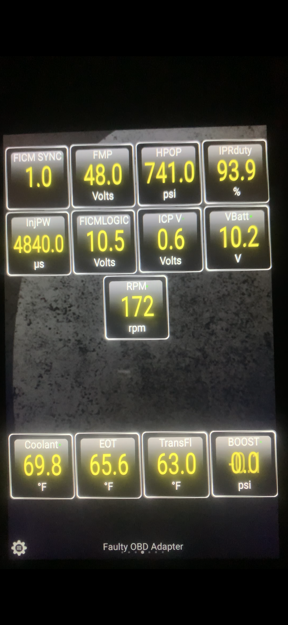

Well I got home and set up my new Android tablet with TorquePro and attempted to start. Duty Cycle 93% almost immediately. Swapped my old known working IPR and same thing. I had to get some sleep so I left it until after work today. I will hook up my IPR air test tool and see where it’s leaking. It won’t build over 700psi. One time it tried to fire and duty cycle was 45-50% while cranking but it did not start. FICM is an Ultra from Ed and sounds good, I did not mess with injectors other than cleaning nozzles and new lower o-rings and coppers and nipple cups/o-rings are the same as when I removed the rails. I did replace both braided lines and stand pipes with new Motorcraft parts from Tousley/White Bear Lake Ford. HPOP got a new Motorcraft reseal kit. I had no issues before the rebuild so something is leaking. DieselSite Adrenaline High Output HPOP had no issues at all before. I guess an air test will pinpoint the leak(s). ICP is a new style Motorcraft that I bought about two years ago. I may get new batteries, these Optimas suck. I am getting about 180 rpm cranking but I am not happy with their performance since I bought the two new red tops to replace the old ones. I have my 2019 F-250 running with jumper cables to the passenger battery while cranking to keep voltage up. This is pretty disheartening when I was meticulous when assembly and rebuild...
These are cranking values every time after 8-10 seconds. Battery and FICM Logic voltage are 12.2-12.4 with key on before cranking and FICM is 48v.

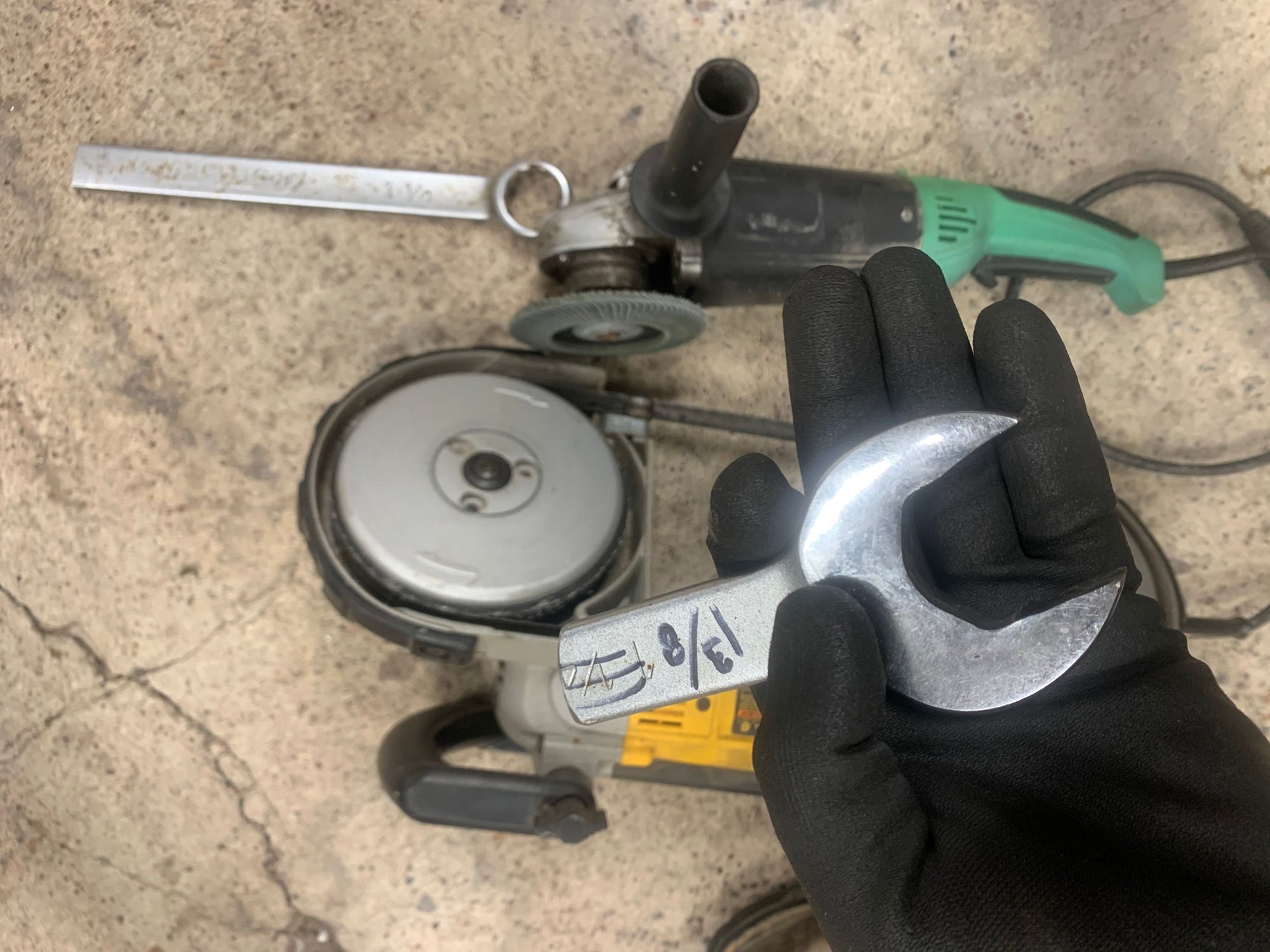

With fuel and coolant lines at the back of the heads it was impossible to get the IPR socket on so I made a stubby wrench out of a 1 1/4” wrench by cutting the handle and grinding the size to fit the IPR nut...maybe I could sell these for coolant/fuel return guys.

Charge those batteries for about 4 houirs and crank it for about 20-30 seconds, waiting for 30 seconds in between cranks. It will fire. Sometimes they leak before they are started.

SmackDaddy: did you cranked with FICM relay removed? I guess there is air in the HPO system!

I may get fresh batteries after work and try again before air testing. The batteries have been charging all night and today while I’m at work. That’s what I was telling bismic...if I could just get her to run the leaks would probably seat themselves. I was meticulous when assembling and had no HPO issues before the rebuild.
Yes. I have base oil pressure and getting up to 700psi so she should start...almost had it once yesterday.
