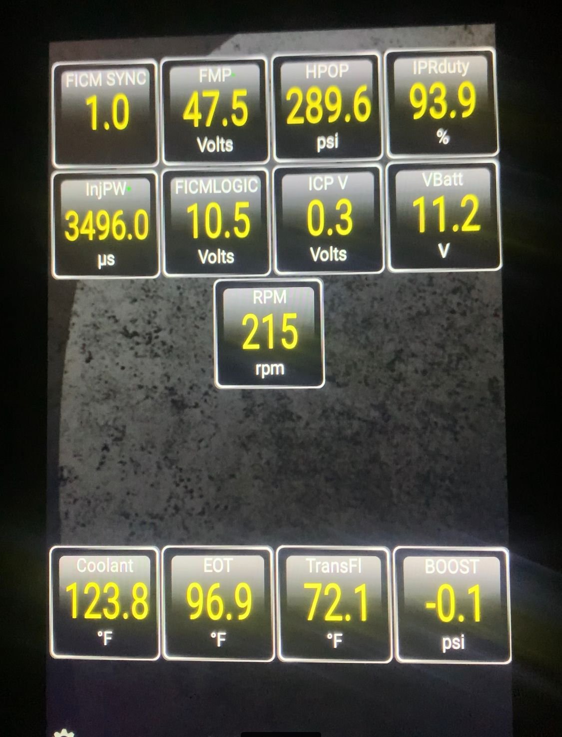

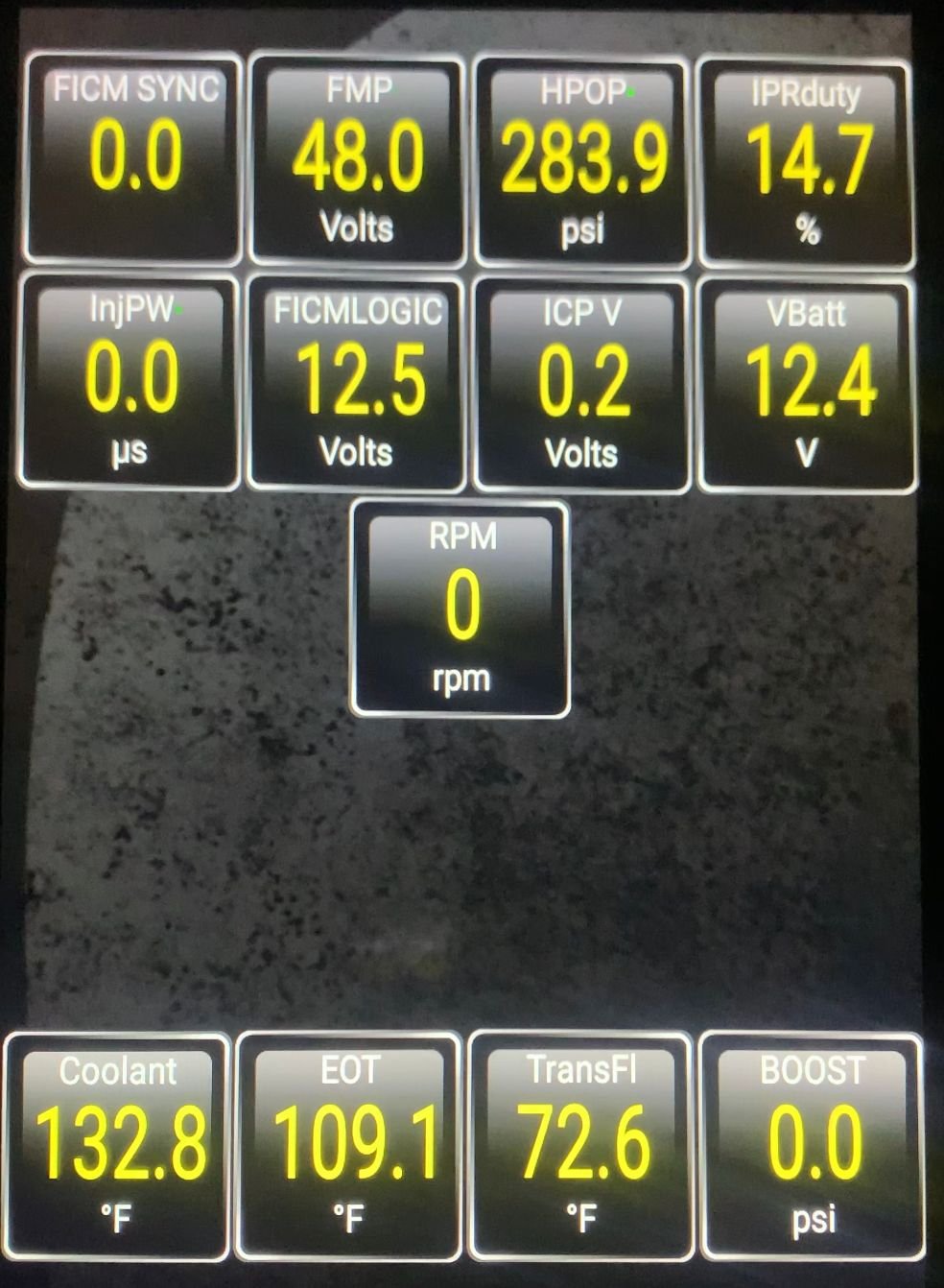

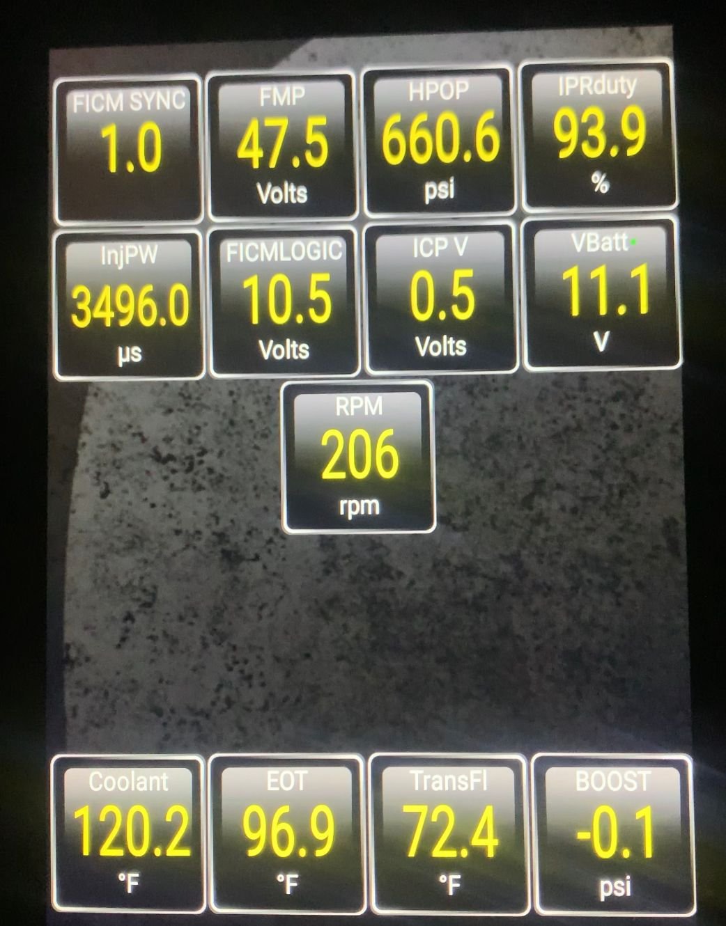

Something is fishy here, I think it’s a bad ICP or wiring issue. I picked up two Duracell group 65 batteries and installed them and plugged in the block heater while topping the batteries off. I let her heat up and cranked with the starter wire and FICM relay removed taking breaks in between to cool the starter and let the batteries charge. Cranked with the relay in and key and I got 210-220rpm but everything else was the same as yesterday. Duty cycle jumps to 93.9% immediately and can’t get over 680psi ICP. I noticed my ICP with KOEO shows 270, it never drops anywhere close to zero. I thought Duty Cycle was 15-85% not 15-93.9%? I think that’s my issue causing the ICP to show a false value. I am going to unplug the ICP after work and see if she fires. Everything else is right where it needs to be.
Key on engine off...what’s up with that ICP AT 283.9?
First part of cranking duty cycle immediately jumps to 93.9%
This is the highest the ICP gets after 15-20 seconds of cranking

SmackDaddy, one thing you could look at to check is the actual voltage from the ICP and IPR. That might help track down an electrical issue.
The ICP voltage should by about 0.25V KOEO.
I saw that you had ICP voltages displayed.

One other thing I see is the IPR duty cycle of 93.9%. It is suppose to max out at 85%.

I mentioned that, it was the first thing I noticed. It never went over 85% before. Something is jacked up with the PCM, wiring or ICP.
UCF and my machinist confirmed that reduced height pistons do not change compression because what you shave off the top of the piston and reduced bowl volume cancel eacb other out. I’m no machinist but from what I have seen there are no issues with people adding piston coatings, fly cutting pistons to clear valves etc so mine should be no different. That IPR Duty and ICP are suspect.
