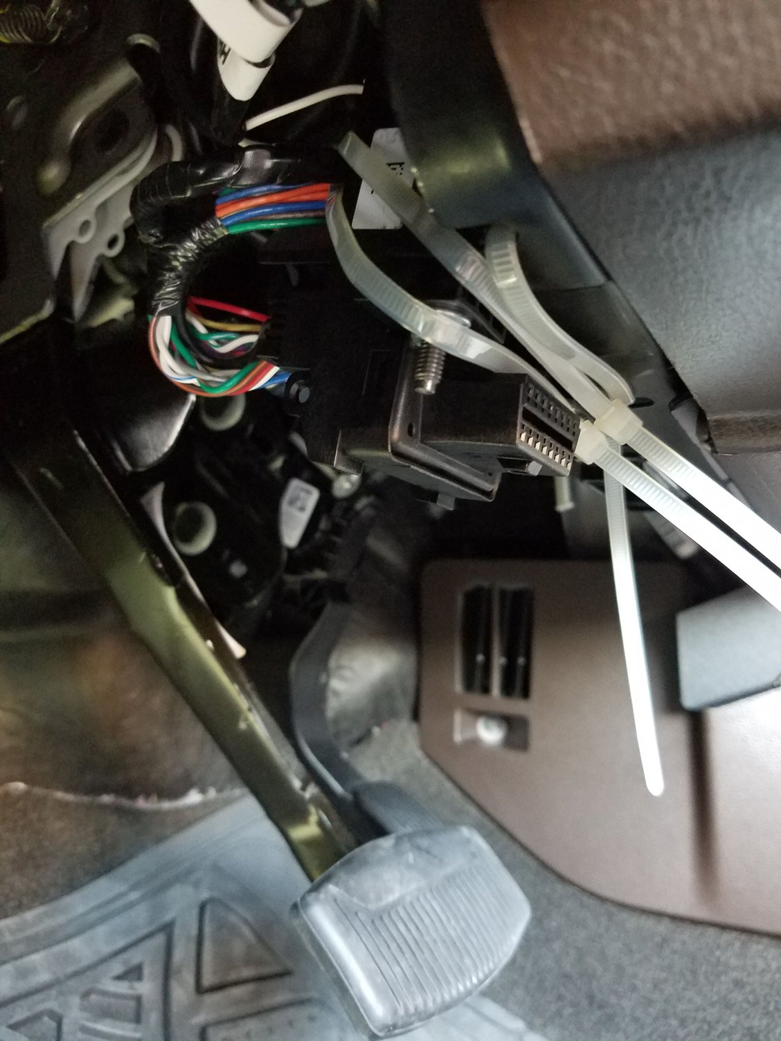

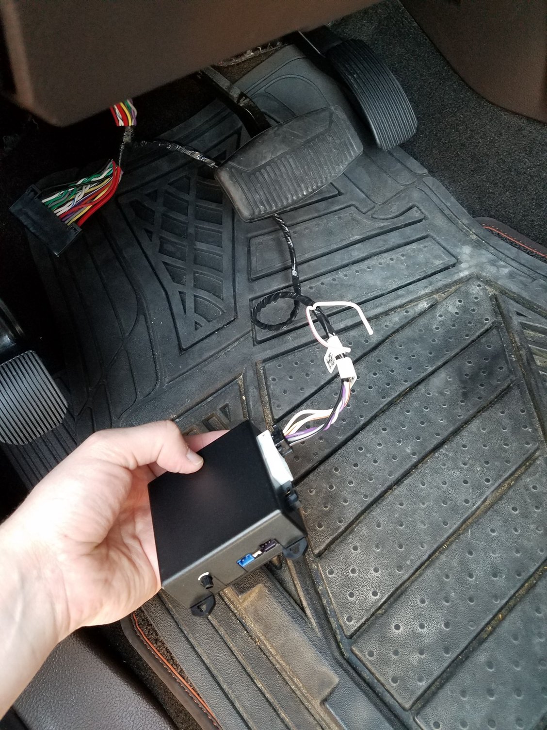

Ordered from Banner on Monday, delivered today. Just installed. Took about an hour of fine tuning. I could do it over again start to finish in 5 minutes now that I know what to do. I took pictures to hopefully help you guys.
Dont zip tie it all up until you test the sensitivity of the alarm...i had it all nice then couldn't access the sensitivity ****.
1. Unplug from back of obd ii
2. Plug in the t harness to the obd ii and the plug that goes into it.
3. Plug into the perimeter alarm box.
4. Plug in the remote cell box
5. Turn off and on and off to learn.
6. Test sensitivity by using fist. I have mine turned all the way up.
7. Set off alarm a few times to admire your work.
8. Zip tie units up out of the way of anything moving. I tied it above the obd in the little cubby there. Seemed to work nicely and is out if the way.

Originally Posted by BostonDMD06
Thanks for all the PIC's, are you going to be able to plug in an ODB II reader with those zip ties there?
