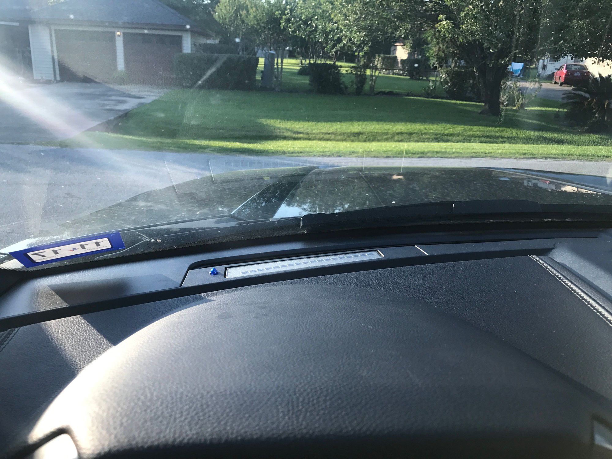

For those that have not installed yet. I just did mine last week and figured I would share my pictures to help give you ideas on mounting. I will warn you that it is a pain in that *** to get it mounted in this location but you won't find a better more factory looking spot. Also I used a aftermarket alarm led due to wanting a brighter light. Also I would like to point out a few things that I was unsure before I installed. When you receive text alerts it does differentiate between shock sensor and the door opening. But if you have motion sensors from factory it will pick those up as a door opening as well. Last thing is for those that are wondering you can temperorarly disable the shock sensor very easily by putting your foot on the brake and pushing lock button on key fob.
