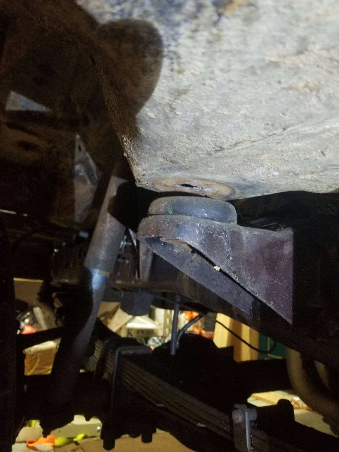

Drivers side cab mount. Going to put a steel plate below the mount and see how that holds for now. At some point will need to pull the cab and install new cab mounts on both sides

Probably the best option for a quick and solid fix... good luck with it amigo

You will want to go up the side as well to distribute the weight better. Those are not original cab mounts correct?

fe390, I'm not sure if they are original cab mounts. But I am sure the cab will need to be removed at some point down the road to have new cab mounts installed.

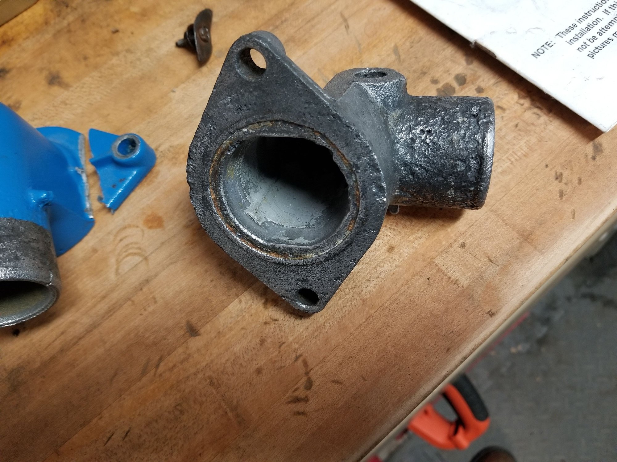

What do you guys think about the Scott Drake water necks C8AE-8592-B? I had a guy send me an old one that I cleaned up but not sure I should use it. I'll post pics. Also where can I find the body clips for the hood lip? I'll post a pic on that as well. Hope everyone is doing well and staying healthy with this pandemic.
Thanks for the help on a water neck for the 390 and the clips for the hood lip.

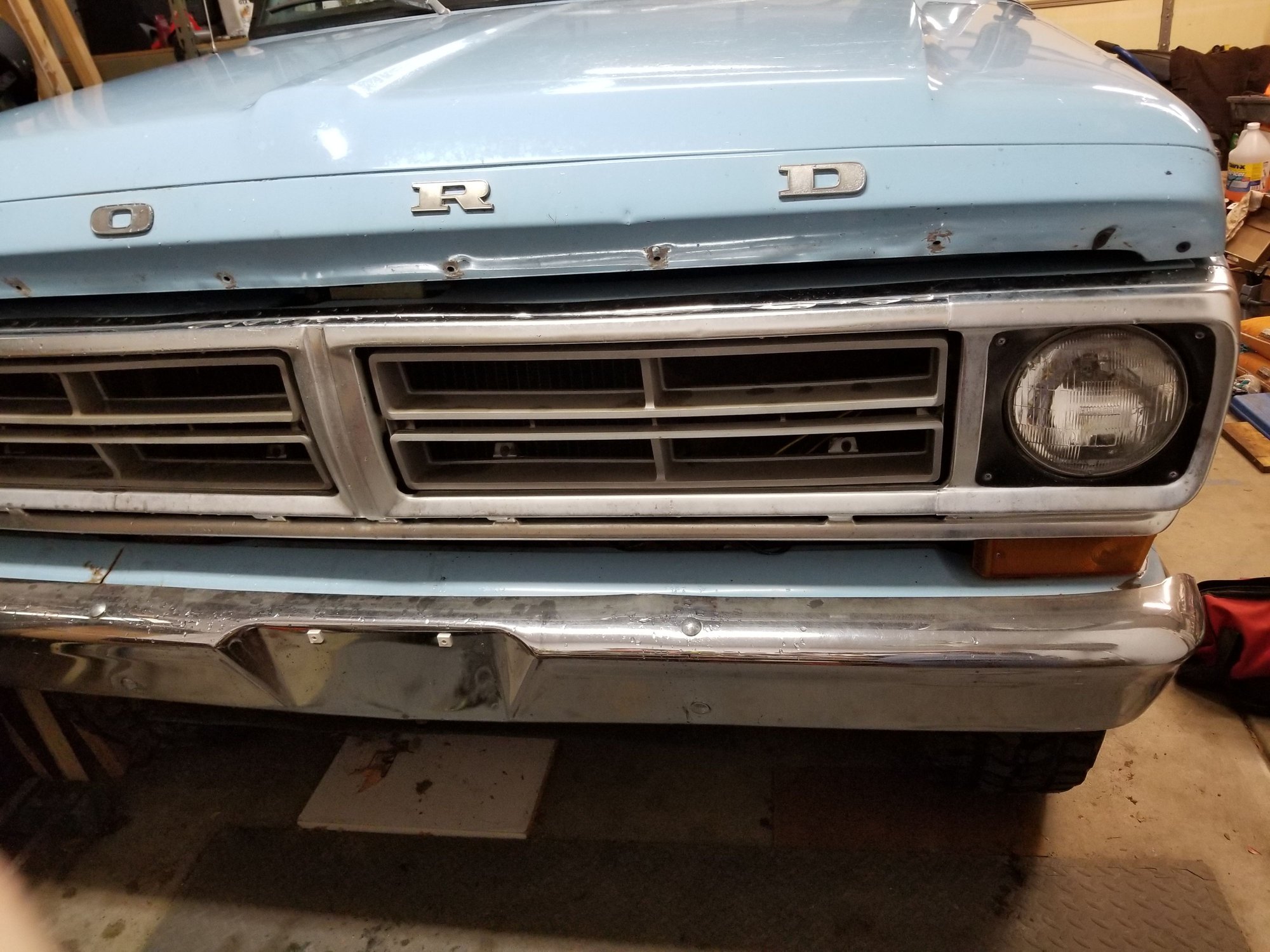

Need hood clips to put the chrome upper lip back on.

See the one on left I broke. Then I put a chrome water neck on and it is leaking. I read where the chrome necks have that issue. So I would like to find NOS water neck. I appreciate the guy sending me his old one but after cleaning it up it's rough. Thoughts?

Those clips are pretty ubiquitous. I saw them at a local body parts supply.
Also, did you check LMC? https://www.lmctruck.com/1957-72-for...l-arch-molding

X2 what cBrown is saying, I think I bought some at Napa. For the 2 ends of the hood trim side pieces, you should be able to find an expanding rubber grommet + a stainless screw at the hardware store. The rubber grommet has a brass nut imbedded in it. I found them at Ace hardware (fastenal I think).

LMC or Dennis carpenter for both of those parts.
