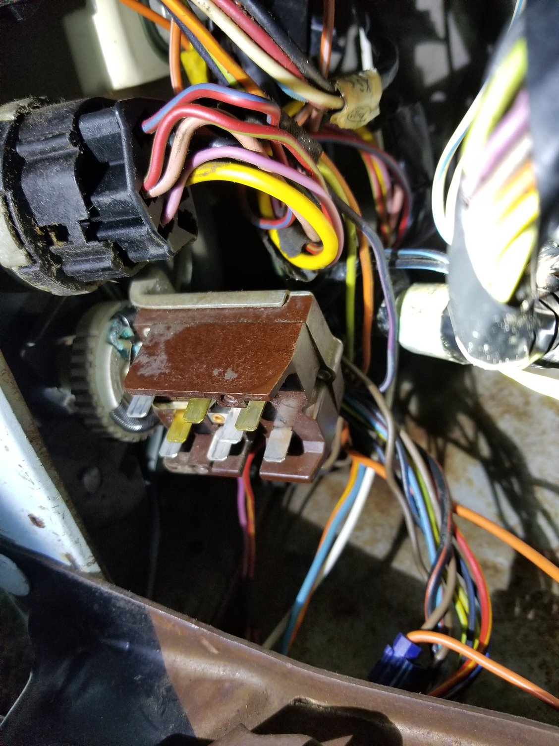

Has anyone had their light switch get so hot it shuts off the headlights? I'll post some pics. Do I need a new plug or does the switch need to come out and be cleaned? Ground issue?

Switch only heats up when headlights are on. Running lights are not an issue.
The plug you see was hot enough I could not keep my hand on it for more than a few seconds. It does cool off fast when headlights are off.

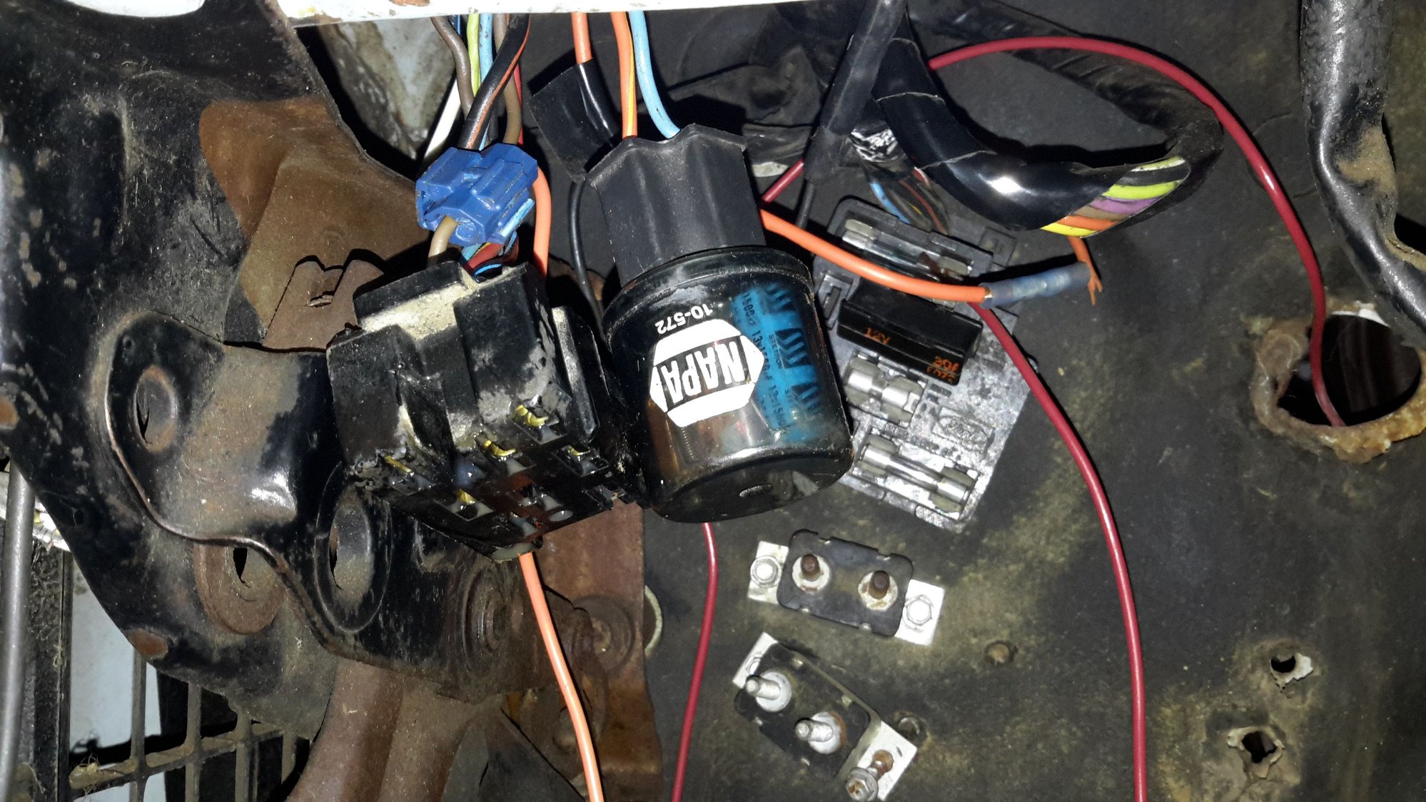

The part with NAPA on it was not org to truck. The guy who had the truck afte my grandfather and b4 me must have put this on. I think it relates to the lights. Also they guy had 6 aftermarket spot lights he installed. 4 on the brushguard and 2 on the upper cab.

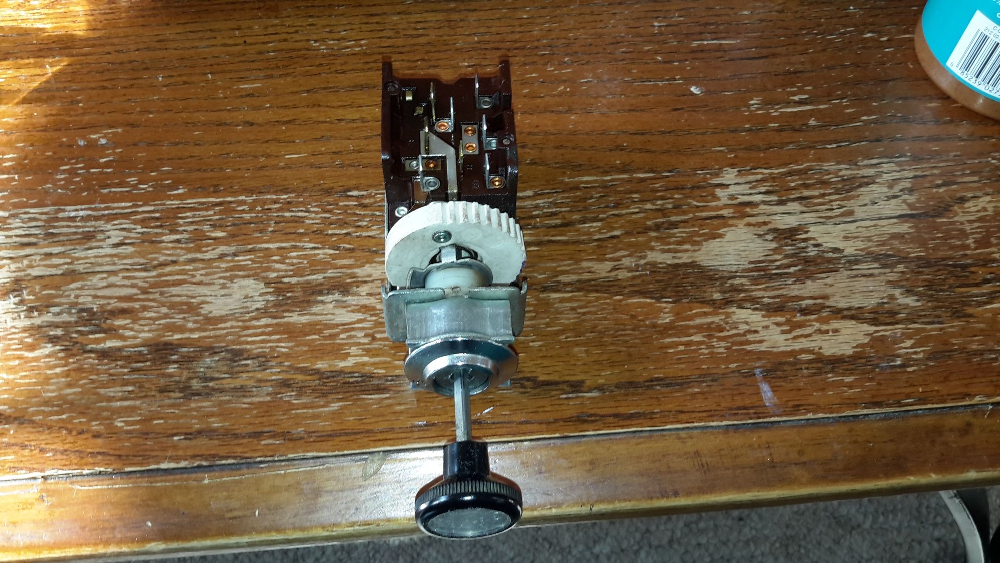

I took the light switch out and it looks fine. I could tell its been out before. But that brown part of the switch is what is getting hot and shutting off th headlights.

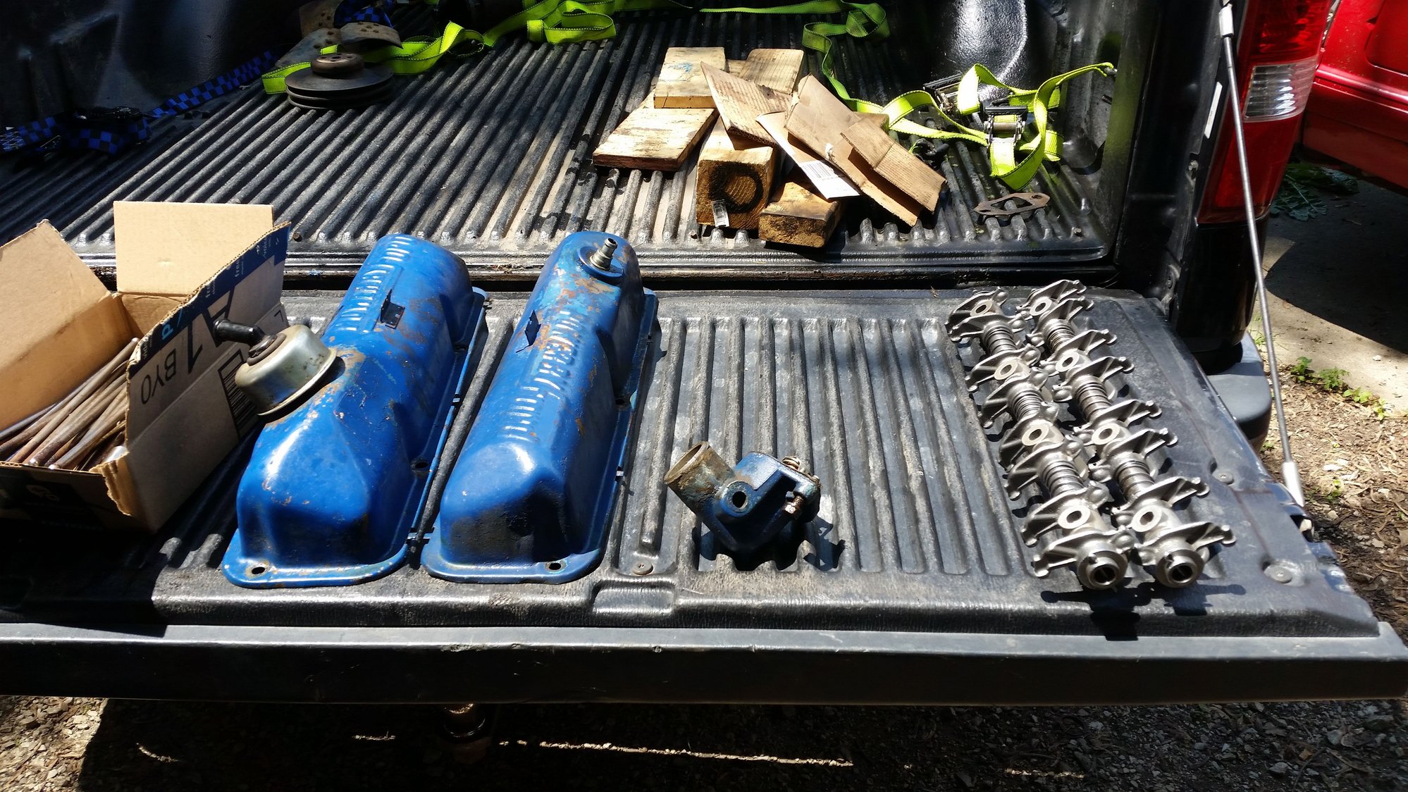

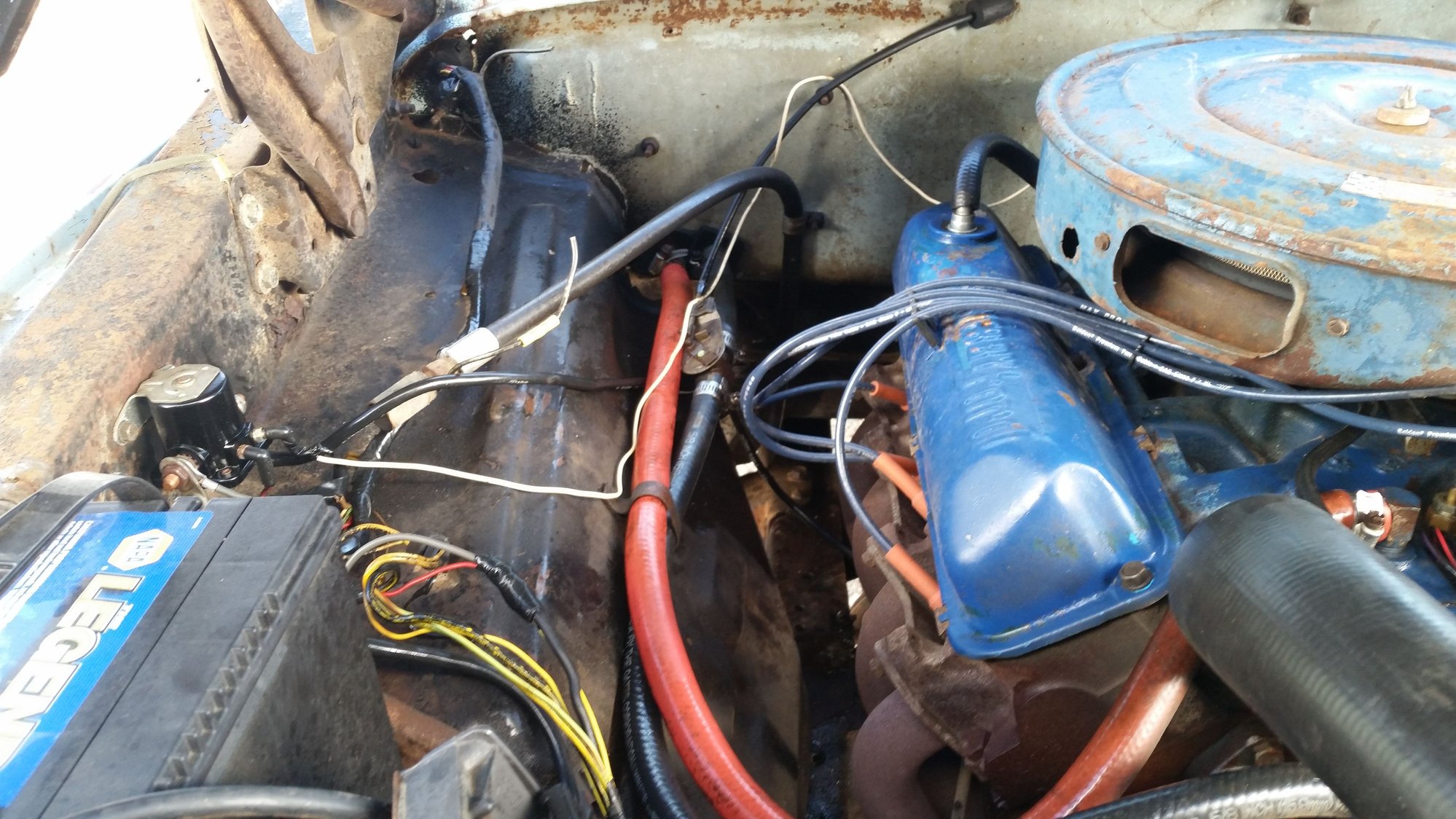

To be, or not to be... PCV on our FE390 engines. A friend who is good at dialing in carbs and Holley Carbs said the PCV valve should be on the engine. He is saying I need to have the PCV valve in to dial in the carb correctly. The PCV originally went from the passenger side valve cover to the air breather I think. Or was it to the carb? Anyway, I'm doing some online research and found much debate on the topic. Some guys say the engine just needs the breather caps, one for each side and my engine has one for each side. (I'll post pics) Other guys say it needs the breather cap PCV value for OE running specs. The grommet, PCV valve, and hose are gone. Where do I find those parts if I in fact need them?
Thanks for the help! -Sh awn

This pic is b4 I pulled the engine (2016 or 2017) b4 engine went bad
See the valve covers in 2017 when I pulled the engine. The guy who rebuilt the engine trashed the grommet and PCV valve so they are gone
New air breather and vented caps on each side.

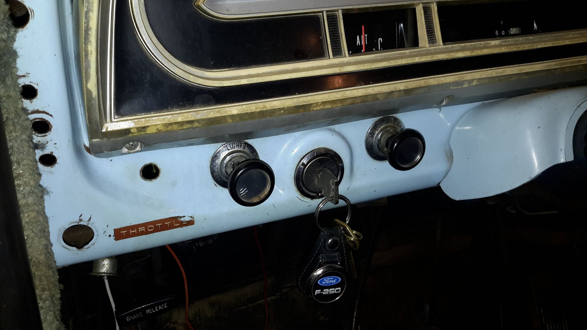

Baja, my new switch is in and so far it is working. I only drove it on one test run but the lights did not go off and the switch was not hot (it was a little warm but not hot). When I would grab the old switch I could see the headlights getting brighter or dimmer (just a little). The new switch is solid and I can grab the wires and move those around with no issue or diff on the headlights. So that is good. Now that might not be the only issue I have becuase now I can pull the light switch to the running lights fine but when I pull the headlights on (2nd pull out position on the switch) I can hear the electric fule pump power drop slightly. That was with the truck off. I wired the eletric fuel pump so it is hot when the key goes on. When the truck is running I don't think I would hear that slight power pull. But not sure.
So the new switch is working, I just need to look at what Jeff posted on the grounds and maybe install a relay on each headlight. Let us know if your new light switch is the solution for your truck as well. Between the two of us we might help someone else down the proverbial road.
