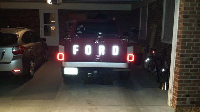

Is no one working on their trucks because they are staying 6 ft away from them
Saturday being nice I washed the truck and then installed the tail gate letters that I have had for a month or 2.
It had to be above 65* to install them.
And they are reflective

Those tailgate letters look great, they really finish it off! I got 3 new bumpers, front & rear for my 69, and rear for my 83. I haven't had time to do any truck work lately though, I've been working on my sons deck which I just finally finished (actually I finished the deck a long time ago but been working on the ramp for months, and now it ALL finally finished).

Thanks guys the letters does finish off the back nicely.
I hear you on washing and pollen but I had the time, it was warm enough to do the letters and the truck needed a wash any way. Washing just the tail gate would look strange.

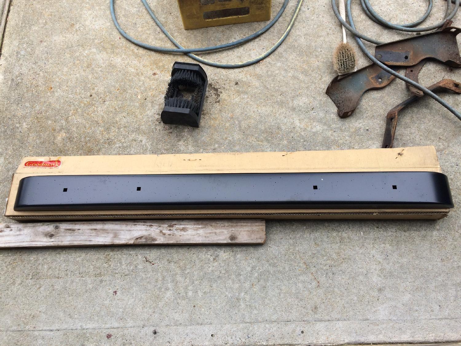

So I have spent this week working on the rear bumper of my 83 Flareside.
The rear bumper that was on this truck when I got it was a step bumper that would go on a Styleside, too wide and too low for a Flareside.
The new bumper I ordered was for a 73-79 Flareside and cost $115 - quite a bit cheaper than the bumper listed for 80-85 Flareside, but the dimensions were the same (61 inches wide, 4-3/4 inches high). I can only assume the difference is in the placement / size of the bolt holes.
Even though the place I ordered it from said it was for 73-79, it came in a box that said "48-72 rear bumper"

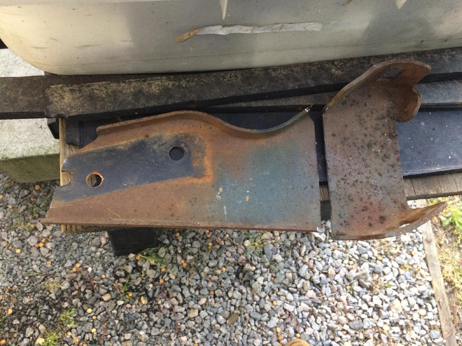

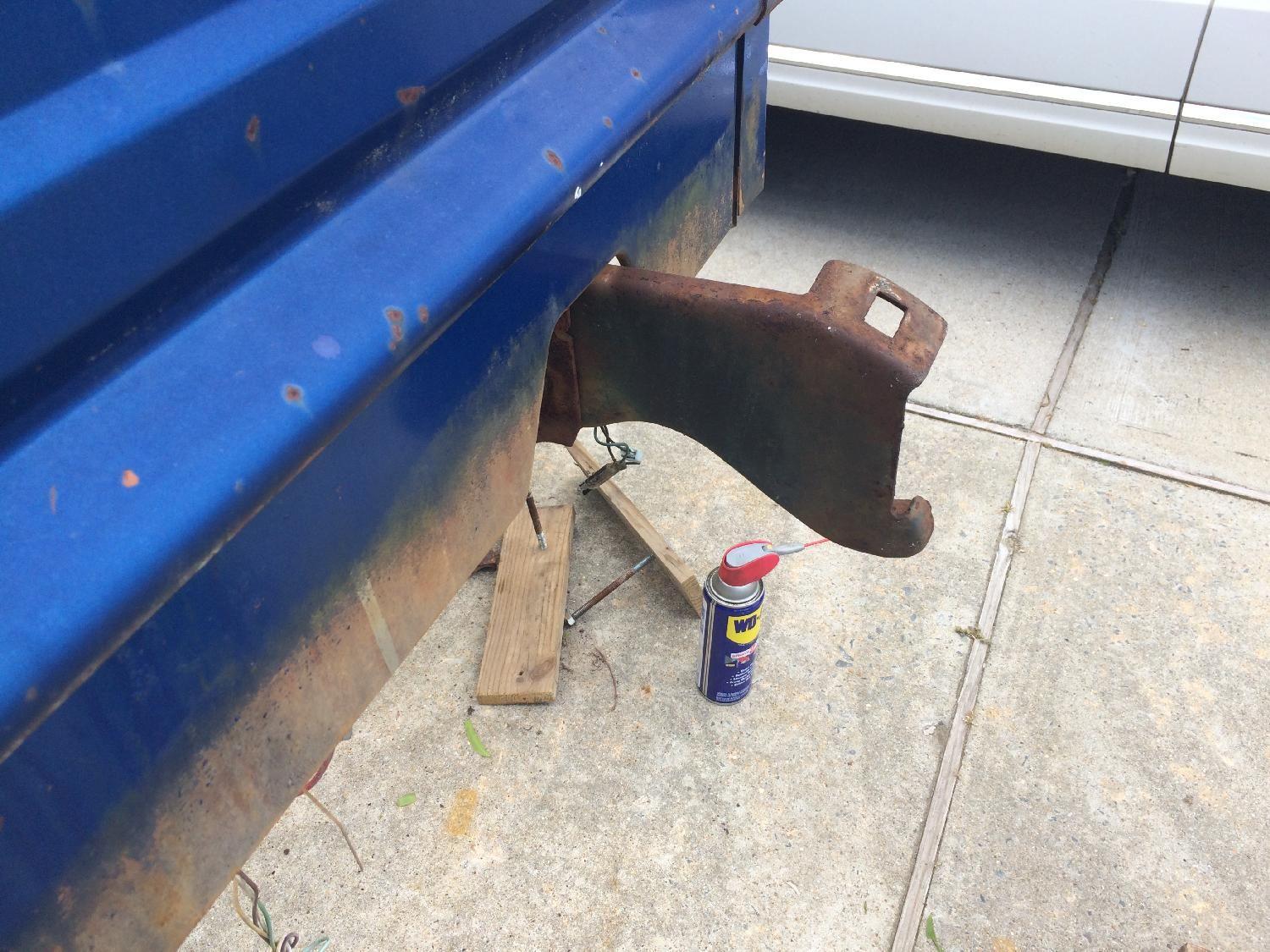

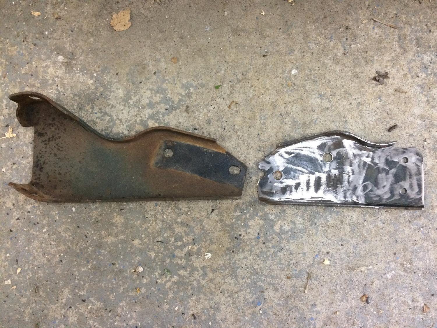

I wasn't concerned about non-stock mounting locations, because I was fabricating my own mounts. I had these old Styleside bumper brackets off my 1969 F100 and decided I could just modify them.
I had to flip the brackets upside down and redrill one of the holes to make it fit. It stuck out much too far however.

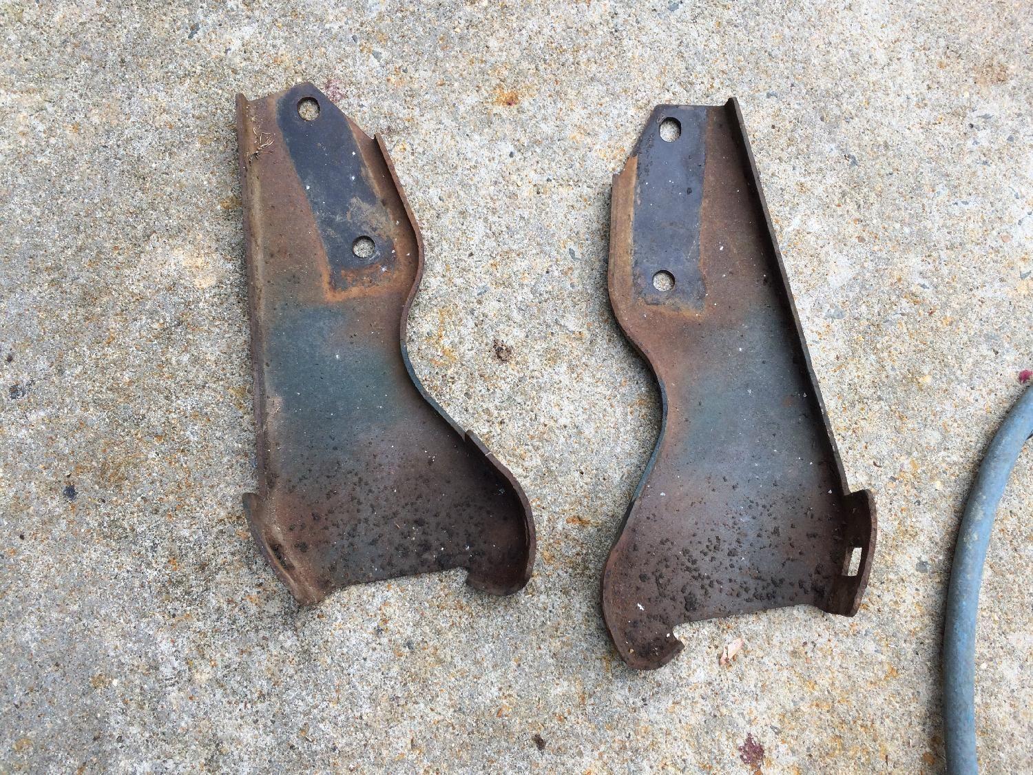

I trimmed the nose of the bracket to clear the rear spring perch and trimmed off the excess.
Here you can see one side prepared compared to the original.

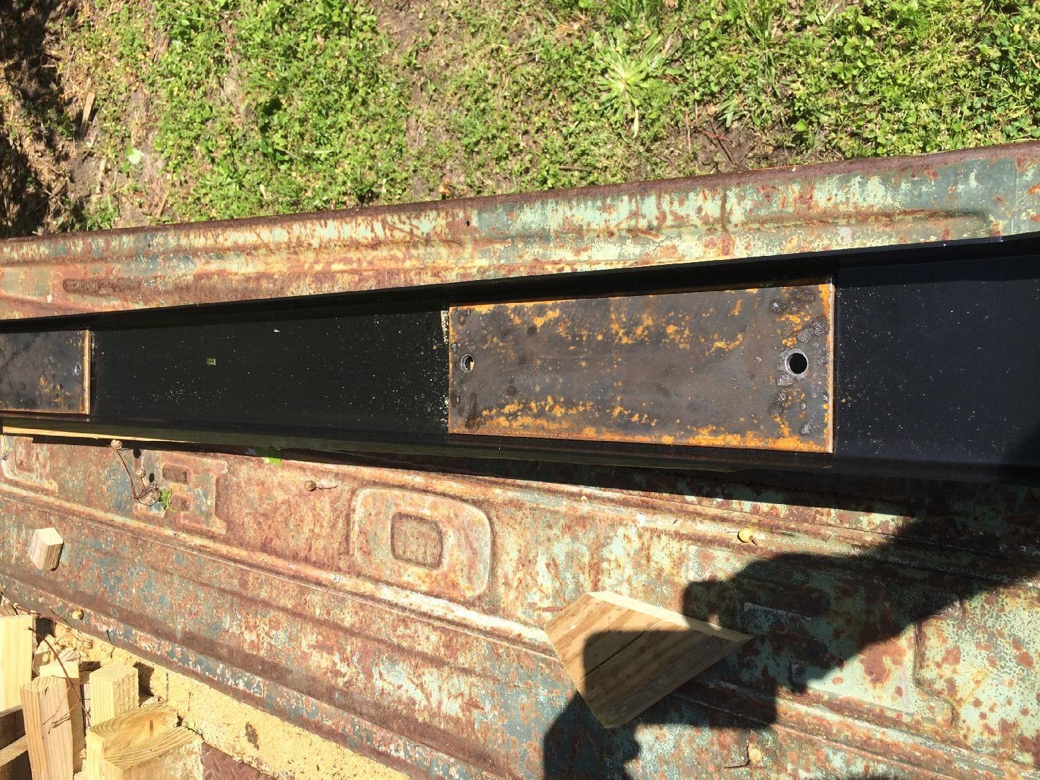

I got 2 pieces of 3/16 flat plate (4x12) which fit perfectly over the bumper bolt holes. I drilled out the mounting points (wow, what a difference a drill press makes. It took 15 minutes to drill one hole to 1/2 size using a regular drill, but once I borrowed my father-in-law's drill press, I was cutting new holes in 30 seconds each).
Fits perfect

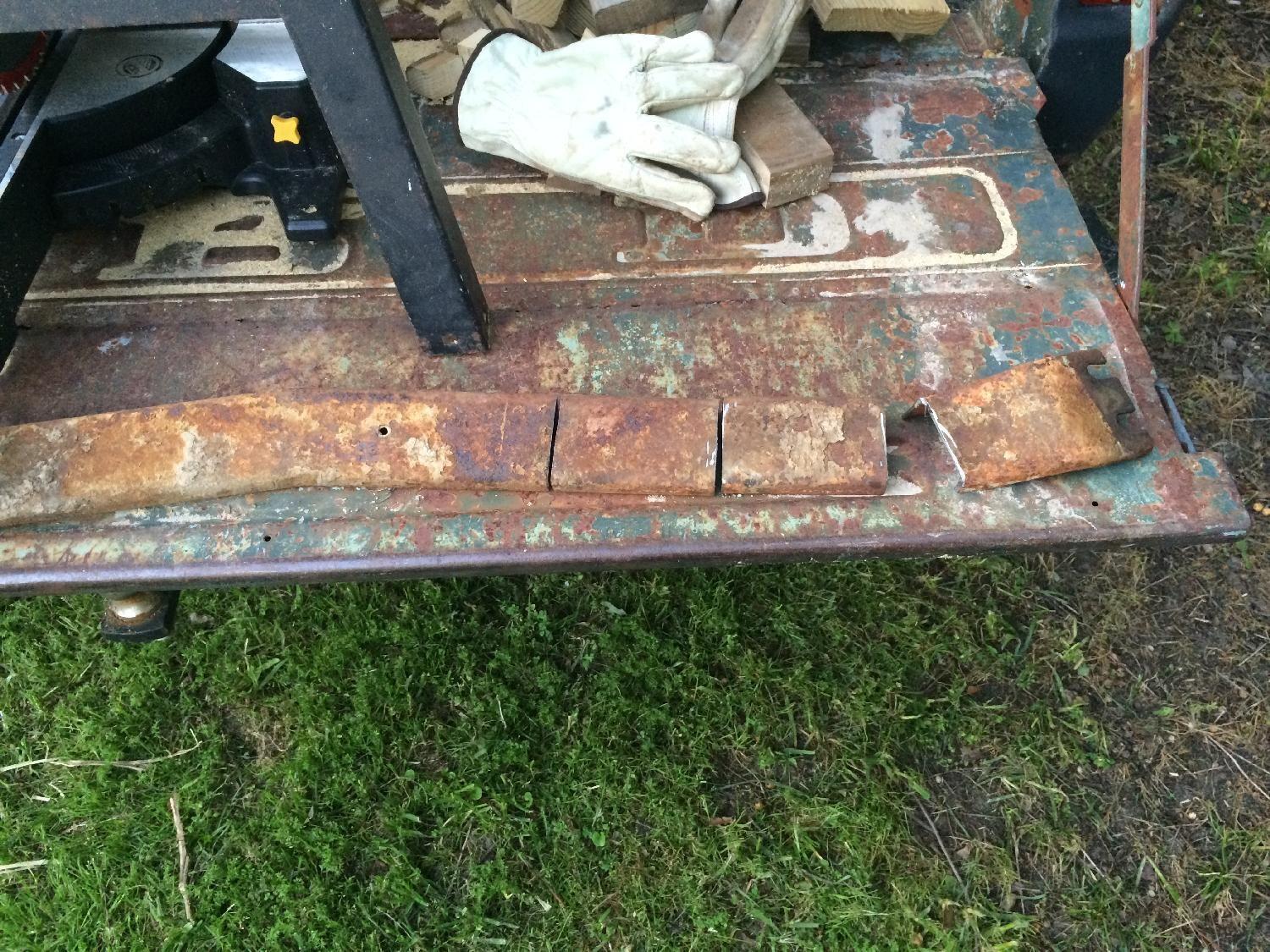

To connect the 3/6 flat plate to the modified 69 bumper brackets, I decided to cut up the old spare tire brace. This one is pretty rusty and Dave had given me a much better one that was leftover from his truck.
I went to town on the old one.
After cutting & drilled them to bolt on, test fit looks good!

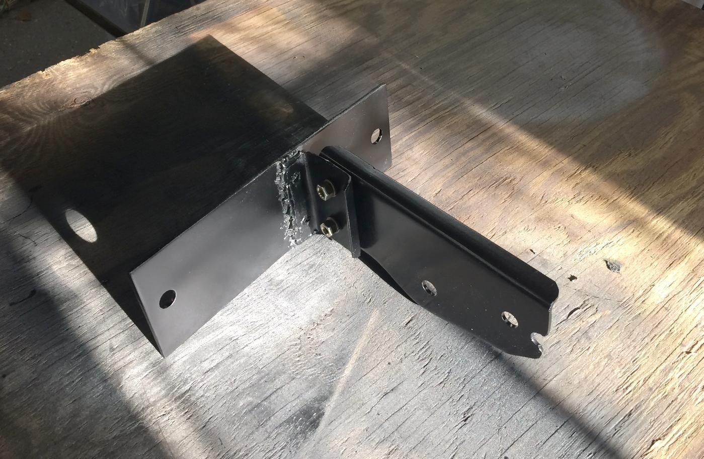

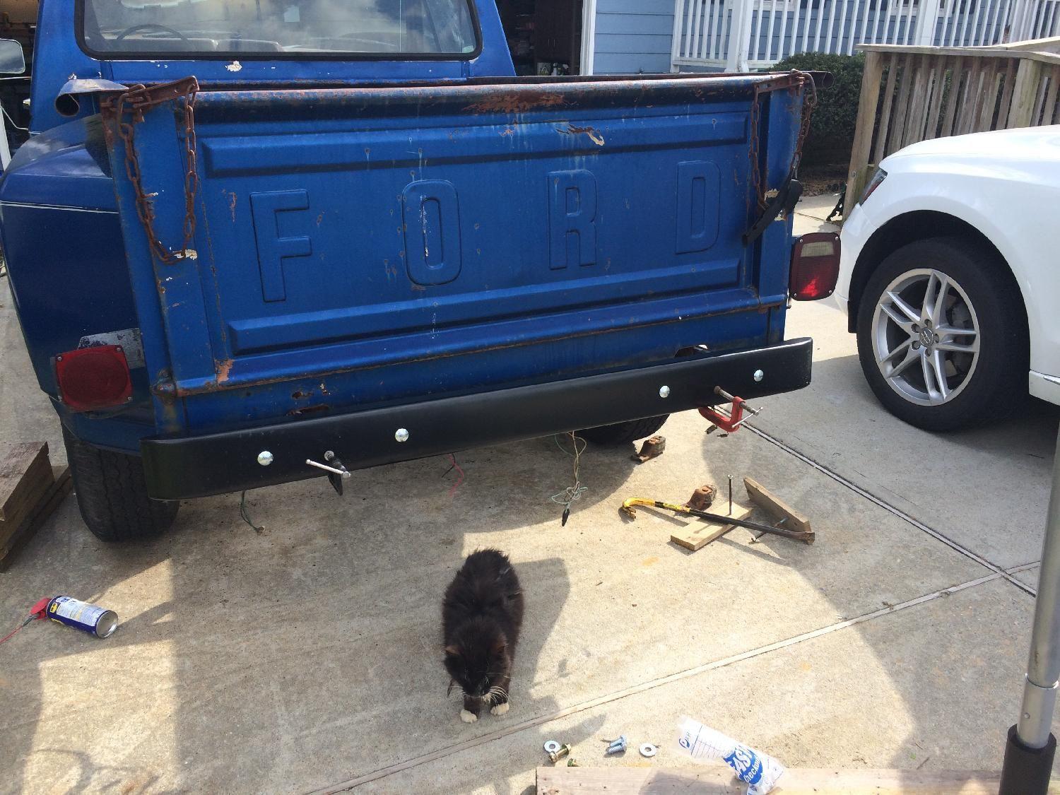

I clamped the bumper into place with the flat plate bolted on so that I could tack weld the brackets to the flat plate. It does look like it is drooping too low, but keep in mind the bed is currently held up about 1/2 above it's normal position, and that by drilling all the bumper bracket holes 1 size too big it gives me about 1 inch of adjustment up & down.
After finish welding & painting the brackets they are ready to go on the truck.

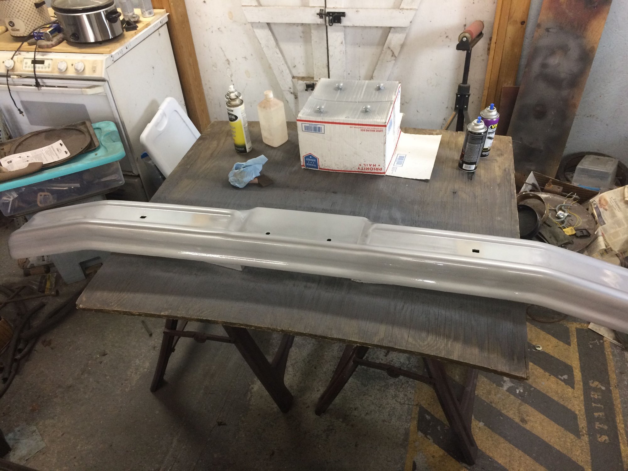

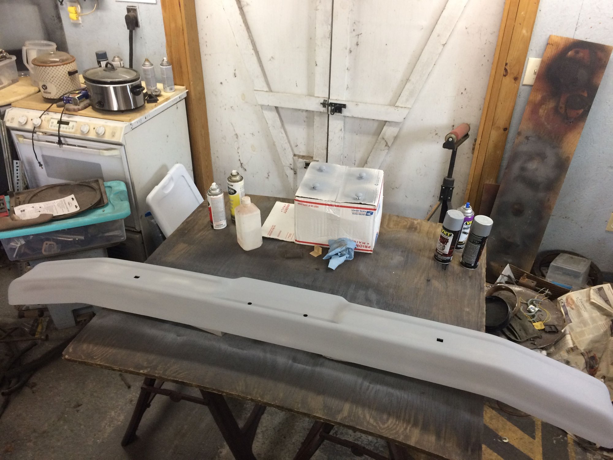

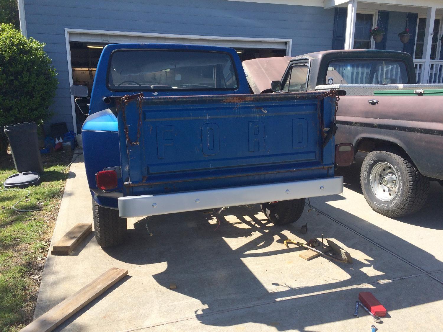

I rattle canned the new bumper with VHT "Ford Argent Silver" wheel paint and mounted it, looks great to me!

Looks great Now to paint the FORD on the tailgate the same color

John, bumper looks really good.
I will have to measure the bolt spacing on mine & yours to see what is different with them.
On the 69 bumper brackets that you used and cut up can you get them aftermarket?
If not its a shame you did them in. Might have been able to sell them and get the right ones as there is a member in the 80-86 area that makes them now.

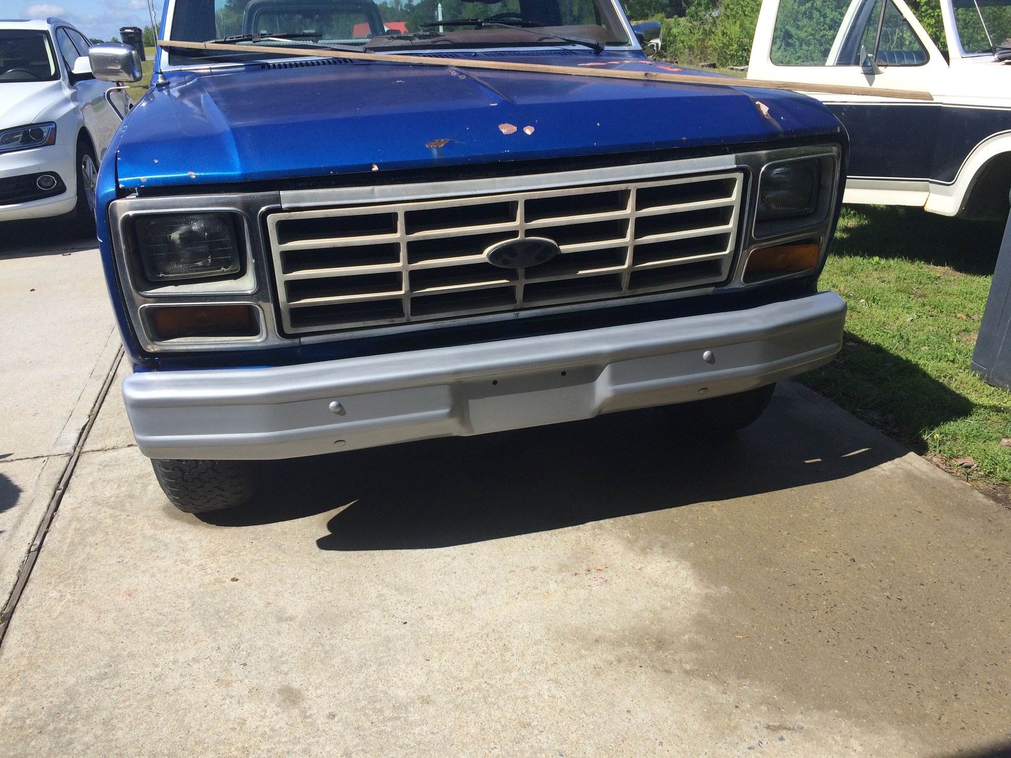

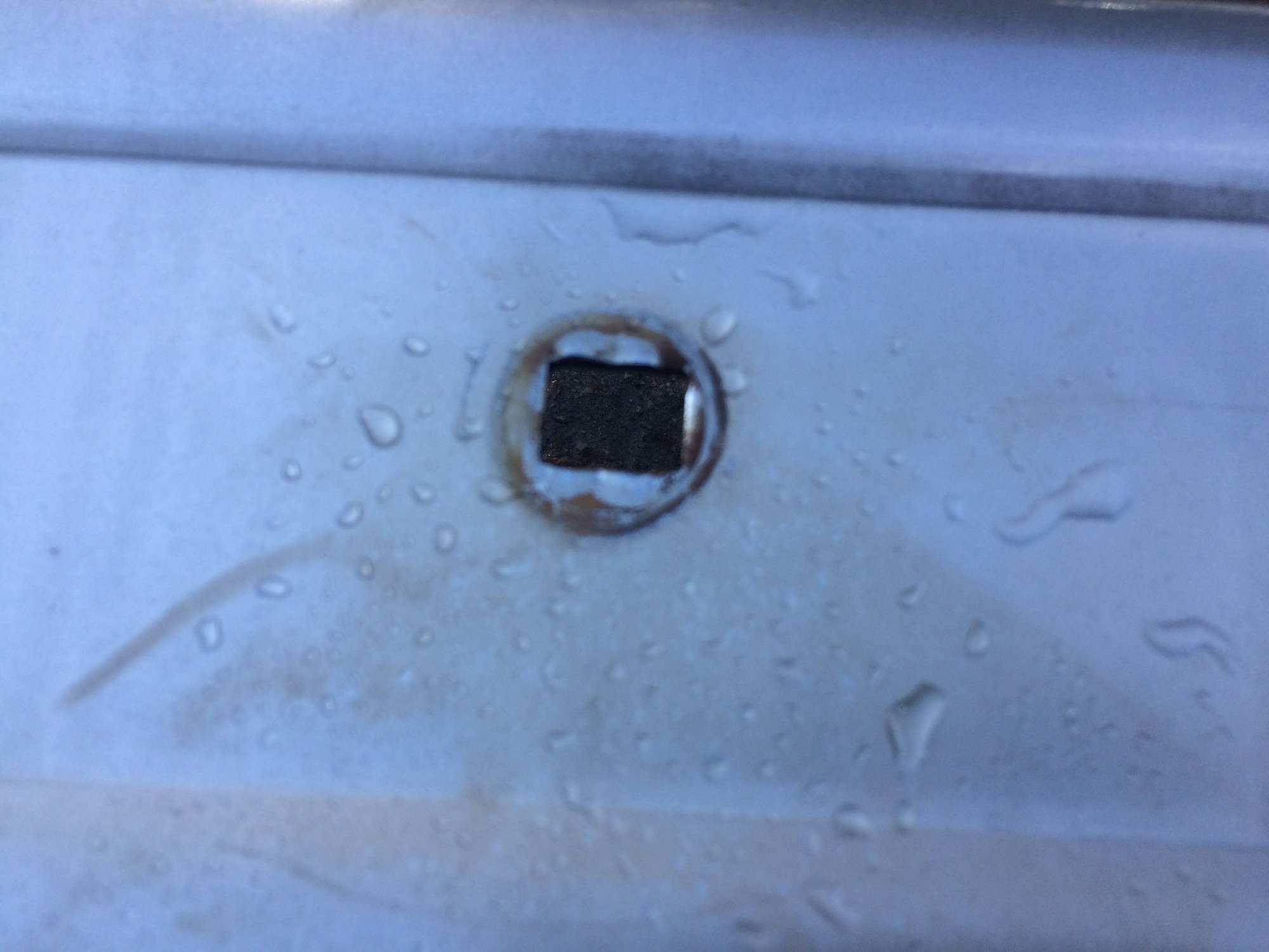

I went ahead and did the front bumper as well. I took the silver painted bumper off the parts truck, to use on my Flareside. I noticed something I had missed up until now, this bumper used to be chrome. I could see it anywhere the paint had been scratched, as well as underneath the bolt heads. I toyed with the idea of removing the paint, but I realized something. No one would paint over a chrome bumper if it was in good shape, so I have to assume that there was rust or pitting on something that made the previous owner decide that paint was better. So I just went with it, cleaned it up, sprayed some primer on any spots that needed it, then I rattle-canned it with more of the VHT "Ford Argent Silver" wheel paint. Installed on the truck, looks good. Once I do the grill, I think it will match and look well together.

Front bumper looks good but think it will need to come off when you swap the noses / radiator support around.
