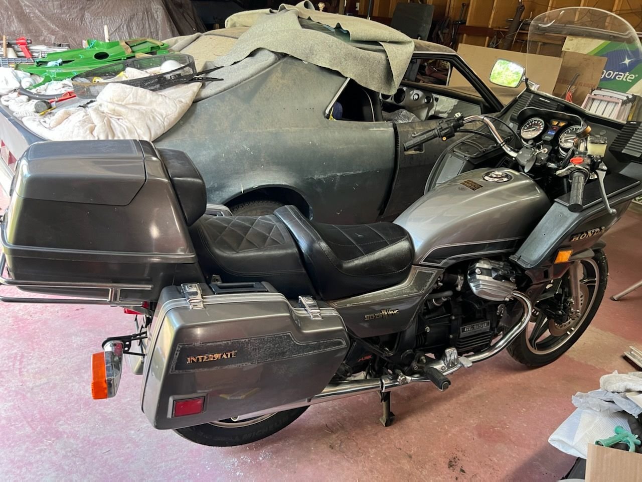

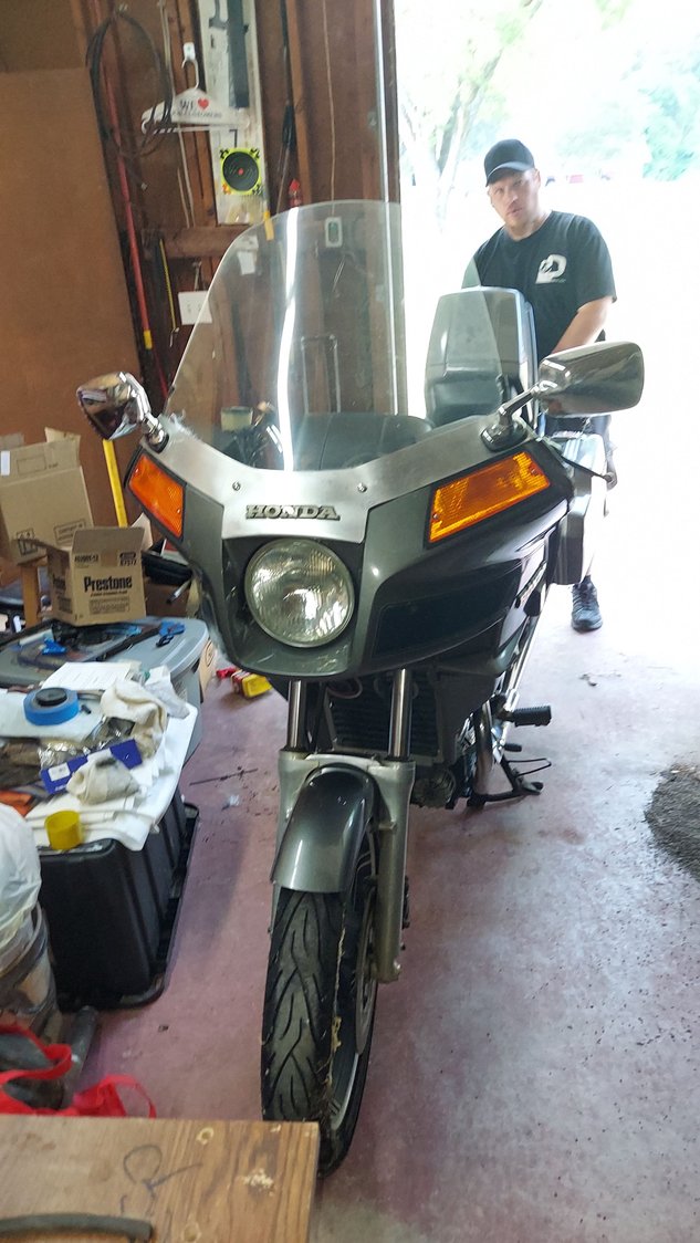

I picked up a Non-Ford project that the wife is not happy about but when are they
Its a 1983 Honda GL650I SilverWing with 37+k on it. A 1 year only model but I found a lot of good reviews on them from back in the day & later.
Told the carbs are gummed up from sitting little over a year so could not hear it run. Also told the cooling fan dose not work, could be sender or fan?
It cranks over a little slow, he always had a battery tender on it so I need to look into that but what little it did crank did not hear any knocking.
I need to go over it all like any new project.
I can tell you all the lights work and the radio cranks!
I did order some manuals and parts I know it needs to day and found a local dealer that I can try for other parts like brakes & filters.
