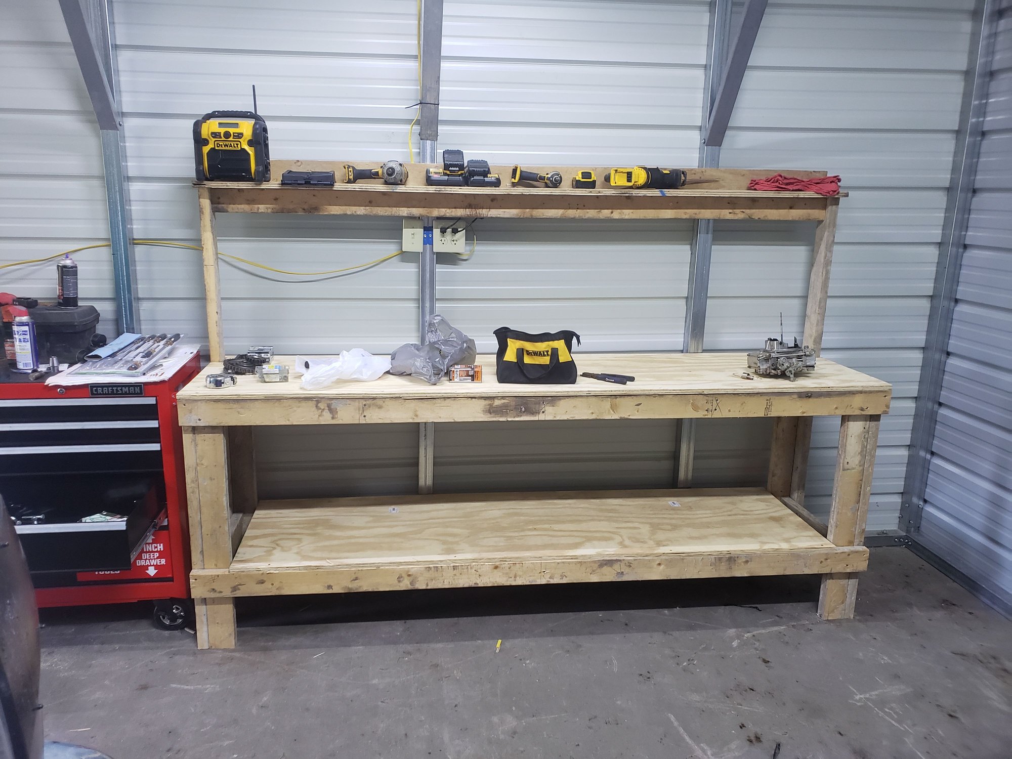

Well got a bench built, and a truck pulled in... definitely christened because it is leaking transmission fluid 🤦

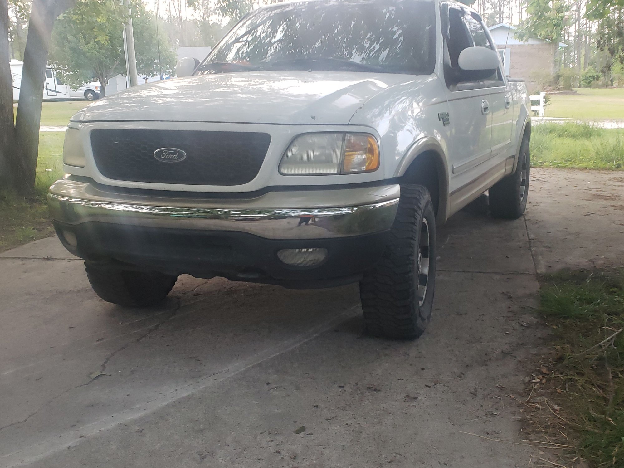

Got the thermostat housing replaced and recharged the a/c on the sport Trac.
Took the starter for the John Deere back to the starter shop, it was turning backwards, Bendix wouldn't engage. Got the new muffler on.
Finished getting the borgeson shaft ready to go in the f250.
Washed and waxed both trucks. Someone did some serious sanding on the hood on the Trac, between that and the hail damage, I'll just find a better hood.

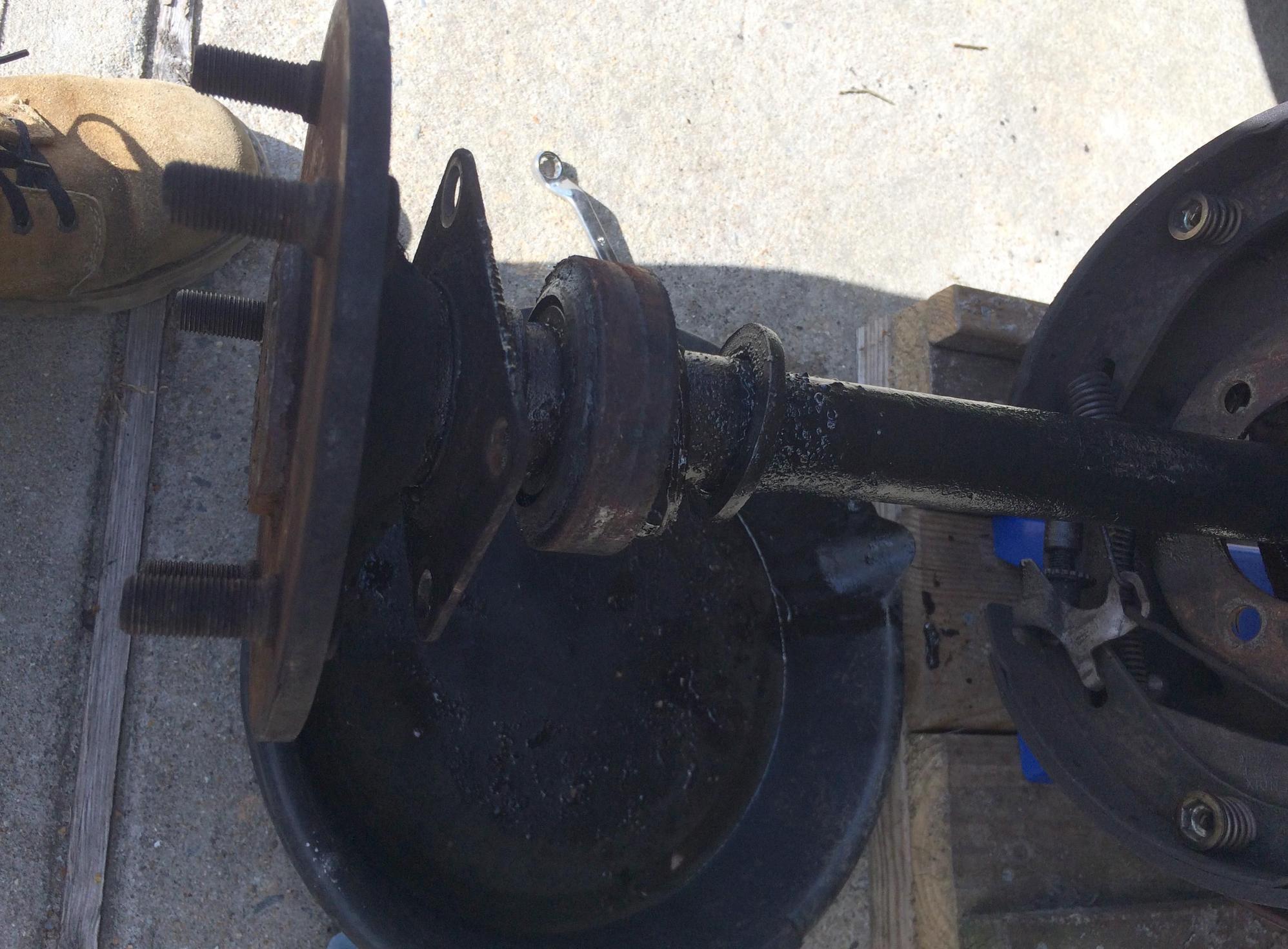

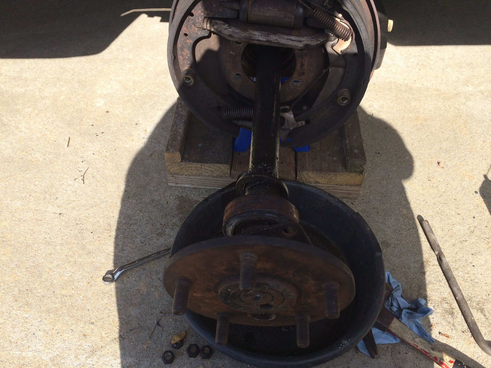

Got a leaking axle seal on the F100 (Ford 9 inch), loading up the brake drum with gear oil and then dripping onto the tire and slinging it all over the inside of the wheel well. Just a nice wonderful dirty greasy job to tackle! I can't get the axle out, I tried the backwards drum on the wheel studs trick, but it's not heavy enough. I have a friend with a slide hammer who told me Saturday he would bring it by and let me borrow it, but he never showed. Now I've just read about the so-called "chain trick" where you hook a heavy chain to the wheel stud, and then "whip" then chain, and that is supposed to jerk the axle hard enough to break it free. I'll try that later and see if I have any luck!

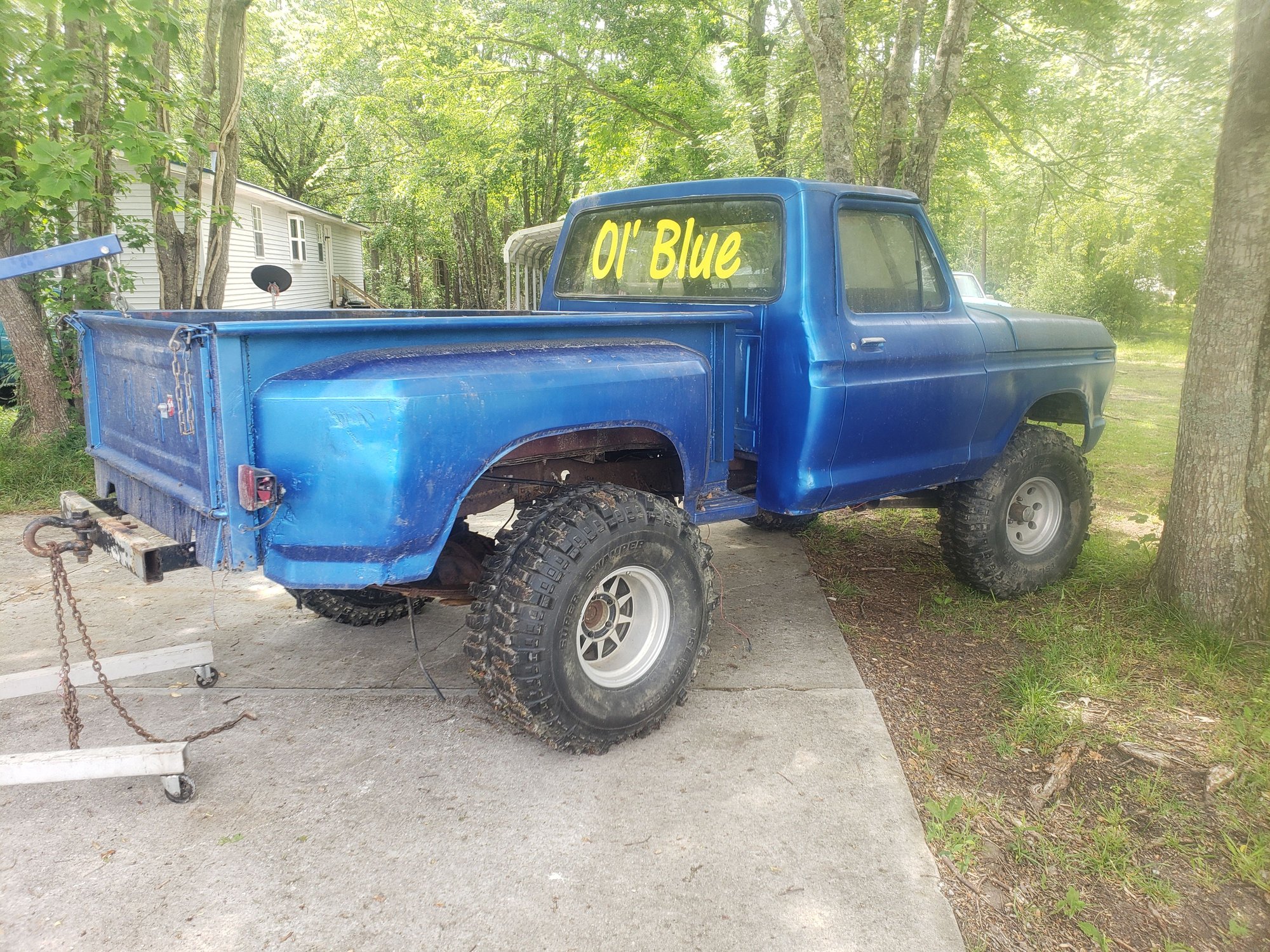

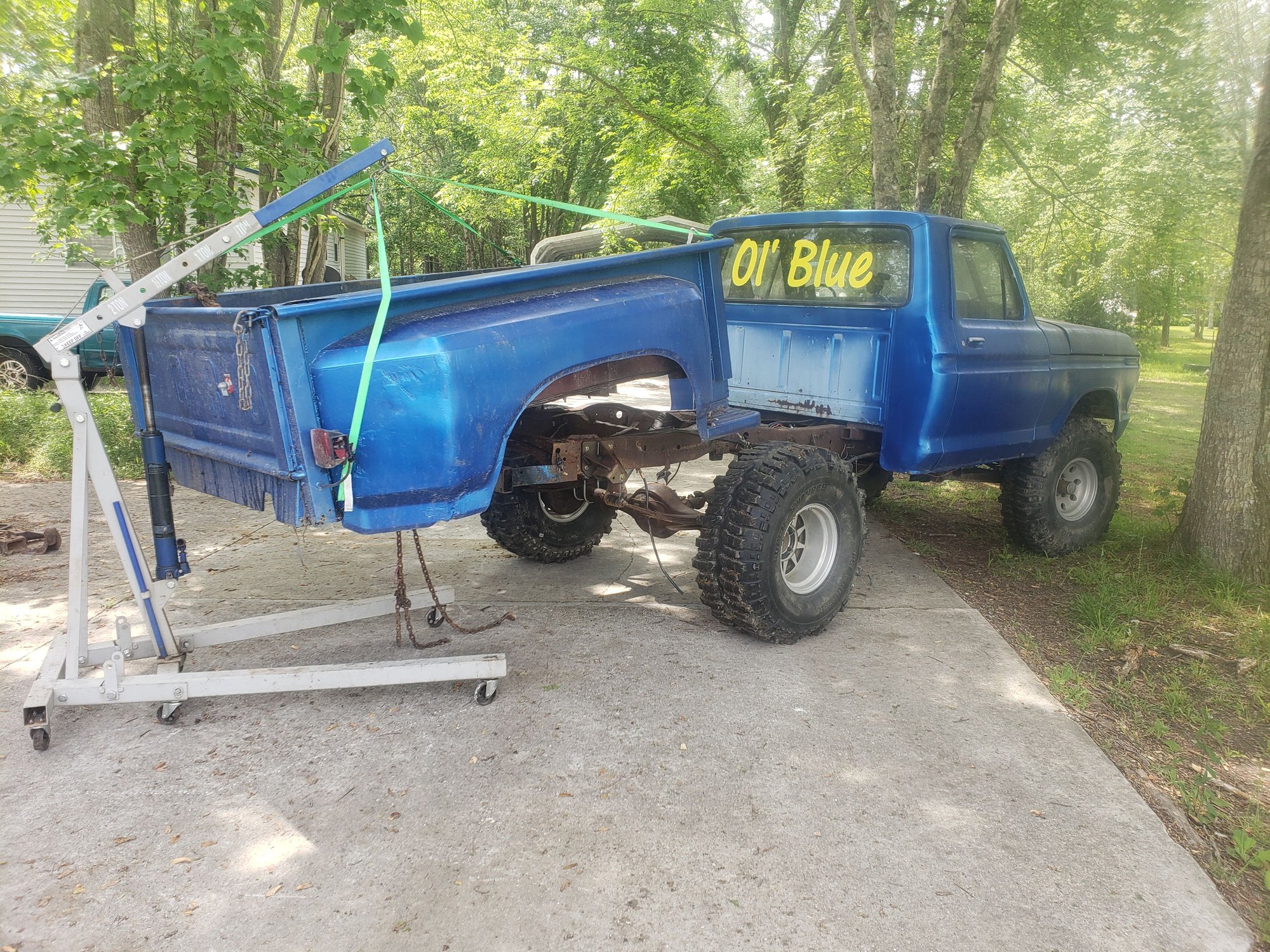

Well I sat the bed back on Ol' Blue today... it's not in place, but it's on it enough I could put it in the shop, so i did just that.

I'd just get a slide hammer from harbor freight or northern tool and be done with it.

I did the "loan a tool" from Autozone and got a slide hammer, I had to beat the crap out of that thing to get it out!
No wonder it was leaking and making noise.
