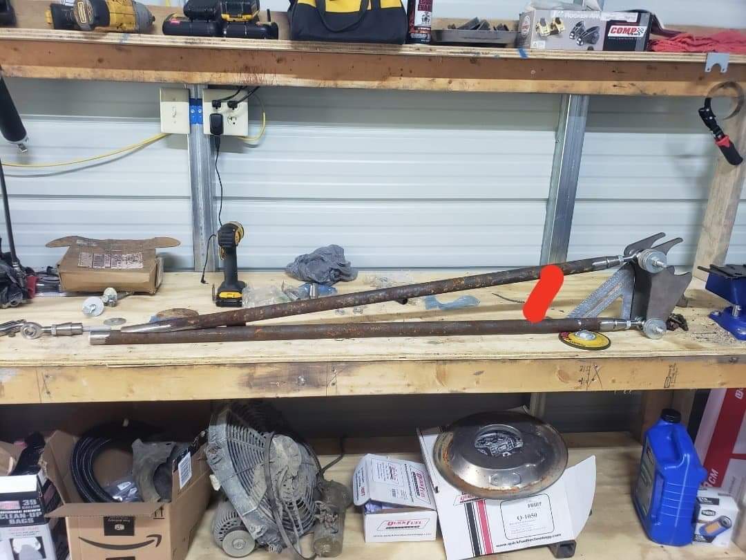

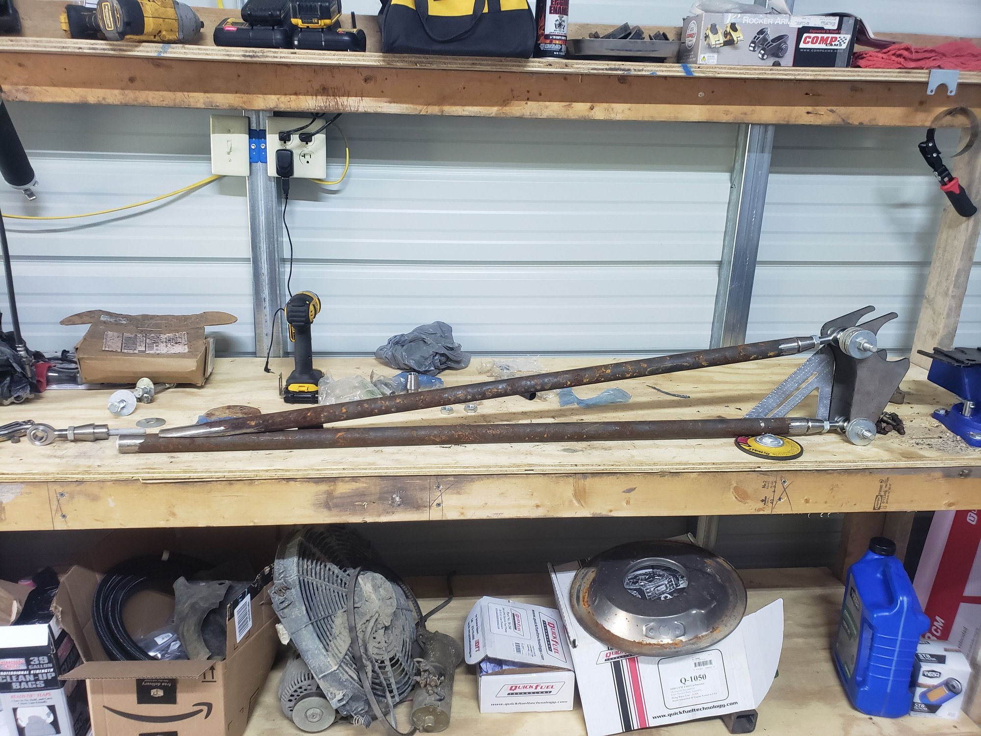

Well today I started working on a set of traction/ladder bars for my truck. I found a premade set for about $300 but they were only 32" long and from what I've been seeing I needed closer to 48". So when I picked up the DOM tube for my roll cage I also got some smaller DOM to build traction bars out of.
I'm gonna add 1 more bar in there to add strength then they'll be ready to install I reckon.

if it were me in addition to where you have marked red i would add a second in the middle between that point and where the bars meet...

I will see, but it shouldn't really need it.

never hurts to have extra support... especially when your dealing with something thats going to be supporting great loads of torque like a suspension part... even the canopy i built for the tractor has an additional one in the center of the triangle brace for added support...
originally i had it all threaded together with just some small tack welds to keep them from unthreading (even though they never should have once screwed together) on the tractor... but somehow he managed to snap it... i didnt have the triangle brace from the base to the front then... it was just supported in the middle about the same degree as the 3/4" pipe is... the pic there is from when i just did away with all the screw joints and welded it all solid pipe to pipe.. then added the ladder brace for the additional support... he hasnt managed to break it again lol...

I agree extra never hurts, but these aren't really supporting anything because for my class I'm required to retain a working factory type suspension. So I did the shackle flip, and removed the block so should make the suspension work better. These are just fancy traction/anti wrap bars.

ahh.. normally when i see ladder braces like that they tend to get under a good bit of twisting... why i figured the extra bracing would keep them from bowing under the stress...

Yea these aren't fully functioning ladder bars since I've got to maintain at minimum 3 working leaf springs.
