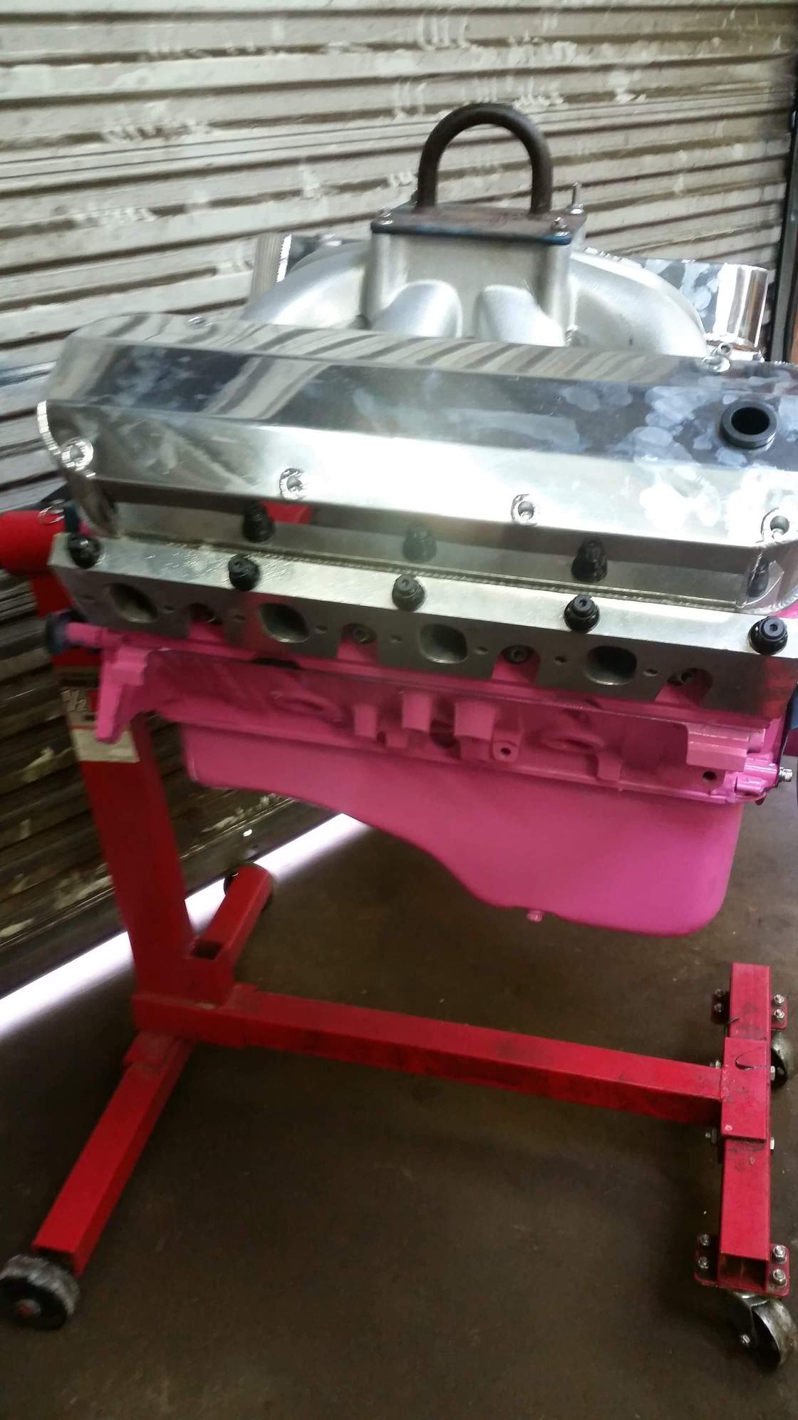

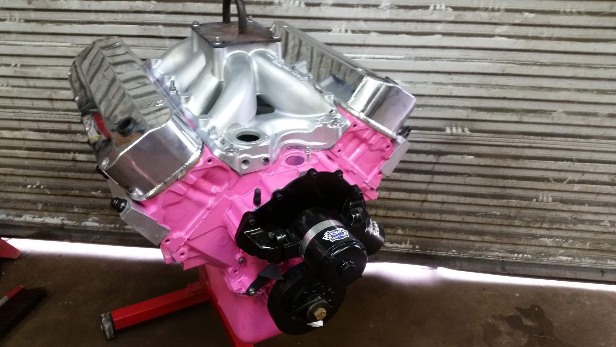

I present to you "Boggin' for boobies" by LEB out of SC. This is a short block I've had for a couple years wrapped up in the shop. It is a 433ci "factory headed" class rules build. It got a solid roller cam, some very heavily worked 72 model 460 PI heads, a trick flow intake also with a lot of work, CVF water pump. We went down, slid the cam in bolted on the heads measured for pushrods and then assembled. I've got to order the pushrods, then install them and the roller rockers. Drop the distributor in, and order a torque converter for it. Should be able to send a tiny bit of mud north.
Now I just need to finish the cage and other random odd and ends and I'll be ready to get it in.

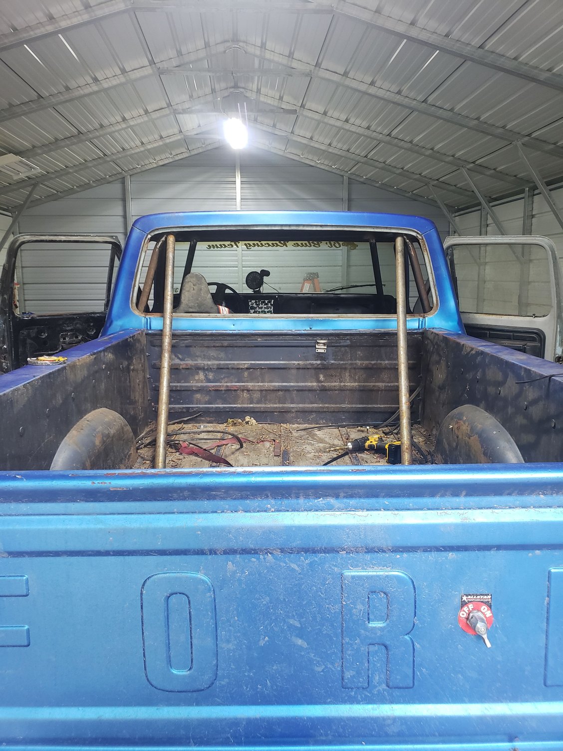

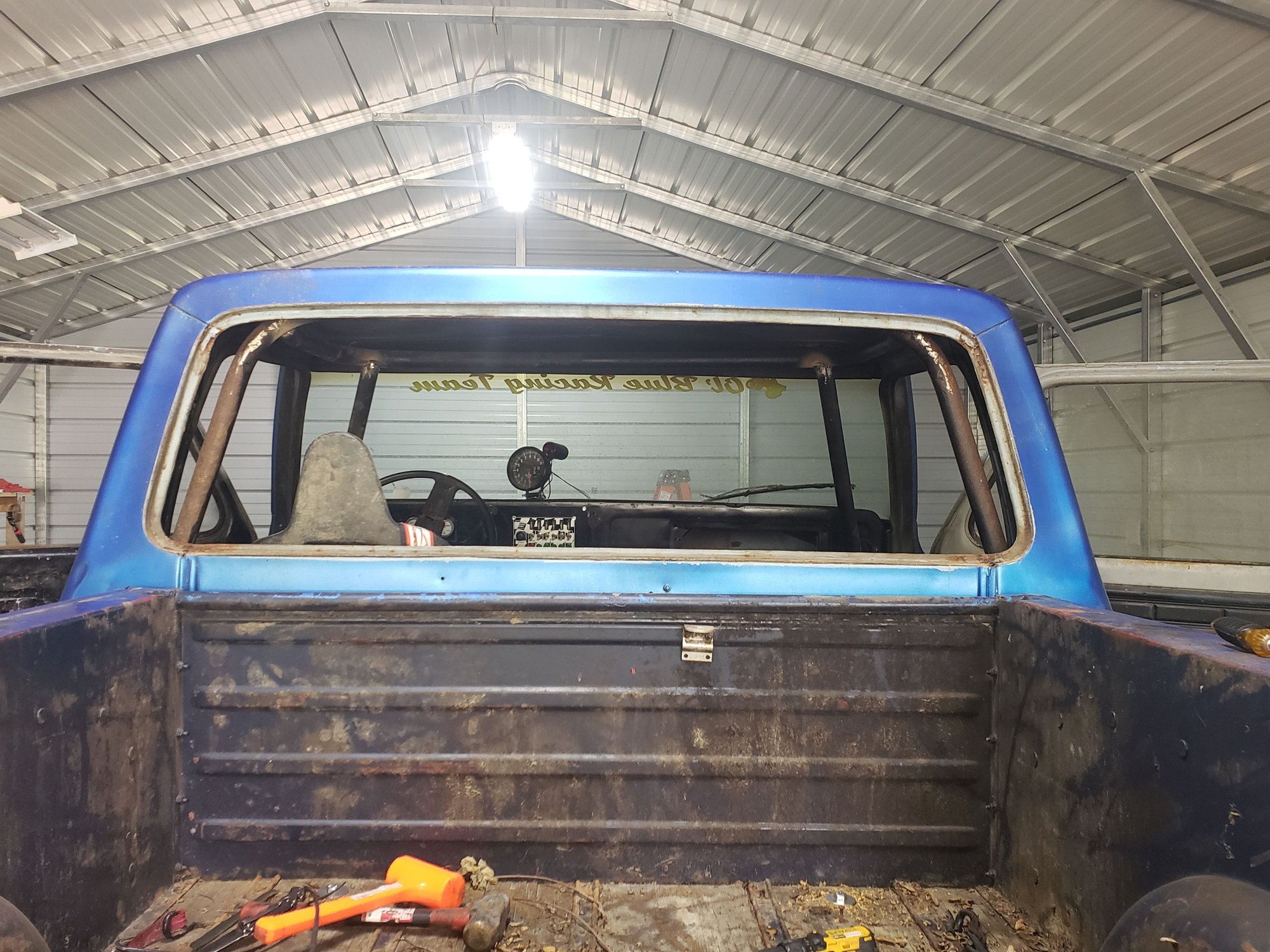

Did a little work on the truck today... took out the back glass, then cut, grind, test fit grind some more, test fit, grind and test fit. But I got the 2 bars to the bed fitted and ready to be welded in.
