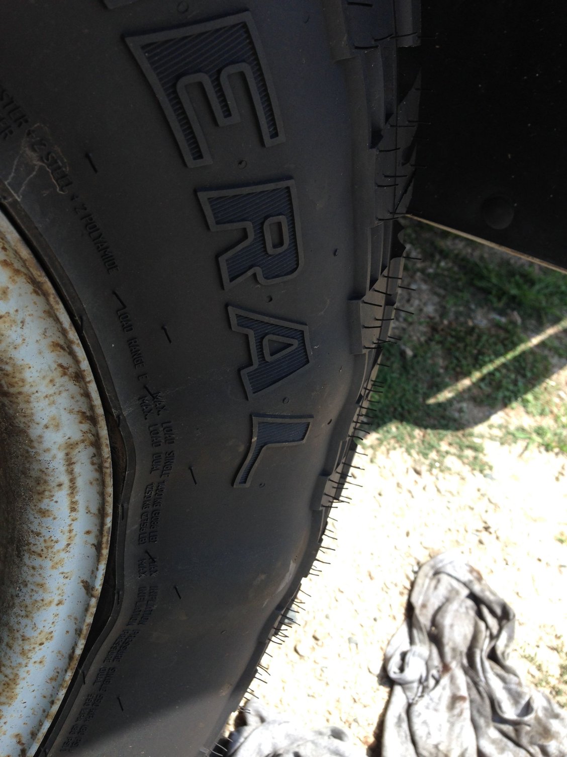

So i decided to work on adjusting my parking brakes today. When i pulled the outer tire so i could pull the axles and not make a mess of the rims with gear oil i discover this on the inner tire of my passenger side set.
For only having less than 3000mi on them needless to say im not real happy about that. Might explain why its been feelin like its got an out of balance tire back there too.
Got the parking brake adjusted some but still not perfect. Found the star wheels adjusted all the way down. I adjusted them out a bit but when i test parked it on the hill in the back yard it still rolls. So not really satisfied with them yet. But gonna let it knock the rust off the inner drum then readjust them later.

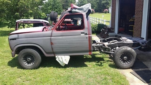

Put parts on and take parts off but this time it is all good!
Last weekend I prepped the under side of the hood & cowl cover for paint but was to hot but we have a cool spell so I got out early to paint the under side of the hood & cowl cover.
Wile I let it dry I cleaned out the bed of the truck so I could remove it at some point.
Once some what dry I got the truck turned around so I could get the hood on the truck.
You may ask "how do you install a hood by your self"? You hang it from the rafters and drive the truck under it.
Get the hinge bolts started then lower it some so you can get the springs on.
Once on it took a little bit of adjusting to get the gaps good and to close it felt good to see it on.
I then turned the truck around again to pull the bed off. I used a few 2x4's, some straps and my engine hoist to lift it off the trucks frame.
I then used my garden tractor & trailer and lowered the bed on the trailer and parked it outside by my race car & trailer and sons Jeep.
With the bed off I was able to blow the body filler dust off the rear half of the frame. I will need to wash it all off before the bed goes back on as it is looking a little shabby.
Tomorrow I hope to check the fuel gauges for the 2 tanks now that the bed is off and I may put some gas it a tank because with the hood on I cant cap the can I have been running the truck off of as it sits too high and would hit the hood.
Dave ----

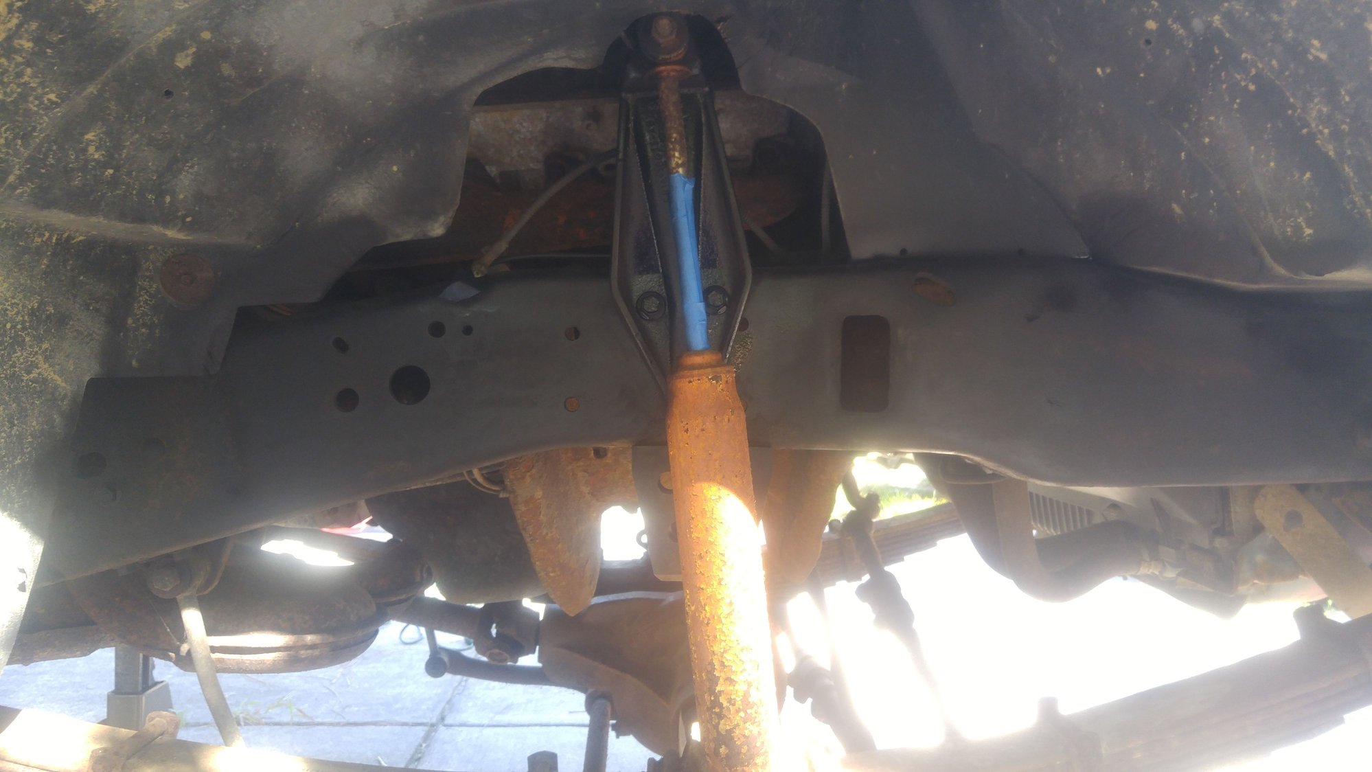

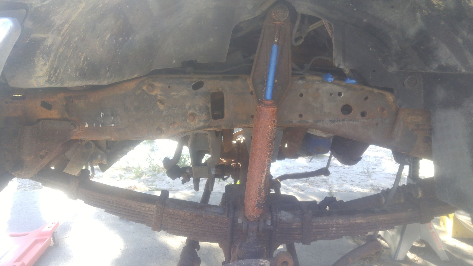

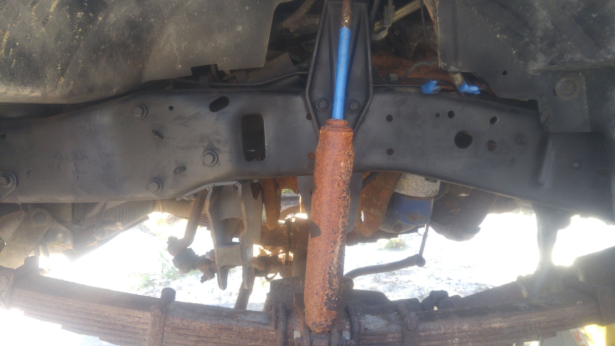

Update in The Beast
Been a while since I have touched the truck. Still on jackstands and didn't do a whole lot today, but something is better than nothing. Got out while it was still cool this morning and took the rest of the front brake lines off (easy enough). Then took the wire wheel and drill to the frame. Cleaned them up just a little bit and sprayed some rust reform on. Realized I lost my shade so decided to package up the calipers to return as cores and get some of my money back.
Front driver after wire wheel
Front driver after rust reform
Front passenger after wire wheel
Front passenger after rust reform
