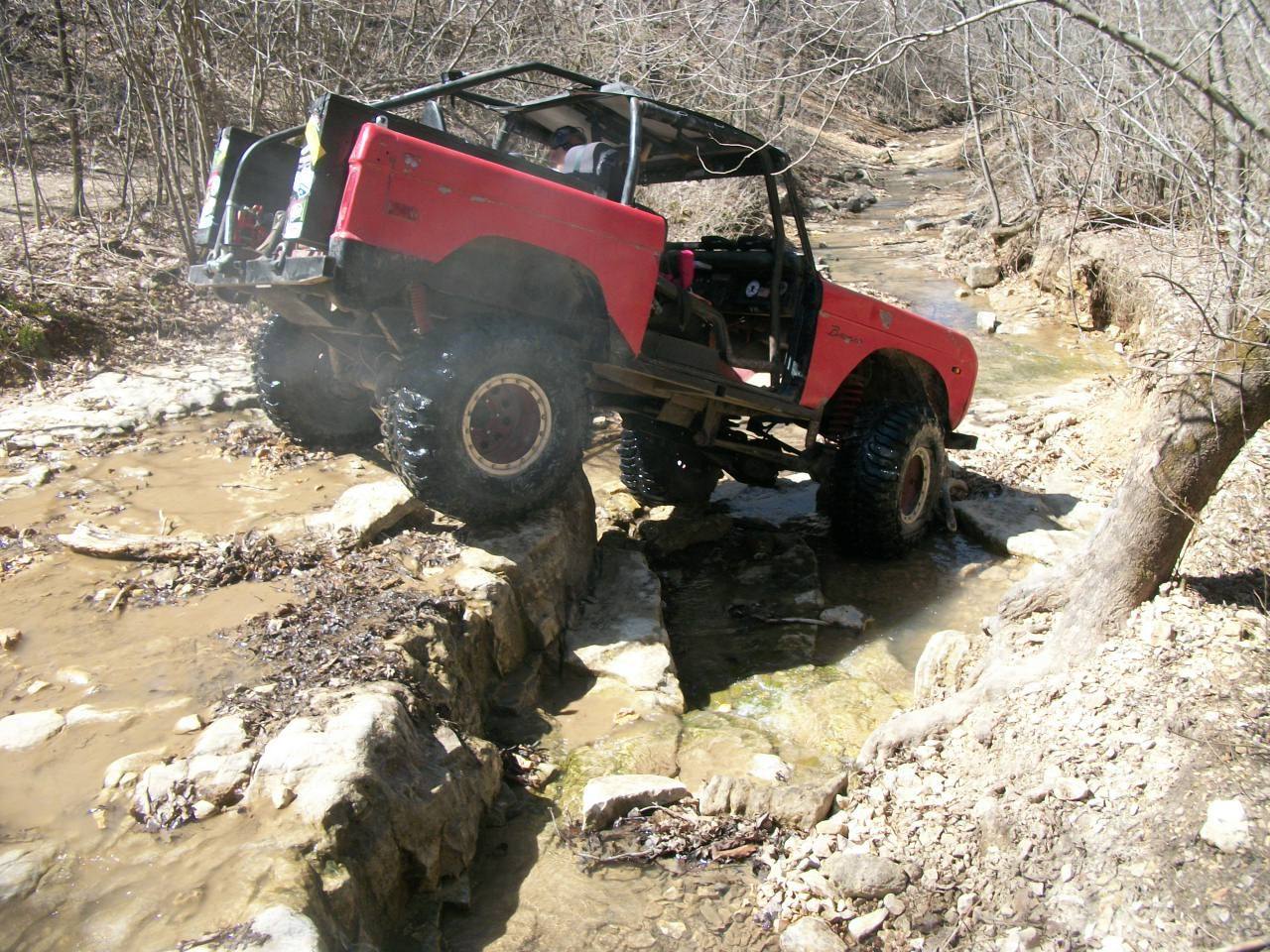

Old rig that has been wheeled hard and no easier since I got it....in my book its standard up keep/maintenance on a used rig. But it looks like the PO and PPO never did any. Good ball joints matter.....
This is why I needed the gas tank skid plate, when I came off the ledge, even going creepy slow, I smacked it good...real good.
No I did not make it all the way up and over...yes I tried. That picture does not do it justice on how step it is.
