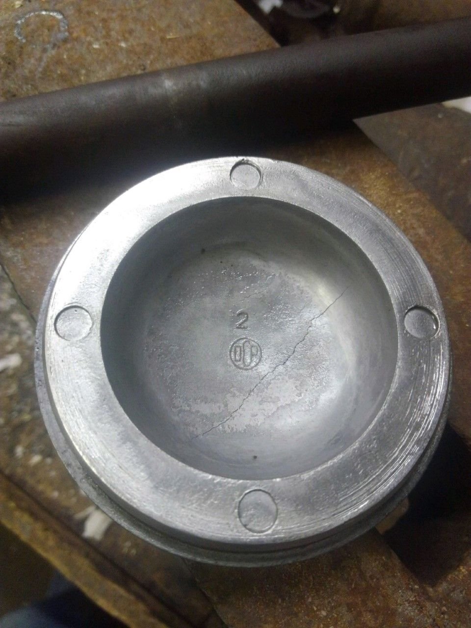

Well I sourced a replacement OEM cap (just to have on hand) and I got the cracked one removed. NO sign of anything hitting it from the inside of the cap. So not sure what cracked it. Driving fwd with the repair/upgrade route research.

Well I am at least putting the aftermarket HD end cap in there, to start out. After a talk with the local machine shop tomorrow, I will start to document the modification plan.

I measured the end cap that came out, it is 3". The one that I am getting from Diy4x is a 3" also. They offer 2 different sizes.

A while back I received the DIY4X 3" cap, it fits perfect diameter wise. Going to be a challenge to get it in there with a new o-ring for sure. Had to get a little "lip"
machined off the inside to get full movement of the piston. I also got my p/s box spare top cap drilled and tapped for 3/8".

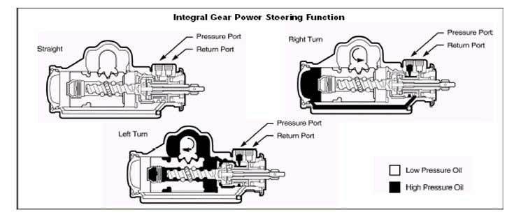

So the hi pressure line still comes from the PS pump to the PS box. I'm not sure how the bx is connected to the 2 fittings on a hydralic ram (got em on my sno plow). I C frm the info U sent the DYI line/drill out on the top (U describe a 3/8 incher above) plate/cover.
Gee, I must B dyalestic.
I could not visualize the hydro boost lines either when 1st exposed to the benifit. Sketches all ways "do it" 4 me. Is there one on-line somewhere (the last link or w/whatever, did not have a whole view system).What dia/length ram do U have?

No the steering box caps (end and top) are removed drilled/tapped and then the lines attach there and go to the ram ports. A very good video on it.
DIY4X ram kit. https://diy4x.com/product.php?produc...cat=249&page=1
Diagram below.... right turn pressure goes out the end cap port and to one port on the ram via a line. Left turn pressure goes out the top cap and to the ram other side port.
West Texas Offroad https://www.westtexasoffroad.com/ will drill and tap the actual box. I like being able to swap the caps in case I break another box.
