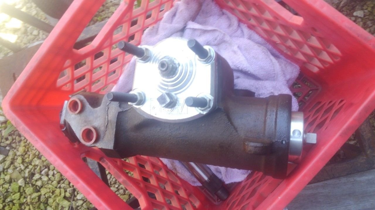

The Saginaw steering box cap upgrade starts Monday, I am searching for a new needle bearing to add to the inside of the cap. I am getting a spare Sag box sector shaft to take to the bearing supply house to get parts matched up.

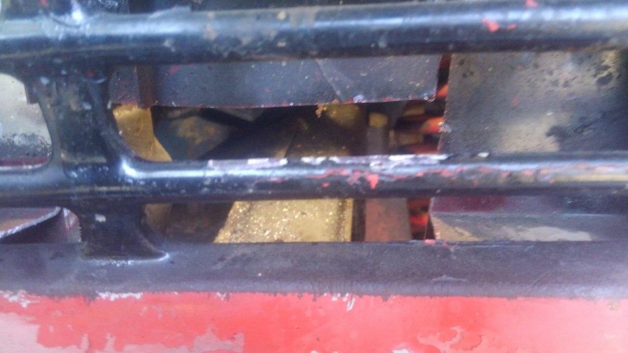

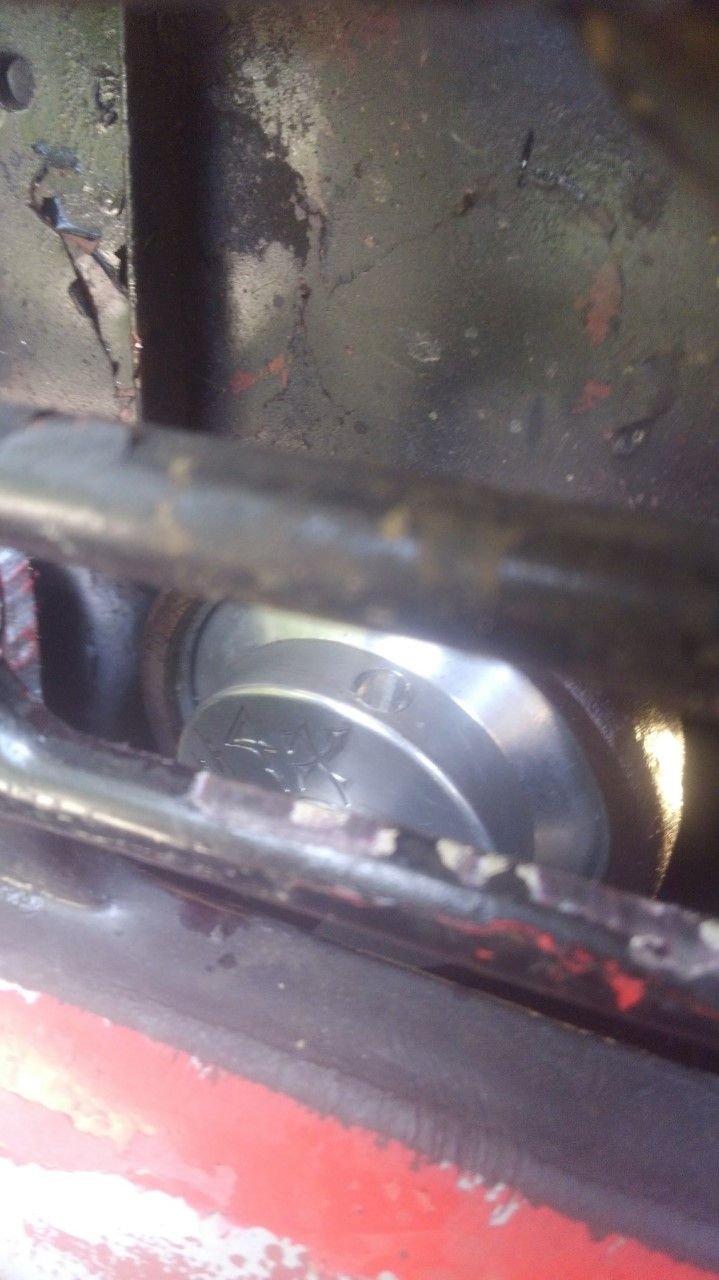

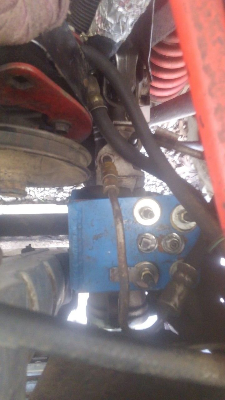

Well I had to cut a place in the core support for the new "tapped front" cap to have room. I love a pneumatic body saw with Red Diablo blades. Then I had to modify the "Blue Brace" to be able to bolt it down tight and still be able to access the 4 bolt "tapped" top cap area. For install purposes I just plugged them off for now.
Got the steering box installed, NOTE always connect the steering shaft before you bolt the steering box down. That way you do not have to loosen the steering column. It does NOT have a telescoping steering shaft. Got it all together, Blue Brace, Duffs brace and the front skid plate on.
Installed the p/s pump belt. Connected the lines, jacked up the front end and left the pitman arm off. Pulled the coil wire and bumped it over shortly to start the bleeding process. Added fluid, bump over, fluid, bump, fluid. Coil wire back on, started it, ck fluid, add a little more. Lock to lock X10 ck fluid, goes great.
Connect pitman arm, connect steering stabilizer, idle, jacked up lock to lock all is good. Leak ck the whole time, the new caps are holding great. Now take it off the jack and WTF its NOT working, it is like it is back flowing or hydra locking the pump, to the point it stops the p/s pump pulley and squalls the belt. WTF WTF I barely have any p/s.
I even did a lock to lock (with the front tires off the ground) (with the wifes help) and checked the fluid thru the whole range of steering. Level never dropped...
The fluid is moving to the fluid cooler (its warm) so WTF? Did my pump take a dump on me? Or am I air locked? Suggestions?
