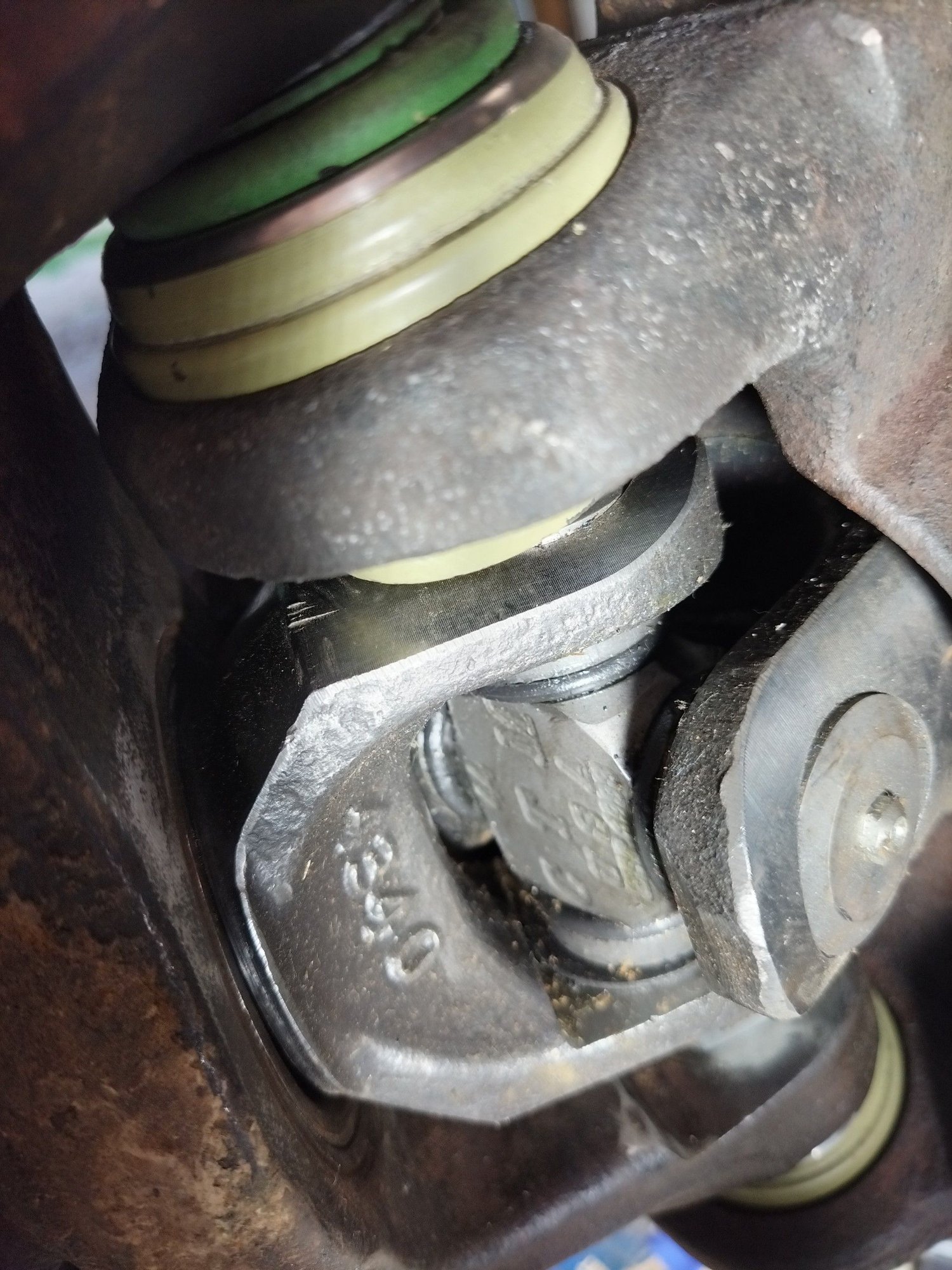

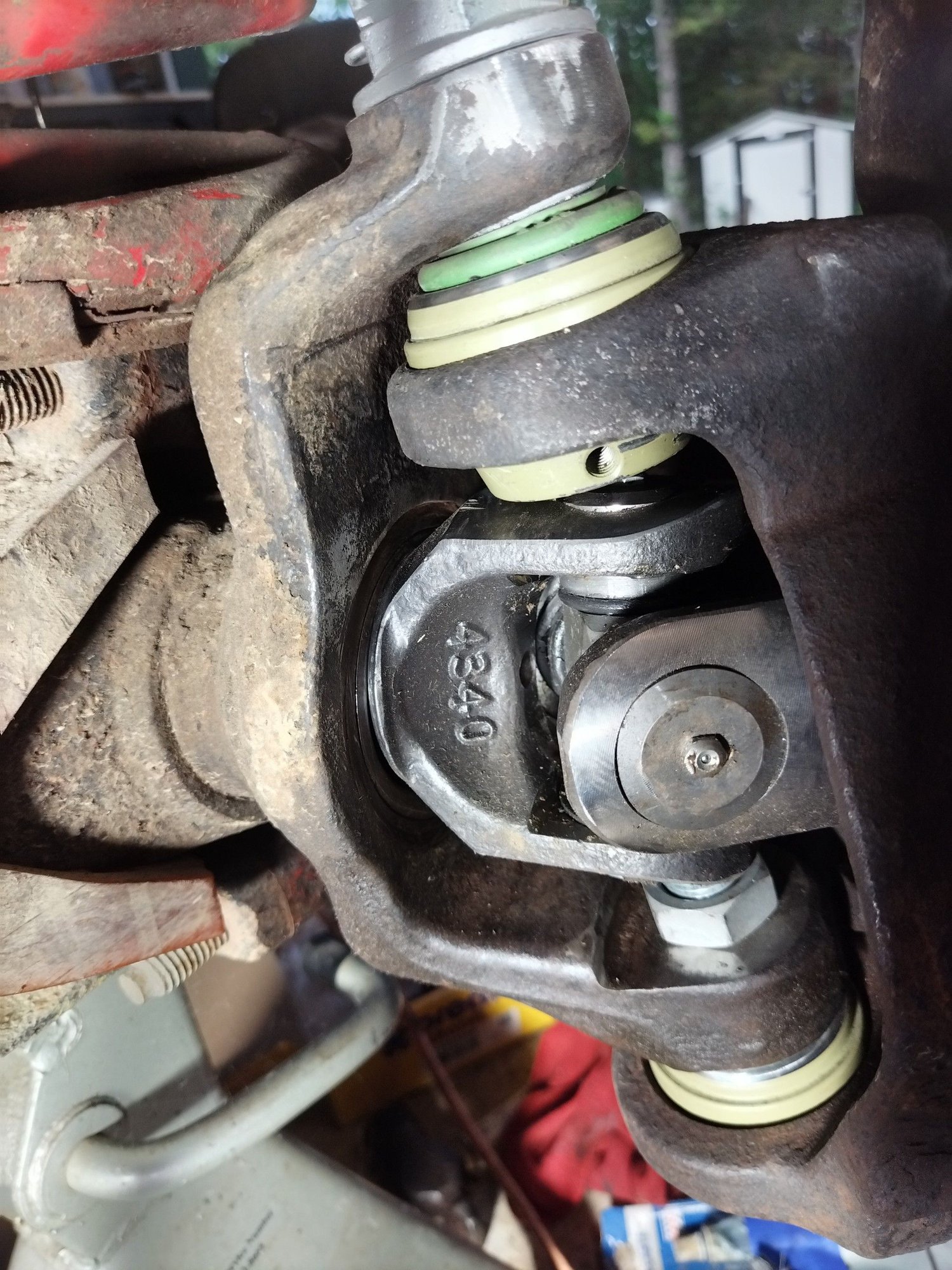

Well I hit a snag, I got the passenger side all back together and when doing a new lock in/out function check/rotational check (by hand) to make sure all is clear. And to check the steering knuckle stops are set correct. It seems like the new axles are riding crooked where they go in the axle tube. Almost like the new ball joints are WAY OFF causing me negative camber.
The old axle shafts/yokes were, for the most part, centered when going in and or gapped the same. On my new axle shafts, the yoke is contacting the top (of the axle tube) and I have a very noticeable gap on the bottom. The dvr side has the same issue, but less of a gap at the bottom.
So guess I am taking the passenger side all back apart tomorrow and starting over. And or checking it with the old axles 1st. I might blow it all apart and start over, but I know (or I feel that I did) followed the ball joint installation directions correctly.

Old May 3, 2024 | 10:25 PM
  #709
Tim Young's Avatar
Tim Young
Active Streak: 30 Days
Joined: Jan 2006
Posts: 21,341
Likes: 8,061
Well shoot, that doesn't sound good, bummer. Maybe the wrong ball joints?

I got the Bronco axle shaft issued figured out and put back together....for the most part. I put on the stub shaft snap ring on the inner groove and it holds the axle shaft out just enough to stop the axle yoke to axle tube C contact issue. I have never seen a axle shaft run so out of center when floating/fully seated in the axle tube.

Yea Paul I was like WT heck also, and sort of still am. But the snap ring (put on the inner groove of the short shaft) holds the axle yoke from bottoming out in the tube end. And there is no real measurable axle/yoke deflection when the knuckle is moved/swung thru its full range of motion. (stop to stop). And this was also checked while the axle was turned (by hand power) thru normal rotational turns.
