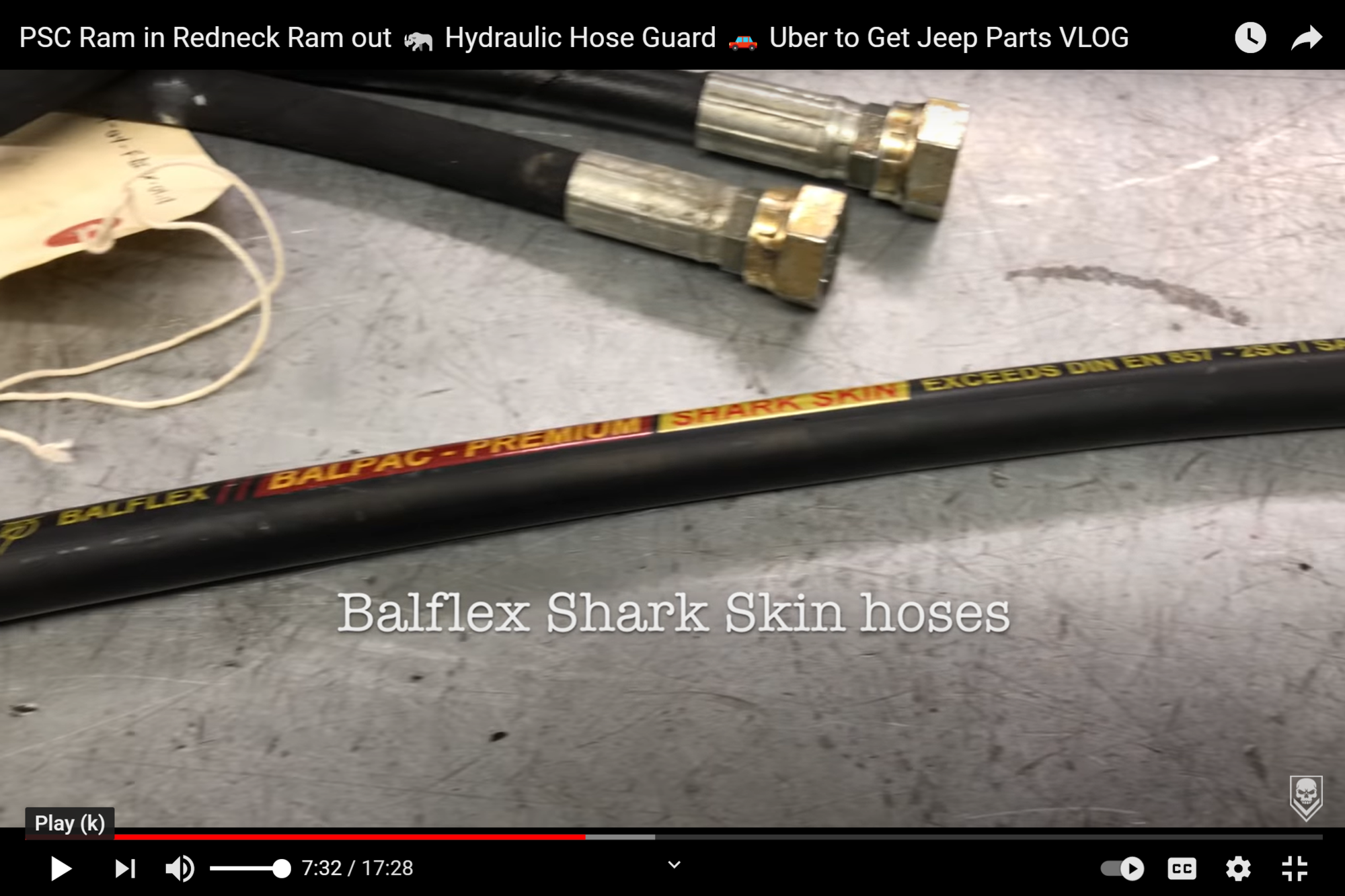

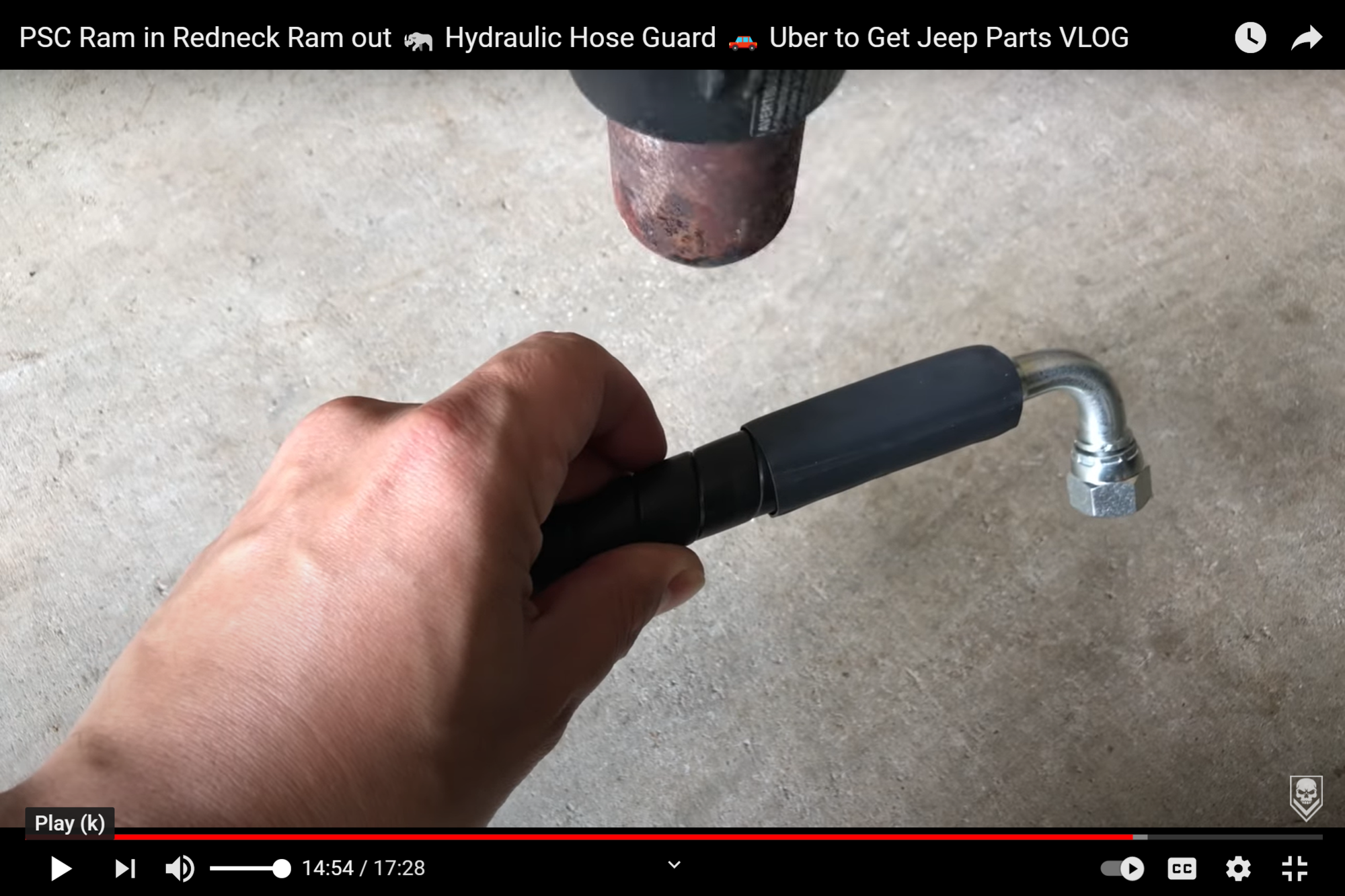

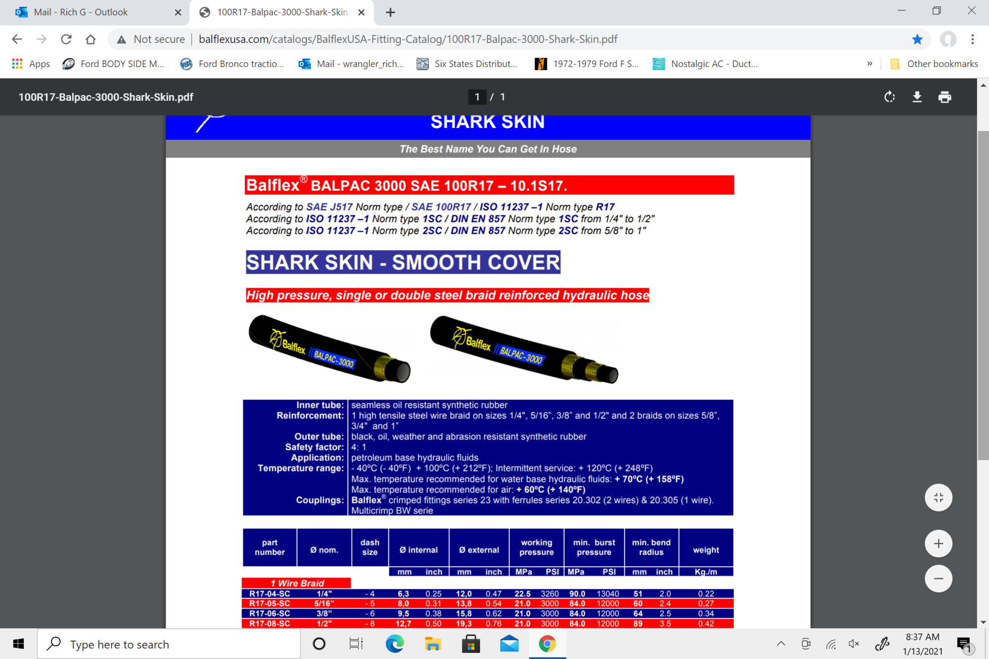

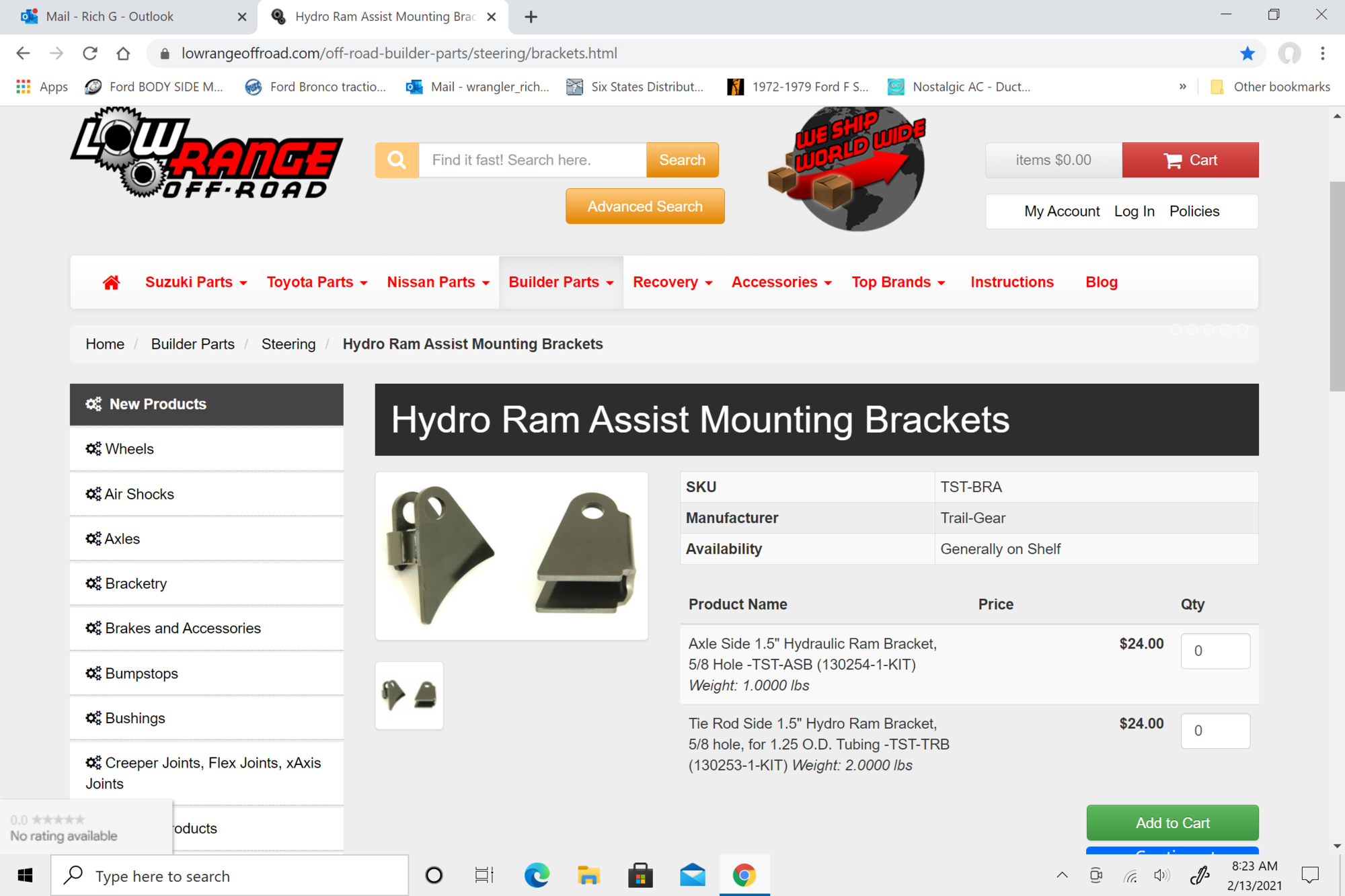

I am going to get my research on the correct tap sizes for the hydro assist mods back on track. I do not want to do this more that ONCE! I have a tall version of a Kiser Riser to work in the mix, or the below product. And some other good ideas to add.
Quality lines material.
Wrapping the guard material.
Heat shrinking the wrap in place.
