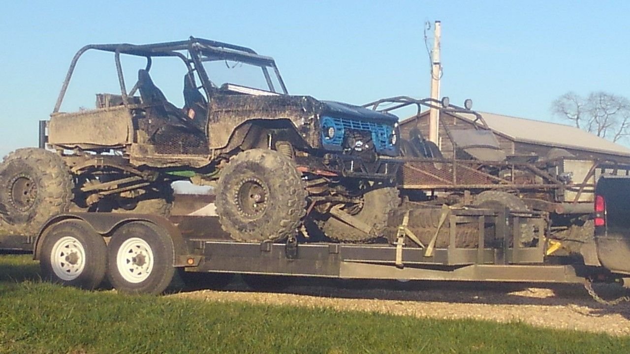

Got a awesome Craigslist deal on a like new Holley 670 Off Road Truck avenger 4bbl. It's on the Bronco already and working nicely, I have to do some quick fine tuning dial in and then we are getting ready to test it out this coming weekend. We are heading to SMORR (Southern Missouri Off Road Ranch) right after I chow down on a turkey leg thursday AM. The son in law is taking his newly acquired 76 Bronco also. Pics to follow...of course.

New carb tuned. Swapping on the like new 35x14.50x15 boggers tomorrow on ol red. And putting some new 38.5 Super Swampers on the other rig. Hope to have BOTH on the trailer for Thursday AM road trip.
Pics to follow.

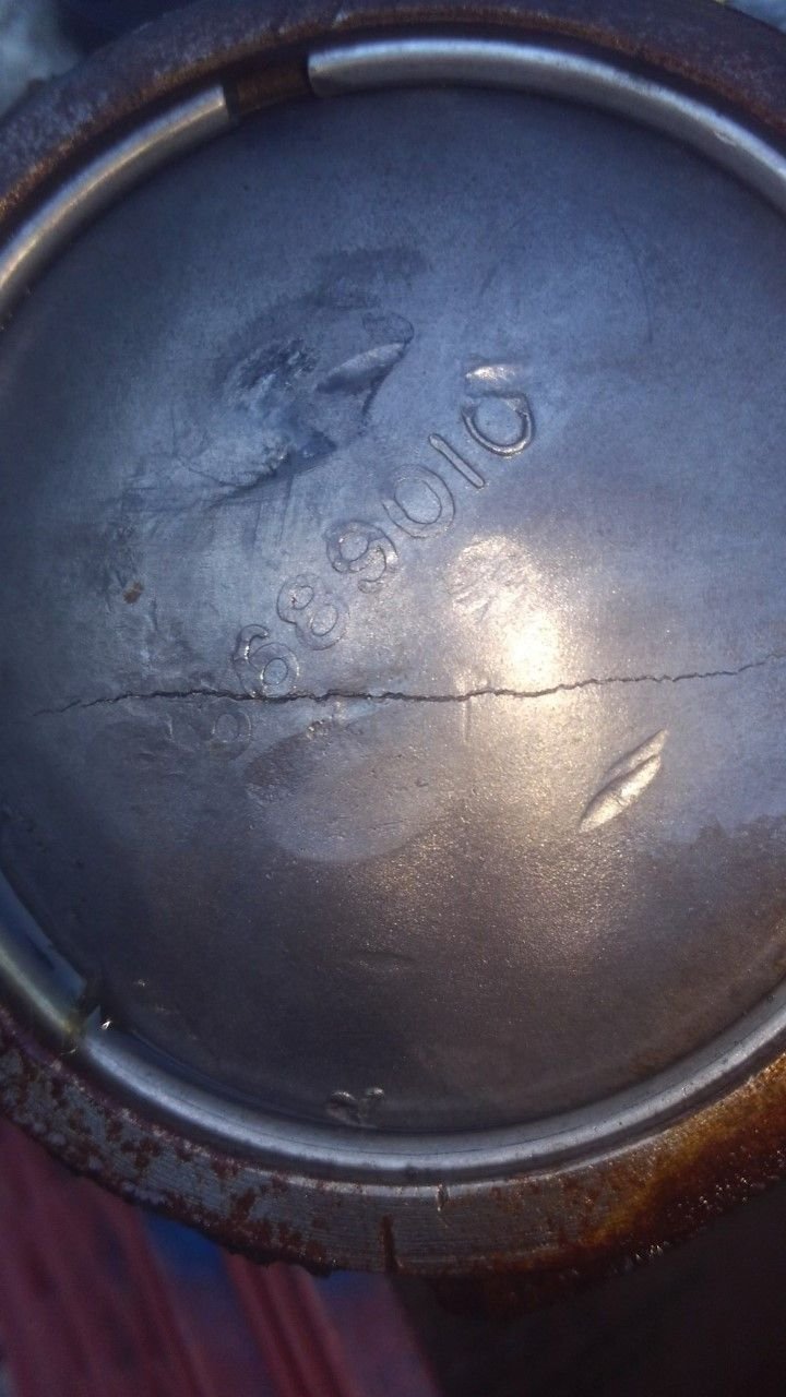

Well the new carb is a winner, no issues on nose up, down or laying it on either side. I wheeled it hard Thursday afternoon, and late into the night. Friday same thing, then on a level 4 trail named (Bronco Buster) it popped the steering box front end cap seal. After a fight to get it down the rest of the trail and back to camp. I loaded it and took it home and swapped it out for the rail buggy Bronco to wheel friday night and all day Sat.

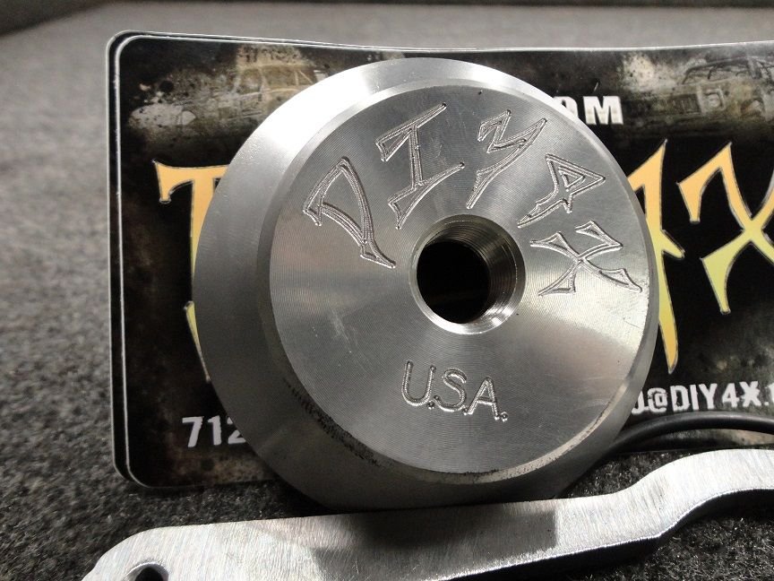

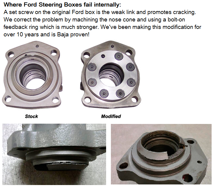

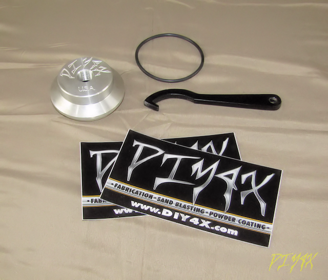

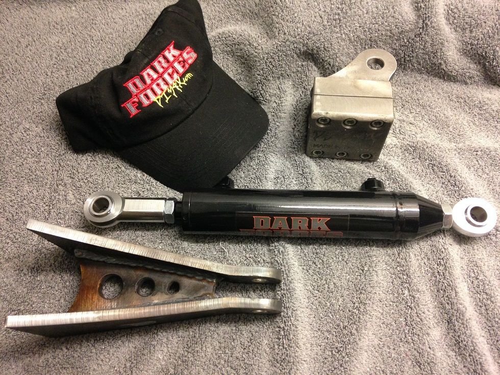

Steering box removed to research the leak, NOT the input, output, ot top cap seal. Something from the inside of the steering box cracked the end cap when on my last off roading adventure. Tomorrow I am working on locating a end cap and figuring out what caused the crack. What hit it from the inside?
Possible upgrade components for the plan to go hydro assist. https://diy4x.com/search.php?mode=search&page=1
https://diy4x.com/product.php?productid=17848&page=1
And then maybe something like....https://diy4x.com/product.php?produc...cat=249&page=1
Might not be enough piston stroke length from the one above, more research to follow.
And then found this info...https://www.howeperformance.com/
https://www.howeperformance.com/parts/steering-boxes/
Decisions decisions.
