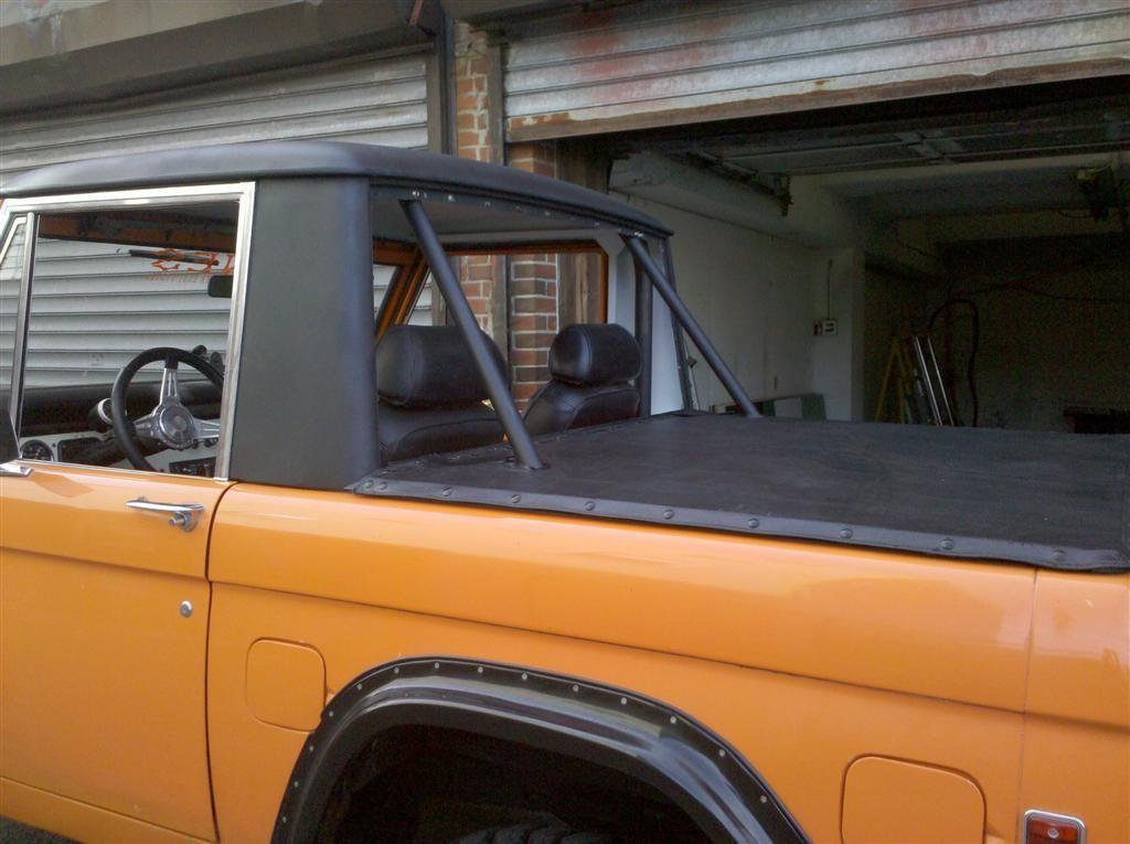

several fellas use the lift gate window (upper 1/2) for the back quarter. This way there is an open/close, righ sized back. i doubt you will be doing this as the bars are there, U may want total access but ur mock up reminded me of it. I wanna find a '70's/80s mini truck slider that fits instead. Migin it in is easier than finding one to match.

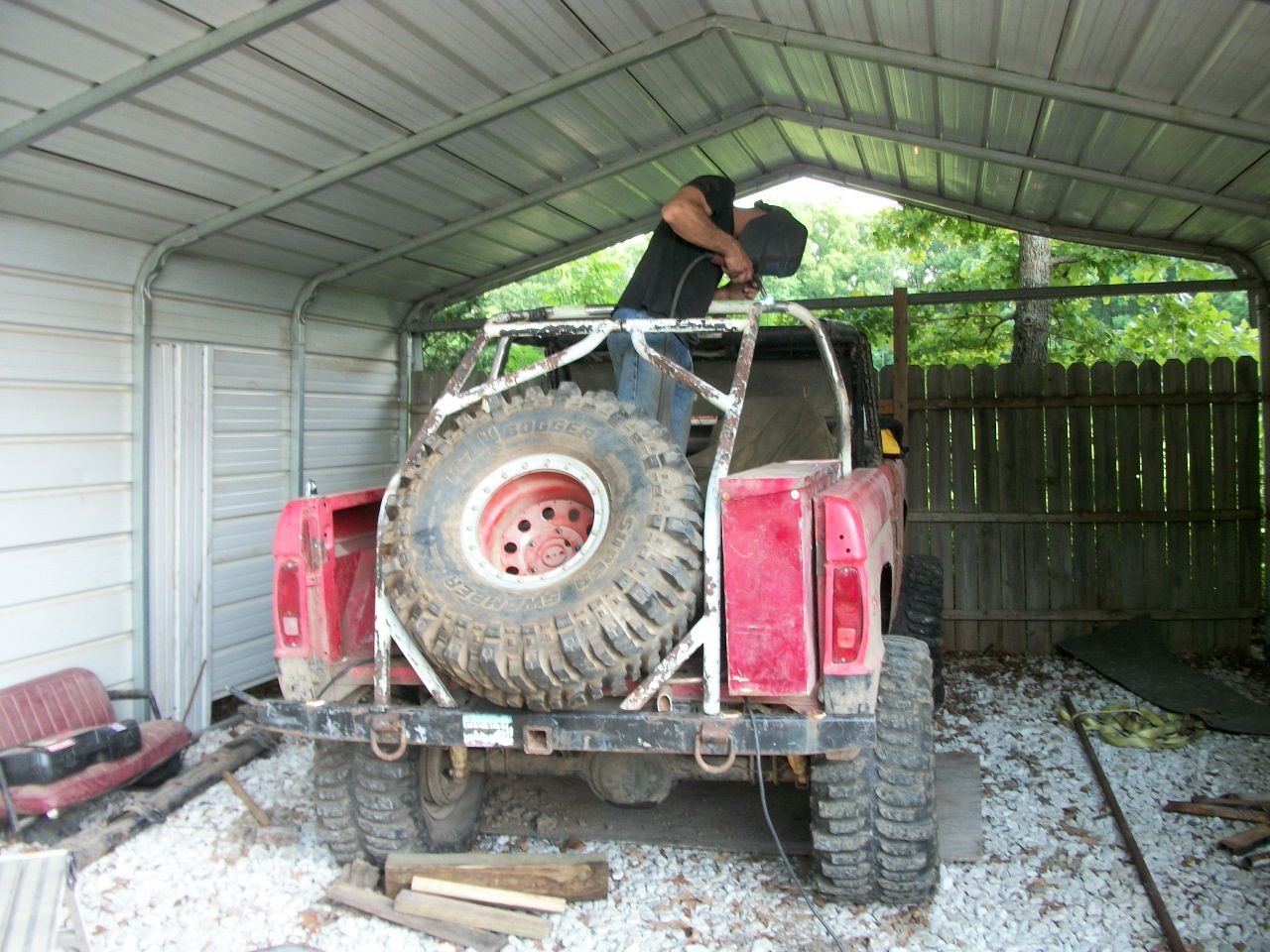

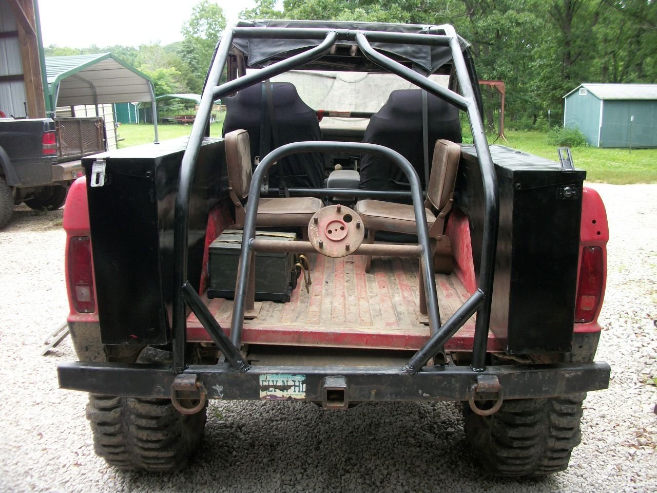

Yes with the roll cage down bars, a solid back window is not an option. But it caged my spare tire nicely (now removed for better reward vision).
Notice the behind the seat cross bar it taller than the front just a bit. That way I did not have to worry about hitting my head. Or it being inside a square.
Had to modify the bikini top to fit. I cut slits and added velcro closure.
See how both seats are pushed back a little bit.

mine is 1/2 cab now (have 3 tops but this is 8 yrs worth). Damn thing came in '82 for 250$ total (S/H included) w/bulkhead all the way from Jeff's to MA.
I appreciate the links to the blk top (& it's details).
I see now how lill U changed the tire mount. @ 1st pic I said "WoW he's done some big changes" but see it more an adapt. It
will B awhile B4 U change tire sz again?
On CB I guy showed the removal of sides from a wagon top. Solid metal, full "bikini" roof - bolted to roll bars...
Like the back of 1/2 cab above he left a flange for pop-in/out canvas/windows.
BTW what do U use for roll bars? DOM? what is inside/outside dementions in inches - how thick is the tube wall?

I used what ever the guy used to build the custom roll cage for the 79 Bronco tuff truck did. I took it out the 79 Bronco and made it work in the 71.
Sorry not sure about the tube specs. I have a left over piece I can mic tomorrow.

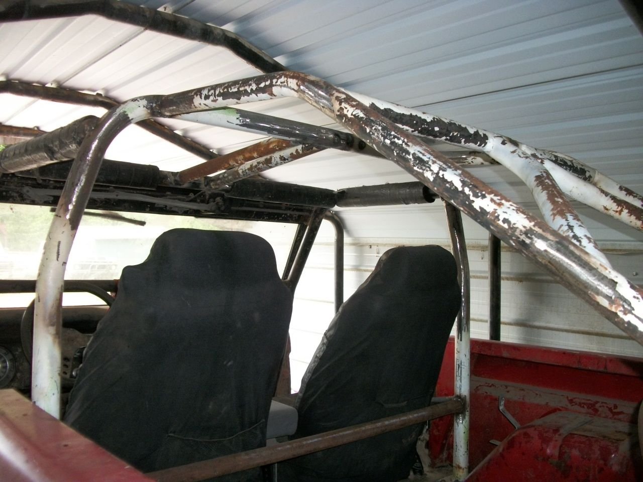

no mic needed. I was wondering how thick it was for safety. They say not to use 'pipe'
but the DOM spec.ed stuff. From memory duz it look 3/8th? and 2 inch around?

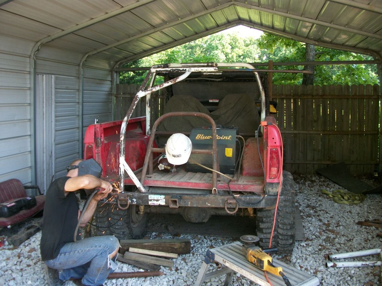

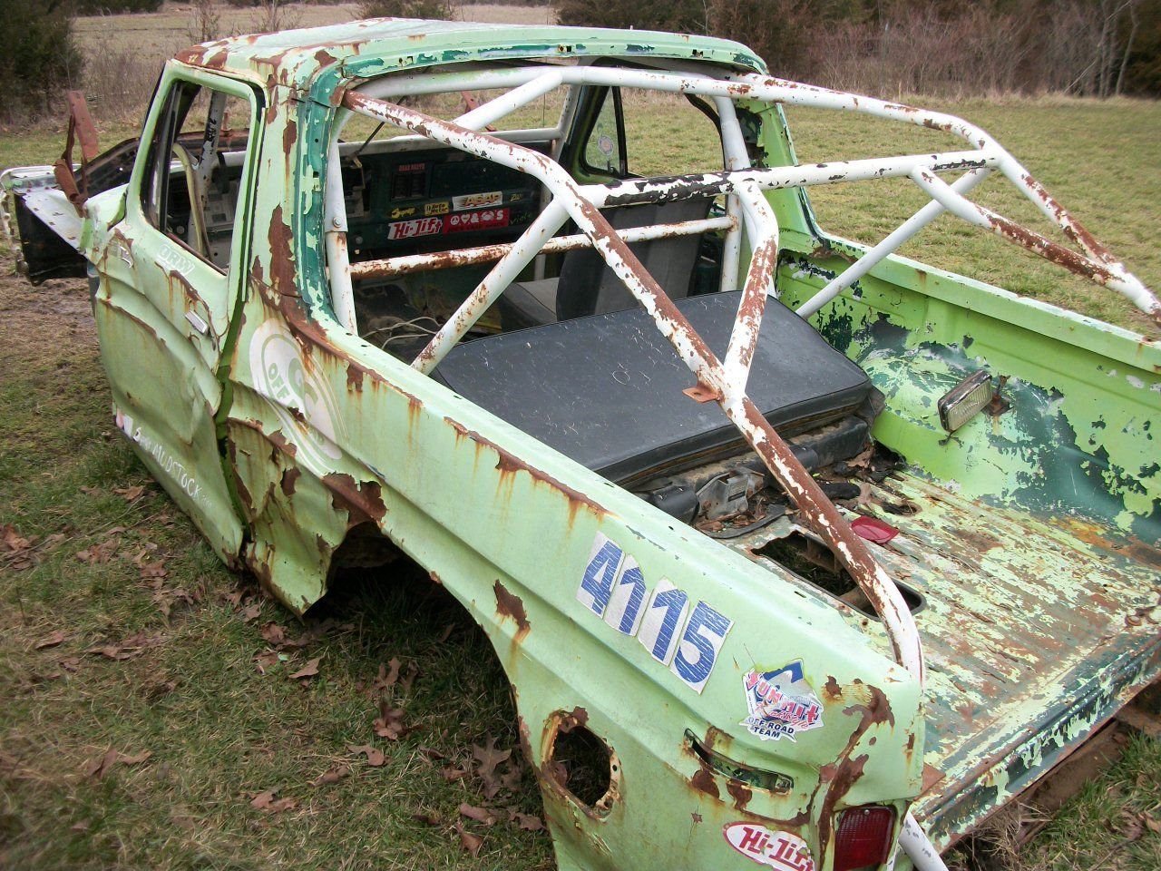

So when I was looking into buying the green 79 Bronco, I asked the owner if the cage was built with DOM processed material, he said yes. The guy ran that Bronco in actual competitions, so he had to go thru a tech insp of some sort. It is not thin wall muffler pipe, or run of the mill iron pipe for sure.
So when my buddy that helped me build it (the guy under the welding hood). I first off asked him to look at it, to make sure it is the correct material to use. He said it was good to go to use as roll cage material. He is also a Monster truck builder, owner, and driver. I trust Alan's experience and his welding capabilities.
Thanks for looking out for my well being. I am going to try and get you the specs anyway.

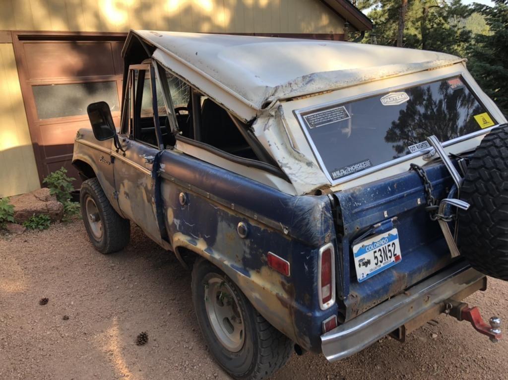

As I understand it, the smaller the DOM processed tubing (that is as strong as all other) is going to be $$. And remember that to really protect your nugget it needs to be connected to the frame, and not just bolted to the floor. This guy has a cage and you can see it, did he have passengers? They sell a "family" cage.
Windshield frame is not structural.
I use to have a show bar like this.
I gladly took it out.

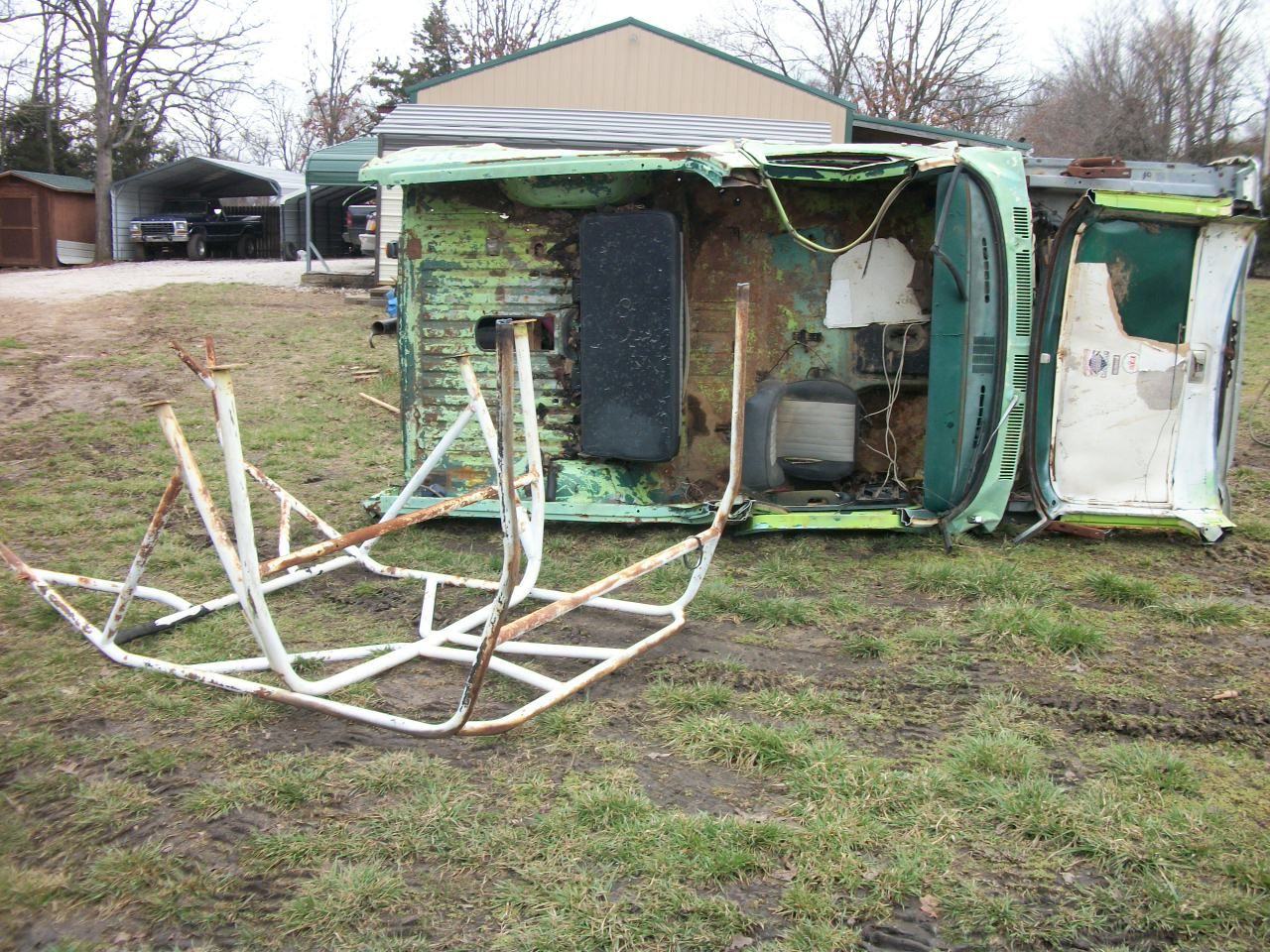

"...connected to the frame..."
yup, as I stated (#604 looks like they all do) we discussed manya X.
None of the pic seem to have this, or even a non-frame tied. I think, like
the 3 wheeler - they should B banned (loan either 1 & feel the pain of a bud
injured by false trust). Many guys use the "show bar" who do not go off rd. They C
what the windshield is, the B pillar, etc. & install, BUT this is hazardous as 1) false security,
2) deadly off rd. I have seen some of the 'upside downers' U publish here. I have seen them
w/'show bars' through the floor bds sticking up above. I am not happy w/all the bronks being sold
@ re-dick-U-loss prices'n no frame tied cage/bars.
