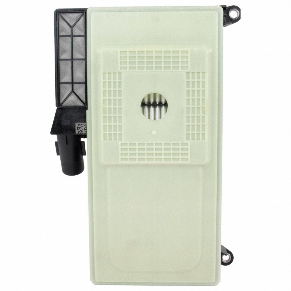

2020+ 10R140 transmission filter
Just saw this now on dieselfiltersonline.com
You 10 speed boys have a different trans filter.
https://www.dieselfiltersonline.com/...-10-speed.html
Haaa, it's $5 cheaper than the 6R140 filter. Go figure...
