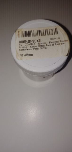

Before I plugged in the connector, I put NO-OX-ID A-Special- Electrical Contact Grease on the connecter. Like I said, Overkill...

Overkill - That No-OX special is the bomb. We were required to use it on every DC connection when we wired cell towers. I use it on any DC application, cars, trucks, tractors. Not a single one has shown battery terminal corrosion.

I believe I ran into it here. I bought that small jar on Amazon. I used it on my new snow plow motor connections last year where it was impractical to use NOCO NCP2 brush on corrosion inhibitor.

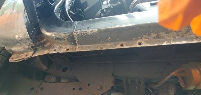

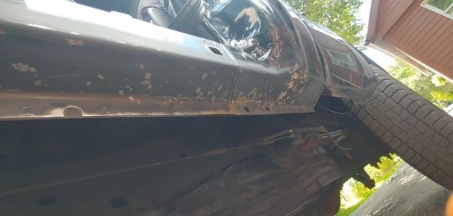

Driver side rocker panel pre Chassis saver paint
So these are shots of the driver's side rocker. I regret not getting mudflaps sooner. I will run them for this winter though (have to buy a set). I pulled off the fender flares and removed the side steps. The front fender had zero rust and solid paint, but the rear wheel well had two spots with the bubbles; pics to come. The front step brackets from both sides were rusted pretty well with most paint gone. Will treat those with Chassis Saver as well. I'm thinking about getting the steps powder coated semi-gloss black. A local shop did my son's Fusion factory wheels and they came out great. The guy said semi-gloss is most durable so that's what we went with. I'm going to have my wheels done at one point; probably after the Cooper Snow Claws are totally racing slicks as I have a set of Ford 18 inch steelies with brand new snows on them.
I can't remember if I was finished sanding them or not. All solid with just surface rust and not heavy.

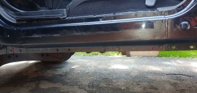

Drivers side rockers with Chassis Saver paint
So after I knocked down the bubbles to expose the metal underneath, I sanded with 150 grit sandpaper to get it ready for the paint. They call for a range from 120 to 180 grit sandpaper for previously painted surfaces. On the back side underneath the truck, they was minor rust and I had to scrap off the Ziebart tar schitt. I used xylene to clean after sanding and to clean the brush. I used 3 coats of silver #934, as a primer, and then 2 coats of the antique-satin black #970.
I also removed the sill plates from the doors as well. There was minor rust on the lips of the body where the cab seal sits on top of. So I took care of that as well. Here's pics of the holes for the rubber pieces that hold the sill plates to the floor... sanded and prepped for paint.

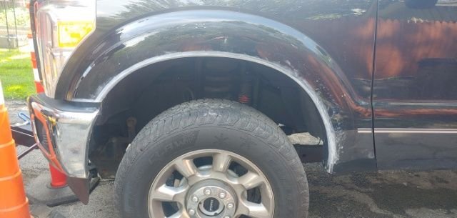

The front fender was clean but to protect the paint I decided on sanding underneath on the lip and a small portion on the fender line. This is a pic of it sanded pre-clean.
Looking at the rear of the truck. On the outside, I already coated the rust I found under the wheel well flare.

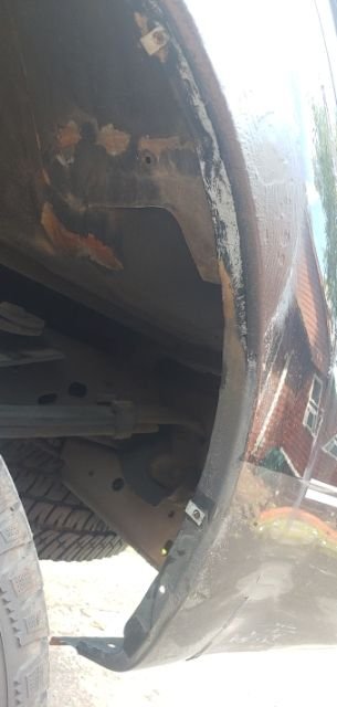

Rear wheel well looking towards the front of the truck. You can see more bubbled paint I found under the flare pre paint.
In the rear wheel well itself...

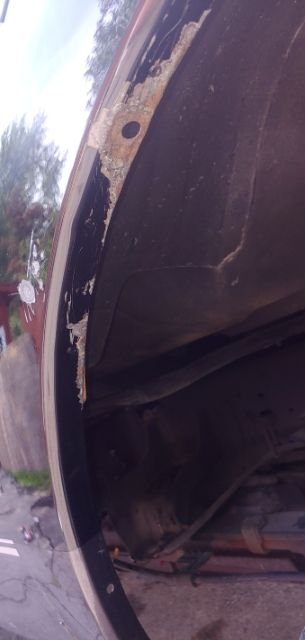

Another shot of rear wheel well looking towards the rear. More rust and damaged paint under the painted area.

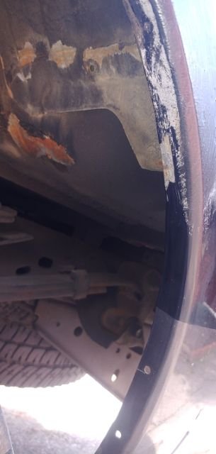

Another shot looking into the wheel well.
This is all painted now... Will take pics soon and post up. Then on to the passenger side.
