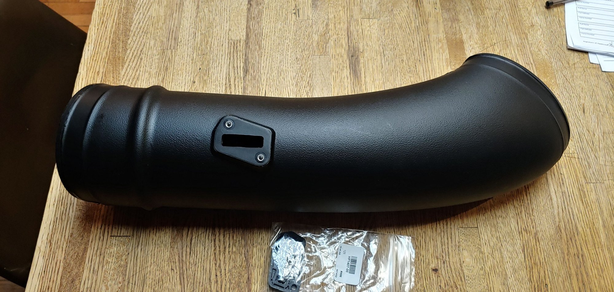

S&B replacement air tube came in.
The replacement air tube was at the house when I got home from work today. This will be going in and then I'm going to try to fix those threads in the insert in the bad one to keep it as a spare. Stay tuned...
Looks like i got a good one...

Looks good... Probably a rainy-day project at best, but another idea to repair your defective tube is to insert a screw into the stripped insert and heat the screw to the point the plastic around the insert starts to get soft and pull it out. Install new insert onto screw and install into tube. Heat screw until plastic around insert starts to melt and remove heat and hold screw/insert until plastic solidifies. Maybe worth a shot if the other suggestions don't work. Best case you won't ever need it and it collects dust and 10 years from now when you're cleaning your garage and doing a 5S project you decide to pitch it.

That's a sound idea as well but truth be told, now that I'm thinking about it, I'll probably put the old one in the box with the OEM intake and probably forget about it. There's way too much to do around the house, the honey do list, plus the stuff I have for the truck that I want on so I'm thinking it will be for another time. I'm just one of those guys who likes to fix schitt, you know, problem solve just for the simple reason because I can. It's a feeling of accomplishment. Thanks as always Troy.
