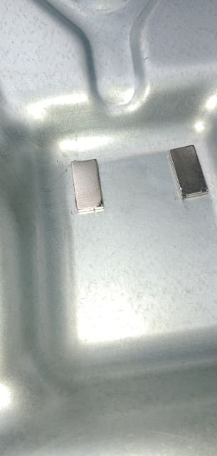

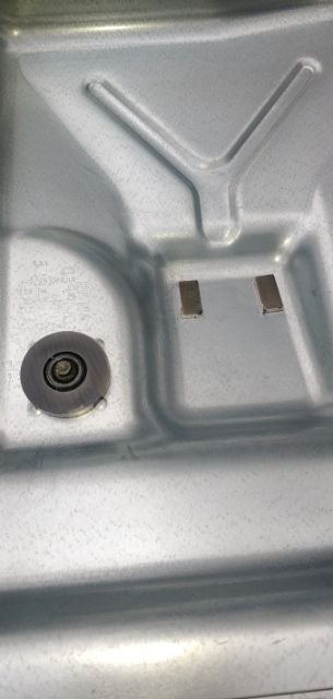

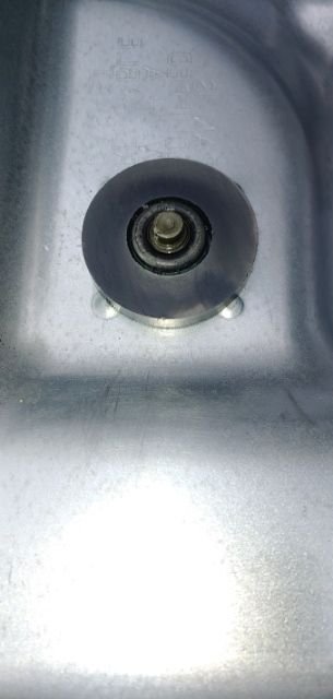

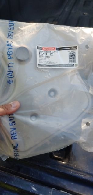

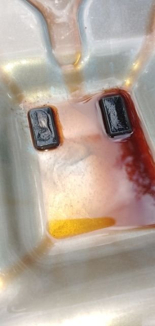

30k mile drain and fill for 6R140 and transfer case
I finally got around to doing my third 30k mile maintenance on my trans and transfer case. Mileage was 91647 miles. I have to find the mileage for the one performed at 60k which I believe was just over 60k miles. I love keeping track of stuff on post it notes and my phone but need to put it all in one place.
When I did my first drain and fill at 31k miles, I decided to drop the pan to replace the filter. The "O" shaped magnet around the drain plug had a lot of break-in material on it then. I also added two high temp rare earth magnets to the bottom of the pan at that time of filter replacement/pan cleaning. So it's been 60k miles since I last opened up the trans. I took the truck for a ride to get the trans and transfer case fluid warm before I did this. I told the forum here that at this 90k mile drain and fill, I would take samples of each (the transmission and the transfer case) to send off to Blackstone for analysis to see how well this 30k mile drain and fill keeps the fluid. I am also sending in a new, virgin sample of the Mercon LV to see how the fluid samples compare to the new fluid. Is it overkill? Maybe. But I don't mind changing the fluid early to keep the trans and the transfer case in good shape.
Here's the pics:
The new trans filter that went in. I bought two of them from dieselfiltersonline.com. The next filter will go in at about 150k miles for another filter change interval of 60k.
The two rare earth magnets I placed into the bottom at 31k miles. I scrapped of the top of one prior to this pic.
Cleaned off more to show the magnet.
The cleaned version. These are some strong little magnets. Could not get all the stuff off....
Cleaned and ready to go back on...
The transfer case fluid looked better (redder) than the trans fluid. Stay tuned because when I get the results back, I'll post up here.
