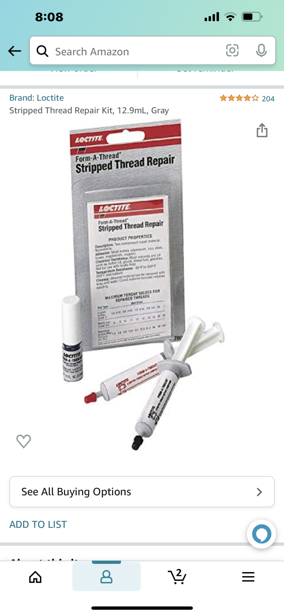

i used that thread repair kit a few times and if you follow the directions exactly it works….critical step is to prep the damaged threads with a though cleaning and complete dry.

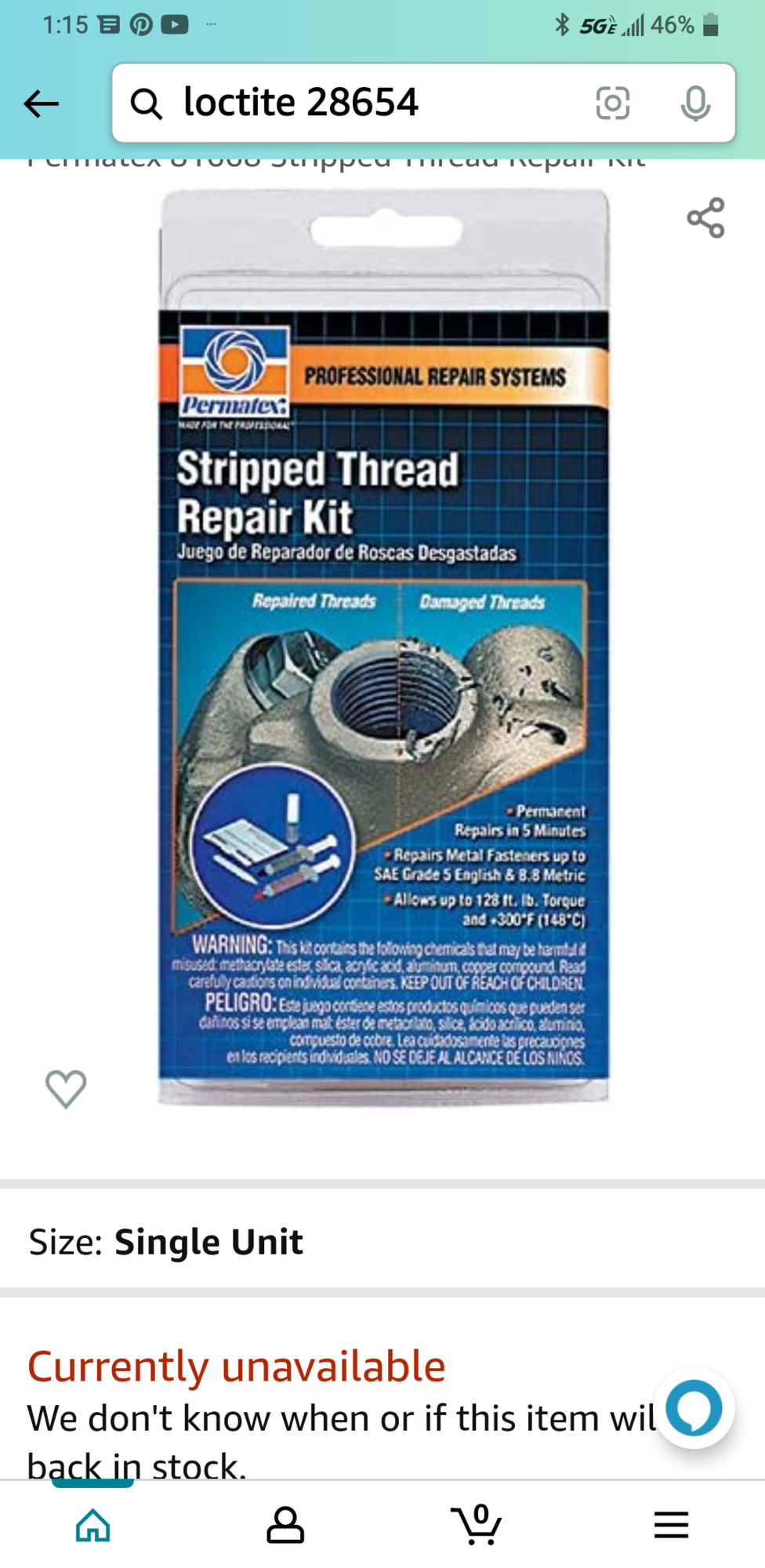

Nobody sells this stuff locally, I've been calling, and the reviews on Amazon, the most recent ones, have not been good because it sounds like the kits being sold are old as eff.
Not a lot of options on Amazon either. They want 50 to 60 bucks for these kits. I'm thinking it's no longer made and its NOS.
I'm going to look into Permatex. But I can always get a heli coil kit cheaper than what Amazon wants for a Loctite kit. It just doesn't seem to be out there which would mean to me it's no longer made.

you can probably simulate how this kit works.
there is a metal set type of compound that goes into the cleaned out and preped damaged threads . I used a tooth pick to apply. The only caution is that the idea is to cover the thread area lightly and not fill the hole. Filling the hole will prevent the bolt from being inserted.
the second componet is the y damaged bolt clean and lube with the secret sauce lube paste. The lube past prevents the metal set type compound from bonding to the bolt.
the idea is once the metal set hardens, it’s bonded to the bad thread side and the hood threads on the bolt cuts the thread path into the metal set stuff while at the same time the lube past prevents the hood bolt threads from bonding.
at a certain point the bolt gets removed and you let the metal set cure. The retained thread pattern in the metal set becomes the new threads.
you wipe off the lube past from the bolt and after full cure, you can even torque the bolt.
sure a spring type insert will work if you want to drill out the bad hole and go thru that process. You would probally want to use some type of drill stop.
