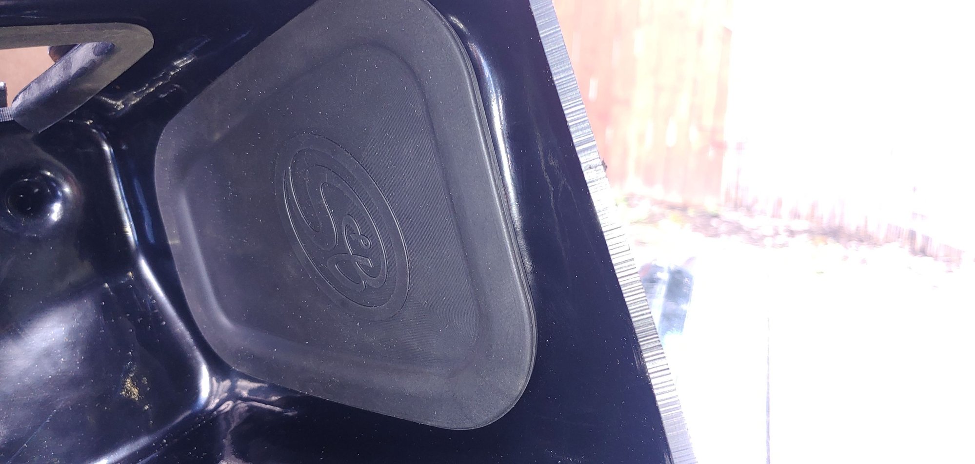

This is for you Chad. That plug will fit in that hole on the fender side from the inside... It moves around a little but seals it up fine.

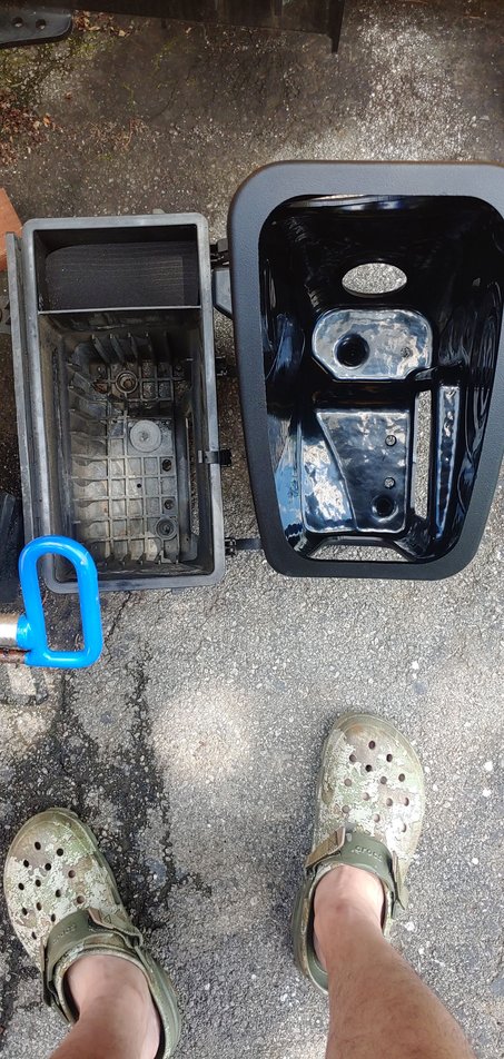

This used to drive me nuts when I replaced the air filter... That clamp was so close to the radiator support. Not a problem anymore.
The two boxes side by side.

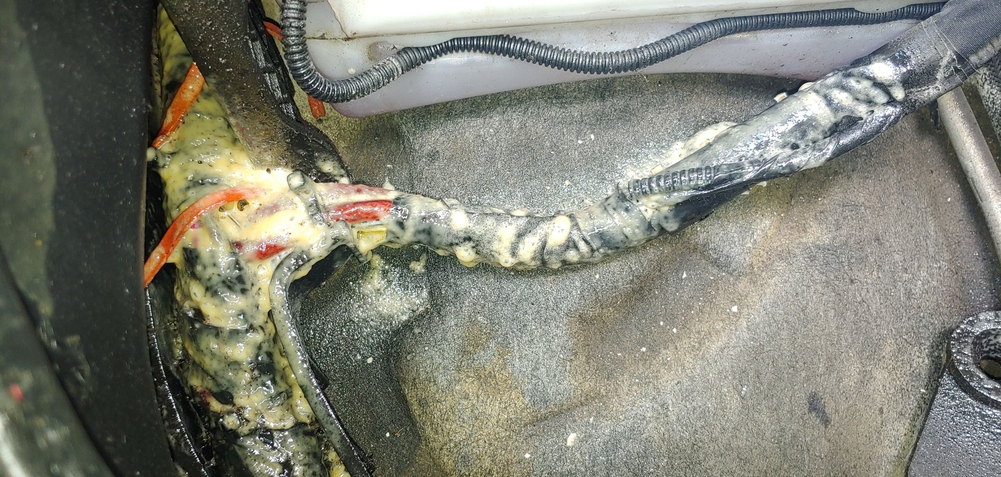

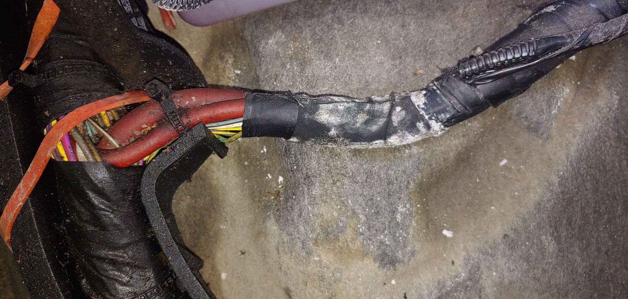

When i popped out the airbox, i found the wire harness covered in salt.

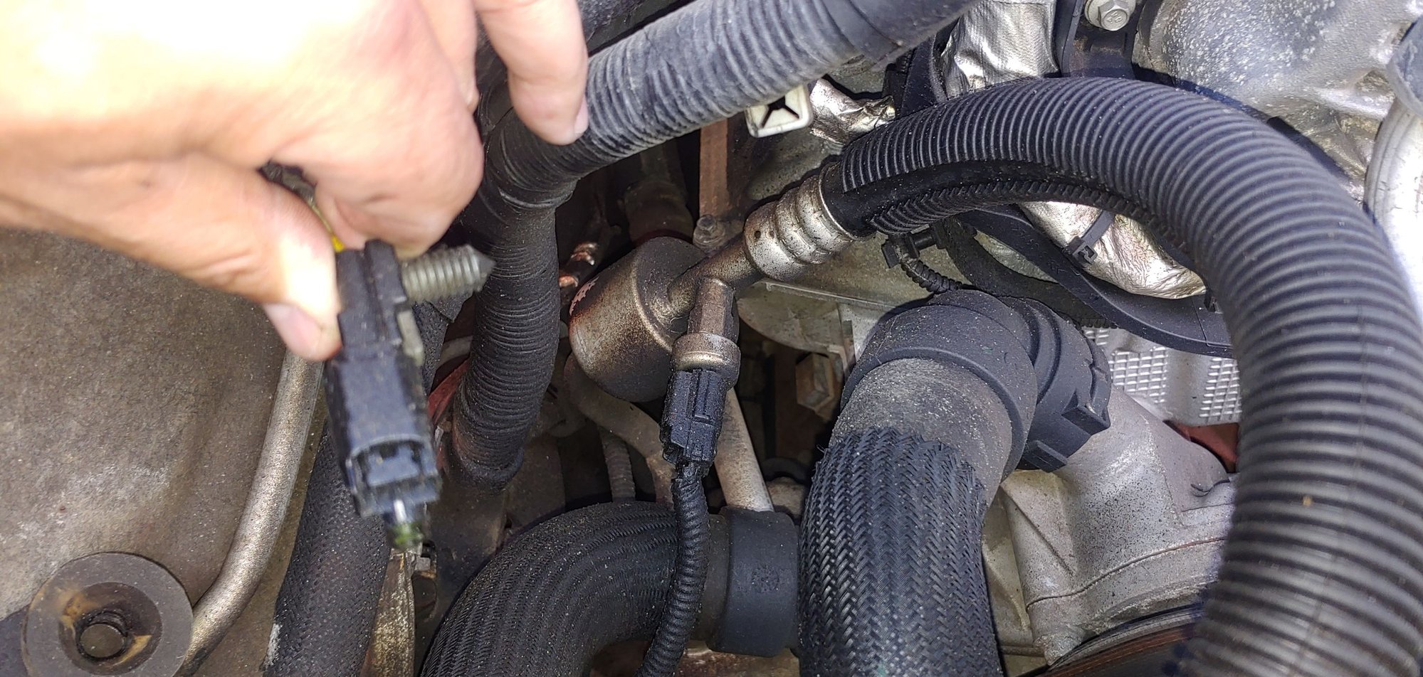

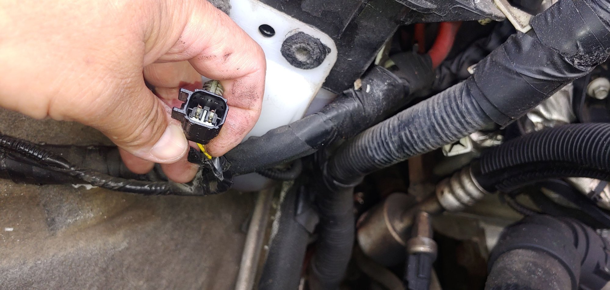

This connector is also there. It has a dummy connector on it to keep it clean.
Sprayed Carwell Products oil on it and Fluid Film to keep it corrosion free.
The dummy connector...
The wire harness after being douched down. Sprayed extra Carwell oil in the fender where the harness was.

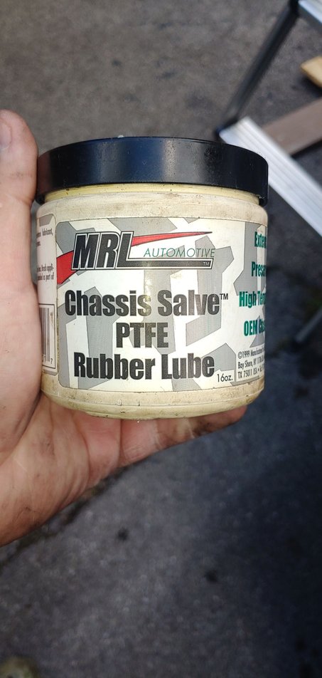

Welcome to the world of overkill. I've had this since the 90s after i bought my 96 F250. Put some on the rubber piece that goes on the intake hole from the factory. That had some salt on it also.
I used this, very little, on the silicone gasket where the air tube slides into the box to help lube it and worked great to make it easier for the tube to pop through the gasket.

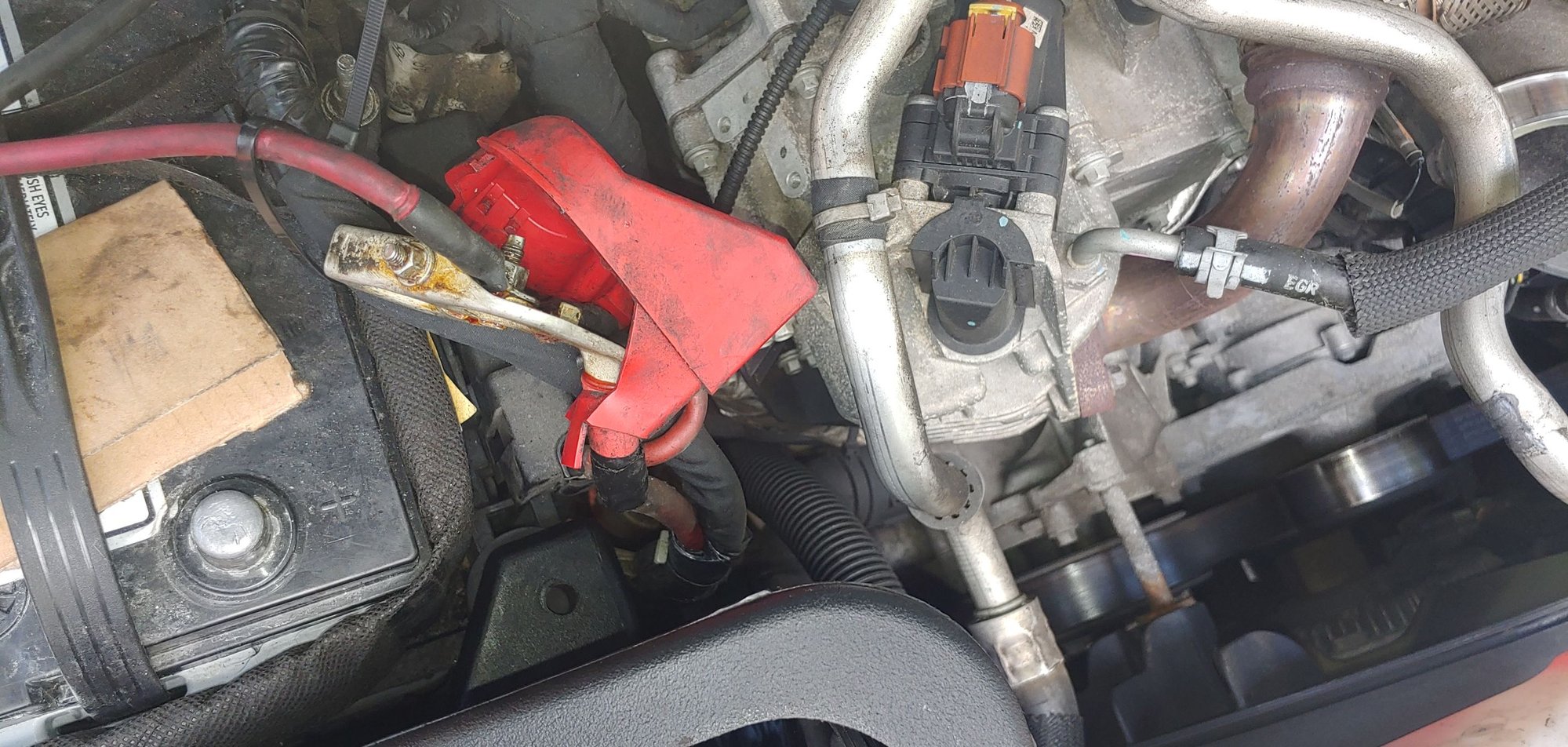

I highly recommend zip tying the passenger side positive terminal up and out of the way prior to attempting to line up the factory screw through the rubber washer they provide to the threaded clip. Trust me... Just do it. I wasted a lot of time effing with it before I realized that zip tying the terminal up and out of the way will make it a lot EASIER. Believe me.
Its still a pain but way more room.

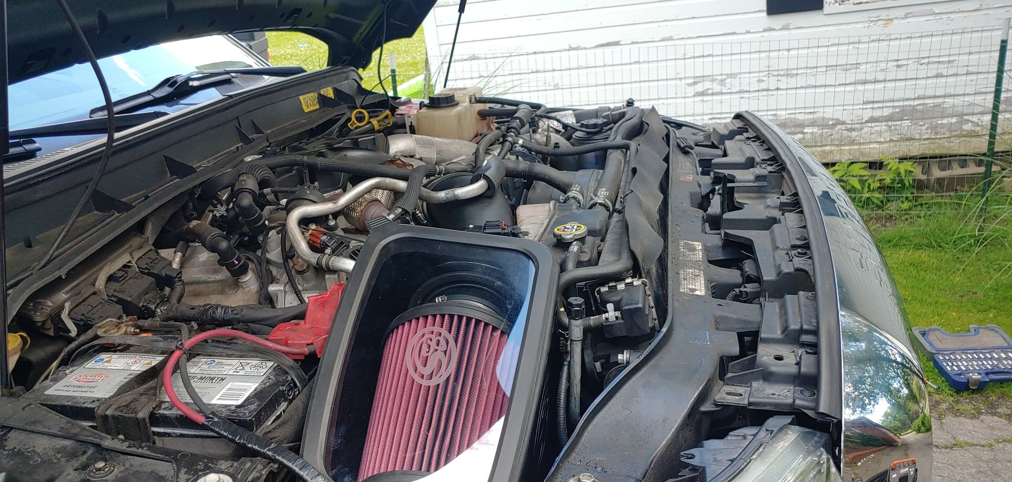

I believe the truck is a different beast with that less restrictive air intake on. I'm not saying it added gobs of power, I just think if you make it easier for a big air pump (our 6.7 engine) to pump air by having a less restrictive air intake, you have some power (a little) back that you may have lost due the restrictive factory air intake.
It sounds louder... I like it. Now, just to take care of this with S&B and get a new air tube with TWO good threaded inserts...
