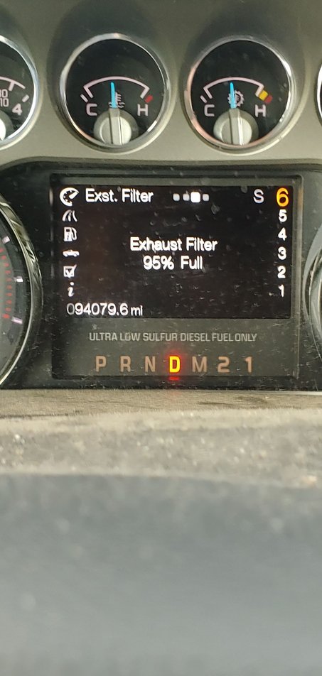

Pretty impressive mileage amount for a short build up to FULL DPF
Okay so I mentioned in this thread, that I had a short active regen (8 miles) end with the soot load total dropping from 100% to 70%. I dropped a buddy off after a concert and put truck in park in driveway which ended the regen. Said regen was 390 miles out from the last one. That's low for my truck which makes me think it may have been the fuel that changed as I have not changed where I fuel up.
Anyways, I left the house early this morning in anticipation of the truck going into regen because she was at 95%. I left the house with 94062 miles at 95%. It took to 94089 miles to hit FULL. I'm impressed that the truck went a full 300 miles to get the soot load to go from 70% to 100%. The iDash did indicate some passive regeneration as EGT4 prior to the regen was in the 600s but it wasn't enough for the truck PID to drop 5%. It was a 23 mile regen and the truck got down to 25%. I won't be surprised if when I get back into the truck, she's at 20%. It's been doing that now quite often. I'll post pics of the iDash with EGT temps later as I took a few.

From today's drive prior the regen...
EGT4 climbed some more after the pic was taken... Almost got to the mid 600s.
Damn thing took forever to go "FULL."
Temps during regen
That's where you have the problem... Level roads with no hills to climb. My soot load always climbs faster (on the iDash) when I'm driving in to work because it's down hill.

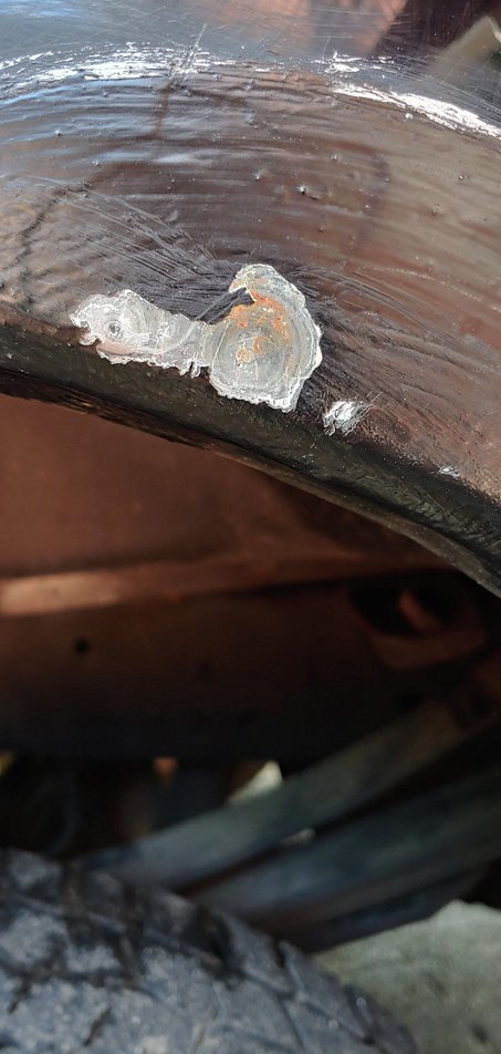

Make sure you sand smooth metal w 60 grit sandpaper for un-rusted metal for Chassis Saver
Okay so I learned my lesson here. When it comes to new smooth metal, with no rust present, use 50 to 60 grit sandpaper as per their instructions to give the metal enough scuff for the paint to hold to.
I didn't do that and just used 150 grit sandpaper that they called for (150 to 180 grit) for solid previously painted surfaces as I sanded over the metal where the bubbles were under the fender flare.
A few days ago or so, I was showing my neighbor the job I did when I noticed bubbles in the paint over the rear wheel well. It had rained previously plus I took the truck through the car wash so when I pushed those bubbles that weren't previously there, water came out...
Today I ended up cutting into the bubbles and peeling them back with my Hogue knife. The paint bonded well with the painted surfaces I sanded with 150 grit but did not bond with the metal under the bubbles.
Here's an idea of what the metal under the bubbles looked like before sanding.
You can see the circular spot where the bubble was. There were also smaller ones there as well. Its on the outside of the wheel well to the left. This spot was pretty good. I ended up scrapping it with my knife and most of the paint bonded well. So there was only a new small spot to re-coat with paint there.
Don't bother buying one of these. The sponge flexes and does not dig in the same as the regular old sandpaper does, trust me. Just wasted 7 bucks.
This is pre sanding... After I scrapped the paint off.
Close up pre sanding...
Pre sanding....
Larger part hit with 60 grit sandpaper.. As was the right part of the bare metal above it. The left circular part was not yet. Notice the roughened surface of the bare metal. This is required for Chassis Saver to bond with smooth, un-rusted metal.
All bare metal sanded with 60 grit and ready for paint. I did sand the solid paint around the bare metal with 150 grit some more though prior to painting.
