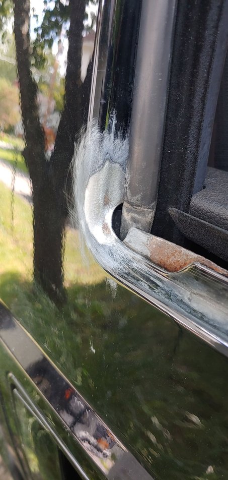

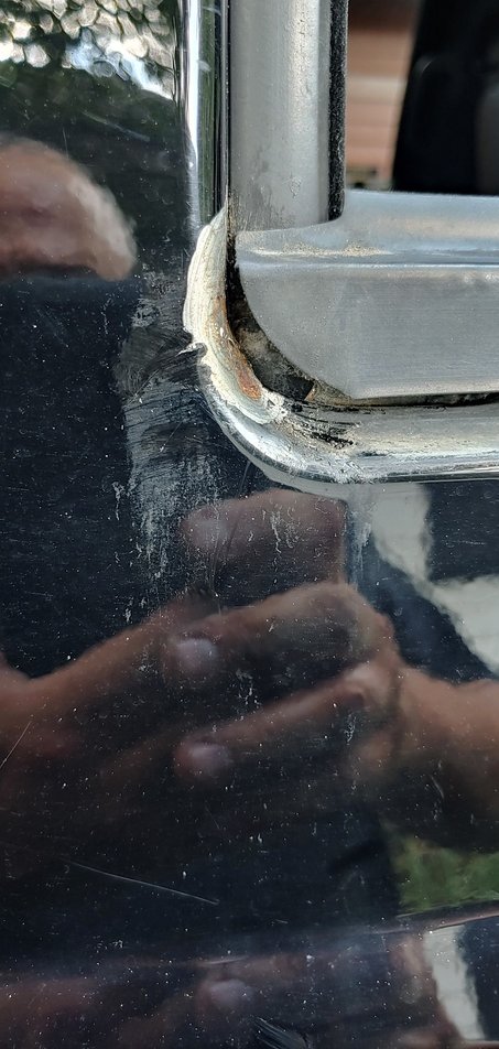

The passenger rear door by bottom window weather strip
So if I had known how easy it was to just pull up and off the bottom outside door window weather strip, i would have done this before instead of just keep spraying the spot with Fluid Film.
Before removing the bottom weather strip off the door.
The bottom weatherstrip removed. I did take a 1/4 inch 1/2 inch socket and place it between the door and side weather strip piece so I could get behind it.
Prepped and ready for paint. You can't see it but i have that socket in there.
The socket in place there...

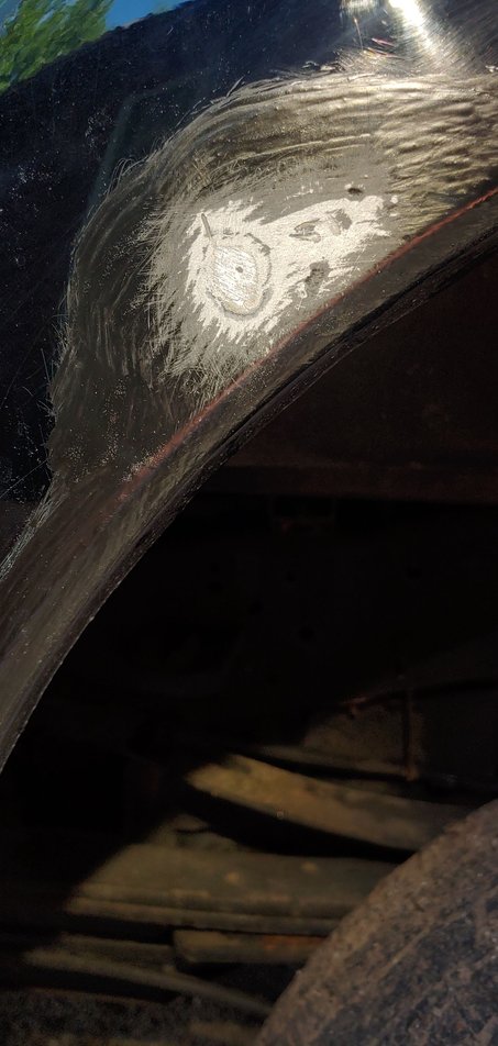

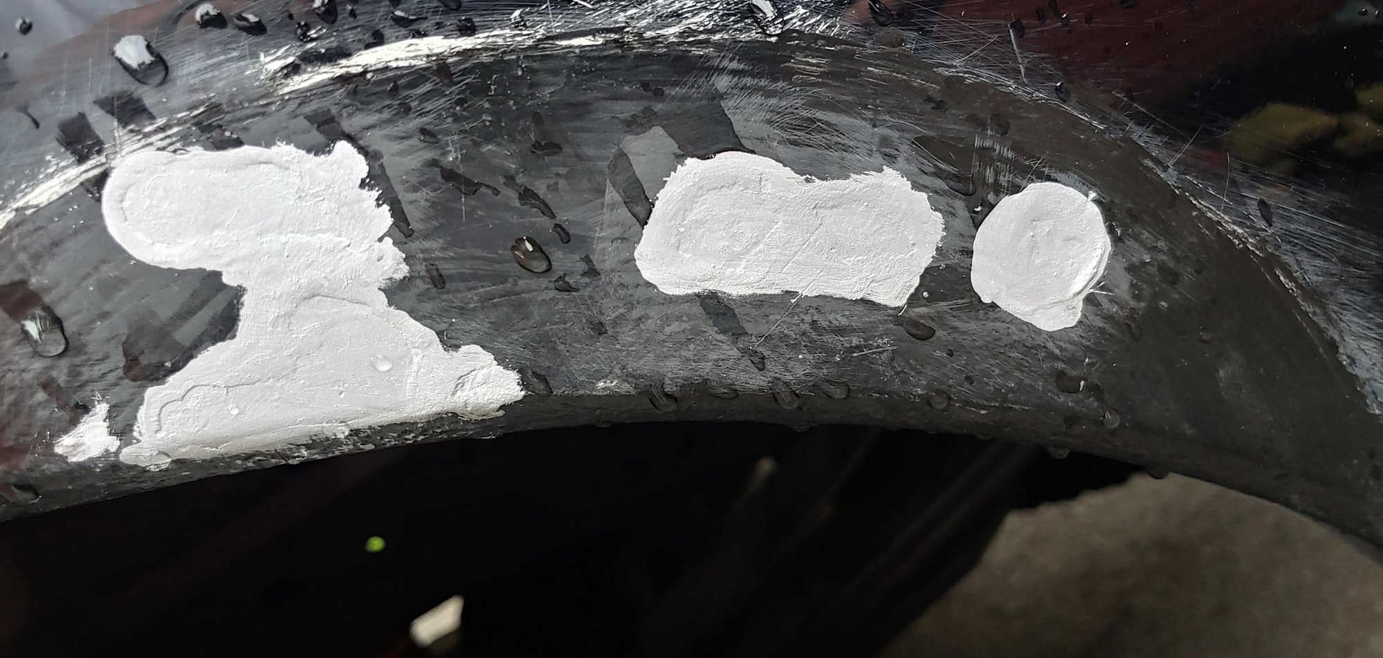

Another shot of the bed wheel well scuffed up.
I only got two coats of silver on today. Had to go with the fam running around. I'll take pics tomorrow if it's not raining.
Still had that window open and saw flashes... went out to close it. Of course it's gotta rain now but paint felt dry to the touch because it was humid today and it's cured by moisture. Will see how it holds up when I go to recoat.

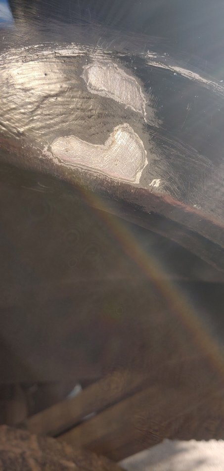

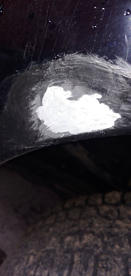

Two coats of Chassis Saver #934 silver
I was able to get two coats on yesterday but the rain today is preventing me getting on more. It rained very lightly after the first coat but the truck was parked under the Bradley pear tree whose branches hang over the driveway. So the paint stayed dry. Then I got a second coat on that had at least an hour and a half of dry time before it started raining again.
I got a few pics before the rain moved in again. I applied the paint with a Q tip as the area was very small.
With the flash on.
Flash off
It seems like the paint bonded to the metal this time due to scuffing the metal with that 60 grit.
Passenger rear door... There was very light rust there...
The corner
Since i will recoat after 24 hours, I'll have to scuff the paint with 400 grit sandpaper but could probably use 150 grit real light.
Once I have at least two more coats of the silver down, I'll top coat it with the antique satin black I used.
I gotta be honest here, I really am a function over form guy as opposed to the other way around. My goal is to make sure that the paint properly adheres to avoid problems, then cover it with Monstaliner for the ultimate protection.
I'm really not against eventually coating the whole truck in Monstaliner for the ultimate durable coating on my truck. And IMO, on the plus side, I won't run WITH the crowd, I'll STAND out.
I recently sold my mom's car and the guy who bought had a same gen truck as mine that was deleted. We were talking truck stuff when he mentioned that mine was a gasser... Because I de-badged the truck. I smiled and said, "No, it's got a 6.7."

I just looked at your pictures again and saw this was near the window. What a odd place to rust. As for sand paper and I guess you know this already but the wood sandpaper is different than automotive sandpaper. They use a different material for the grit. It's a pain to paint and get it just right.

No problem. I've used this paint, Chassis Saver, before on the receiver of my 94 4Runner that's in my garage. I wire brushed the loose rust off, cleaned it and painted over it with the antique satin black Chassis Saver. The paint has faded due to the door spring being busted and I haven't fixed it yet, but zero rust has come through. I'll take a picture when I think of it and post here. It's made to adhere to tight rust, no loose pieces, and seal it from oxygen preventing further rust as long as it's properly prepped and cleaned.

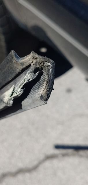

The weather stripping has a metal reinforcement that must have dug into the corner of the door, it looked like it was pushed into the corner, and worn the paint off from vibration of the movement of the truck and rust happened.
As to sandpaper, no I did not, I'm clueless when it comes to that. But the 150 grit sandpaper scuffed the solid paint great as did the 60 grit scuff the bare metal really good for adhesion of the Chassis Saver.

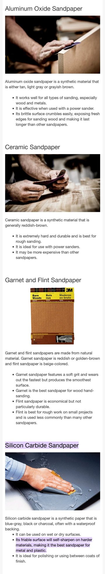

Back in the early 90's I was a professional painter for custom cabinetry. We always used Aluminum Oxide based papers. I've dabbled a bit in metal work and finishing as a DIY'er (not professionally) and I've always used Silicon Carbide for wet sanding. Not sure if anything has changed over the years or not.
Here is some info about the different types of sandpapers after a quick search.
I don't have a big knowledge on sandpaper like I did in HS wood shop LOL. I don't do much woodworking these days mostly wet dry on some painting on a car I own. Sanding I got down pat but painting, not so much
