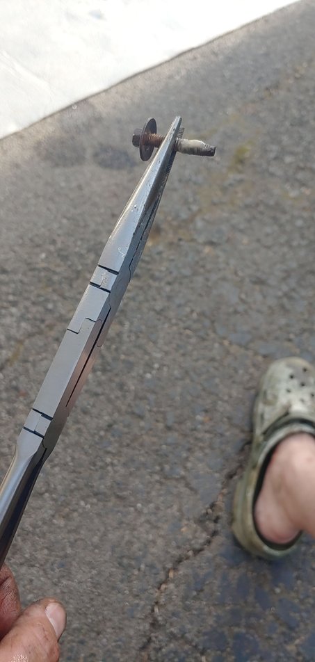

A pair of needle nose pliers made the reinstall of the outer 8mm bolt MUCH easy than without...

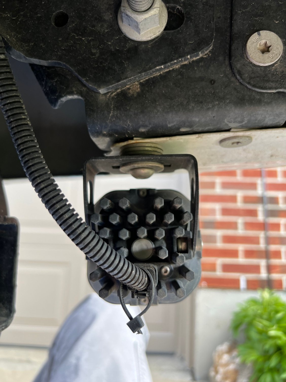

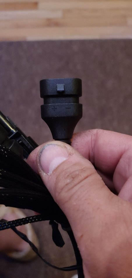

And another thing before I forget... The adapter harnesses from Diode Dynamics come with a tab on each side probably because of all the different makes that they are used on. When you install them in your Ford, put the side with the "+" and "-" on the Diode Dynamic male connector on the opposite side of where the clip is on the female factory connector. They don't work the other way. Guess how I found out...
Use this side to lock in the factory foglight connector.
NOT this side.

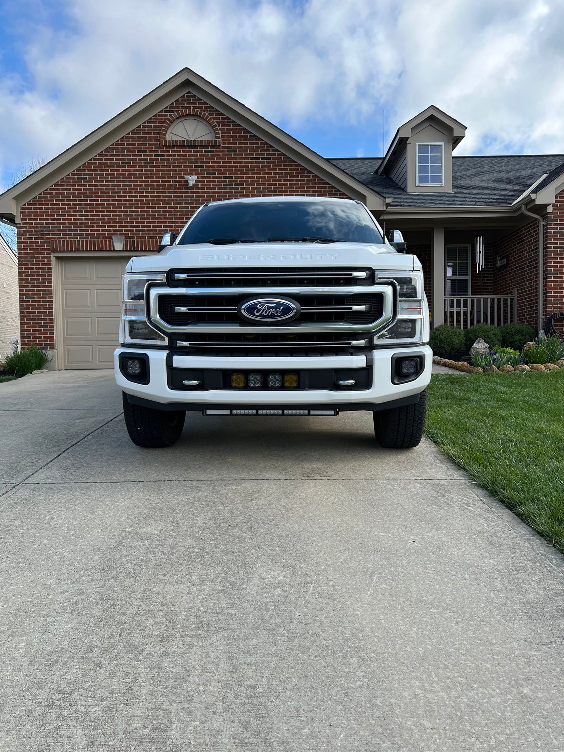

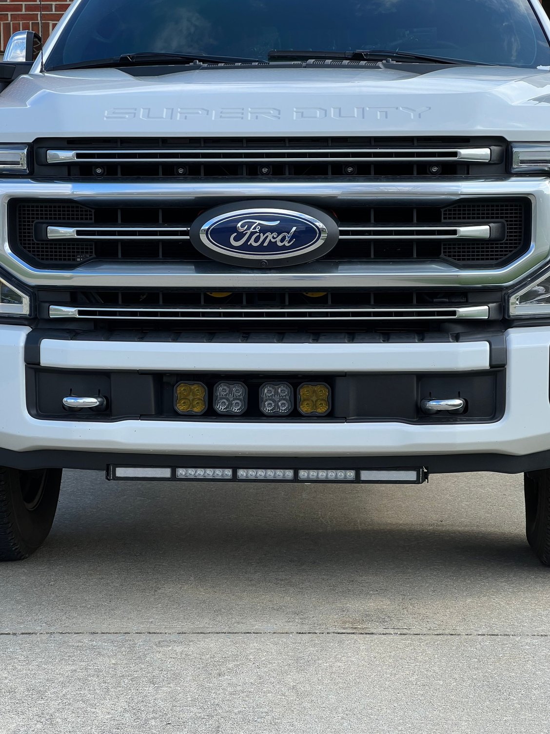

Originally Posted by Squirrel13
I love my DD as well.
I was just looking at my bumper today and I have room for one pair in the center cut out in the bumper. I could do a set of SS3 SAE driving lamps at one point. May stay with the yellow. Nice setup you have there.

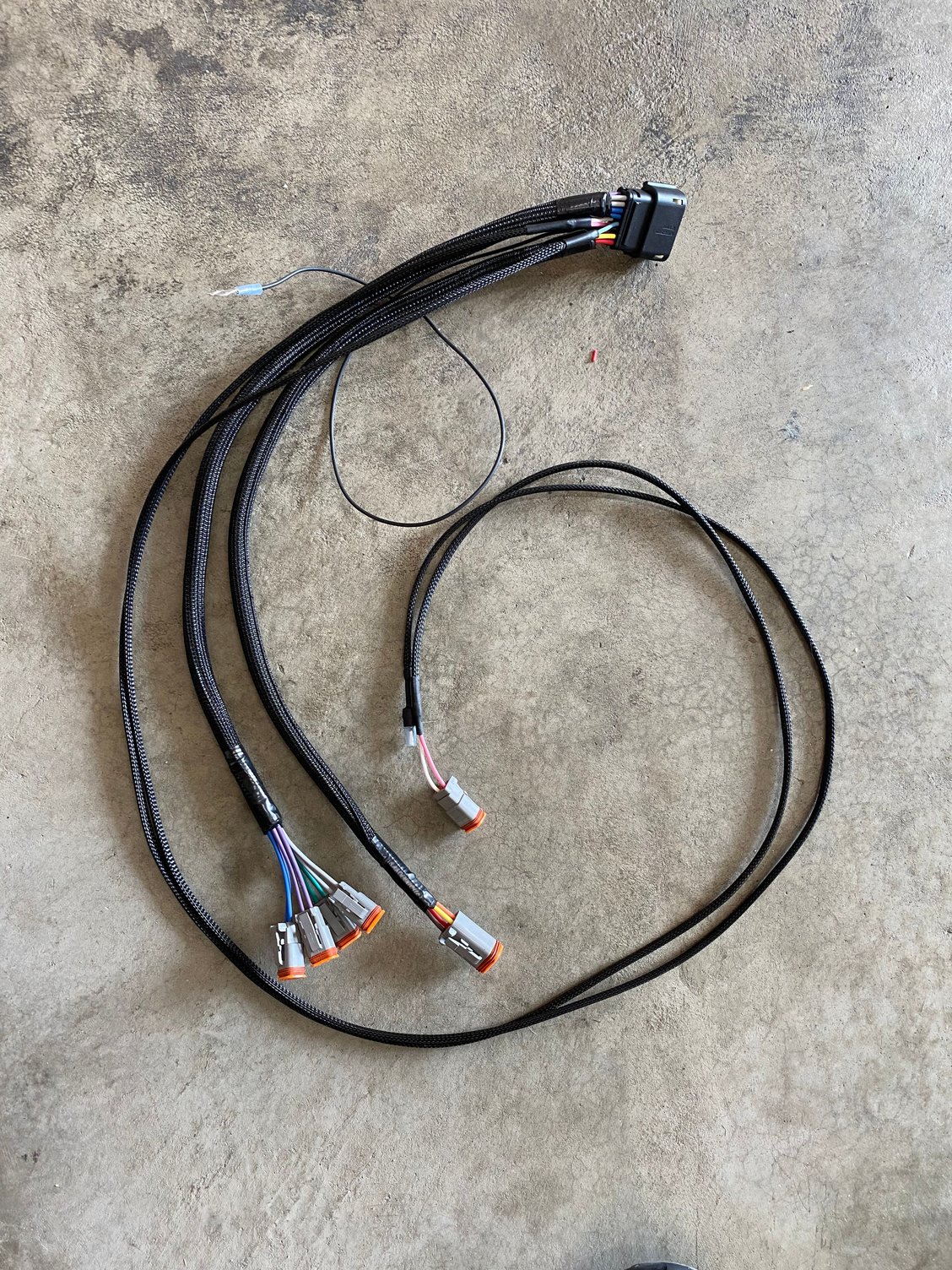

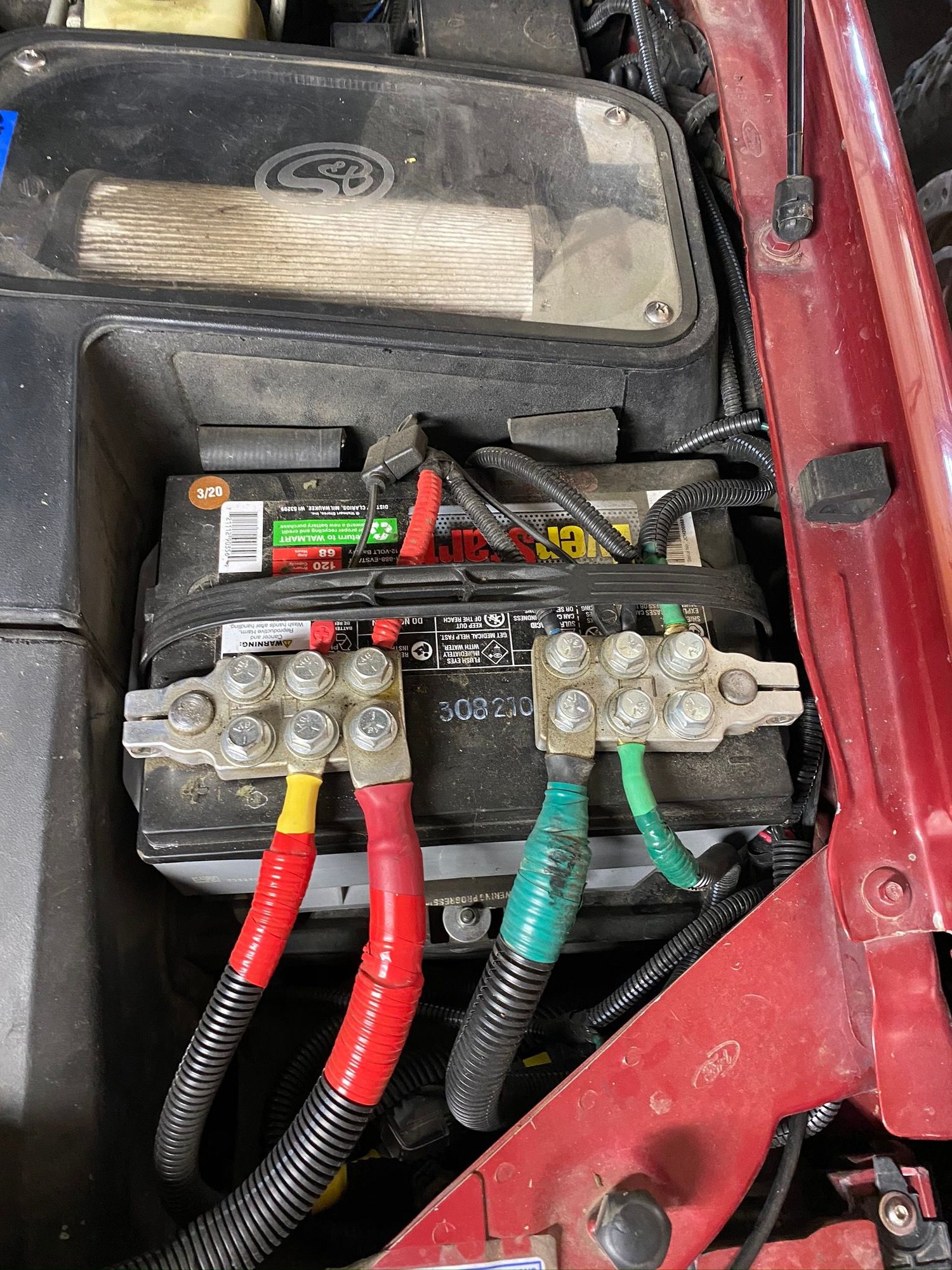

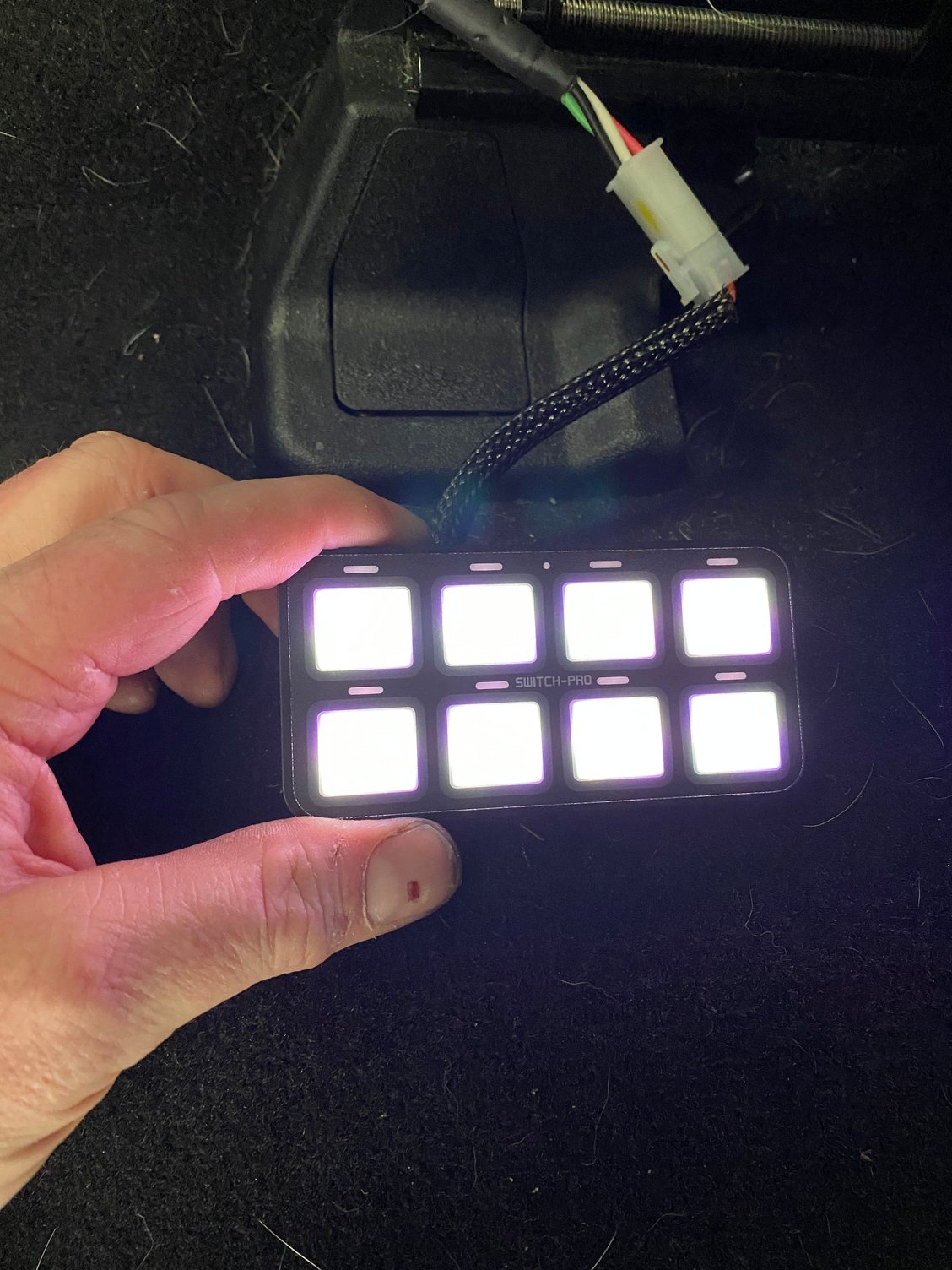

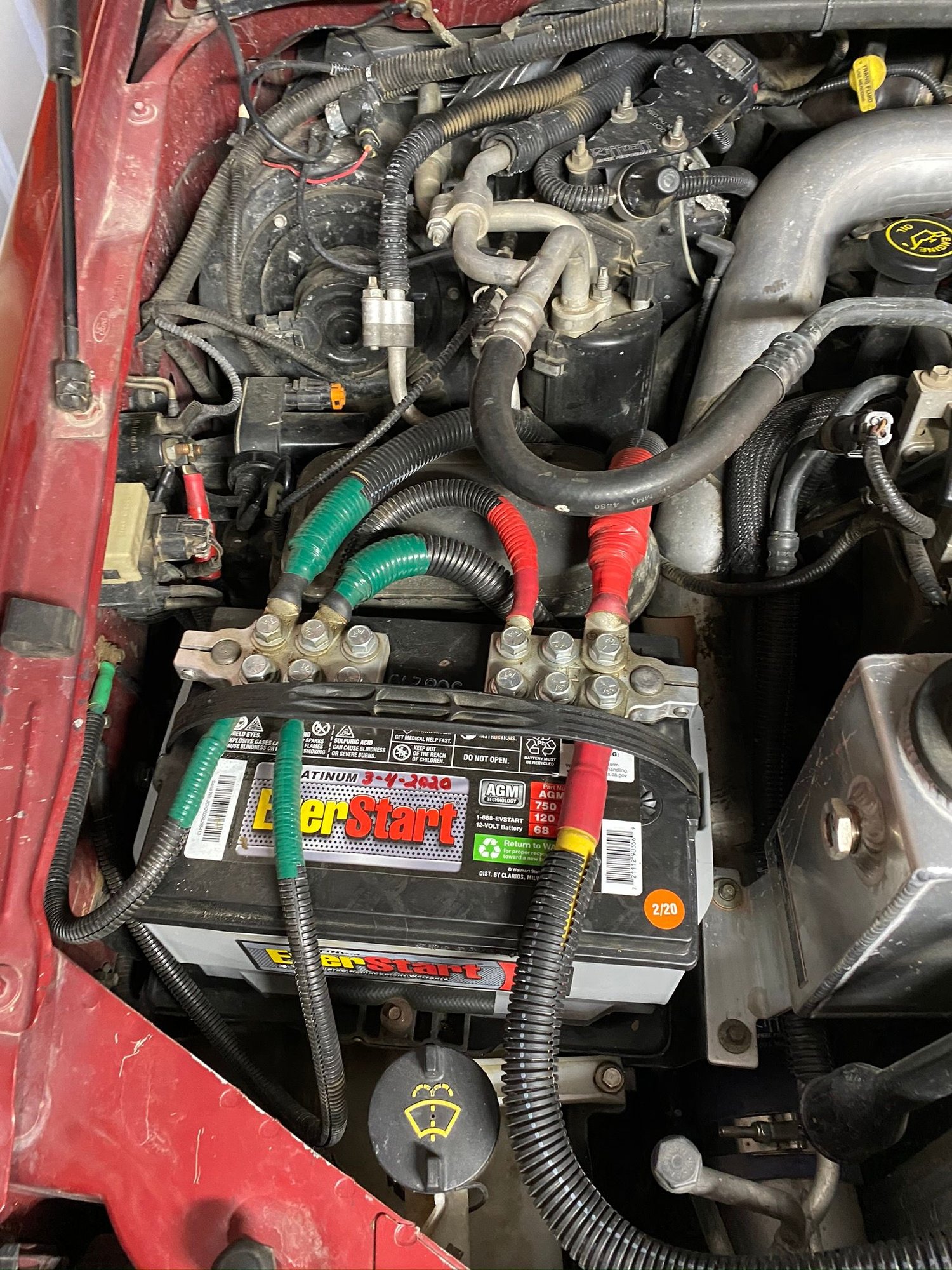

Overkill the big harness is for the Switch Pros auxillary switching.
Like you I did a complete custom marine cable upgrade on the Excursion.
That's some quality wiring there Squirrel... Sweet.
