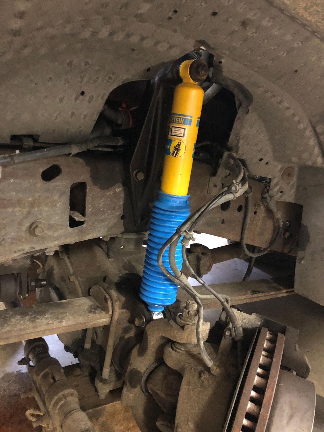

Originally Posted by F350towing
It’s a shame though. I’d rather see the blue boot than the yellow in the wheel wells.
I didn’t want to see either which is why I opted for the silver/black “lifted” version even though they aren’t exactly correct. I just don’t like things to stand out and prefer they sort of blend in. Hindsight guess I could have painted the shock body and ordered black boots?
Not knocking on your install. I’ve heard the 4600’s ride a touch better.

The 4600 series is what Bilstein advises for a non-lifted truck and I am 99% happy with mine. The last 1% unsatisfied is the color. I have grown used to them though after having thoughts of removing them to paint them black and replace the boot with a black one. Maybe one of these winters if I have time I will paint them.
Like Jason, I would prefer a subdued look, but I am very happy with the truck as a whole for our application.

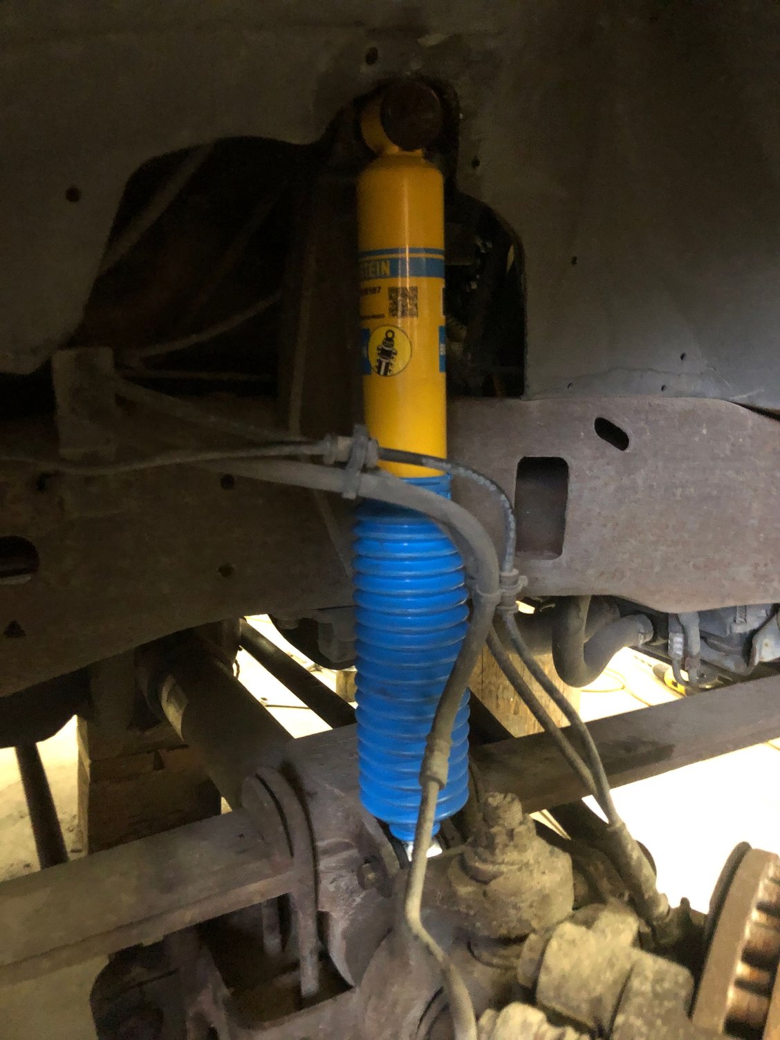

Shocks are installed. I didn’t like how compressed the boots appeared to be so I cut the black zip ties, moved the boot up on the body to a more neutral position and zip tied with a blue instead of the black.

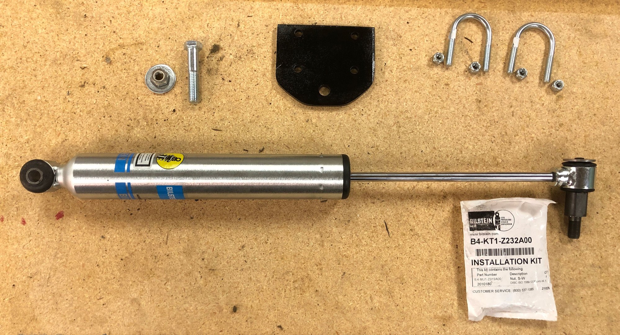

Since my truck didn’t come with a steering Stabilizer from the factory I had to collect some 1-3/8 x 2-1/2 x 5/16 u-bolts for the centrelink mount and the bolt for the clevis on the axle side.
Made my bracket from 3/16 plate. 4-1/2 wide x 3-1/2.
3rd coat of paint went onto it right after this picture was taken. Either this evening or tomorrow morning it will be installed and ready for road testing.
Track bar bushings are on a slow truck delivery and scheduled to arrive on the 16th. This won’t allow enough time for installation before my next scheduled trip to the property on the 17th.

Looking good! Think I “overreacted” about the color and this version would have been a better fit for me.
I ordered the stabilizer bracket kit from Summit Racing when adding one to my truck. Seems like it was pretty cheap. I didn’t notice much of a difference with it, but I also don’t drive the truck much. Surely has to help a little.
