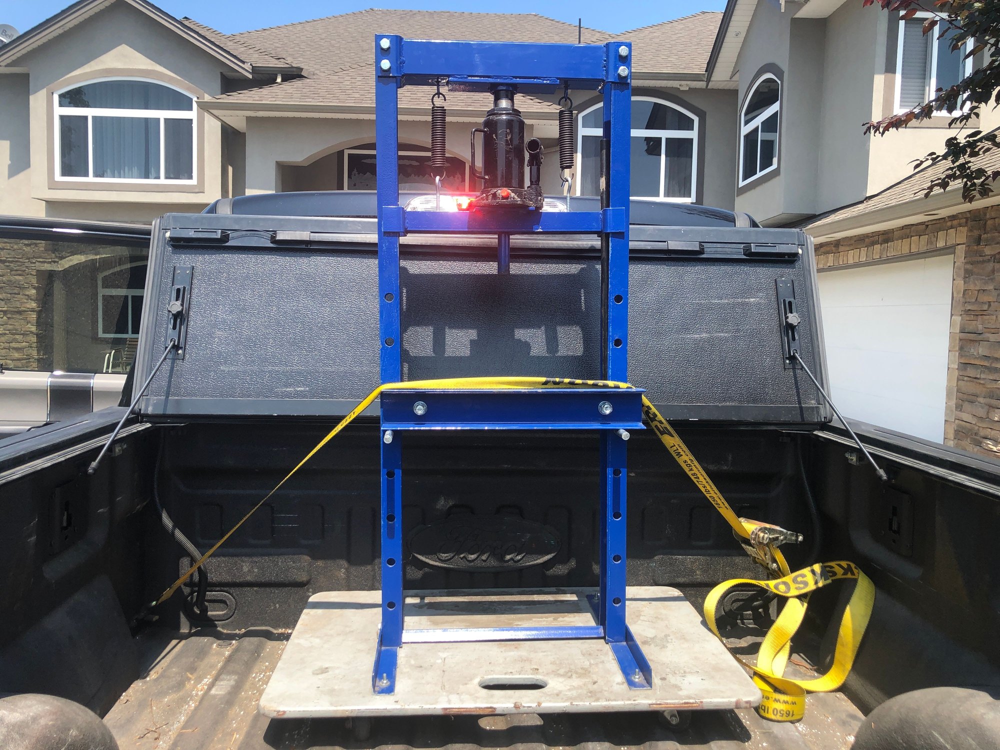

This should make the track bar bushing’s easier to do. Couldn’t turn it down for $150.00 off Facebook Marketplace.

Dammit!! Why don't deals like that hydraulic press come up around where I am?!
The other day, a member here picked up a 1.5 running hp (not "peak") belt driven all cast deep arm Made in USA MK Diamond MK-101 wet tile saw, with stand, for $10 on Facebook Marketplace.
I've never been on Facebook (Facebook won't let people who refuse to join Facebook see what is on Facebook) but dang.... the classified ads on Facebook seem to have incredible deals.
